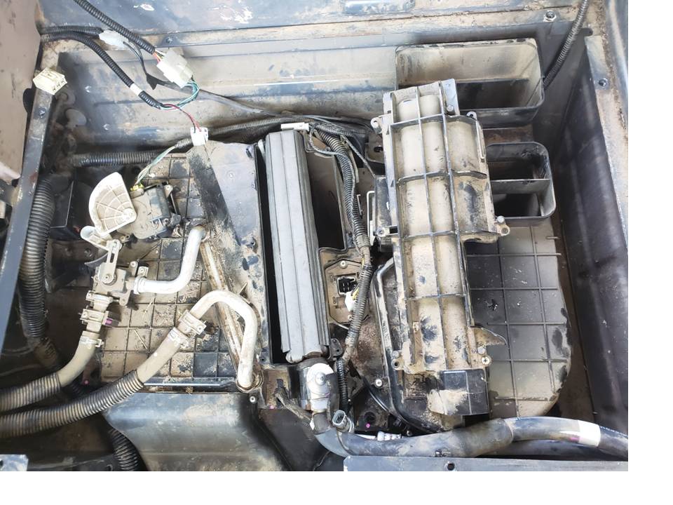

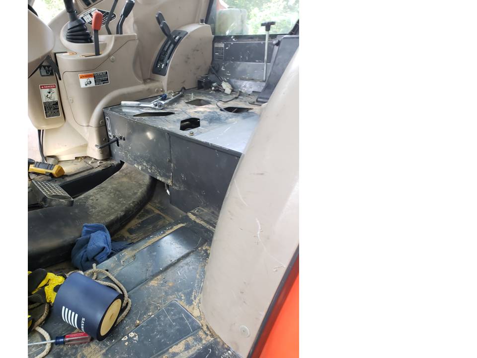

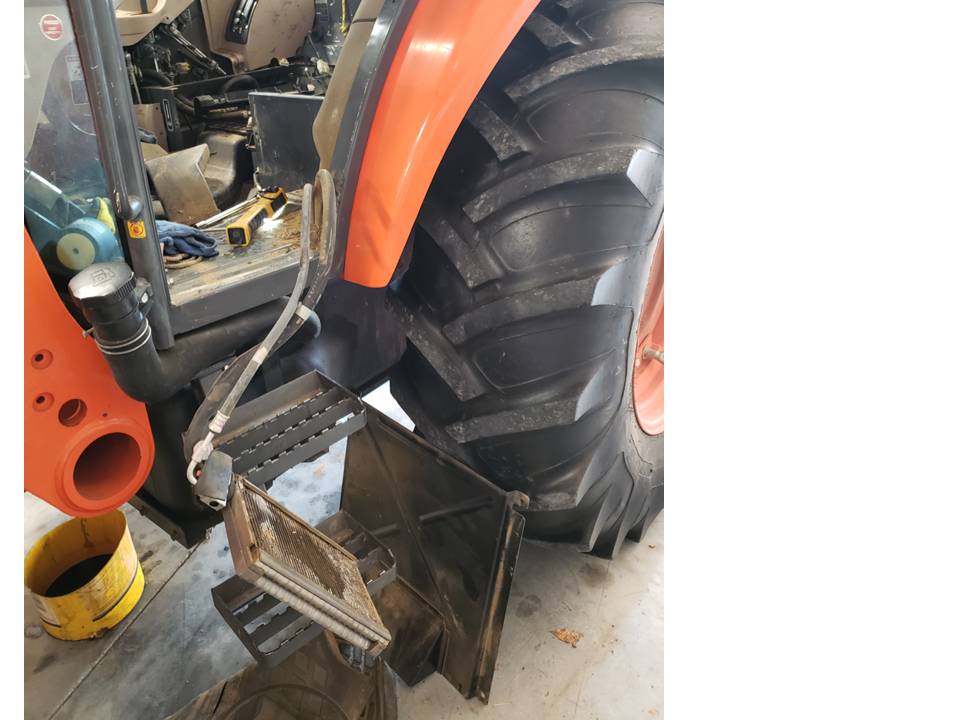

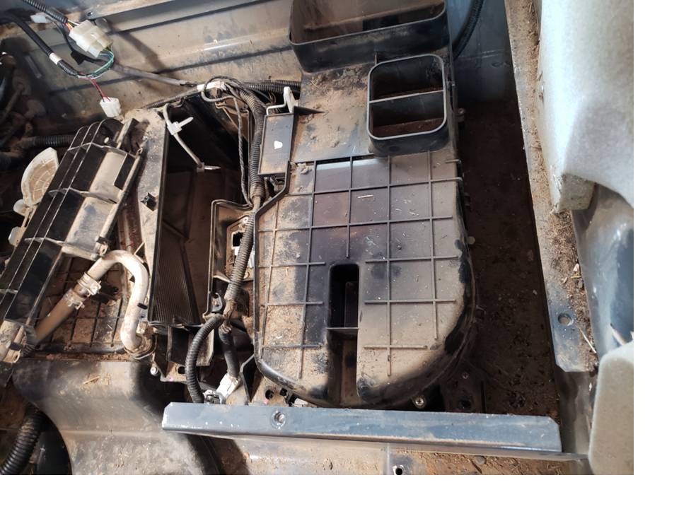

Finally pulled the evaporator out and it does work better now. Pulled more out then I need to with the floor plate and side Lock Dif plate, but go it done.
Remove seat, then have to unfasten both plastic covers to get at 2 bolts. There is one bolt on each side. Then remove exterior intake duct by removing two 10mm nuts. Then the plate can be removed. Screws covering Evap and out it comes
It was pretty clogged
Also best to remove all the bolts holding the entire unit in. The lines are flexible, but the unit needs to be moved toward the rear to get the Evap out

yes that is exactly how I do it too. There's one screw in the box that can be a bear, but it's not terrible.
Get it cleaned out good and reassemble.
One thing that I did a little of while doing kubota work was to remove the top of the cab. A few screws around the perimeter (just take out the long screws-and be aware that the 3 or 4 in the front are a different length than the others). Leave the short screws in. Then just lift the top off. I'm pretty tall so I did it by myself without issue, but if you're a little shorter it might be worthwhile to ask for a little help (it's not heavy, just kinda bulky). Clean the bottom of the top real well and then apply some self-stick heat reflective stuff. This helps two things--(1) reduces some of the noise and (2) helps the a/c work a little better. Ceramic tinted windows help too-quite a bit I might add. But I also understand that some don't really like tint. I'm on the fence there.
Your a/c low side pressure will drop with temp. So as the cabin interior cools off, your psi will also drop. That's something that a lot of a/c "mechanics" don't think about. You don't turn your a/c on in a 90 degree cab and expect to see 35 psi. You expect to see 22-35 psi after the temp inside the cab is cooled down which might take a while if the machine has been sitting out in the hot sun all day.
