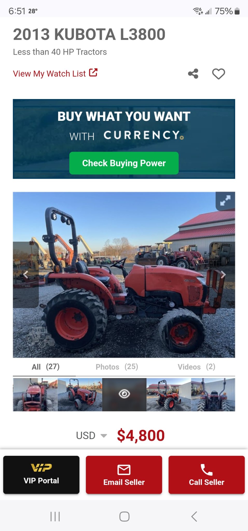

My L3800 is a 2013 also.
After seeing this someone posted mine is in showroom condition.
The owner beat the hell out of this one.
I'll remember to treat my top link with care.
lol. That one hit every branch on the way though the ugly tree. If in the exterior cosmetics are in that bad a shape, I’m thinking the rest of it might have had a rough life too.
