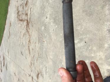

Judging from the picture, you must live in the southern hemisphere? :D
