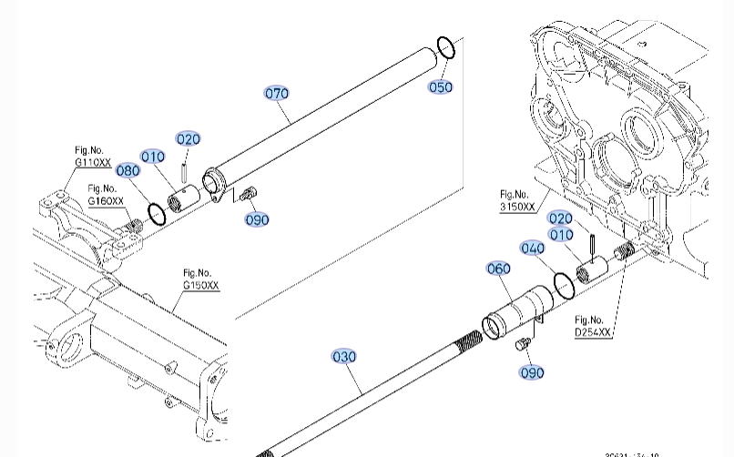

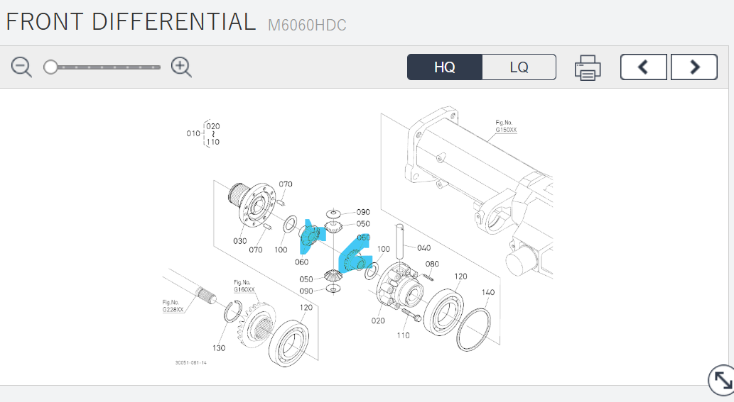

The differential is always engaged. You are engaging the driveshaft going to the differential. I dont know the specifics of an M6060 but thats typically a sliding mechanical clutch of some sort.
Go to Messicks website and lookup rhe online parts drawing for your tractor.

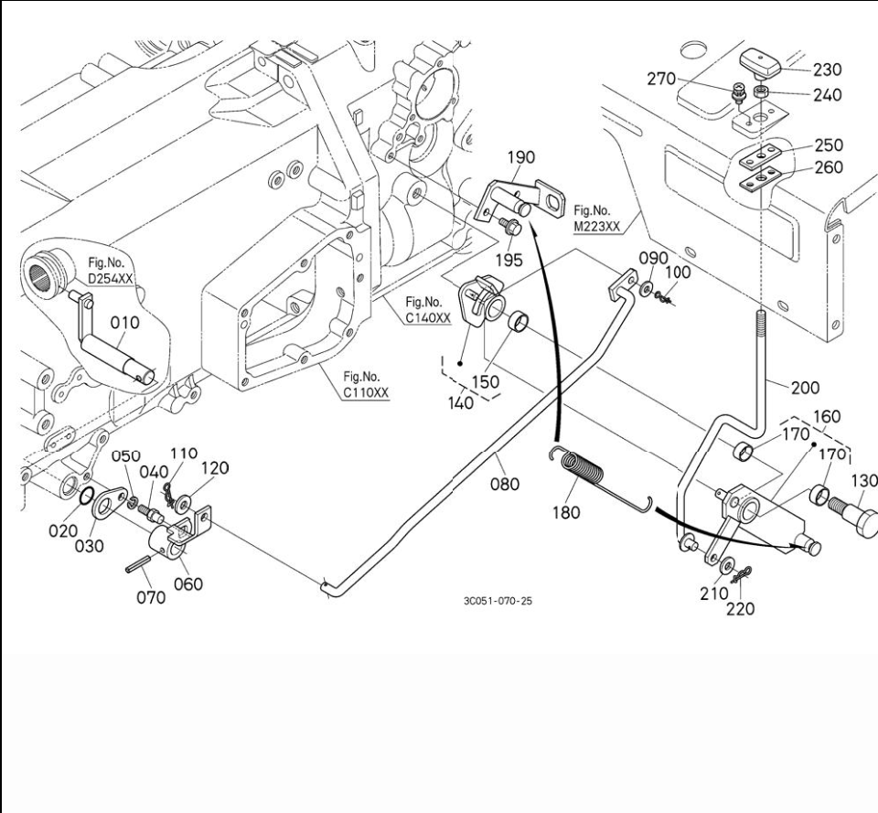

That would be an easy fix. Too bad it’s behind the fuel tank.
Exactly. Can't get my hands in there. Laid underneath and couldn't see anything disconnected. I just can't believe the pin would already be broken with so few hours, but on the other hand, I don't know how it was previously treated. I guess that should be the next spot to look. Seems easier than dropping the fuel tank.

If the 4wd lever doesn’t have any resistance, that’s where I would start. Probably just lost the cotter pin #220 and it came loose.
I would definitely try to see the linkage with a mirror or something before just dropping the tank. Dropping the tank isn’t too bad though.

Yeah I need to get my neighbor over to move the lever while I watch the linkage from underneath. If it was the linkage or even the driveshaft pin, would that cause the indicator light to not come on as well?
34,778
10,046
Linkage being disconnectted or maladjustted would make the indicator not come on.
The front coupling being bad would not effect the light.
