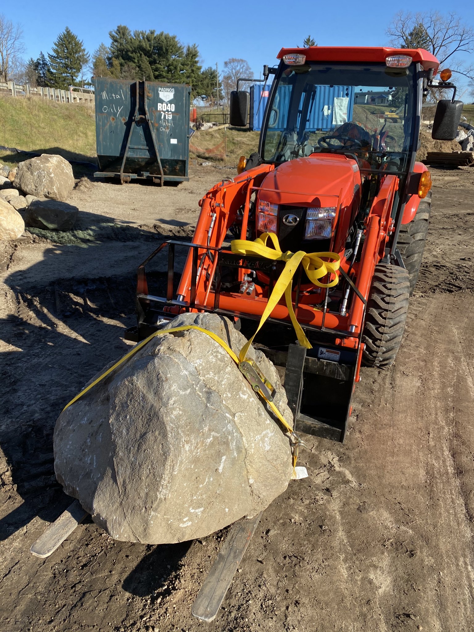

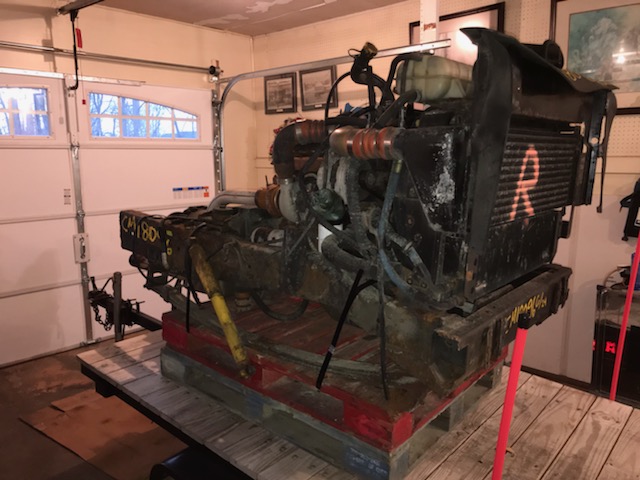

I have the GL4060 with 805 loader. Coming from the skidsteer world I thought it would lift more. It does what I want but if you want to be able to lift anything the 805 is not an adequate FEL (IMO).
lifted boulders ok.
But couldn’t lift this Cummins 4BT w/transmission off trailer.
lifted boulders ok.
That is actually somewhat hard to believe but an excellent reference. I clear about 1/2 an acre every winter to cleanup during the spring and I get some logs my 525 won't lift. I can sure scoot them anywhere I need to go though!
Internet says "Even the Cummins service manual gives a weight range due to the differences between various CPLs, showing the DRY weight of the 6BT as 855-905 LB"
I'd guess a transmission at another 400-500lb, so 1,300lb or thereabouts, which is 650kg? And you're not at the pins, it's bulky so you're pretty far ahead of the pins. You need a loader rated about 900-1000kg at the pins to lift that well. So MX or larger? Pretty much all tractors in the L size range are going to lift 700-900kg at the pins. The LA765 lifts 765kg at the pins, and lifts 573kg 500mm forward (to full height though). It can lift 783kg at 500mm forward, to 1500mm (aka 5 feet or thereabouts). So lifting 650kg at probably 800mm forward, and probably off a truck or similar so a bit higher than 1500mm....you're a bit beyond it's capacity.
