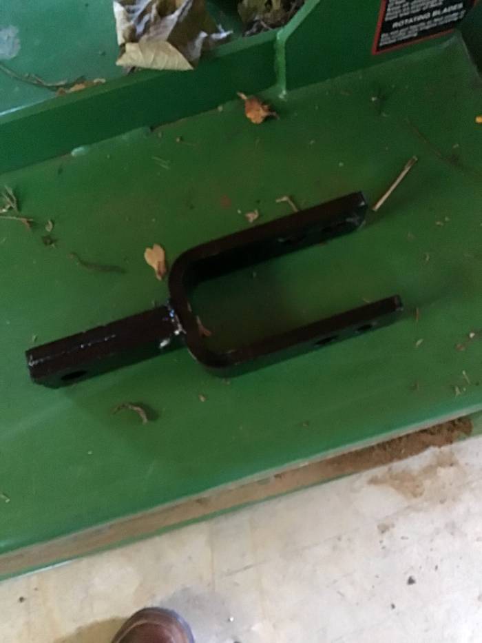

No more messing with lift arms and levelling. Some messing with top hook location or replacing it with a U adaptor. Replaced HF top hook with one from Amazon because of not enough clearance to hook up to the bush hog, common problem with HF one. Used Ken's boltonhooks site to get pins to replace top hook bolts.

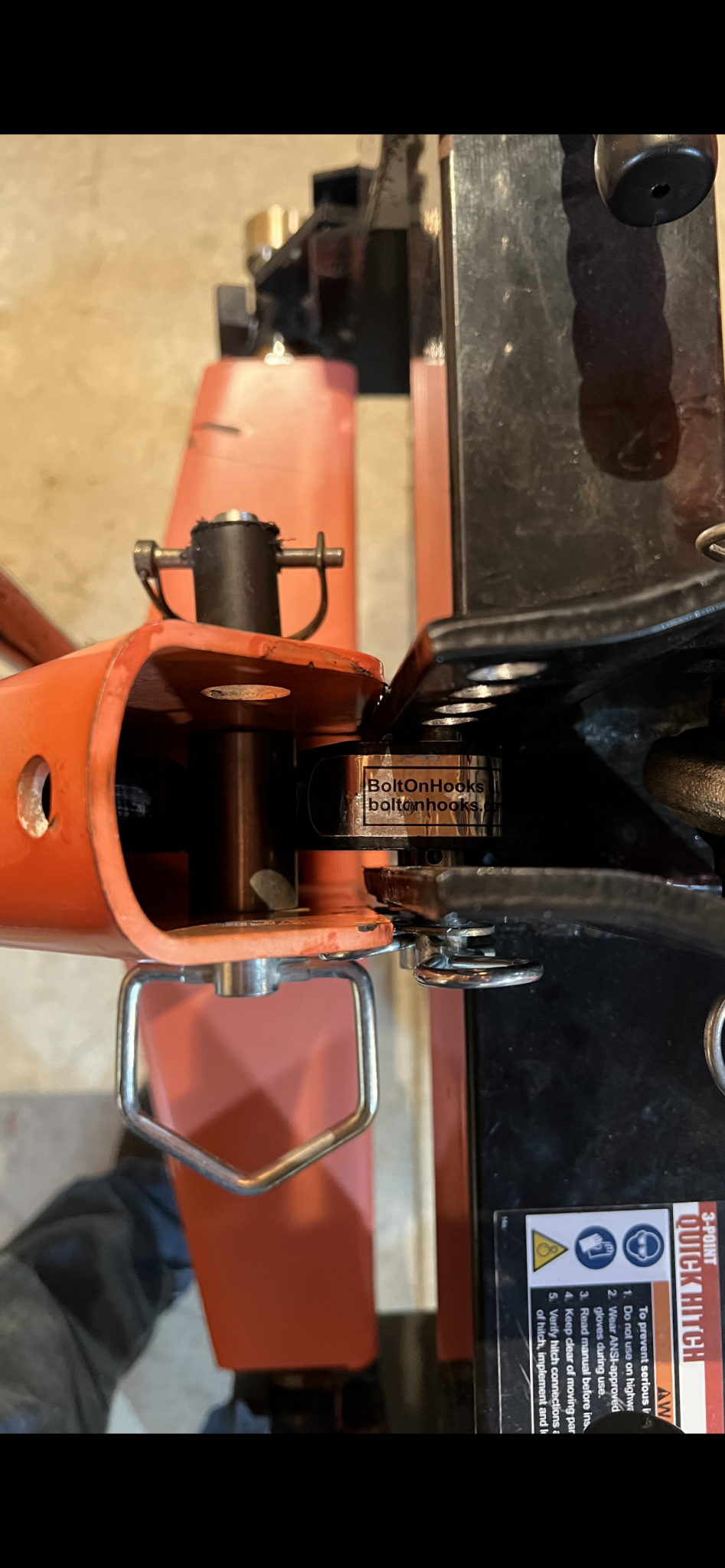

More money but if you compare the Meat around the holes you might think it is worth it.. I did! Click on it and scroll down.
Mine

Think this one will work: Amazon.com: osemar Top Hook Fit for Harbor Freight Quick Hitch Cat 1 : Patio, Lawn & Garden
All it does is set the holes out about 1/2 inch, just enough to clear stuff in the way on most bush hogs.
I have to use the U adaptor (picture above) on my back blade, and it may actually work on the other implements if I keep the top link shortened, e.g. QH cocked towards the tractor on top. May not be short enough for the bush hog though. Of course, you have to get off and manipulate the rock shaft control to line up the holes in the U adaptor with the pin holes on the implement. No big deal. Still lots easier than going through getting the arms attached and then levelling the implement, etc.

So I have another question . I have a L3301 with LP rear blade & box scraper & a Lorenz 3 pt snowblower . will I need to also get the U-adapter like Ralph mentioned above ? .I;s all new to this tractor with a 3 pt stuff , All I've had before were Case 580's , so I'm learning al over .
