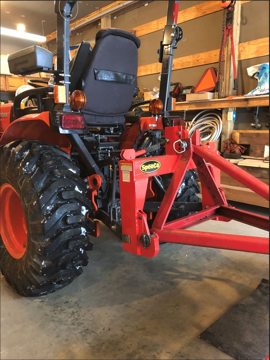

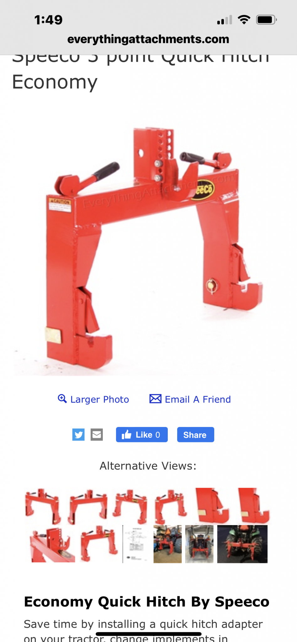

I just started using a new Speeco E-hitch and really like it thus far. It even connected to a very old 8N rear blade. Best part is that you do not need bushings. Top hook is adjustable and it has the longer hook. I'd recommend checking one out before you pull the trigger in the HF or any other brand for that matter.
Mine came from EA as they had the best price that I could find at $300 shipping included.

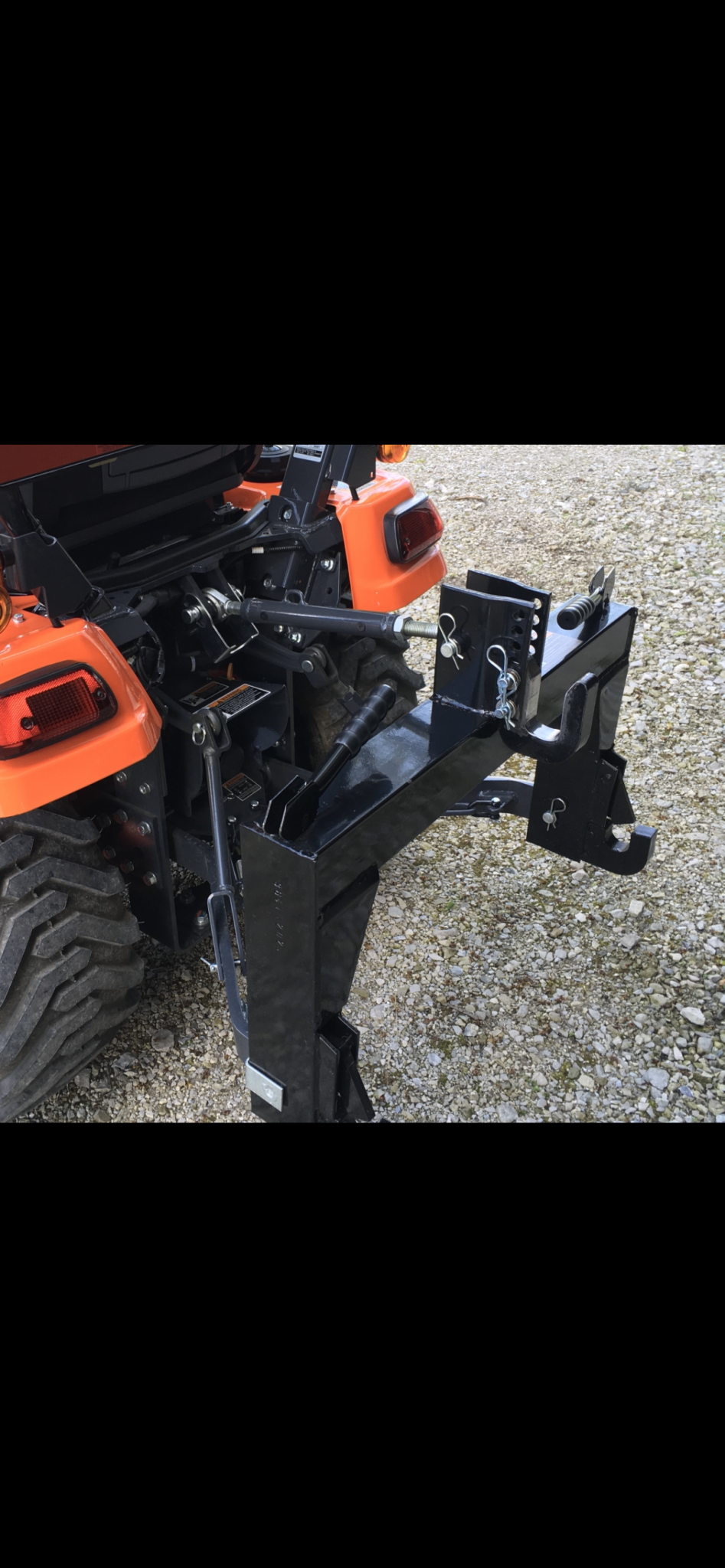

This does look like the HF QH with the extended hook and updated lower hooks to fit without bushings. I did buy the extended hook separately and had to buy the mushroom type bushings for one implement. After reading it on here I was able to save some $ by simply just buying the bushings & pins which would have worked on the first implement!
I probably have a total of $180+ in it but was able to pick up from local HF.
Also the hook in my photo is the original HF that I cut excess out of.. I have the extended version now and works great!

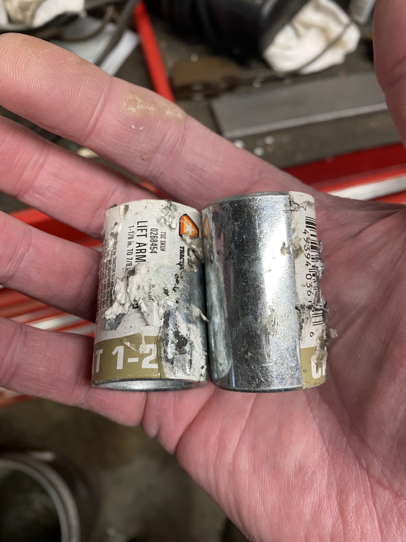

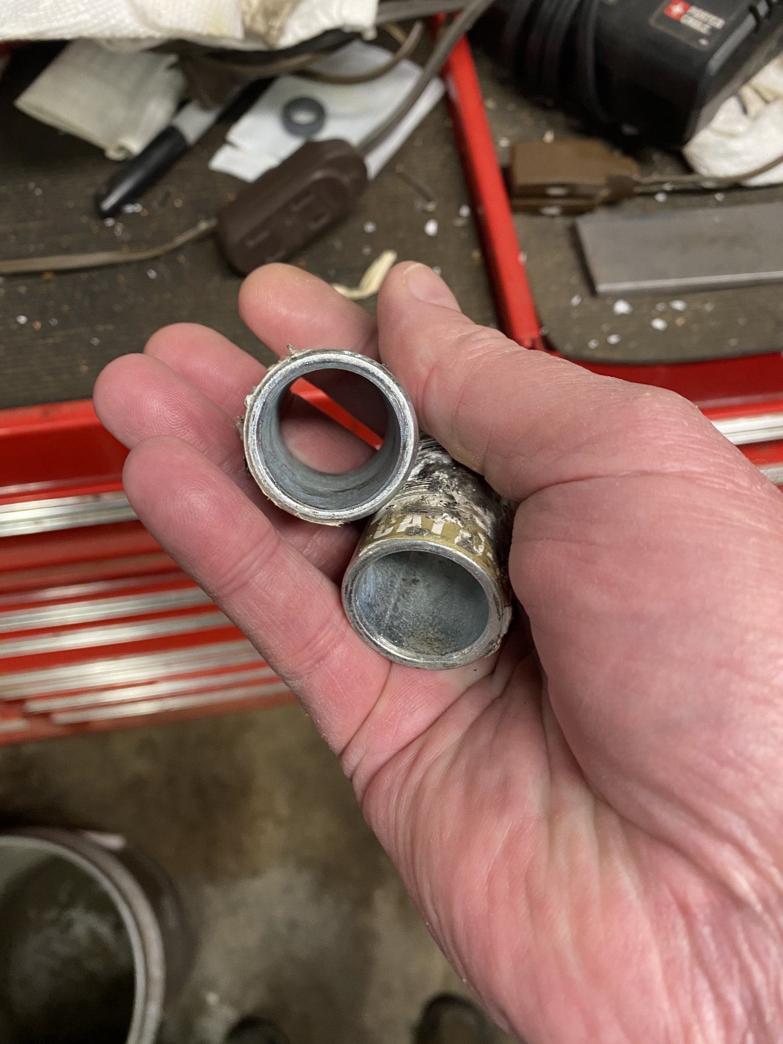

RalphVa mentioned the Cat 1-2 bushings from TSC.
I took 2 off my back blade lift pins the other day.
I also have some Cat 2-3 bushings that would slide over those also.
Note: the top link and lift pins are different sizes. Should I easy to cut to length if you had DOM of similar dimension.

Jay - - I've found that except for the box blade (heavy ground-engaging), I don't need bushings. I don't have a bushing on the top link of the BB either.
The pic I posted earlier was taking them off the back blade since I don't need them.

Exactly my deal.. don't really need the bushings but thought it may be quieter and less wear with them. Those bottom hooks on the HF are so thick I shaved a little off the outside rear of them to make more clearance for my box blade..
Never comes off.. no need!
