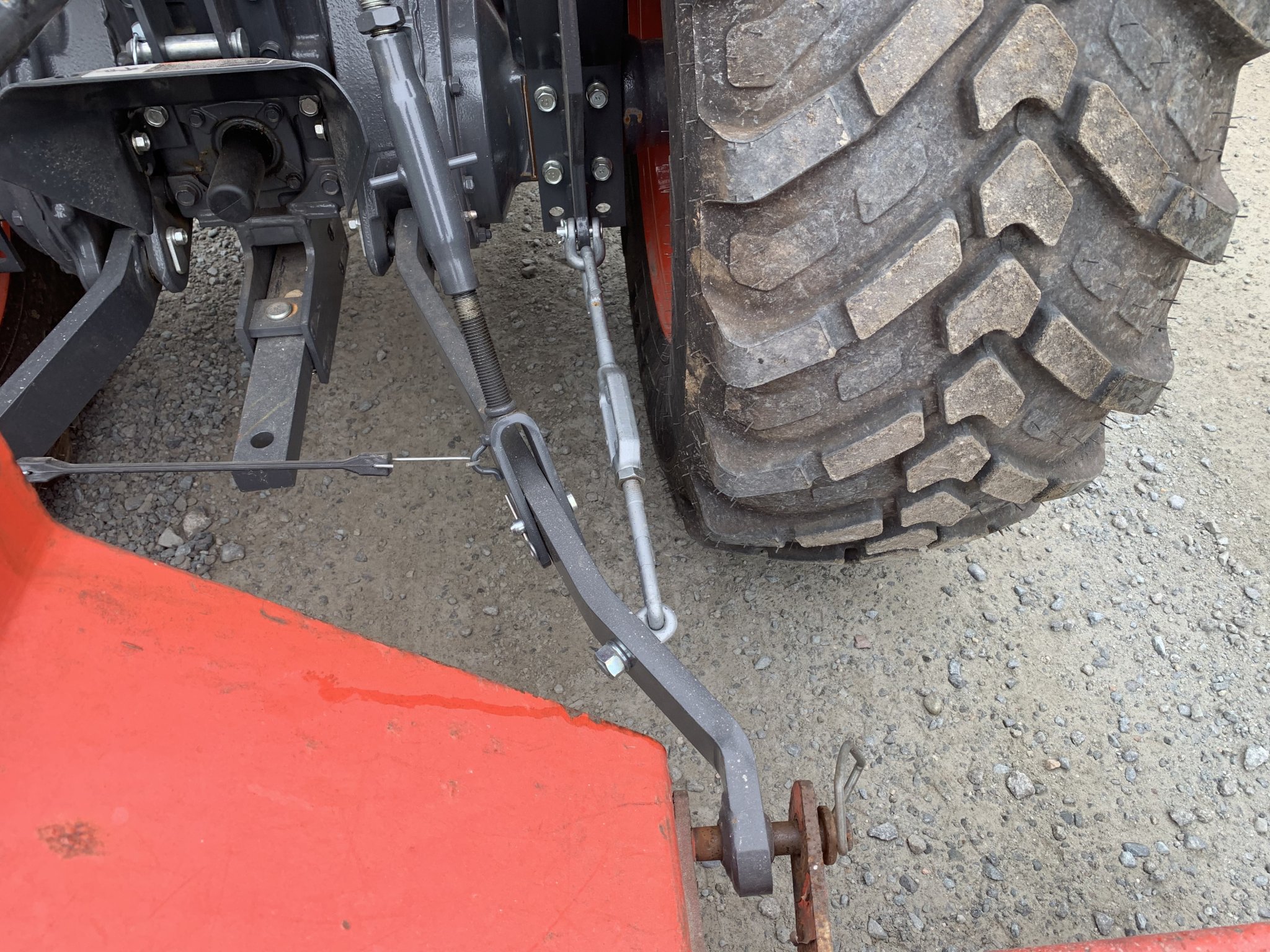

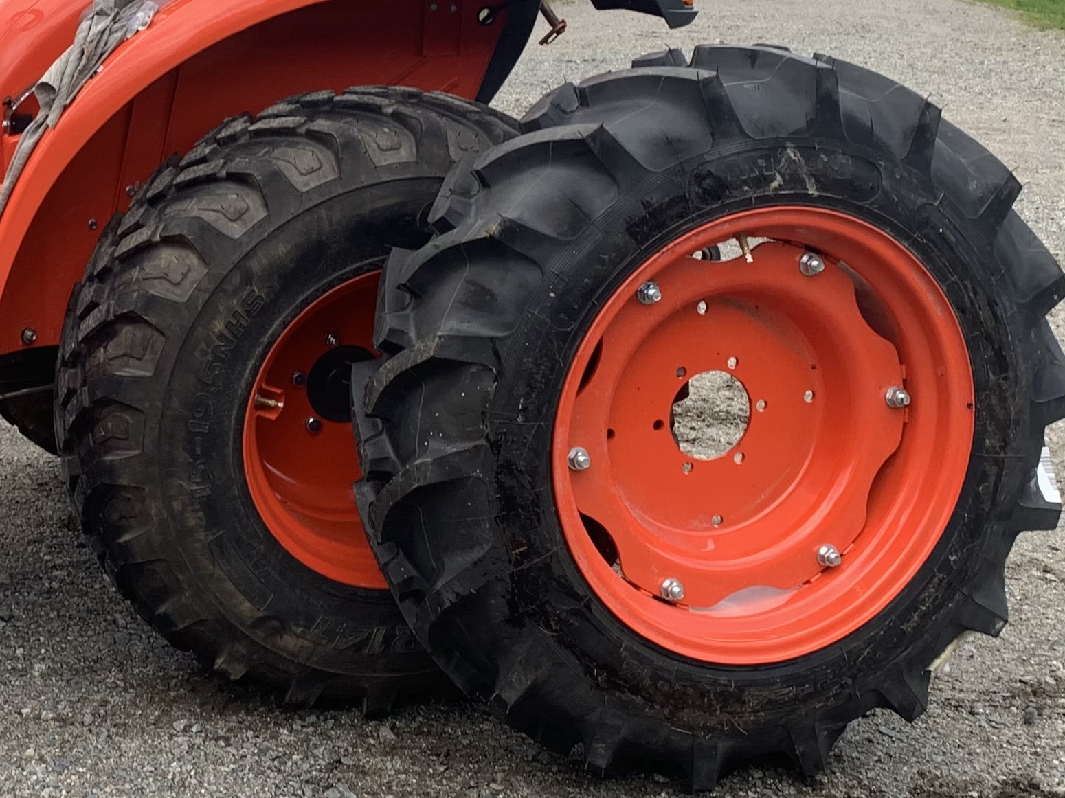

I don’t currently own any implements that attach to a drawbar, nor do I own a drawbar. My implements attach to the sway bars, on 3-point hitch, with the R-14 tires, these sway bars had to centered or very close, otherwise the tensioning turnbuckle would rub on the tires and not allow to offset a rear implement, box blade in my case.
I now have R-1 (Ag) tires, thanks to Ron at Halifax Kubota. If you plan on putting implements on the back of your tractor R-1 Tires is the only way to go. Works for Farmers! 2EC08B6F-FFF4-4248-AE28-509594B6051A.jpeg 1A31AEFD-AA0F-4FF9-B356-1ADA5012969A.jpeg
I now have R-1 (Ag) tires, thanks to Ron at Halifax Kubota. If you plan on putting implements on the back of your tractor R-1 Tires is the only way to go. Works for Farmers! View attachment 93562 View attachment 93561
All implements I have used on my MX work very well with my R4 tires.
Agreed…only issue I have with implements is backho subframe in the way (only on narrow cat 1 stuff that the QH doesn’t mate to). tires have not been an issue.

I guess the rest of us should sell all our attachments. :D
My point was, if the primary use of tractor is attachments on the 3-point hitch, than yes, R-1 tires, due to the width, allow for the most adjustment of the attachments. If buying a new tractor I would like to know this, so I can make an informed decision. If your doing more fel work then, yes, a wider/ stronger ( more plys ?) tire may be best for you?
As far as your attachments, I’d hang on to them. Just my opinion.
True that R1s give you more width if you aren't using a Quick Hitch. However, if you are using a Quick Hitch with compatible implements, you are limited by the Quick Hitch width. Once the Quick Hitch is installed, width is fixed.
I think a lot of us have pointed out that we use our 3ph implements with R4 tires and have no issues. In fact I’ve never heard of this issue before. I used to have a small JD tractor about the size of a Kubota B series and R4 tires. I never had that issue with the smaller tractor either.
