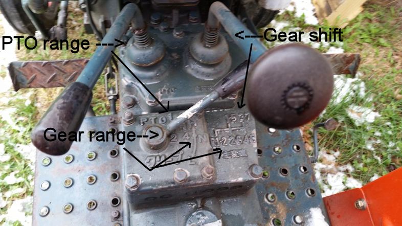

tks wolf...all the numbers had me confused since I haven't had a need to use the PTO yet...so what you are saying is the upper left shifter only purpose is to put the PTO in/out of gear while the lower left puts the PTO in either Hi/Lo range or neutral. And obviously the right shifter is for the tractor transmission...I really appreciate your help....and I just ordered the RPM meter ;)

I actually misstated the levers in the last post.
It's top right lever is PTO gear range 1-4 (H pattern listed below it) for PTO speed select
Top right Gear range R-1-4 and R2-5-8 (Pattern listed below it), for movement speed select
Lower right lever is transmission gear range H-N-L (pattern to the right of it) for movement range select

And to clarify some statements more fully
PTO has 4 speeds
Engine speed has to be set to some RPM to achieve the speed set by the selection of PTO gear
On my tractor and I assume yours there is a mark on the tachometer labeled PTO
On my tractor put PTO selector in #1, set throttle to achieve rpm and pto rotates at 540 RPM
Then select gear for transmission to achieve the appropriate ground speed

To add a little more clarification. The hi/low shifter on top of the transmission is actually for creeper gears. Travel speed can be measured in feet per hour when in low range. :D when used with the other hi/low speed selector to the left of the seat it gives you 16 forward speeds, and 4 reverse speeds. :D

Should not be creeper on this model, it should be truly a high low, I think I remember them adding another box (shift lever) behind this one when they want creeper out of that model. ;)
I'll have to dig out the parts book for it tonight :p

there is another lever just to left of the seat...guy I bought it from said it was for a "super" low crawler gear if you needed some extra pulling power?!?!?

You will have to experiment with the two hi/low levers. On my l1501 which is your models little sister, the lever to the left of the seat is a normal Hi/Low range lever. Then the lever on top of the transmission is for creeper mode. Which gives a whole new meaning of low gear :D When both levers are in low, then put the tractor in first, it took my tractor about 5 minutes or so to get it out of the garage :D
