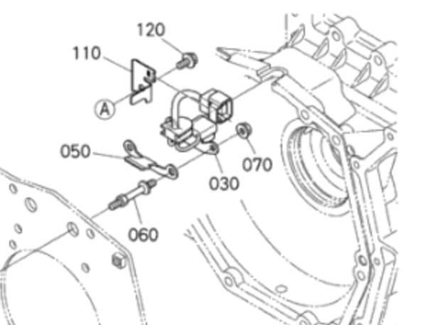

According to a diagram from
This is the pickup coil - right? PN: EG673-67870
They actually DID bury this sensor inside a bell housing! Unbelievable!
Yes, that's the one and yes they did. The shop manual shows the removal of the undercarriage and separation of the engine from transaxle to service it. There might be guys out there who have had luck taking shortcuts splitting these apart but I typically don't do shortcuts on my 1st rodeo.

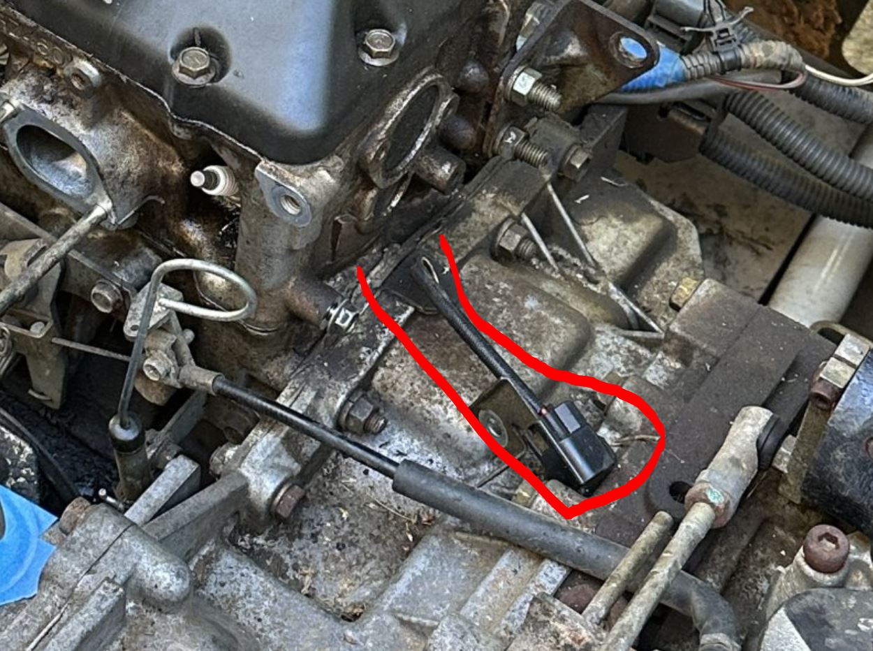

BTW, I have not worked on this unit since my last post. It's not over, just delayed. I have a priority project that needed attention.
I still have not tested/ruled out the reluctor pick-up on the crank. As it stands right now, I'm guessing the crank shaft key is tweaked. I'll probably just invest the time to tear it all apart and check it while reinstalling it with necessary components for MicroSquirt ECM, unless it is obviously the crankshaft key. In which case, I'll simply repair and reassemble it.
