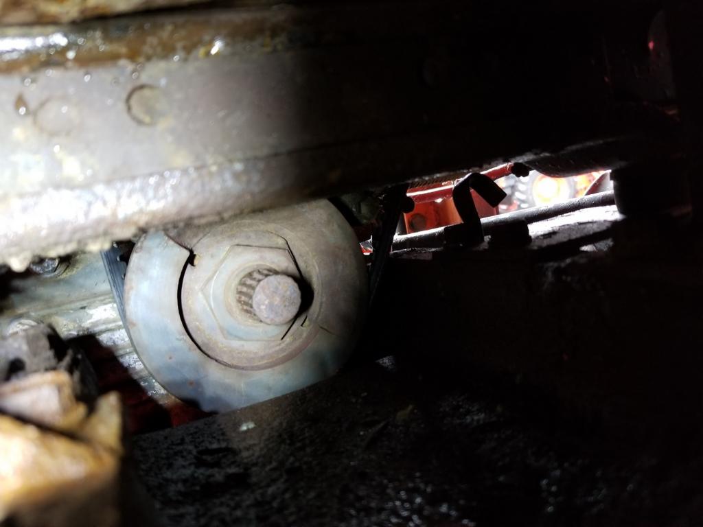

Bringing this thread back to life compliments of the search engine....
Pic's tell the story:
Splines (18) worn smooth on the coupler that goes over the crank shaft protruding out the front of the L245DT.
Trying to find the replacement coupler (18 spline) and repair this one.

fj40dave
Sep 24, 2009
425
257
Yelm, WA
I found this on ebay - I am not sure if that would help make the repair. (It appears that this is the wrong diameter)
https://www.ebay.com/itm/John-Deere-Axle-Shaft-Coupler-Part-WN-H165510-4-Long-18-Spline-for-Combines-/253544361706
That one is really close....the inside diameter on the one I have is 1" and I see the JD one is just a bit over that.
I Googled "18 Spline Pulley" and am sifting through the results looking for a 1" inside diameter that I can adapt (ie: cut away the pulley portion, and have some center stock to replace the one I have).
I called the Sparex company, and they are wholesale to suppliers like NAPA and The Tractor Supply Company. Turns out.....that coupler would be well over $100 retail!!!
