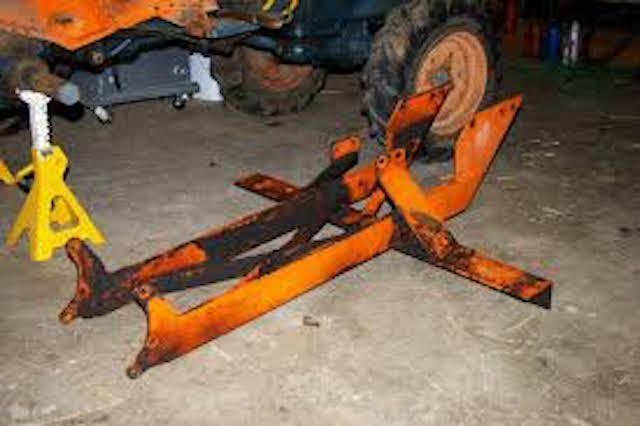

For anyone fabbing up a loader frame, probably the most important part is the bar that goes back to the rear axle from the loader tower base. That is what keeps it all from turning into a scrap pile.

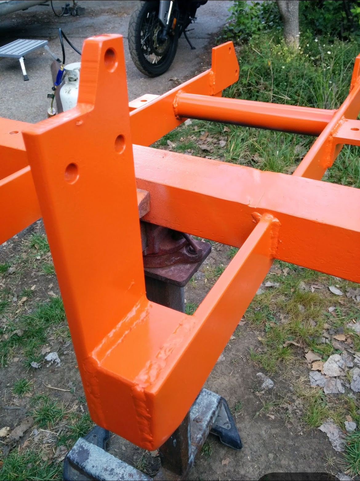

Have you seen the photos Lil Foot has of the subframe he built? These pic's will explain it like a picture menu at McDonalds! :LOL:
Correction: That pic is the stock factory subframe. I did not build it. Wish I had. :)

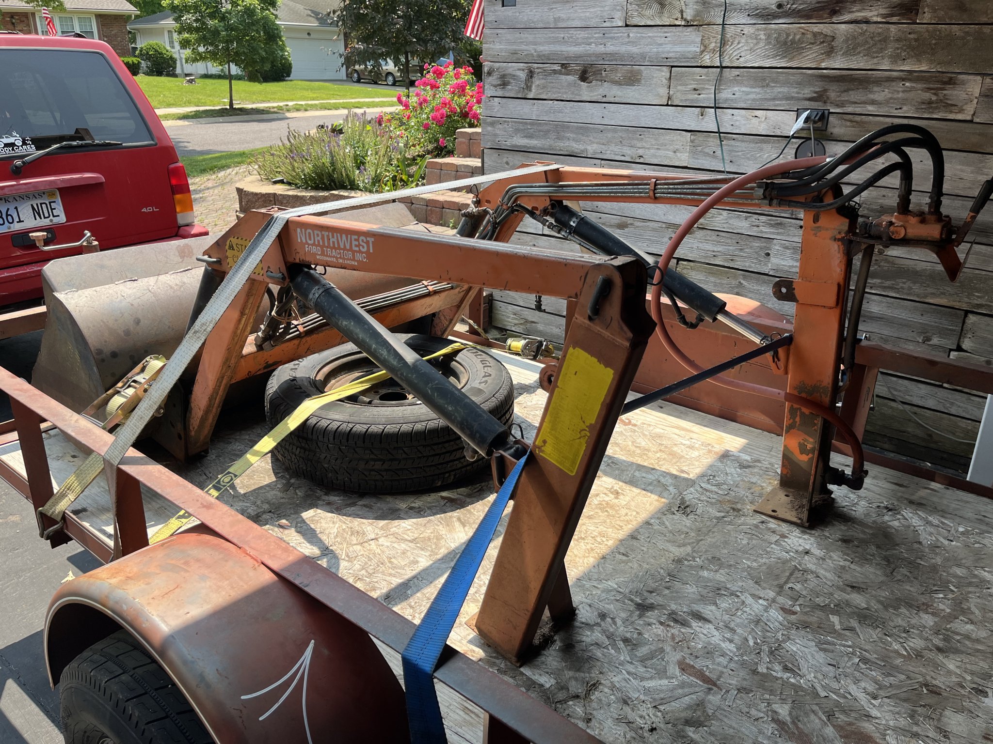

Did I remember to send you pictures of the loader that 1980 sent to me? If I did, sorry for the duplicates.

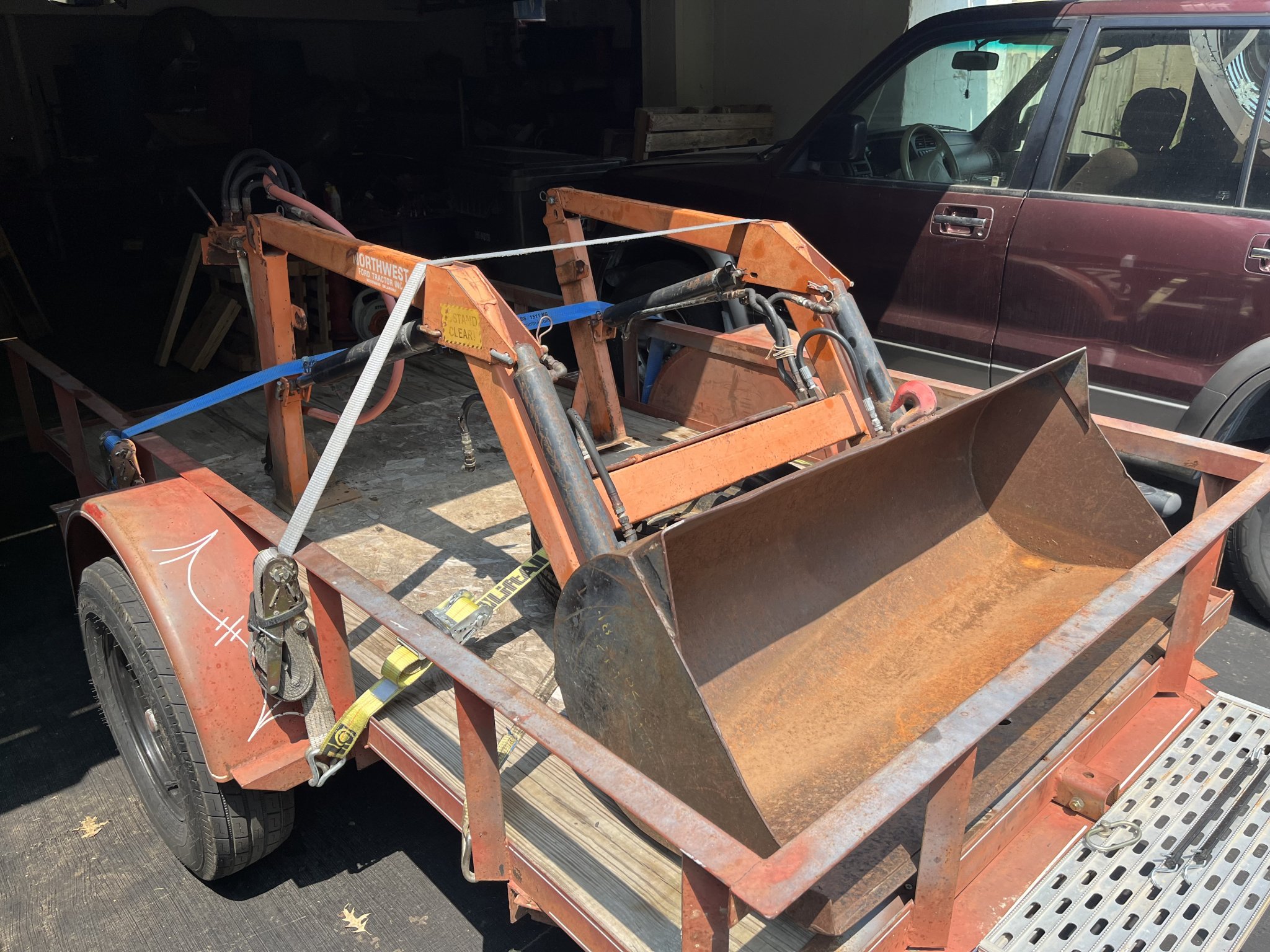

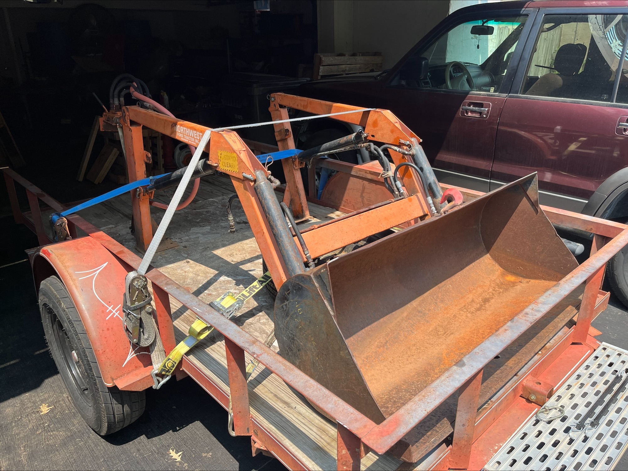

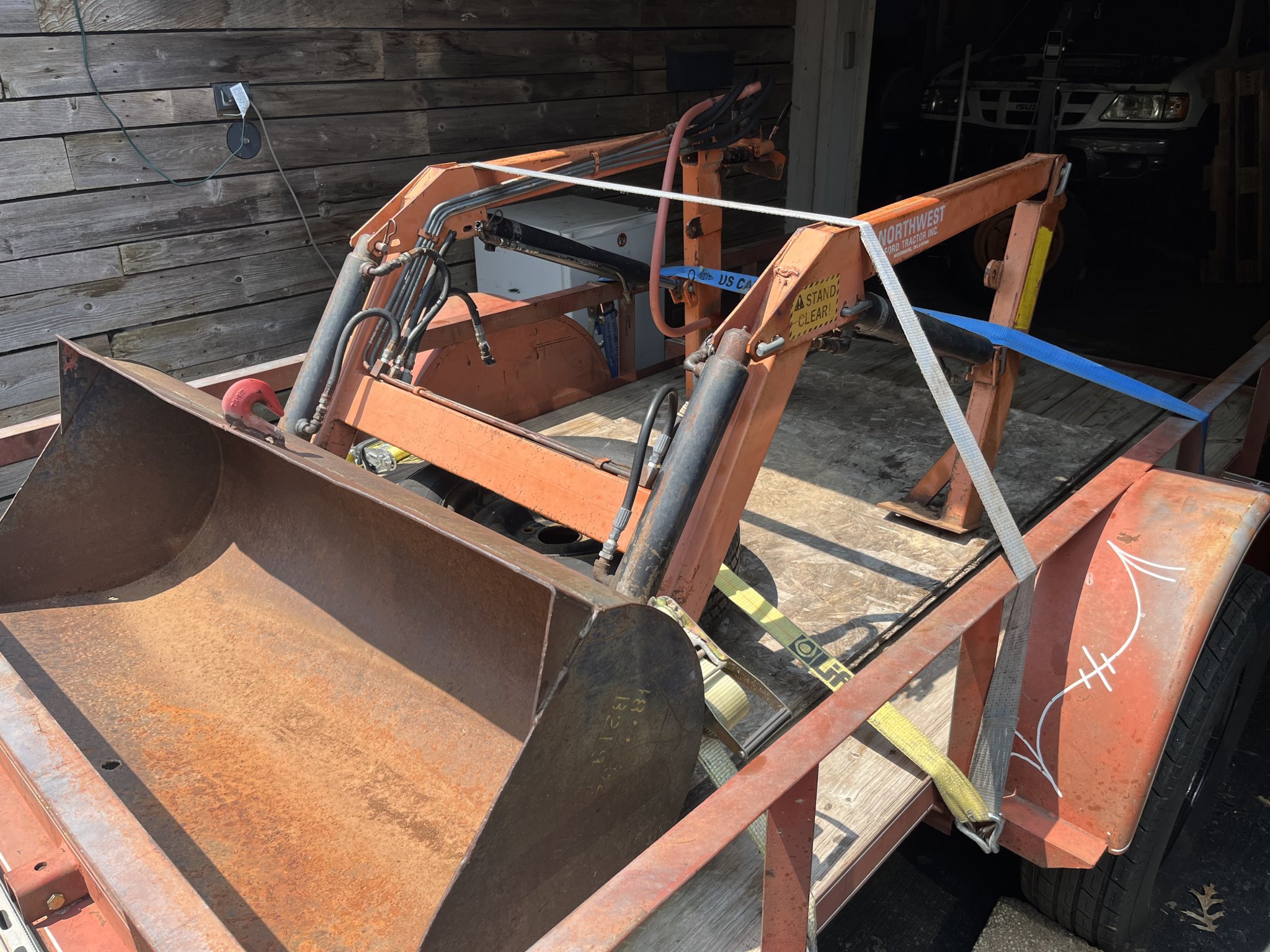

Found a real nice shape Kubota B219 loader in Oklahoma. Brought it home yesterday. Will build a subframe and re-hose the loader with a pressure gauge and return filter as well. The front spline drive for the pump is in great shape. I found a vendor for the drive attachment and pump. Will also be replacing the 2 lever system with a single 2 spool joy stick for easier operation. Things are looking up around here. 👍
