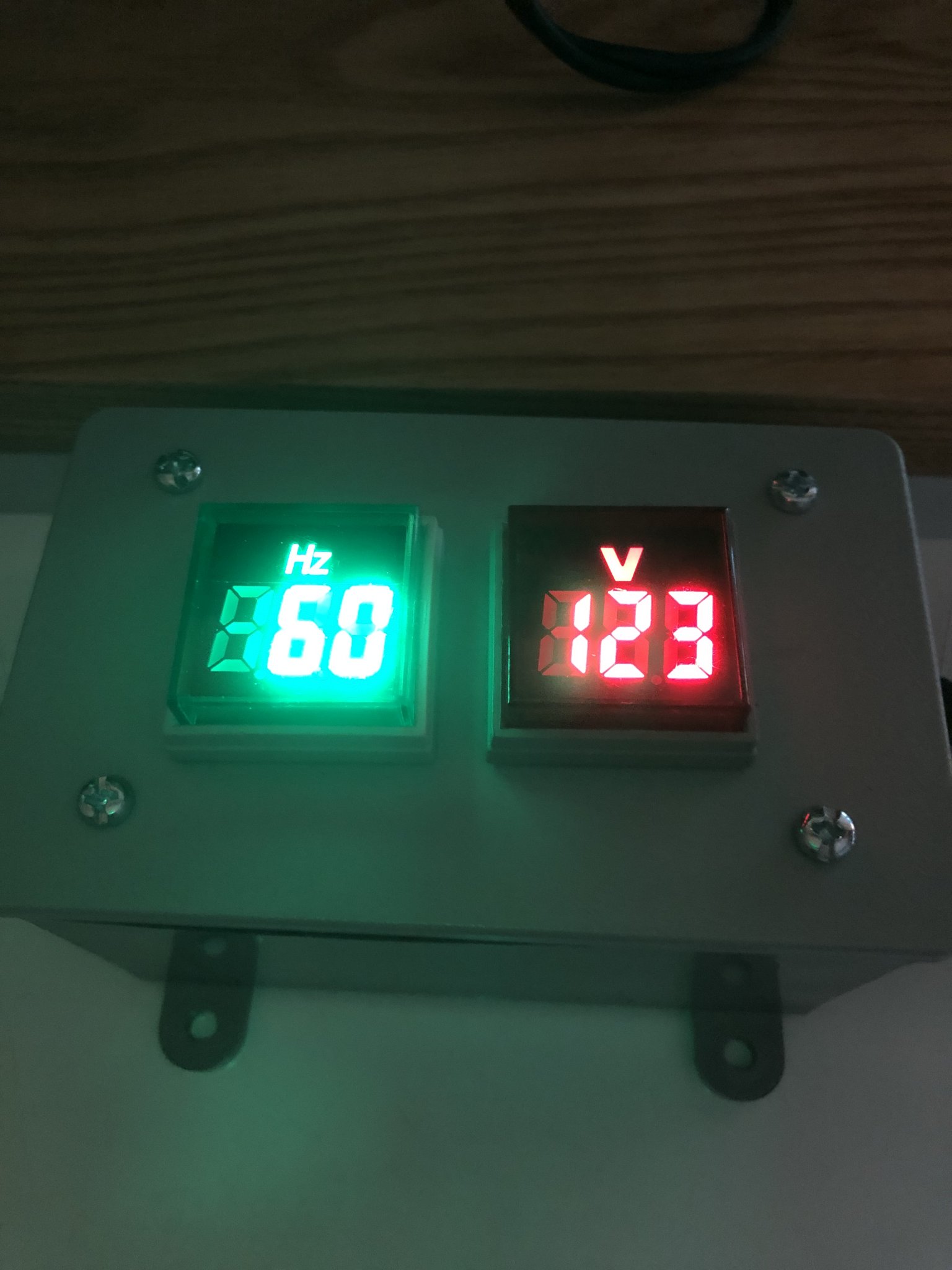

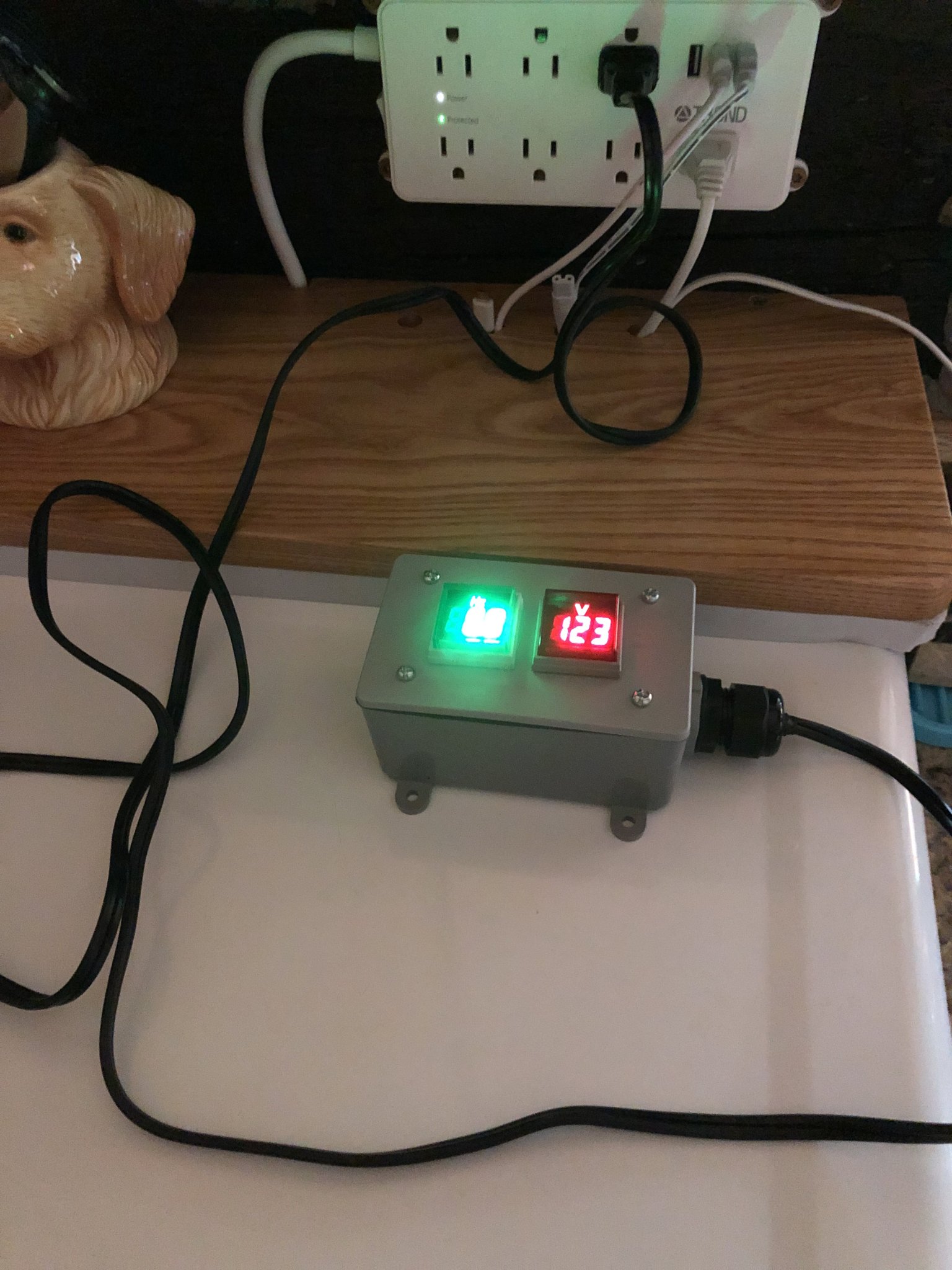

Bought some meters to better monitor the pto generator’s power. With a few extra to make this box for about $20. Can plug into any receptacle, generator or house. Always nice to monitor generator power especially when loading is changing.
Admiring my work by the TV. Wife says it’s too bright to stay unless we are on emergency power. Already have voltage meter in Kitchen.
Hertz is right on and voltage is 0.3-0.4 high compared to my Fluke.
Numbers are sharper than in photos.

That's pretty neat. Now tell US how to do it !
Smokeydog
Jun 2, 2020
757
728
knoxville, Tennessee
Pretty simple if I can do it. PVC weather proof box and solid cover. Drill two 7/8” (22mm) holes. Polarized plug, Power to X1 terminals, neutral to X2. Meters only have two terminals. Strain relief clamp for cord.
Same meters going on the generator.

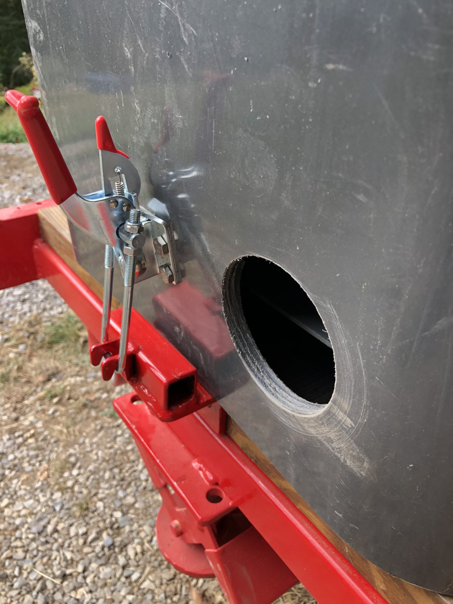

1.5” vent holes around the top. Rotatable prop for the lid for extra ventilation. Added an extra band of “can” material to the bottom for strength. Clamps and steel plate sandwiches the two layers.

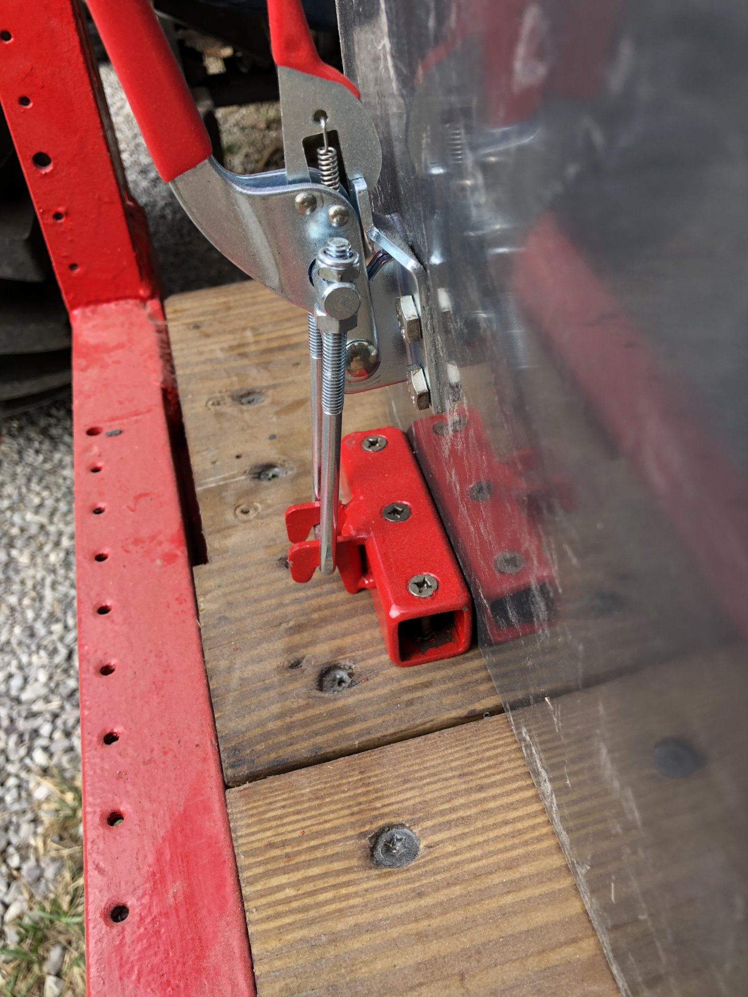

Added blocks and 2,000# locking cam clamps securely attaching the cover to the deck.
Large hole for 50amp plug. Cover easy to remove or install.
Magnetic contact thermometer on alternator to monitor temps.

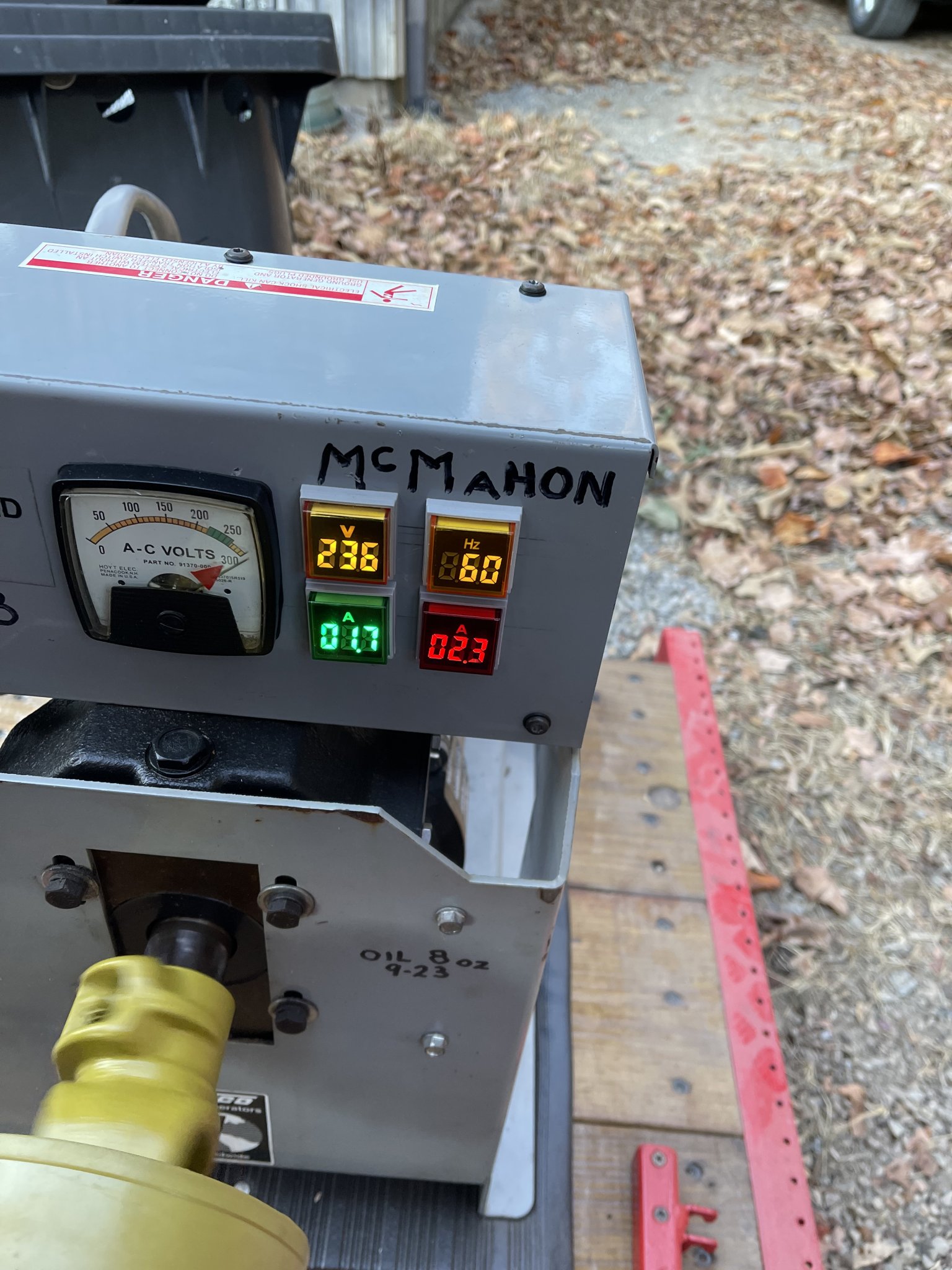

Installed new gauges. They worked great. Liked being able to monitor voltage and hertz at the generator and inside the house.
Four hour house load test.
Cover still needs some work to improve ventilation. Monitored temperatures with both contact and non contact thermometers. Removed cover after two hours.
Power steady even with varying loading by turning major appliances on. Impressive!!!
View attachment 115478 View attachment 115479

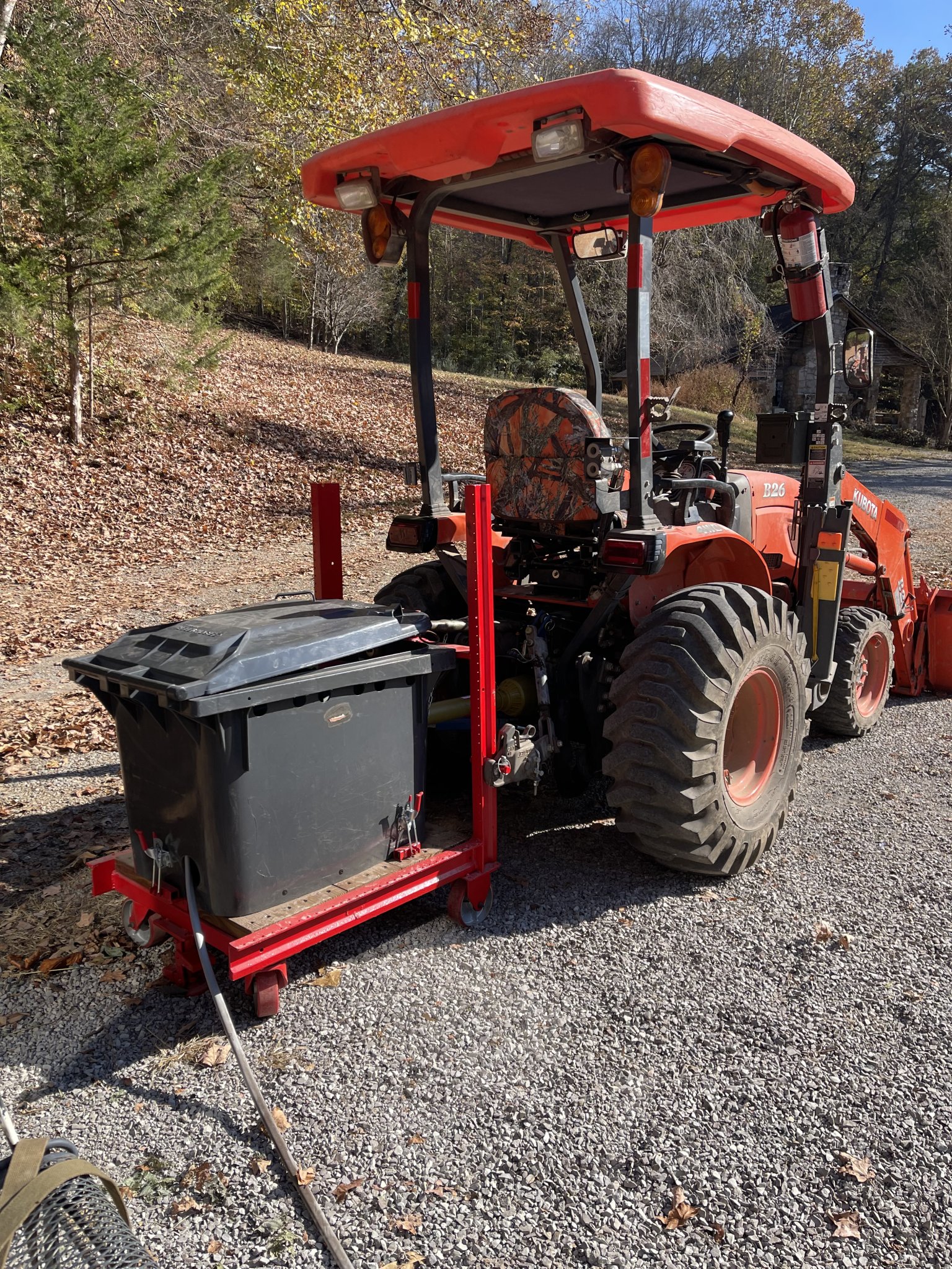

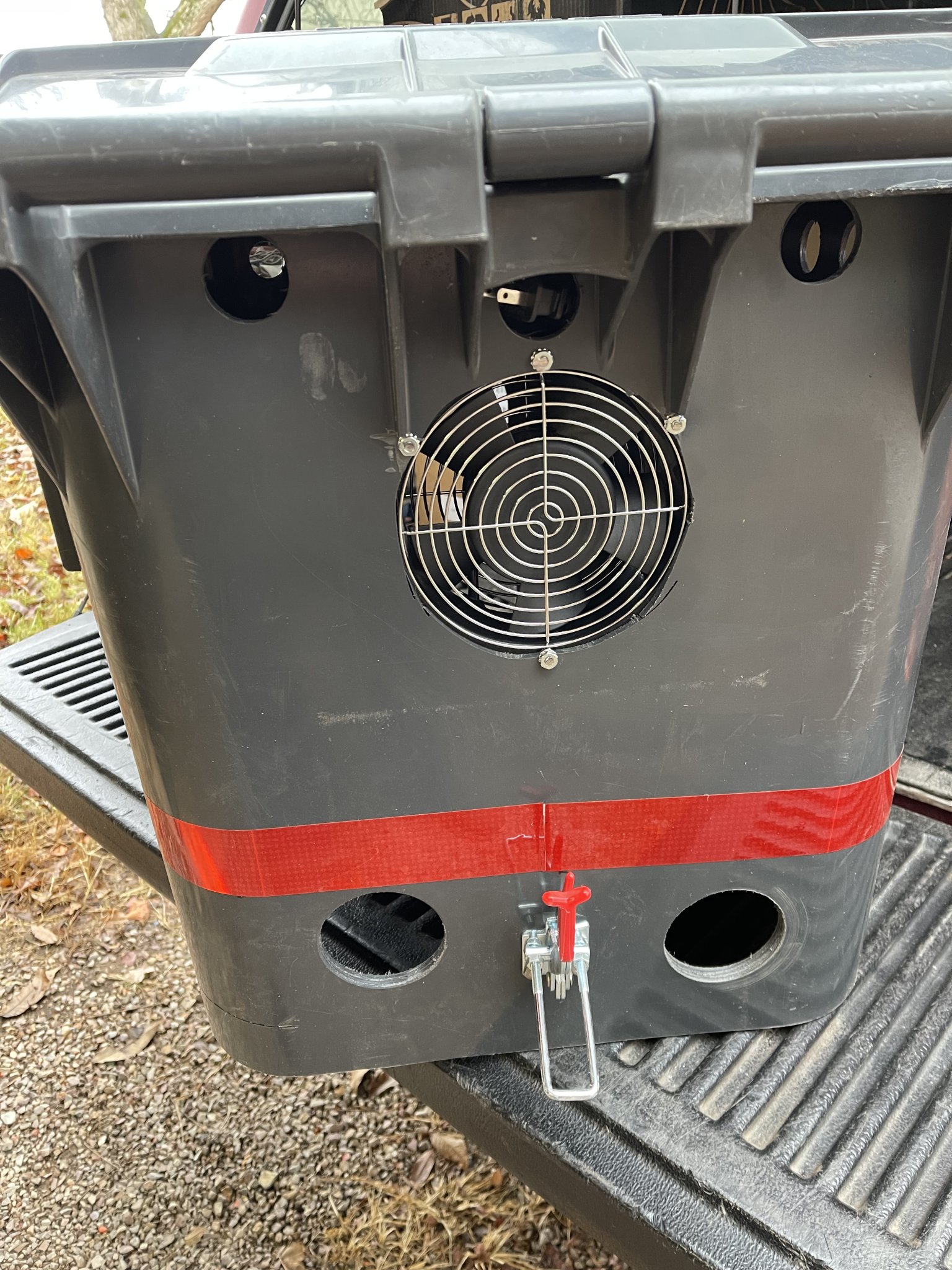

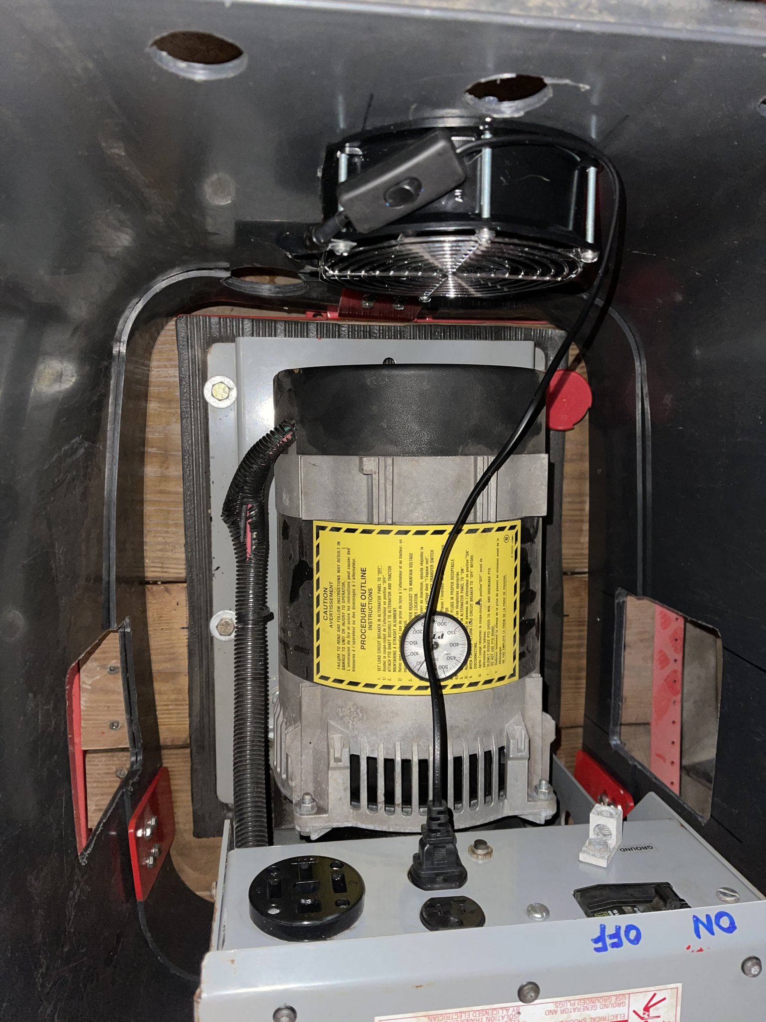

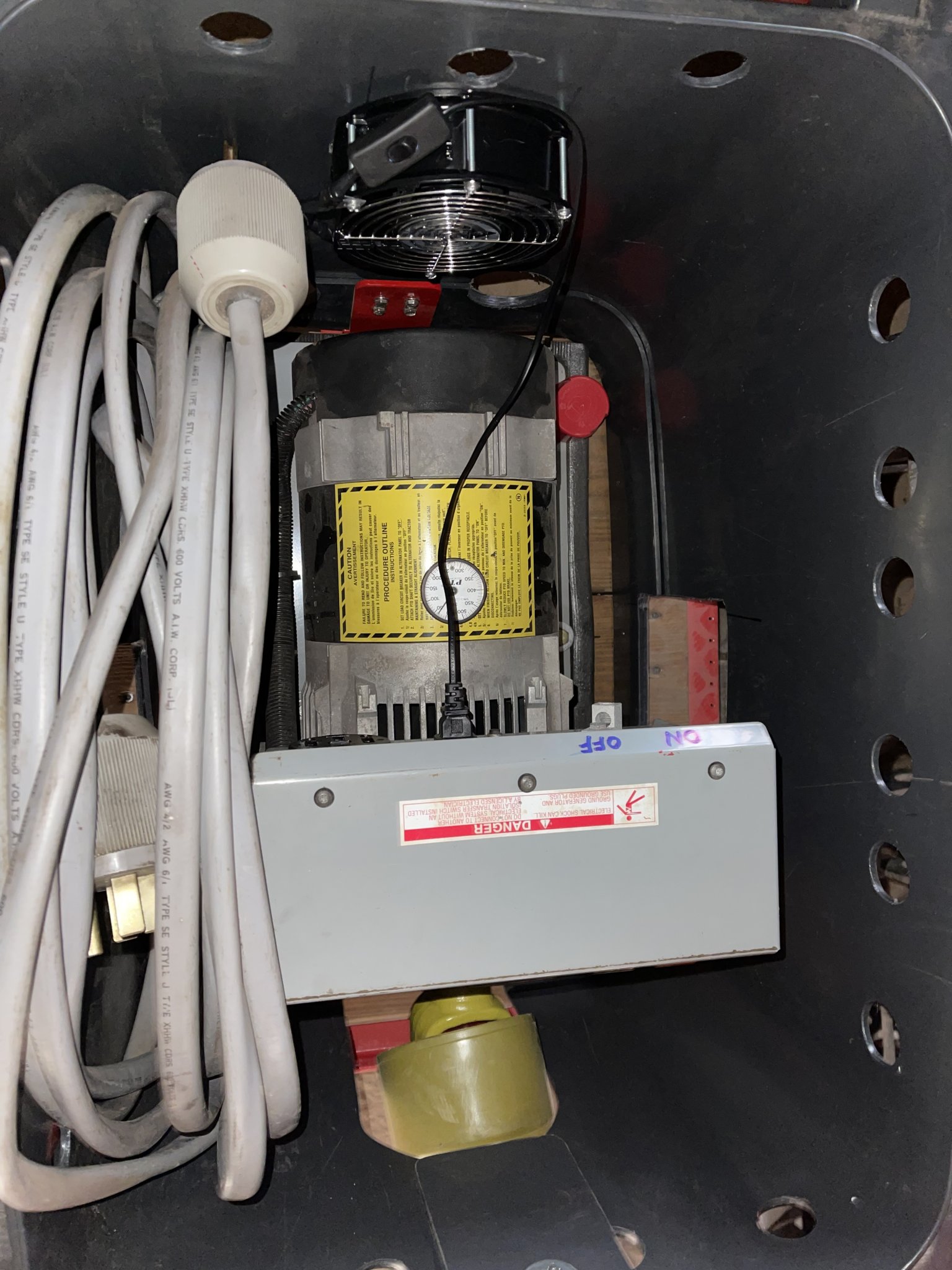

Final modifications as family time approaches.

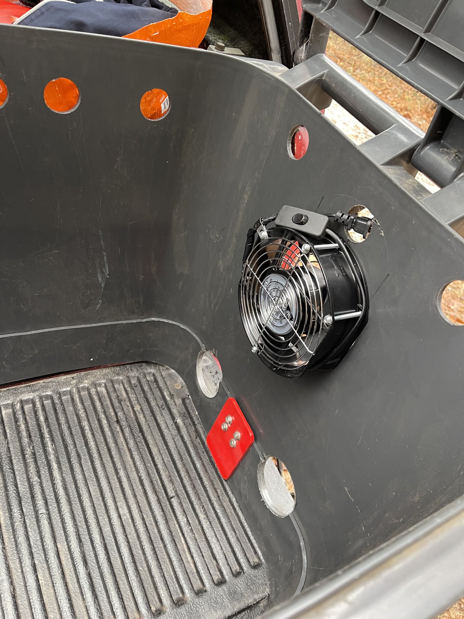

Cut 7” square openings on the sides where the fan cooled alternator blows to discharge warm air.
Installed 345cfm rugged fan on the back directly blowing on the alternator and gearbox. 40 watts, ball bearings, metal housing and guards. GDSTIME Axial Fan 17251, 110V 120V AC 172mm x 150mm x 51mm Dual Ball Bearing High Speed for DIY Cooling Ventilation Exhaust Projects https://a.co/d/5NUKNI5
Probably don’t need fan for temperatures <70F but easy enough add. The way the lid is made have nice overhang for rain protection.
Ready for all weathers.
The trash container makes for sturdy, nearly indestructible, lightweight, easy access cover. Providing protection during use and storage. Preferred by bears like me 9 to 1.
View attachment 116648 View attachment 116649 View attachment 116651 View attachment 116652
