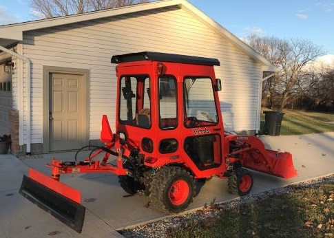

Bought my BX2370 about 3 years ago and have enjoyed everything about it except one thing: you freeze your backside off while plowing snow. I don't recall it being this cold when we plowed snow as kids 40 some years ago.
So, silly me, I think I'll just buy an aftermarket cab, how much could that cost? Well, after the wife finished with the CPR and defibrillator, I decides I'm not going to take out a second mortgage on the house and I'm going to build my own cab. After all, how hard could it be?
So, I surf the internet looking for ideas on DIY or home made tractor cabs. Some looked to be really well thought out and some, well, lets just say while they may have been functional their looks left a lot to be desired. Right then is when I thought that if I was going to fabri-cobble a cab for this tractor, I was going to make something that looked like it belonged there. I wanted to maintain my ROPS, have good visibility, aesthetically pleasing, easily removable, access to hood latch, not create any new holes in the tractor and be built with tools I had on hand.
Using my newly found intranet ideas (tinkerwitheverything, tcrote and Chim from here really stood out, thanks for posting gentlemen) along with my own spin on things, the little wheels upstairs were turning and I set out to mock this build up with materials I had on hand to see if things would work out in real life like they did in my head. You also need to know that I have access to AutoCAD Inventor at work and would model things up during lunch when I could. I'm on about the 4th or 5th iteration for the as built. Some things were easily modeled and worked out first on the computer. And, some were easier for me to cobble together in the garage then create the model afterwards.
I've learned you really do like your tractor porn around here and hope you're not disappointed. I'll try to attach a couple pictures of the completed cab for your enjoyment. For those of you interested, I worked on this off and on for the last 3 years. I have lost track of how many hours I have invested in this but, it has been a labor of love. I've learned a lot from this build and will post updates from time to time so you can experience the journey as well.

Nice Cab. Wish I had a hard cab. But, I'll put still up with my soft cab in the winter. At least it keeps the wind and blowing snow out.

Thanks and stay warm up there. Used to drive a soft top Jeep many years ago. I remembered how bad the plastic windows would look after a couple years is the reason I went hard cab & glass.

Nojacket, those are cheapo Amazon golf cart mirrors. They're bolted into the square tubing door frame. I have less than 2 hours run time since I installed the cab last month. So far, no trouble with them vibrating out of position.

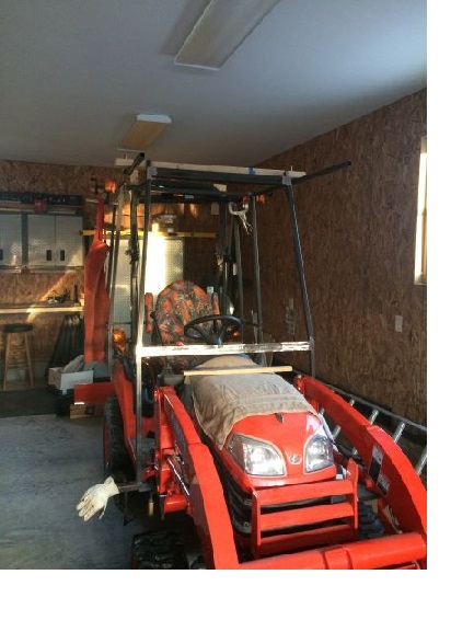

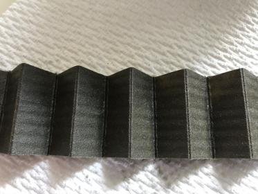

Now for the mockup. Knowing I wanted to go metal instead of wood, and having built cabinets with inset doors, there was no way I was going to attempt to build flush doors for this. All my panels are full overlay so you don't notice any variation in the opening reveal. Mockup with cardboard and Z-fold attached. I wanted my switch panel overhead so as to not block visibility and didn't really have a better idea of where to place it. It was at this point I realized my arms were entirely too short to reach that far forward from the seat. This led to revision #1 where I reversed the angle of the windshield (now layed back in a more conventional arrangement) and needed to incorporate a wiper. Stay tuned, more build progress & pics to come.

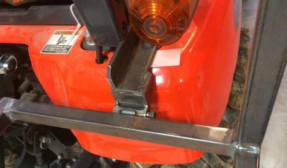

Knowing that curved sections was out (I don't have a tubing roller nor wanted to fork out $ for curved glass) I built everything using simple planes. The original plan for the lower rear portion was to leave the factory hazard lights in place and utilize the 4 small porthole windows to allow them to be seen from outside. This lower portion hangs plumb with 90 degree corners at the rear. The upper portion angles inward about 3" or 5.5degrees. If I had it to do over, I would pinch the top in a little more but that would require I rethink how the front wiper is set up. Since I wanted to retain the ROPS with this cab, I came up with the clipped corner roof design to keep the overall height as low as possible. Also, to clear the ROPS, I left 3/4" between the ROPS and cab frame at the top rear which provides about 5/16" clearance for the rear glass at the pivot brackets. I really liked tinkerwitheverythings idea for pivoting the whole cab off in the spring but wanted a little more substantial rear mount. The rear mounts are 1.5x1.5x3/16 angle iron. I utilize the ROPS fasteners at this point and am working on a modified nut design to increase thread engagement. The weight of the cab is supported by the bracket itself. I'm not relying on any weld or fastener to carry the cab weight. The dowel pins hold the cab from sliding to the rear off the mounts and provide the hinge pin for install and removal. The picture below shows the frame in the 'rotated back' position.
For the front mounts, I utilized the factory holes in the loader mount. If I remember, the OD of 1" pipe needed to be ground down slightly to fit this opening. The rest was just a matter of cobbling angle iron together to get out to the front corners of the operators platform.

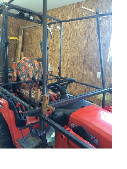

The remainder of the frame was fit and tack welded together on the tractor. First thing was to establish the location for the apex of the front (intersection of the windshield and lower portions by the loader arms). I didn't want to have to remove the cab to raise the hood. This was one potential issue I discovered during my web search. Once this position was established in the front to back and vertically in line with the square portion of the rear frame, I had to determine how much I could 'pinch' both side in. It may not be evident from any of the pictures I've posted so far but the front is narrower than the back as well as the top being narrower than the bottom. The jpg of CAD model better illustrates this.
So, everything below this vertical elevation is plumb. The portion above (upper door, front windows, etc) slope inward. The rear window hangs plumb. This was one portion that clamping things together, measuring, etc was more productive than trying to model it first. Once the front was complete, it was just a matter of tying it to the back. Again everything is built as a plane so it was just a matter of measuring the angles and filling in the gaps.
I chose to skin the frame with 18ga sheet metal instead of welding in pieces to create the window openings. I thought this would result in a cleaner more finished look when completed. The fixed window openings were cut in the sheet metal before being plug welded to the frame. This made it easier to manipulate the panel to cut. In an attempt to make this appear like I knew what I was doing, I did my best to keep the tops and bottoms of all glass level as well as in line vertically. Before I could start poking holes in the skins, I had to decide how I was going to mount my glass. I wanted something I could source, wouldn't cost a fortune and be able to install myself if needed. I ended up using Trim-Lok LK1522 single piece locking gasket. Working with my local glass guy, we came up with a reasonable gasket reveal on the inside. I didn't want the gasket to bump up against the frames and give myself enough room to work. So, with my 5/8" reveal plus the width of the gasket, I marked window locations on the panels off the inside of the frame. I found Folgers can lids are a near perfect 3" radius and this was used in all corners. Straight sides were cut with an electric hand shear and the radiused corners a jigsaw. Everything was cleaned up with a file. If I had this to do over or wanted to go into business building these (I'm a gluten for punishment) I would have made plywood templates for each opening and knocked these out with a nibbler. It would have been way faster than the way I did it. Panels were drilled for plug welding about every 3" or so and finish ground. Stay tuned further updates to come.

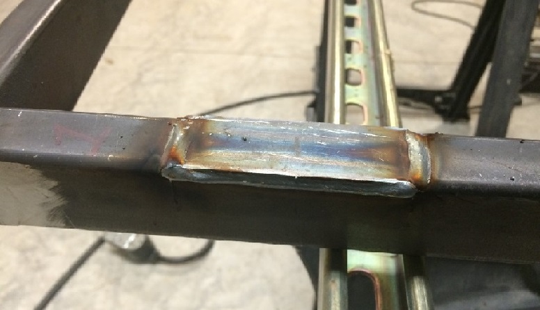

Both front and rear windows are operational. I couldn't come up with a slick and inexpensive way to provide a sliding window in the doors like a Curtis Cab so to provide a little ventilation during late fall or early spring use while this is still installed, I went ahead and opted for operable windows. Since the 1x1x14ga tubing frame provides only marginal thread engagement, at each hinge point I installed a 1/4" thick Dutchman in both the cab frame and opening frame. I fit the mitered frames to the openings allowing for 1/4" gap on the 3 non-hinged sides if that makes sense. Everything was tacked in place and then welded up later. Also, so I would have some room for weatherstripping later, the window frames stand proud of the cab frame about 1/8". Nothing earth shattering about this portion of the build. Just a lot of measuring and cutting. Also, it was handy to have an ample supply of clamps in place to hold spacers, etc in place while fitting all this together.
