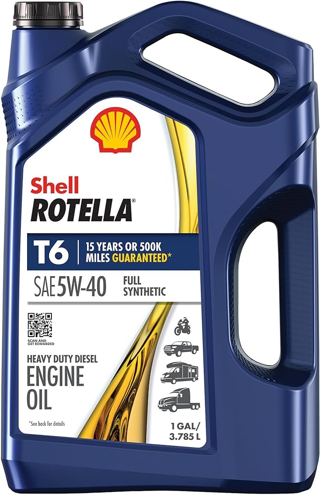

I was changing the oil on my diesel truck last week and noticed (for the first time) that the bottle states "15 years or 500,000 miles guaranteed". I realize that you should change the oil more that one time--assuming you keep it for 500,000. But should I change it at about 10,000 miles (when the truck tells me to) or could I skip that and reset the oil change at least one time between changes? Just curious what everyone thinks. rotella.jpg

That’s a warranty they offer if you use their oil exclusively. Read the fine print
edit: they aren’t saying the oil is good for 15 yrs/500k miles.

If your truck is "in tact" I wouldn't go 10k. Too much soot loading. If you have removed the castration devices then 10k isn't a problem at all.
