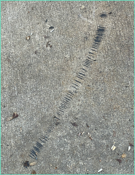

Plus, I ran out of MIG wire. Speaking if MIG, here's today's puzzler - this probably looks familiar to experienced welders - I thought it was pretty cool:
It's just a pattern of steel filings (grinder dust) left on the concrete where the welder leads ran!
I would imagine that the lines of "electric flux" from the leads created that pattern.

.........................It's just a pattern of steel filings (grinder dust) left on the concrete where the welder leads ran!
Some people don't realize how much of a magnetic field there is around a current-carrying conductor. I worked on projects where they used Nelson Studs on the steel beams. One of them was the 7-story county courthouse here. The welding leads were run up the outside of the steel framing at one corner of the building. The leads were a few feet away from the column, and when you heard the welder groan, the leads sucked in near the column for the couple seconds it took for each weld. That machine probably produced 10-15X what we hobbyists might use:

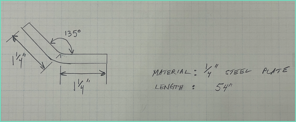

Then I tacked the lower fork 'catch plate' onto the SSQA plate. This catch plate will hook onto the lower end of the forks and keep them from swinging out when I curl the FEL down. This was a piece I had to have made by my steel supplier as it required a 45 degree bend in 1/4" plate:
