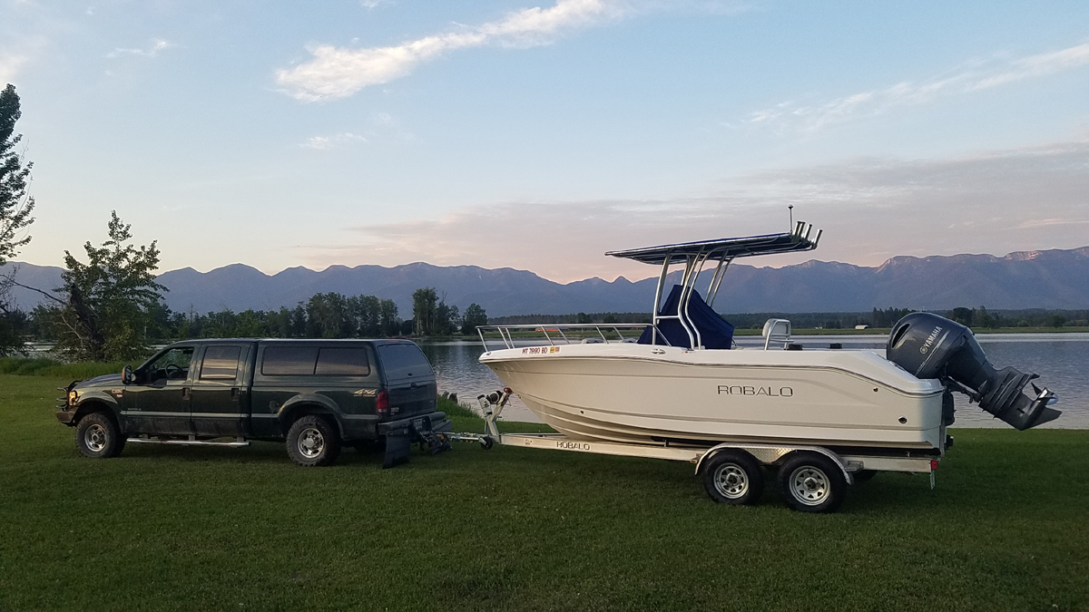

I agree re tonque weight when towing boats.
I'm getting my boat out of winter storage tomorrow and I'm going to check the tongue weight with the Sherline tongue weight gauge this weekend, but I bet it's less than 10%. The boat tows really well and has a listed dry weight including the engine of 3,050lb. If the 70 gallon fuel tank is full that's another 560lb. Add in the T-top, hand rail and all other gear it's probably around 4,200lb. As you can see from the photo, the weight is mostly distributed from the front axle rearward (fuel tank is under the operator's seat). The aluminum trailer has a GVWR of 7,400lb, and according to the title has an empty weight of 900lb. So the entire load is maybe 5,100lb. I wouldn't be surprised if the tonque weight is 5% or less.
