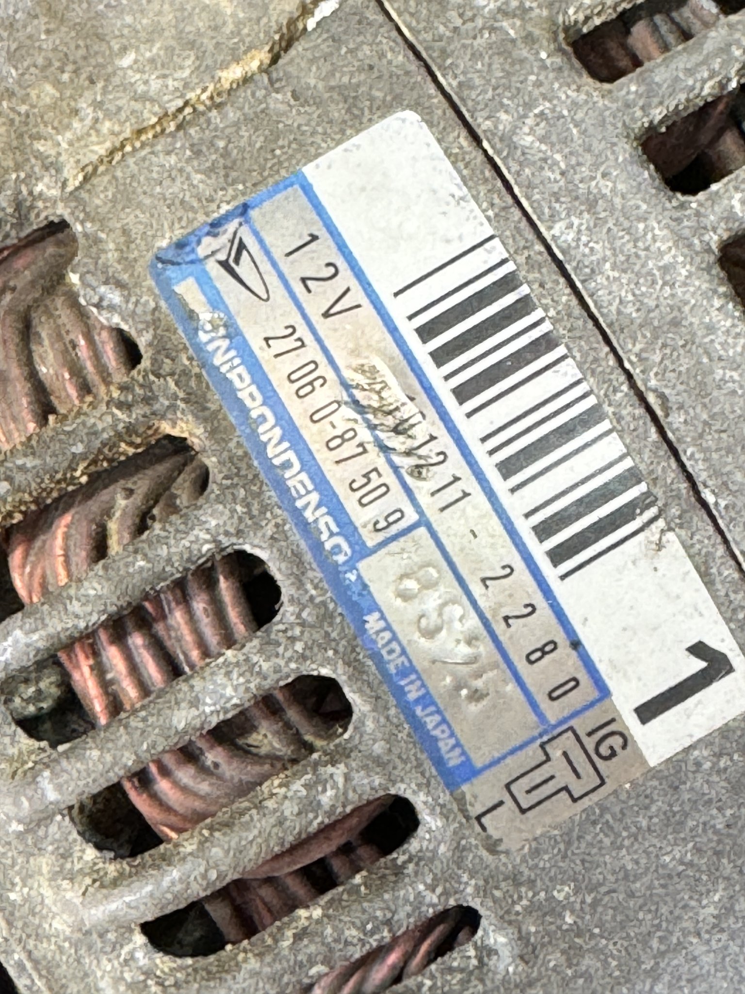

I just looked, the sticker for the part number is against the block, I can not reach it unless I dismantle everything… I will try to dig it up in my messages archive if I can.

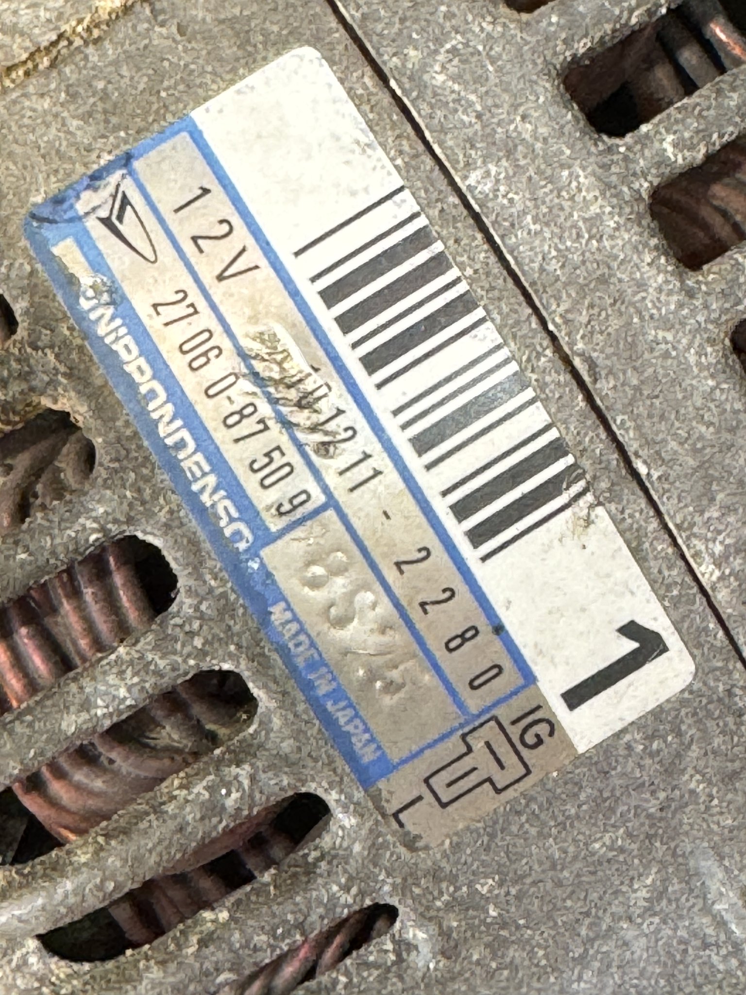

I took it apart, here it is:
thank you for taking the time to do so. According to my research (limited) it fits a Daihatsu Cuore IV (1995, 1996, 1997, 1998, ) Not sure that model was available here but I'm pretty sure there are other applications or similar units.
