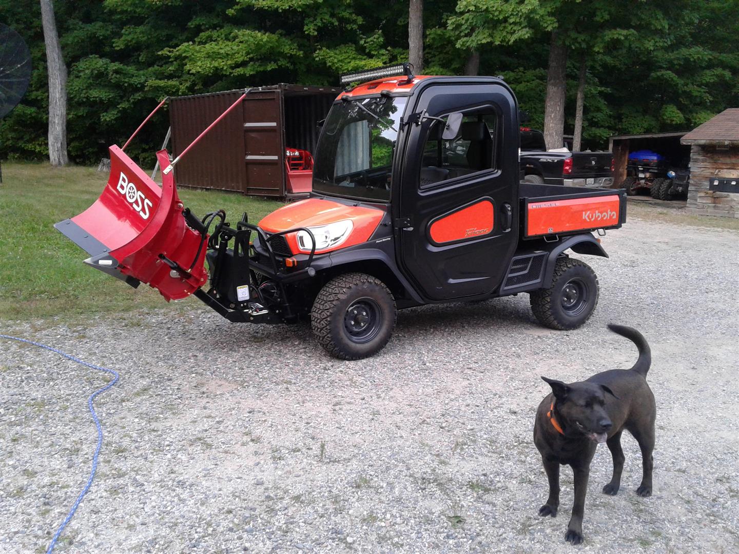

Well I'm not your financial advisor but I will say this. For YEARS I argued on here about how I'm a real man and don't mind blowing with my open station tractors. Well I can tell you, I finally got to use the RTV tonight in a storm with wind and I LOVED IT!!!
So do yourself a favor and buy a cab the first time before prices go up even more. I was lucky, I bought my 2021 RTV back in late 2020 for just over $24,000 Canadian and they are $35,000 here now.
A cabbed tractor is nice too, but I can take 2 passengers if I want.
As for the Boss plow, it does the job and is WAY cheaper than the blower setup. It does good back dragging from buildings and it has a very good range of motion. And as you can see in these pics, it can stack pretty good too.
