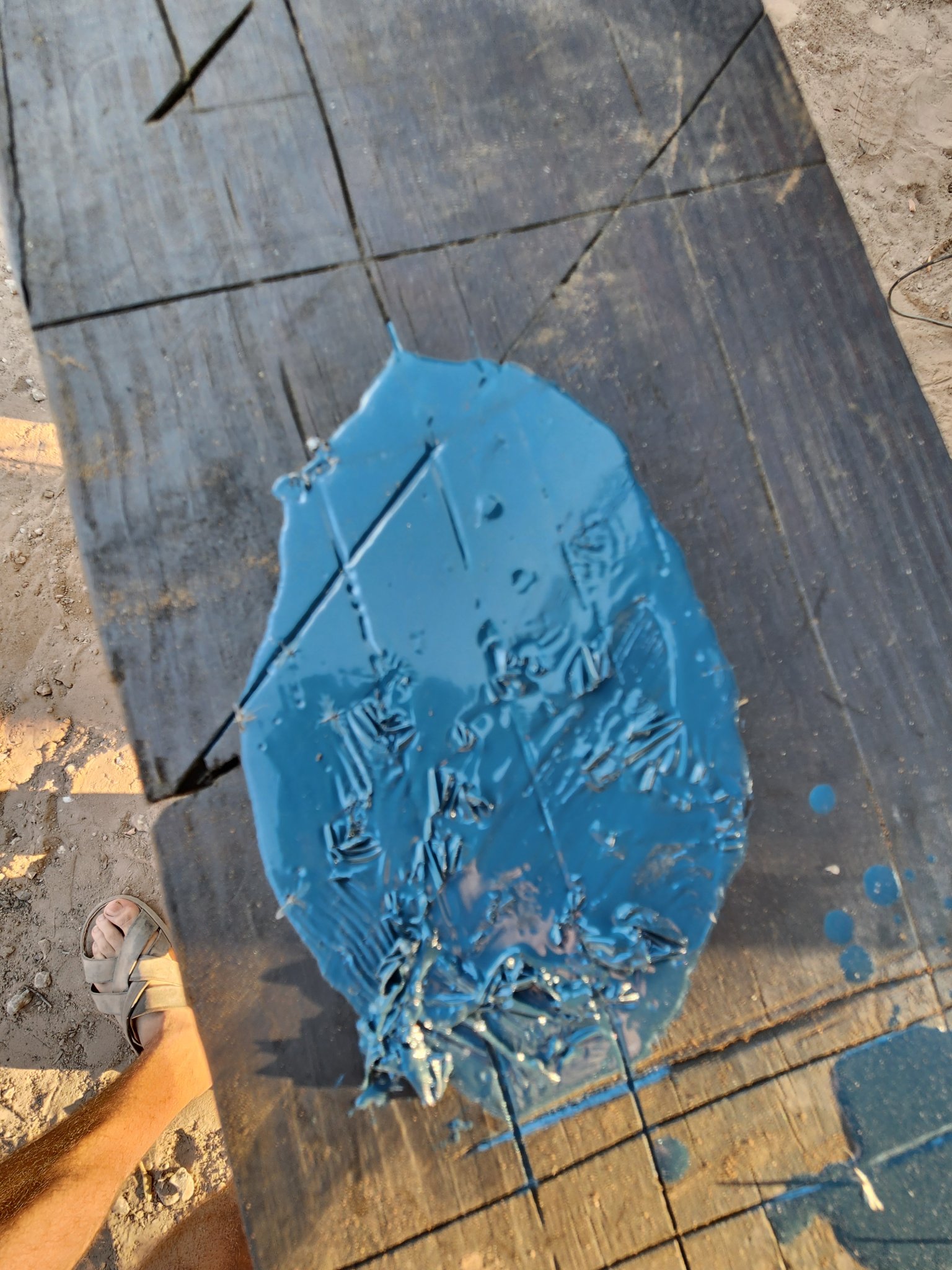

Jb weld using brush over exhaust leak

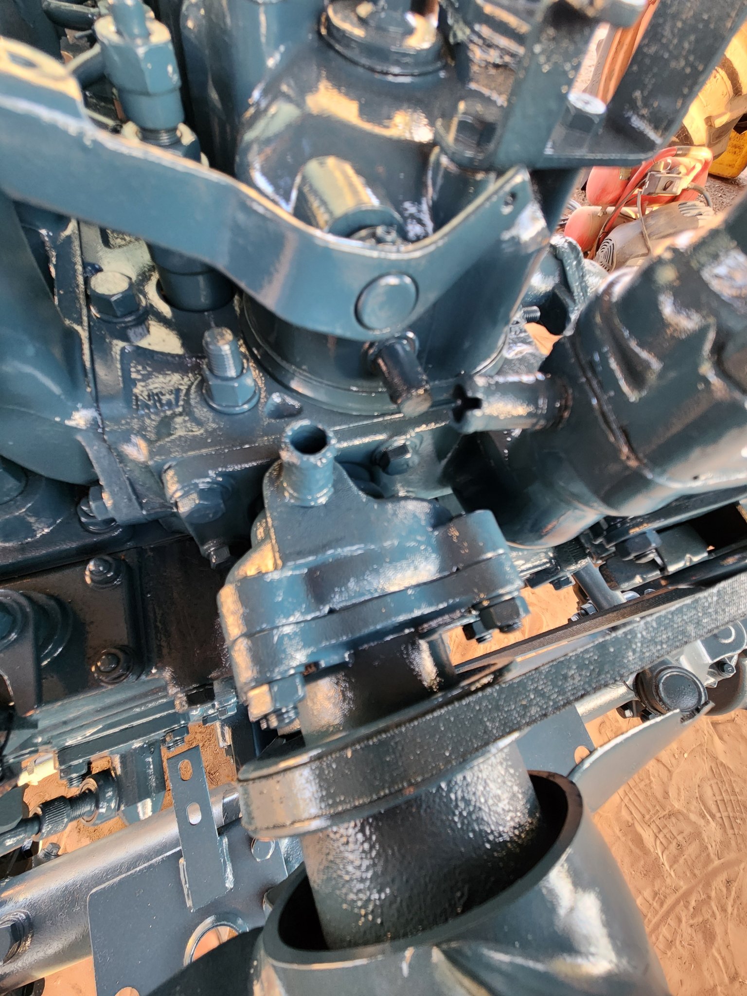

Now: paint over areas that leak and other areas missed with blue paint
Spray leaking areas with paint, no thinner, applying thick into leaking areas
Aimed it also at: injectors, glowplug, gearcase bolts, all random hardware not painted, underneath tractor
@Lil Foot
Before taking off head a second time and fixing the leaks properly, I try this DIY method and see what she does
I had to finish painting the area anyway
Many of bolts where there are leaks were loose, I am hoping tightening the bolts, laying paint will fill the gaps

Yes I comprehend: that exhaust connection warped, I can plane it with grinding disc if it bust through the jb weld
Experiment I test: can we fix leaks with jb weld and small brush? It apply very nicely over intended area

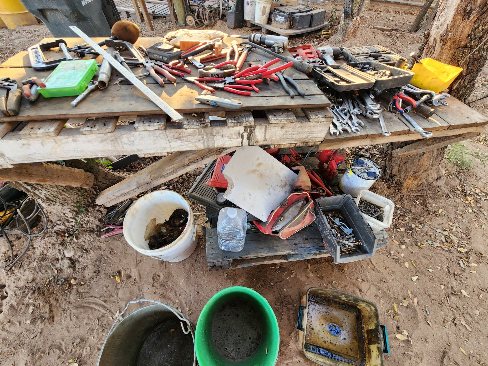

While waiting for paint to dry etc, clean shop, reorganize tools, put hangers on the trees and keep all tools used often close to work area, remove tools not being used,

Soon: clean whole shop, hang tools on trees close to tractors, paint some stuff black with spray can

Up close of leaking area after heavy coat paint

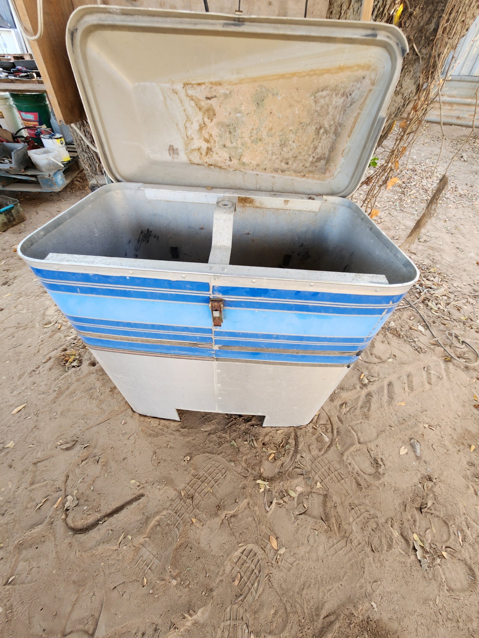

Barrels to be used for solvent spraying systems:
Be able to fill them up, and have pump coming out of them going to small garden hose I use
Can be layed sideways, use bigger hole as fill and vent, and smaller hosing going to fuel pump, then pushing into hardline
That would eliminate the problem of having to pull fluid up out of barrel

Doesn't sound bad. Exhaust manifold probably warped.

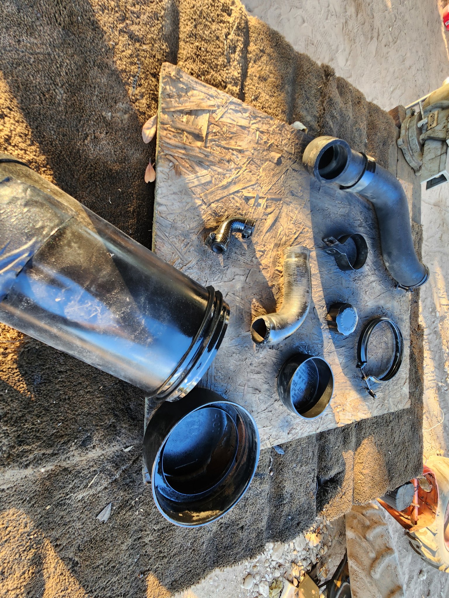

How about an air filter. God only knows what you're sucking in.

On the manifold. Lay a straight edge along it. Should probably be planed but you can try permatex copper.

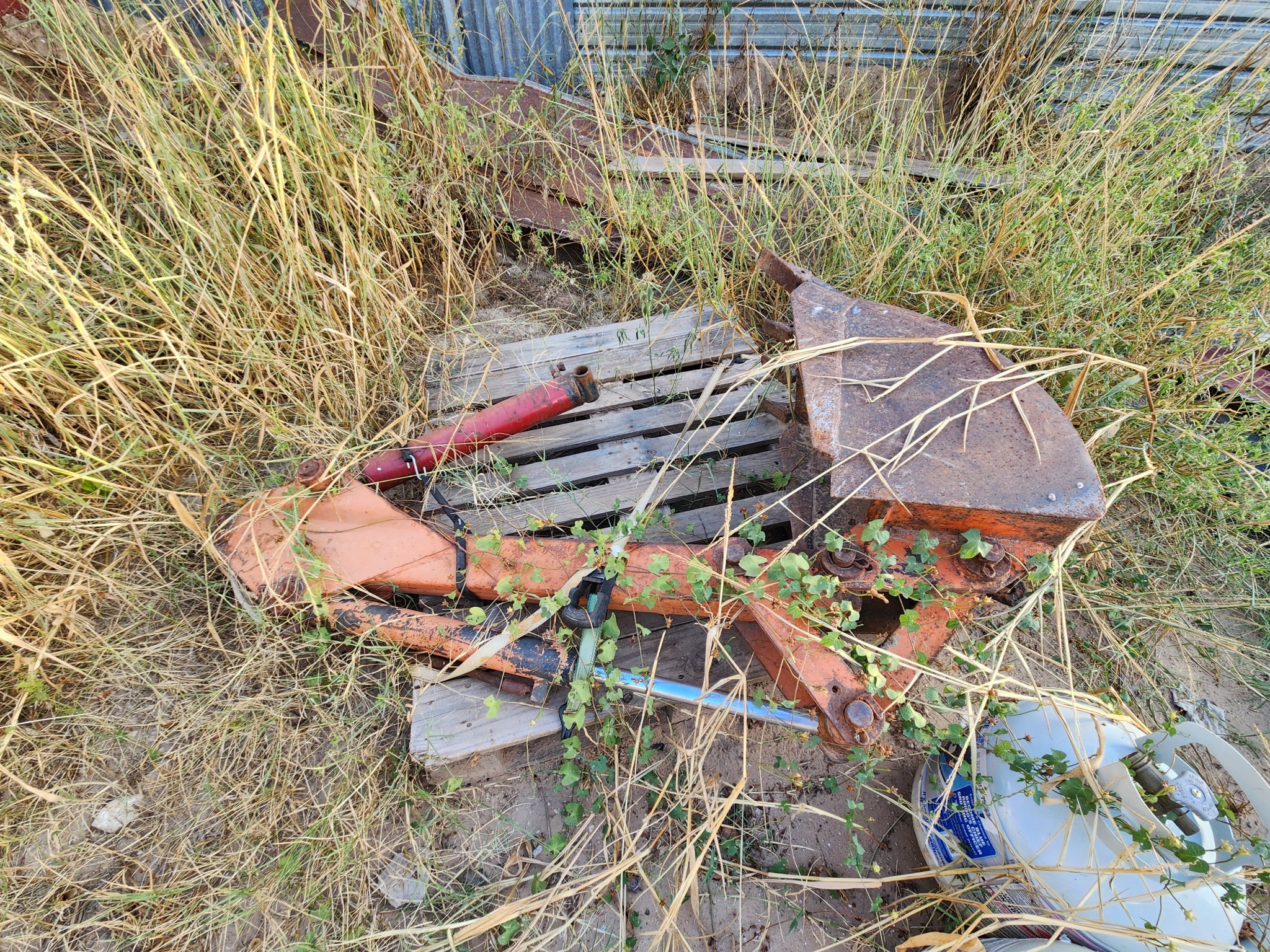

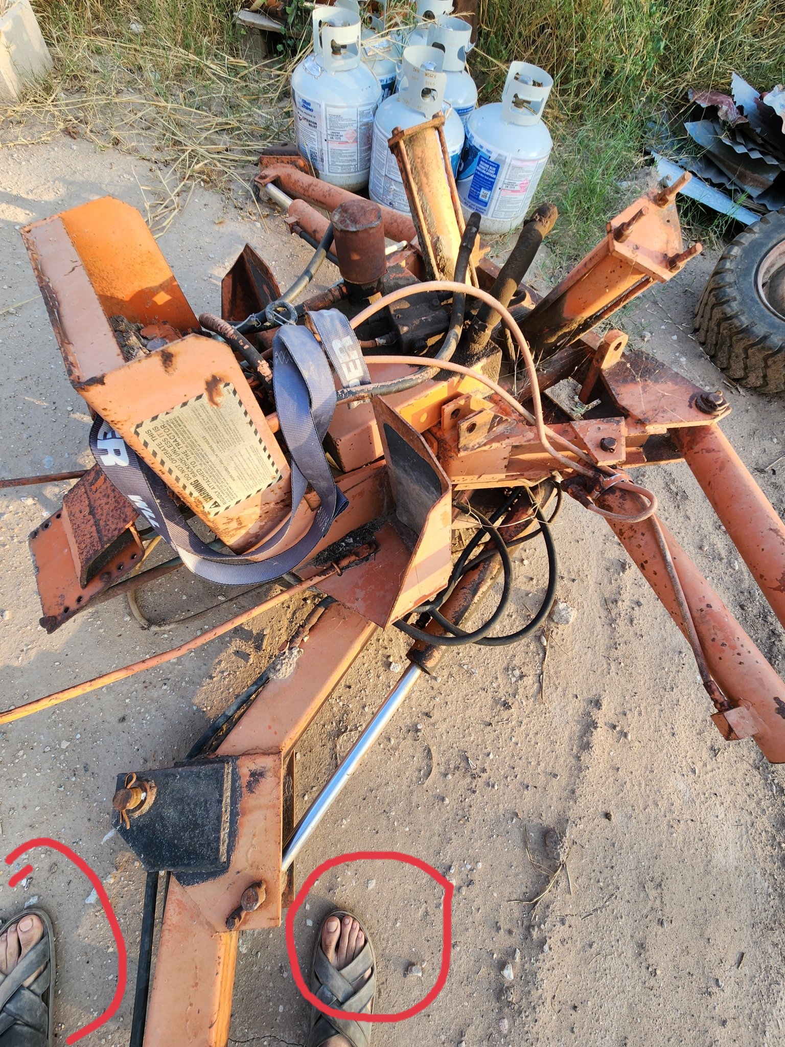

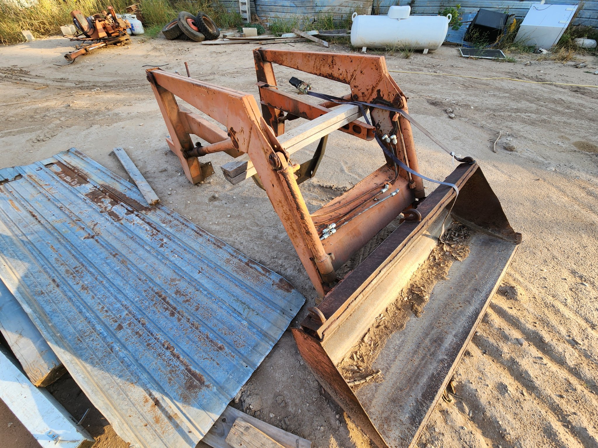

Loader attachment: drag it using pickup truck and chains closer to tractors
Backhoe, same

Spilled paint yesterday, still not dry, don't start tractor and put water pressure on the paint yet
Up close: thick coat give it lizard skin look
Found in junk pile: moving around junk reorganizing the shop, this come off a airstream, I can use it to store gasket away from element
Put all tools back, hit everything with compressed air then part cleaner, cleaned out buckets, cleaned rags, gloves, etc

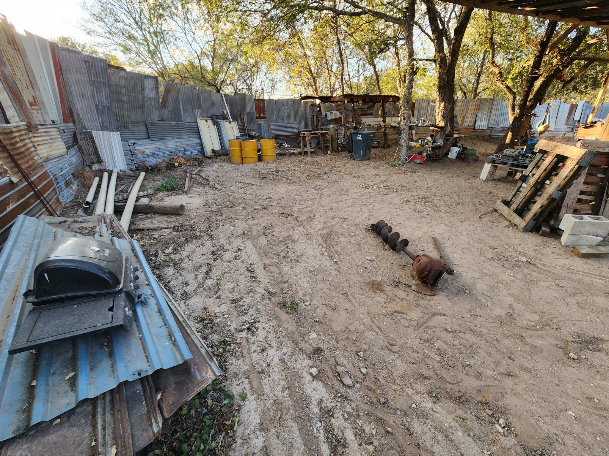

Threw away bunch of junk

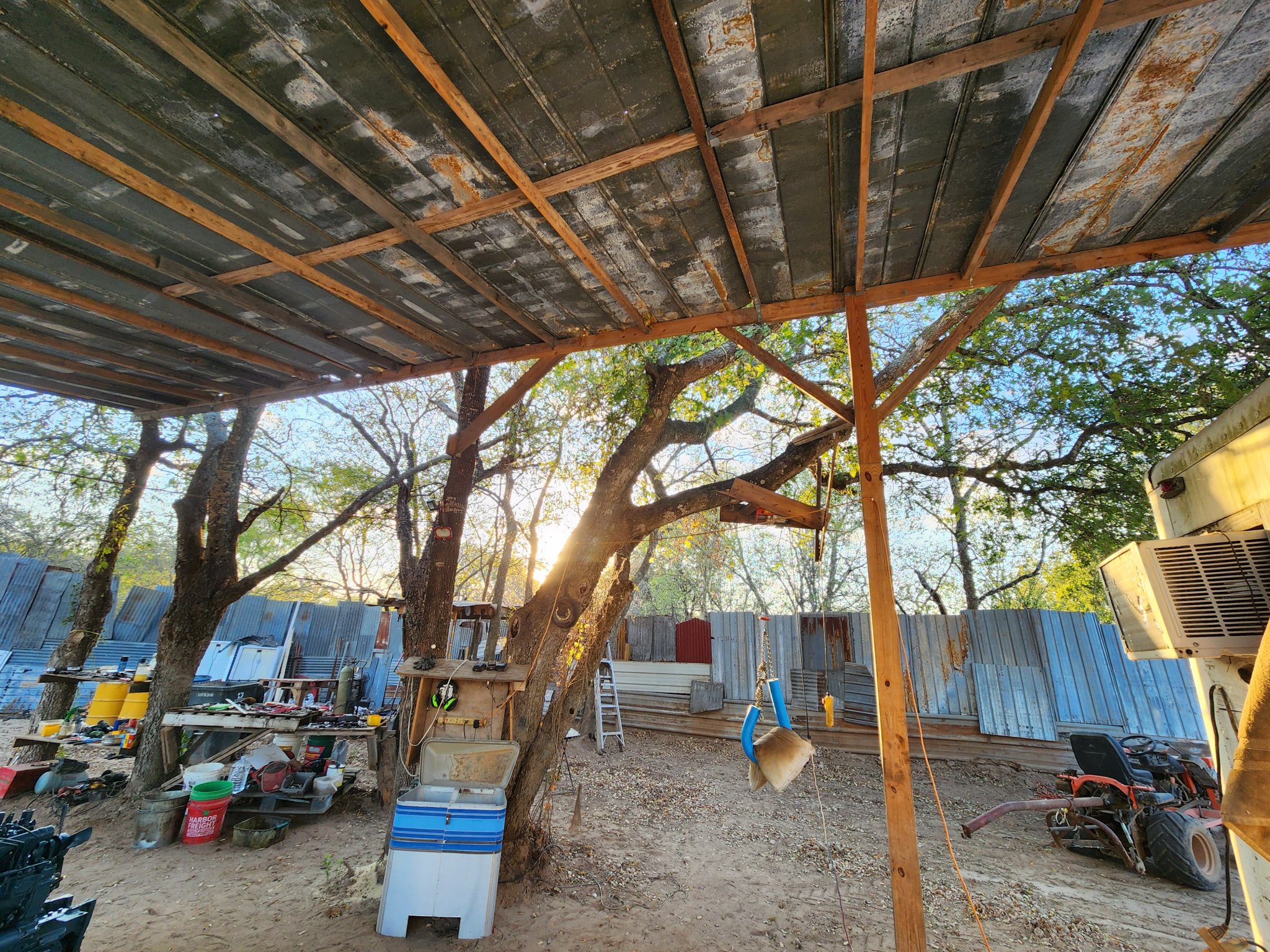

This area: getting everything off the ground, moving all junk to where attachments are and need to bring attachments to this area
Along top of shop: put 4 foot of metal across whole shop to make more shade
@jaxs
#2. Now, imagine if you can what Joe could do with same playpen and toys Runswithsissors has.
Yes, please elaborate
Now, I am reconfiguring shop setup, need to add the barrel solvent spraying system, spread electrical across the posts to keep wire off ground
The one big improvement for the future: put strong beams across top, then when I want lift heavy stuff and couple them, I can hang everything using chain on those beams
I want to lift entire machine reliably
Though they seem like many different projects, they are all one project, generally speaking
Plan: bring all attachments, parts, wheels, everything
Organized in the shop and chip away at all tasks in phases
Example: have all parts that need orange paint all in one area, hit them in one shot
Basically: bring all parts of both tractors, set them up in fashion that efficiently makes progress on entire job as a whole
Bring backhoe, setup stand for it, start reassembing it, bring loader and prep it for use, take apart non painted tractor, get it ready for blue paint, move everything not related to tractors away from site
Clear out and plan walkway for accessing every angle of all attachments/tractors/work benches/tools

fixing leaks with stuff applied on the outside is not likely to work. But lets see, if everybody tells me something does not work I am the first to try it anyway.

Cleared area: yanked junk outta area get it ready to bring attachments and all tractor parts

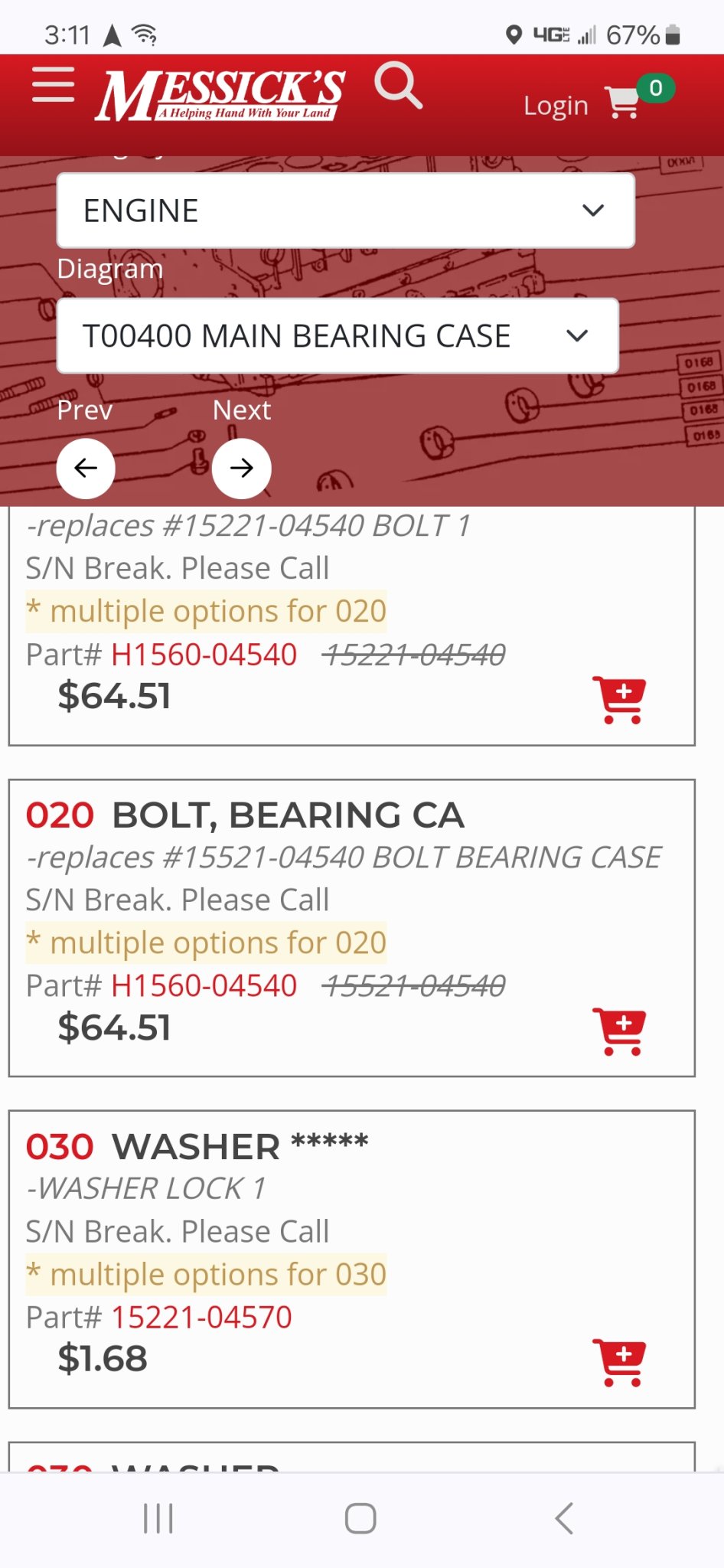

Just realized I have everything ready to put block back onto tractor, I have:
All new main bearings, new main seal, all gaskets to seal crankshaft, new crank bearings 210, new pilot bearing for crankshaft, etc
Everything available to get block onto tractor, but I have no pistons, rings, connecting rod bearings
Plan: get block close to tractor, give everything a clean, press in new pilot bearing into crank
Problem: when I broke main bearing bolt, I took one from this tractor, I might not have enough main bearing bolts to get crank inside block

Block close to tractor, put together crankshaft assembly, figure out parts needed, I think it is only main bearing bolts
Bearing case bolt, $65 for 1 bolt
Can't put engine on tractor because one bolt was busted when putting together other engine, unbelievable
Now: do other stuff while solving the bolt situation
I would swap it out with different bolt, but something tell me it is bad idea
I'm thinking: strip entire tractor, take wheels off, clean everything, use up rest of blue paint while waiting on one bolt
Bearing case bolt situation: I can't find any bolt available except for the $65 bolt from messick
I would feel bad for paying that much for 1 bolt
It's leading to the thought:
"Since I need at least 2 pistons for this engine and who knows what else, Why not just buy a whole other d1301 that has not been disassembled and would give pistons, tons of bolts, tons of hardware, etc"
Let me know how I can go about this, I'll search now for d1301 and see what come up

Get rear of chassis on block, take wheel off, take off steering and body, remove harness, cut hour meter
Hit it hard with compressed air, file in left hand, then diesel, then wire wheel, then cleaner
Clearing body, took off wheel
That bolt looks like the center is 'necked down' as an oil passage. An equivalent length/thread bolt might be able to be put in a lathe and modified like that. Probably the aftermarket supplier for Messicks does something like that..
