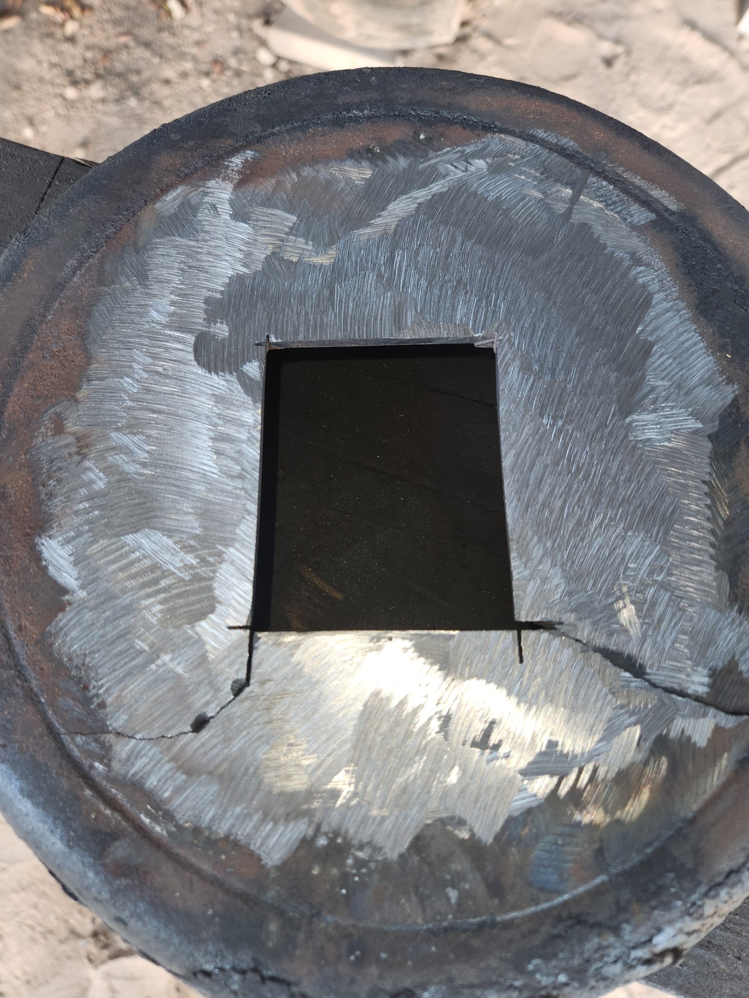

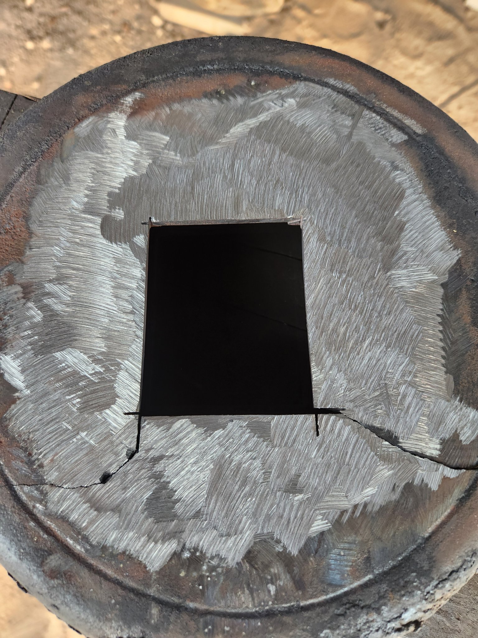

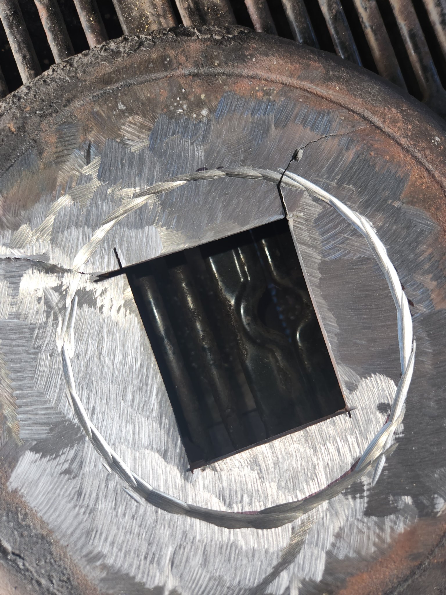

Reflection and observations:
After preheating the cast iron skillet to 400 in the enclosed bbq grill, I ADDITIONALLY hit the cast iron with the acetylene, and I do recall hitting the top part of the cast iron skillet (where the cracks formed) HARD to test the narrative:
"What happens if you hit the cast iron with too much heat?" It will warp
The bottom of th cast iron, I DID NOT hit it as hard with the acetylene, notice the no cracks in the cast iron on the bottom portion, same stress from the cutting wheel
My focus now going away from aiming the flame on the cast iron, aim the flame on the BRONZE because:
That area where the weld held TIGHT after hitting it with hammer, I was aiming the acetylene on the BRONZE, and less so on the cast iron
This was done to test the narrative: "What happens to the bronze if you hit it real hard with the torch?"
The exact sequence I noticed of what the bronze did: First it was a bead circular glob. Then I hit it with the the torch, then it leveled out and melted INTO the cast iron (amazing)
It will turn to flat liquid and bind HARD with the cast iron, which is the goal
Some of yall said it and it is the MOST important factor in getting them to bind:
hit it HARD with the grinding disc EXACTLY where you want the bond, real deep, and have ZERO oil on it including finger oil
Then put the flux on that area and give it a tiny bit of torch to melt it into the cast iron, then
Come in with the bronze rod in the left hand, melt the bronze in that area, then adjust your distance of how you are hitting that bronze with the torch, trying to get it to melt into the cast iron,
you (I) are not aiming the flame on the cast iron, but rather the bronze, trying to give it the RIGHT temperature to bind the cast iron, BUT not too hot to damage the cast iron
Those are reflections for anyone who wants details of observations
Next scheduled experiment: tomorrow morning

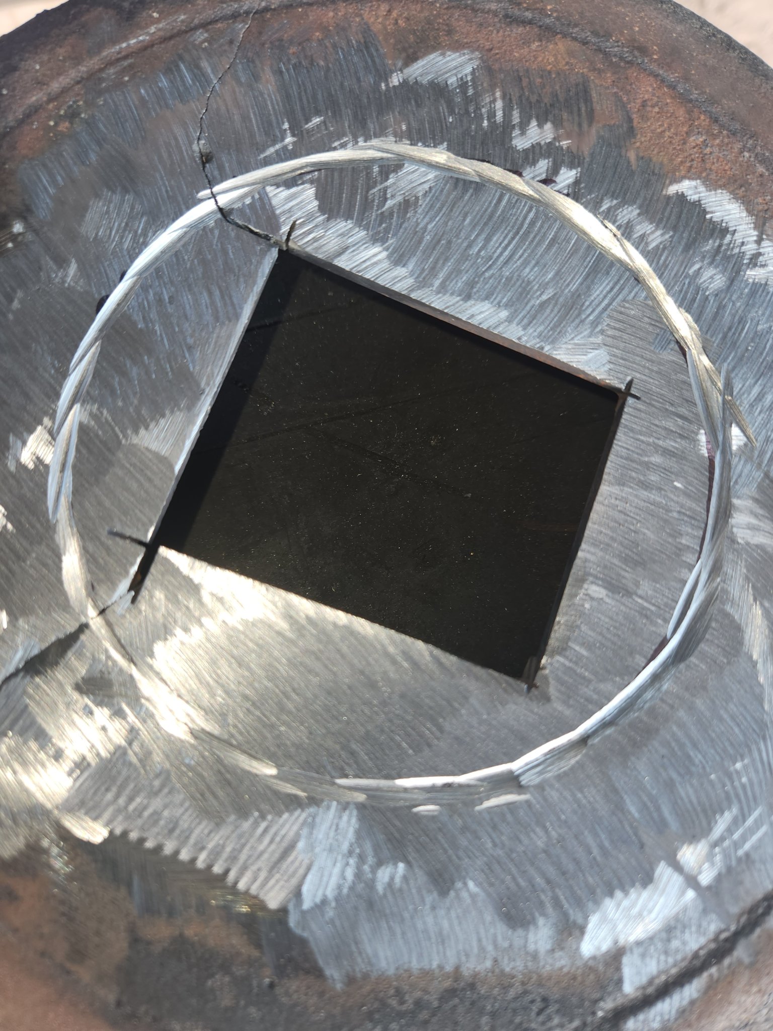

Hit everything HARD with grinding wheel and start fresh,
(new step I am adding) grind a nice round even circle into the cast iron where I want the weld to hold, you cant use pens or sharpies because that is an oil, this is the guide to make the circle more perfect
put the skillet in the BBQ grill, preheat to 400 for 15 minutes, use a precise way to glob the flux into your outline, then hit that with some torch until the flux bubbles a bit, THEN
come in with the left hand with the bronze rod, get it melting along your outline, get it hot enough to be liquified but not too hot to damage the cast iron
Goal: build a nice round circle of bronze that holds TIGHT to the cast iron and is not filled with gaps WITHOUT damaging the cast iron

Beginning to look a bit like "pallets in the field" post count.
trevoroni
B6000
May 24, 2023
201
251
The heating of the cast is not to get it to melt anything it gets it up to a temp that makes the added heat needed to get the bronze to flow less of a shock for the cast.
The reason the pan broke the way it did is because you introduced uneven stresses on it when you cut it.
One much more achievable simple result can be achieved by crafting a patch for the block out of mild steel and then use an epoxy like JB weld to bond the two together.
I fact you would need any thing else other than epoxy to fill the hole, because you could dam the back of the hole with tape.
You wouldn't be introducing any more stress to the block and you will be able to achieve a permanent patch, that will out live you or I.
If this was my project I would do just that and I know how to weld, and I know how hard it is to weld cast.

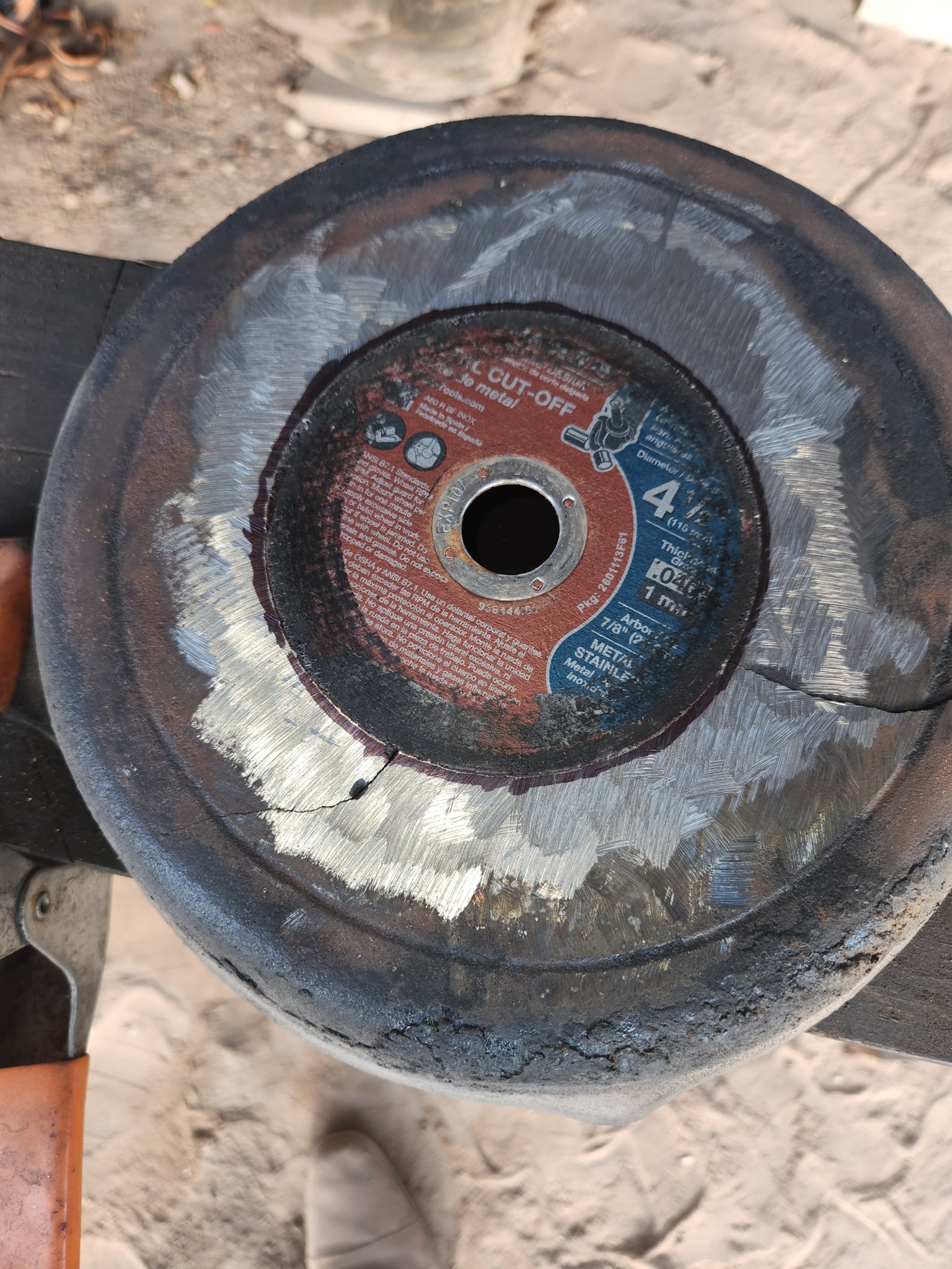

Whoever said those little tanks are useless was right
Hit cast iron with grinding wheel
Used a cutting disc as outline to trace perfect circle
Used grinding wheel to strip away some cast iron

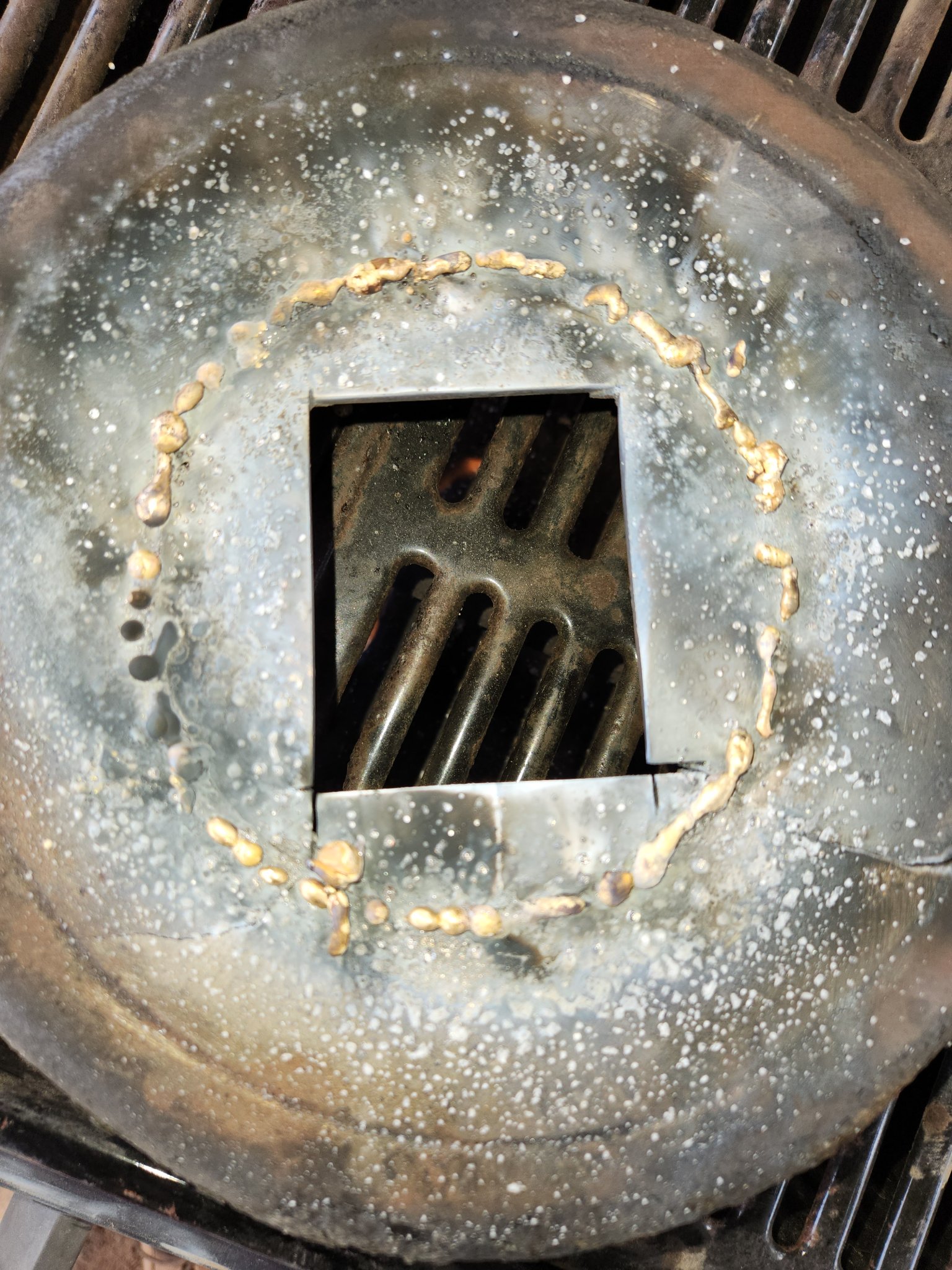

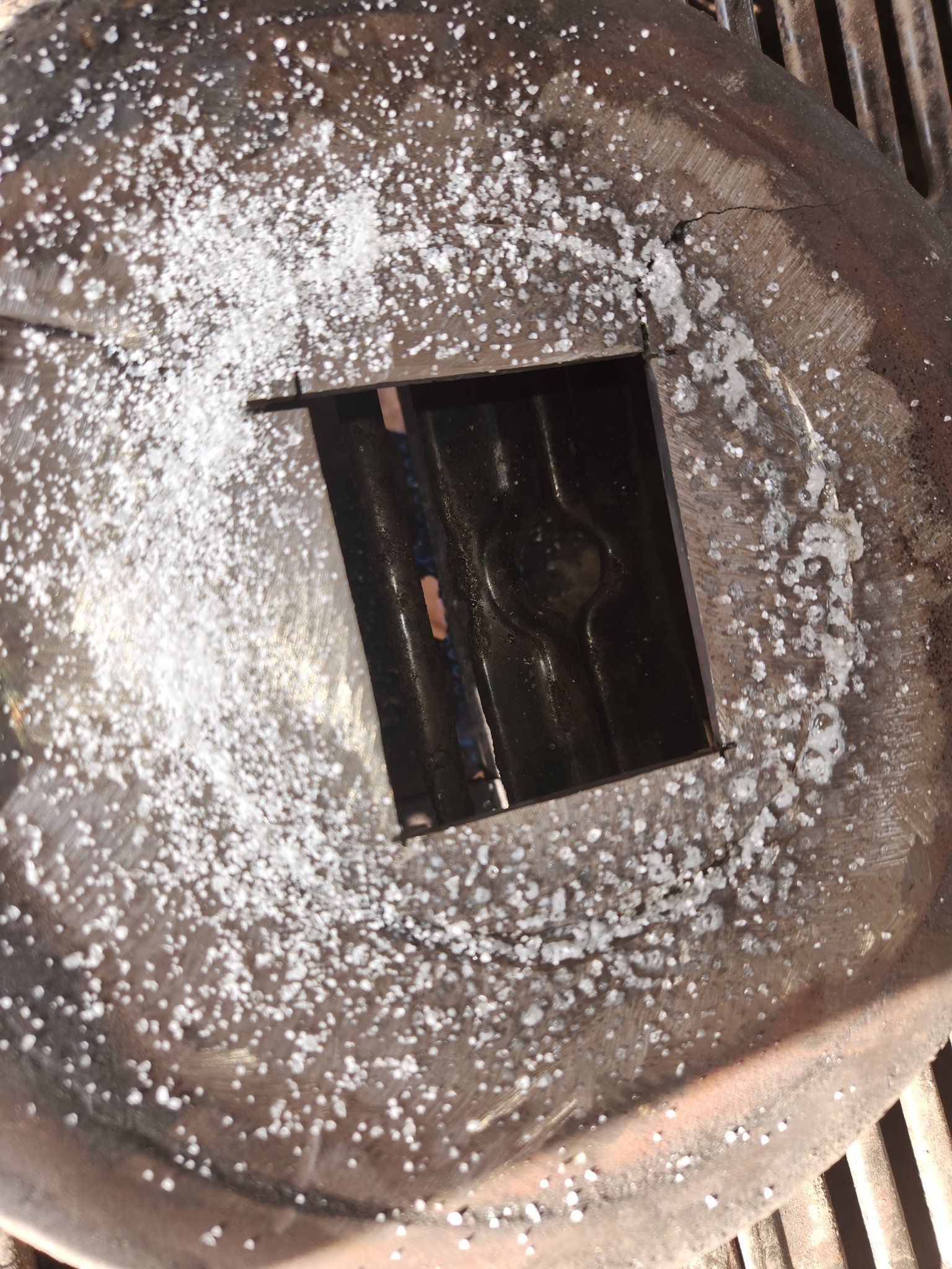

put skillet in BBQ grill
After 15 minutes, I sprinkled flux along the outline, flux bubbled
Soon as I started the weld, tanks ran out! Bummer
Had to drive for couple hours, landed a deal on massive tanks that have gas in them

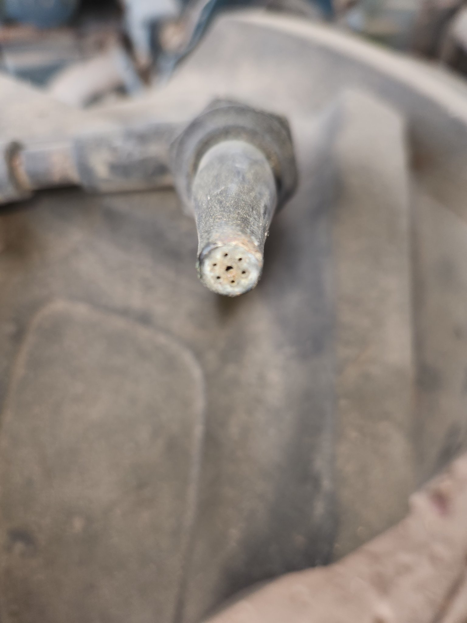

Came with both tips, notice how this cutting torch does not have those holes inward like that other one

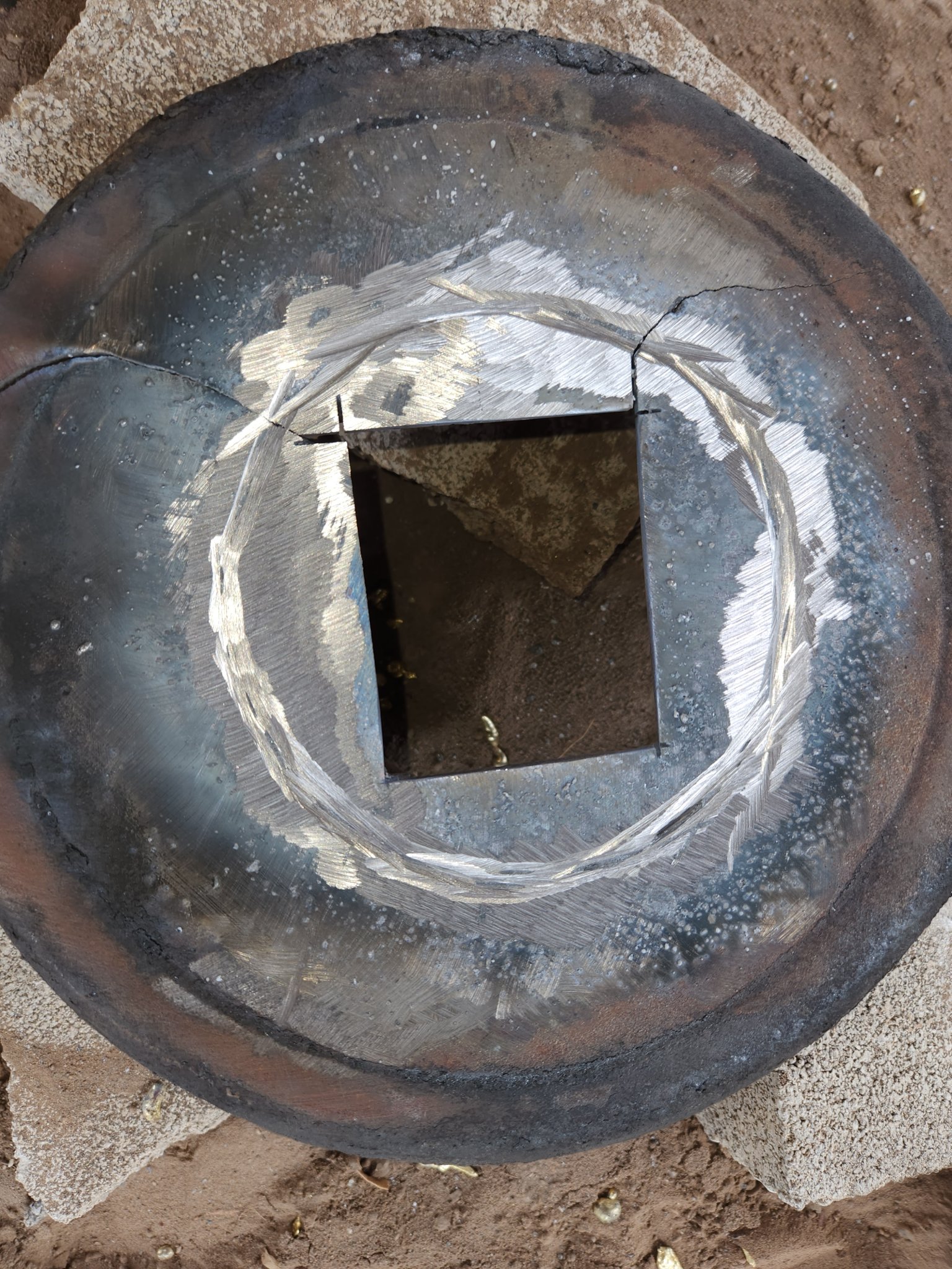

My theories didn't work: bronze only beading and won't flatten into the groove, did not stick
Hit it again with grinding wheel
Tried again with much more heat, propane and acetylene
Still same problem, Bronze not flattening, only beading
Ran out of bronze rod
The problem: I cannot the bronze to lay flat, all it wants to do is stick to the rod and bead, it will not lay flat, no matter if I hit the cast iron hard with acetylene then come in with the bronze rod, or
if I focus the acetylene on the bronze, still the same exact issue, bronze will not liquify and flatten
No matter what I tried, I cannot get the bronze to sit in the groove

Now that you have 2 larger tanks, keep your eyes open for 2 more. That way when one goes empty, you can grab another full one. Then has the empty exchanged for a full tank, and you will always have one in service and one waiting to go into service. I use the small tanks because they ae easy for me to move around, but if the job requires a lot more thermal muscle, I can always break out my large tanks and spares. I used to keep them in the garage, but now keep them in an outside shed. Much safer in the event of a fire. If you have ever seen one of those tanks in a fire you would understand.

defeated, I went back and reread all yalls statements
my method was not even close
Watched these clips, generally trying to understand what they are doing and what I am doing wrong
Things I was doing wrong: acetylene flame not even close to being strong enough, bronze melt at 1800, cast iron melt 2200, you need to hit the area hard with acetylene (someone did say you need more flame)
The appearance of what they are doing: they hit an area hard and create a cherry red section, then they come in with the bronze and build up a puddle encompassing the crevices
Those that can weld on cast iron are very talented
Next steps: get more rods from welding shop, try to do what the clips show

The third video is not brazing it's using muggy weld rod, muggy weld rod is more of a hard silver solder than a brazing rod.
They are expensive, but work well.
I have tons of brazing rod here all different alloys and flux.
I'll see if I have a piece of cast that I can patch up to show how you can run a weld.
But you are going to need a ton of heat to get the block to weld up, and if your real lucky, not crack into the water jacket.
You will also need to pack the block on sand to let it cool slower than in open air, if you don't your very likely to crack out all of the weld.
I'll say it one more time: Epoxy would be a much smarter, safer, and cheaper way to fix that block.
