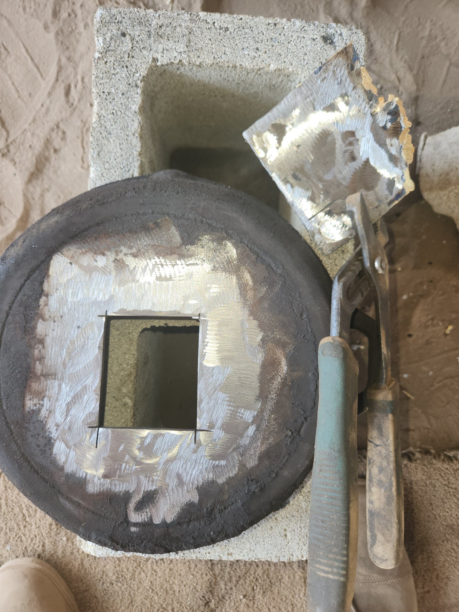

Trying to get the patch to stick
angle grinder, discs and grinding wheels
bucket of water close by for safety
cut square in cast iron skillet
cutting bucket to make patch
practice patch
Hit iron skillet with grinding wheel
held down patch with clamp, hit it with grinding wheel

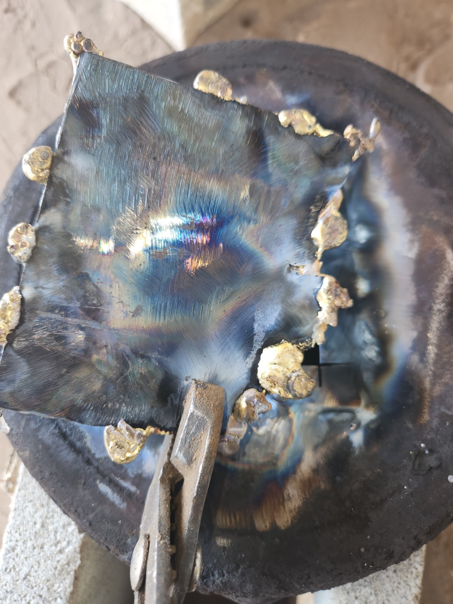

patch ready for brazing

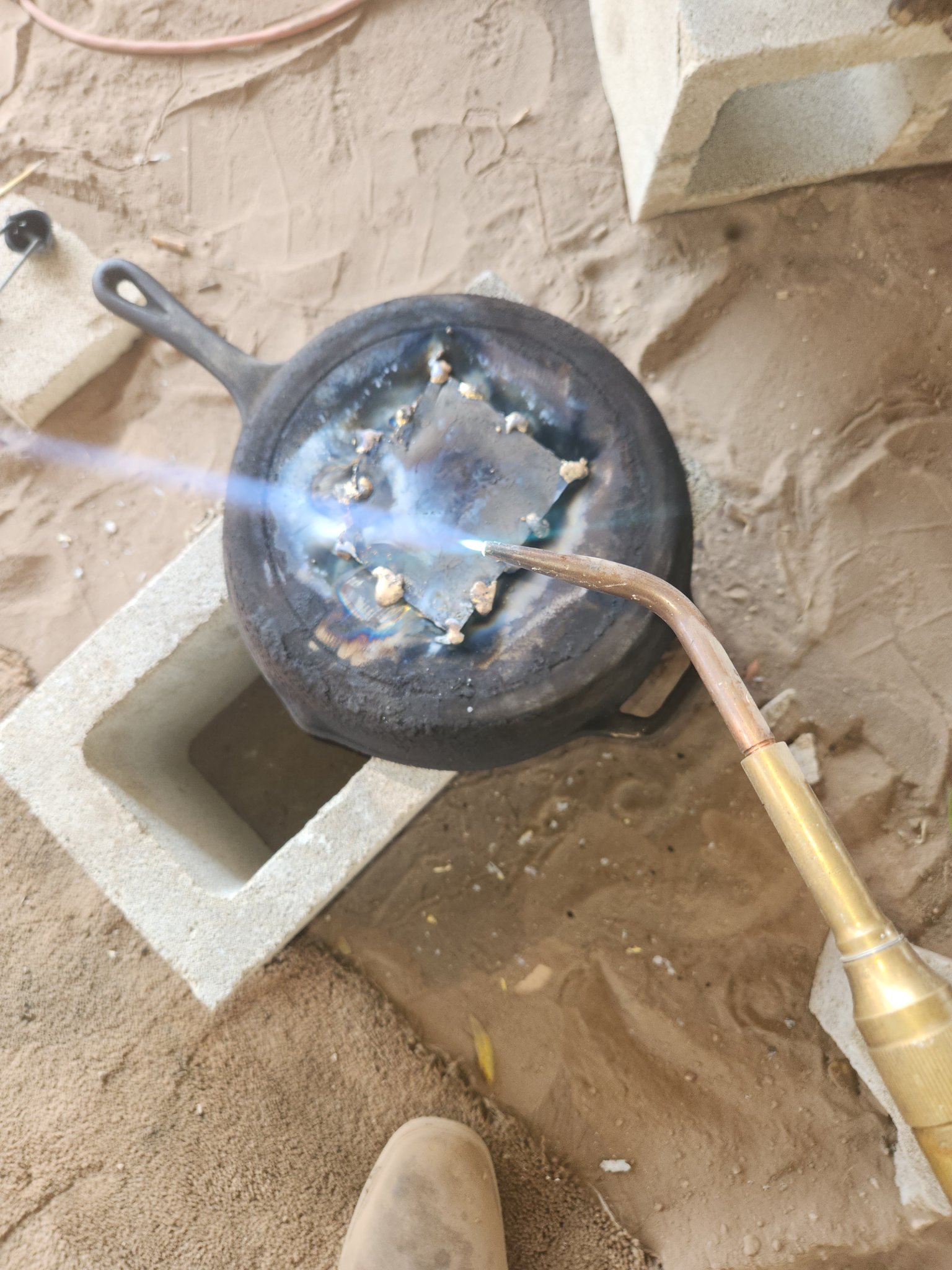

small neutral flame in right hand, bronze rod dipping in flux in left hand, patch did not stick

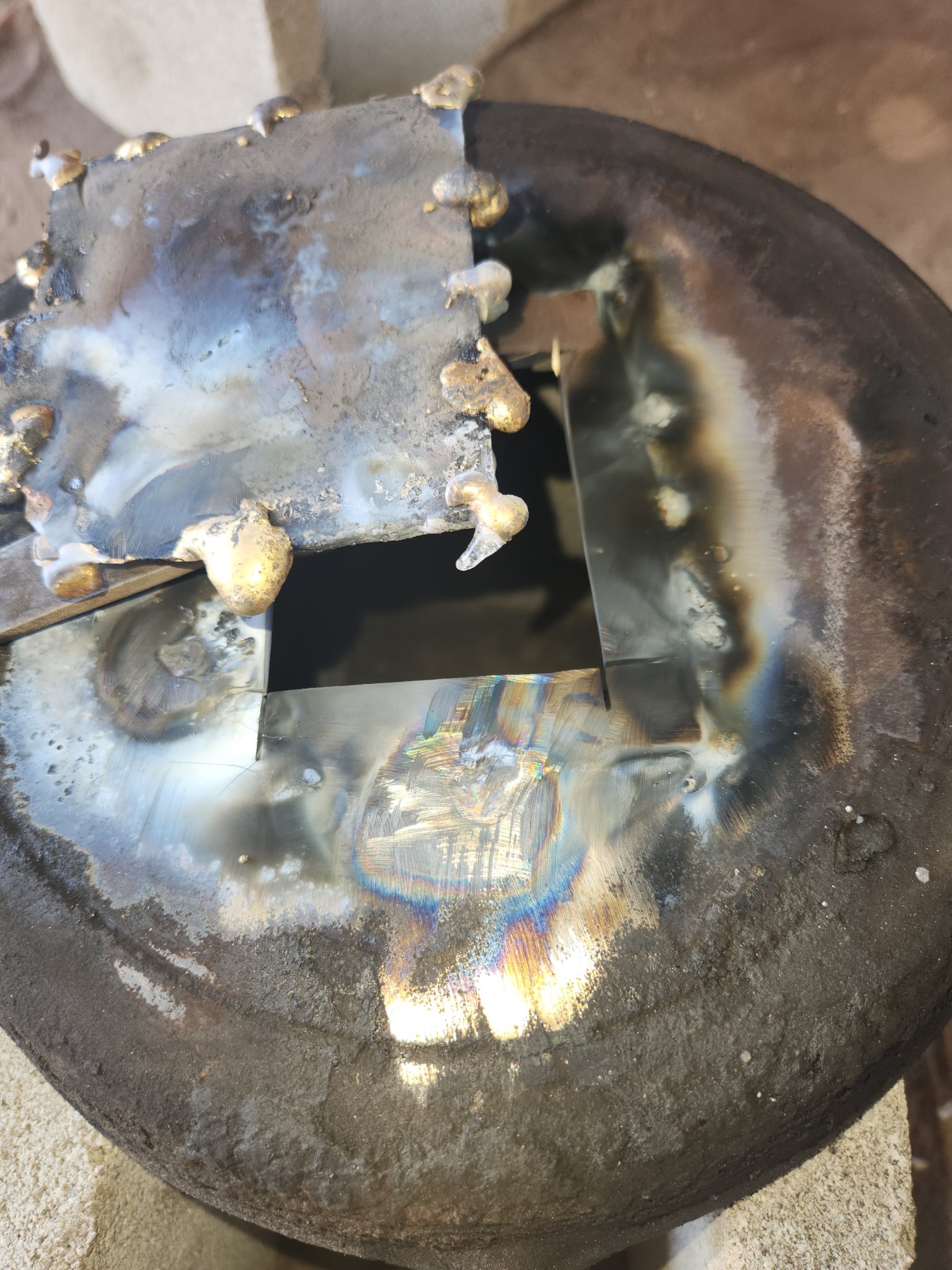

2nd run with torch, messier, still trying to understand where to point the flame and how to successfully bond the two entities
Next step: hit everything with grinding wheel and start over, fixing to try what greenville said: put beads in the corners, then try solid beads half of each line to distribute heat, give big heat to the cast iron skillet, then push the rod into the area, melt the bronze, let it cool solid
New attempt: point the flame on the cast iron skillet, push the bronze rod exactly where you want the bead to form until it liquifies, move down the line forming a bigger bead and waiting longer for the bronze to melt, make the bead form at the intersection of the two entities big enough to encompass the 1/4 steel patch...

Brazing works via capillary action. If there is any filth then the filler will not flow into the joint.
BX23-S,57 A-C D-14,
13,212
5,869
OK, those parts are NOT clean enough to braze !
You NEED shiny, well ground, CLEAN metal. Can be 'rough' but has to be clean.
BTW the coating on the bronze rods IS flux. I never used anything BUT the rods.
Hottest part of flame is the blue-blue transition.
You need to preheat the point where you want the bronze to go
THEN place rod there and heat will melt a small amount of bronze and it'll flow a bit
REMOVE the flame !
Now go to the opposite side of the patch and repeat the process..
preheat,add bronze, move to another corner..
Once several corner are attached, go 1/2 the distance and
preheat,add bronze, move away....
After an hour or so ,you should be able to get the timing right of applying the correct amount of heat, dab of bronze, cool and continue
You ARE wearing 'brazing googles' ?? Mine are a dark blue tint.

The 'trick' to understand is cast iron takes heat AWAY from the heat source real fast, so you need a lot of heat BEFORE you can start brazing the patch.
brazing is just 'high temperature soldering', the way I look at it. Get the parts hot and bronze flows,remove heat and you're done.
This is the comment I am using to figure this out
Point the flame on the cast iron, get it super hot, then push with left hand the bronze on that area until it flows, enough to encompass the 2nd entity, if the bronze rod is sticking, the area is not hot enough to melt the bronze (that happened on the last attempt)
Other details: the bronze stuck way better to the steel patch, none of the bronze stuck to the cast iron
Now I go experiment: how much heat can I give cast iron before damaging it? And I try to do the tack welds, give big heat to the edges, melt a bubble that would hold the patch on, then try to do like I am outlining

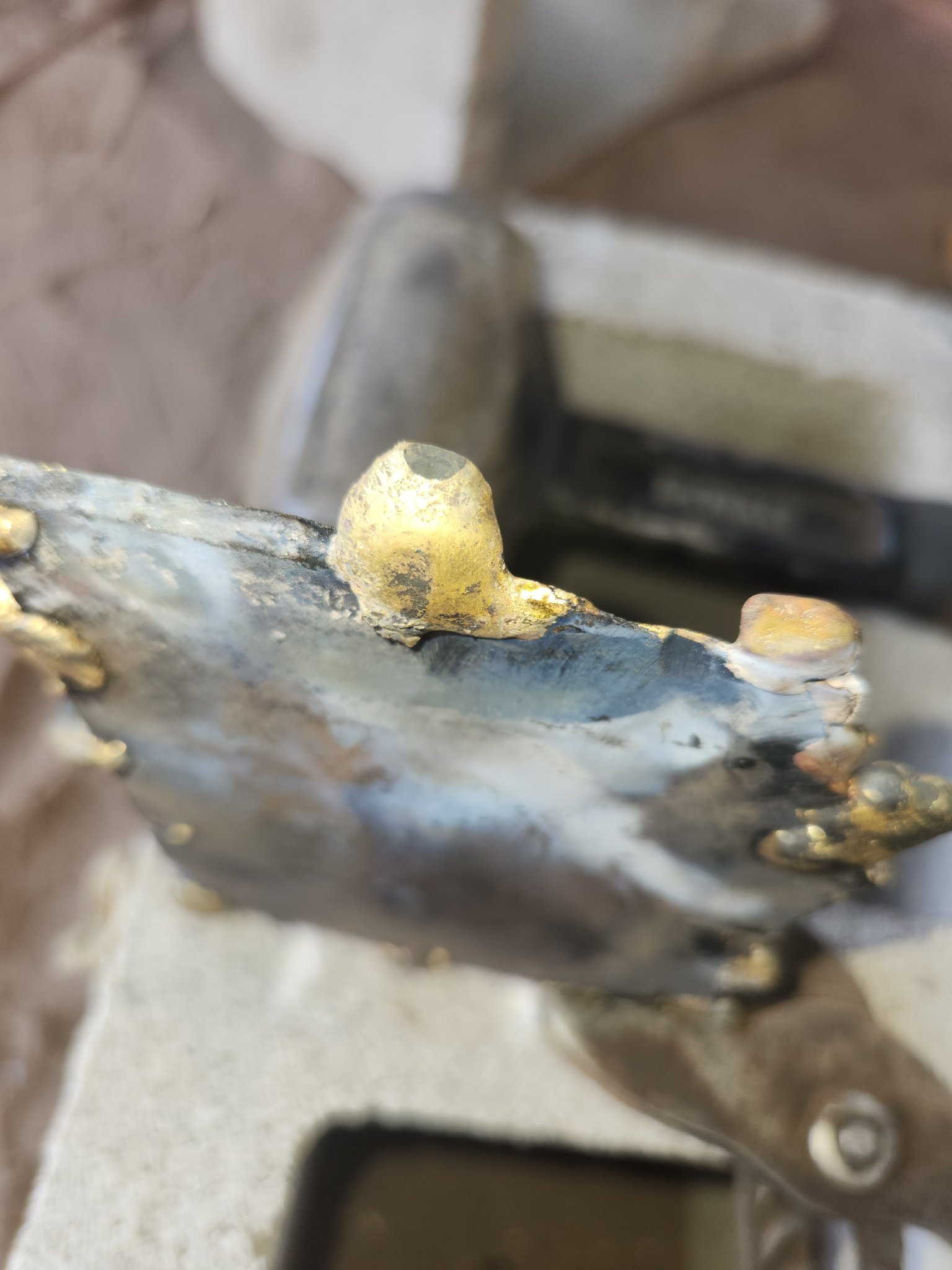

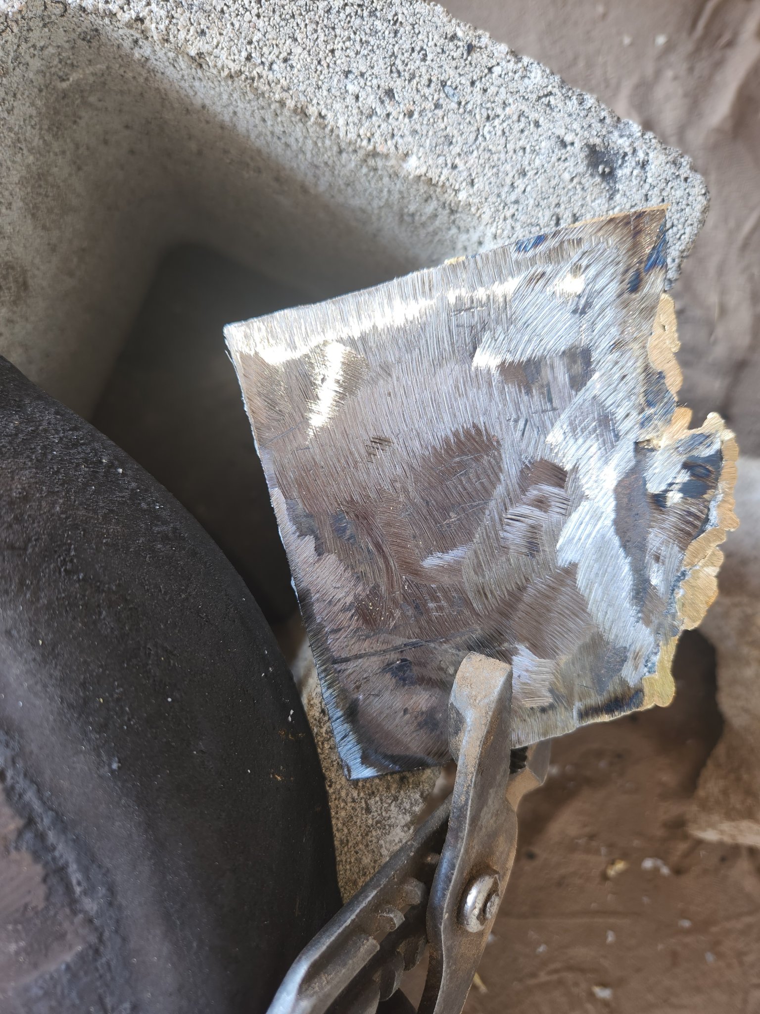

Bronze sticking well to patch but not to the cast iron skillet
Hit the cast iron and steel patch real hard with grinding wheel

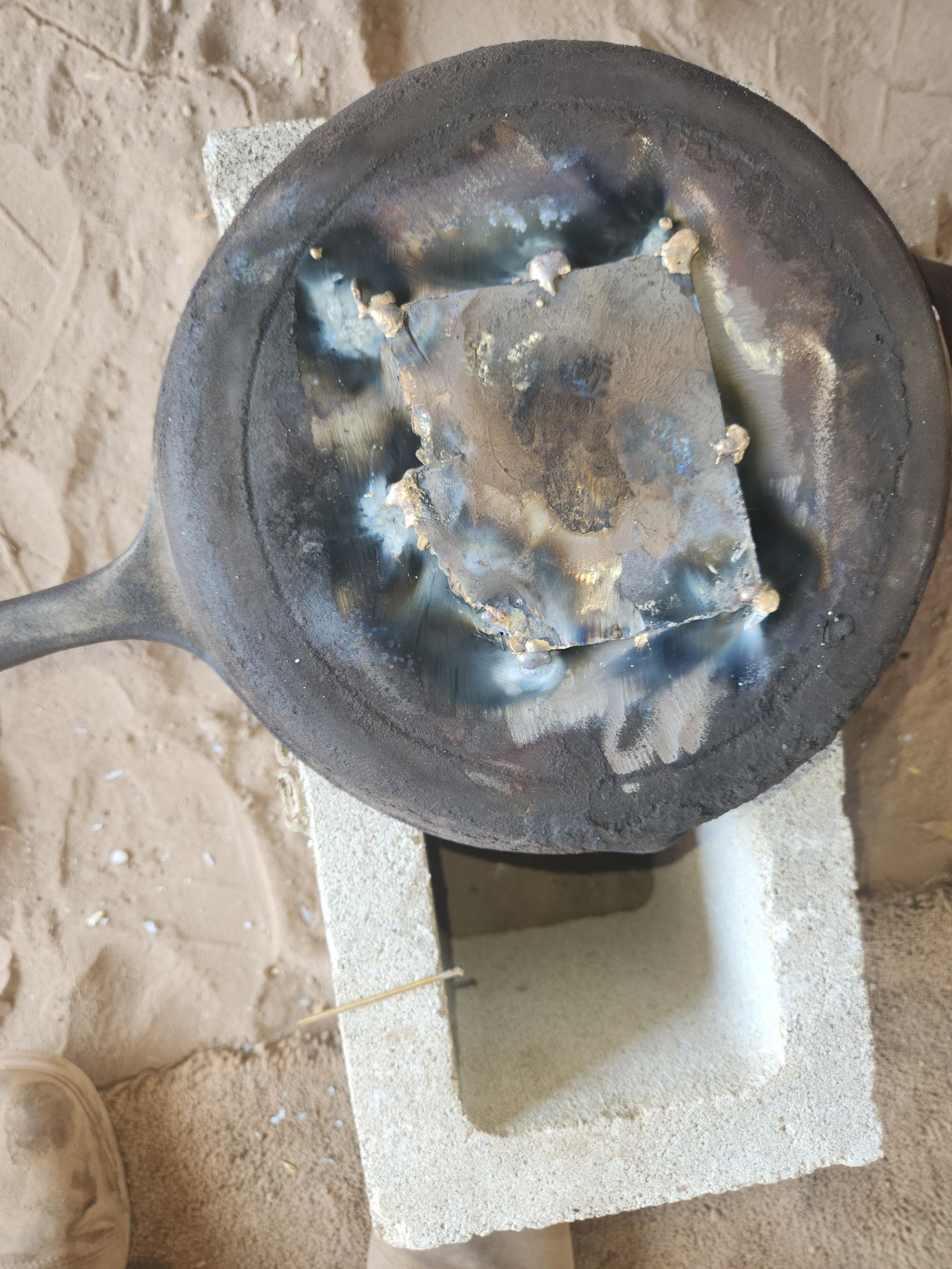

Second try with new data,
Forming beads around the patch trying to get it to stick, Hitting the cast iron with flame using right hand, Then coming in with bronze rod using left hand mounting a small puddle, attempting to make the bronze hold the cast iron and the steel
The flame being used
No bronze wants to stick to cast iron skillet, Bronze sticking very well to steel patch
My theory: not enough heat on the iron skillet to allow it to bond to the bronze
My next experiment: Hit the cast iron with the flame until you noticeably see the cast iron melting, I need to get it to that point so that the bronze can bond with it
This weld I am showing: Hit it with sledgehammer thinking it would break, nope, it is fully bonded to the patch, most of them are

Some thoughts.
Beads show that there is not enough heat. Try preheating the pan in the oven and see if that helps in your test case.
Cast iron needs to be clean. When you get to the engine, you may need to bake out the engine oil and other contaminants prior to grinding.
Rods will work better when coated with flux. Before brazing, also apply flux everywhere you will be brazing to prevent metal from oxidizing and blocking braze.

"My next experiment: Hit the cast iron with the flame until you noticeably see the cast iron melting, I need to get it to that point so that the bronze can bond with it"
I do not think you want to to see the "cast iron melting". Admittedly it has been a long time since I did any brazing but I did spend a year going to WCTI and received a associate degree in welding right out of high school.
I think what you want to see is a cherry red heat zone and you might see just a small circle of the cast iron right at the center of the heat zone start to get what I call a "wet" look.
I agree with Jim L that the pictures you posted all look too cold for the brazing filler rod to flow correctly. Pre heating the pan will help for sure along with pumping in more heat and moving at a quicker pace as you add filler rod.

I'm the least qualified on this thread, but we all agree the cast skillet is not hot enough. The block wil be more of a challenge.
* You could try preheating with a propane torch like people use to burn weeds. Preheat a large area and maybe keep heating while you braze. This is where a third hand might be useful. This will take a lot of propane, but it is cheaper than acetylene.
* Insulate the outer part to reduce the heat loss and keep the object at as constant temperature throughout as possible.

Clue: YOUR amateur brazing ain't gonna work on the frying pan, and even less so on your engine block!

forget about the patch for now
instead get the heat on the cast and see if you can get a small pool of bronze to attach to it.
in 'soldering' this would be called 'tinning'.
yes, you'll require practice maybe 1-2 hours before you get the process down.
You can not put enough flame to it to melt cast iron!
You need to take your pan and throw it on a BBQ grill on high for a min of 15 min.
Your patch needs to fit into the hole ( like a plug not a patch) so not over it the cast.
You need plenty of flux and a good rod, heat both materials till the Brazing rod flows to it.
You can use mutiple passes to build the patch up and seal the hole.
Also your flame is not adjusted properly because you're leaving soot on the parts.
