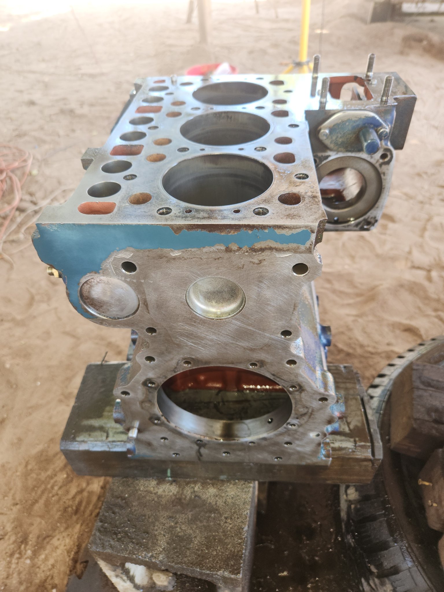

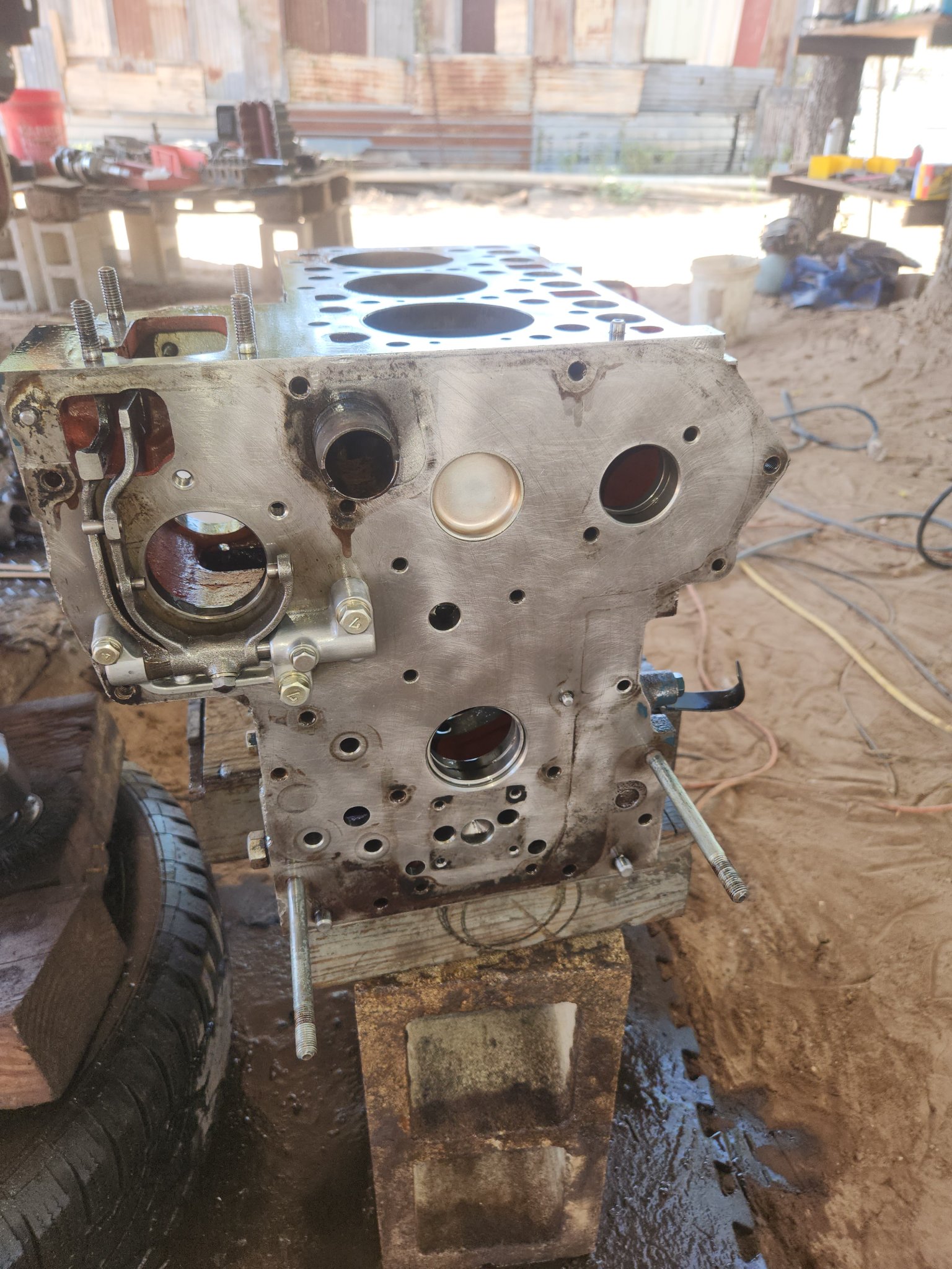

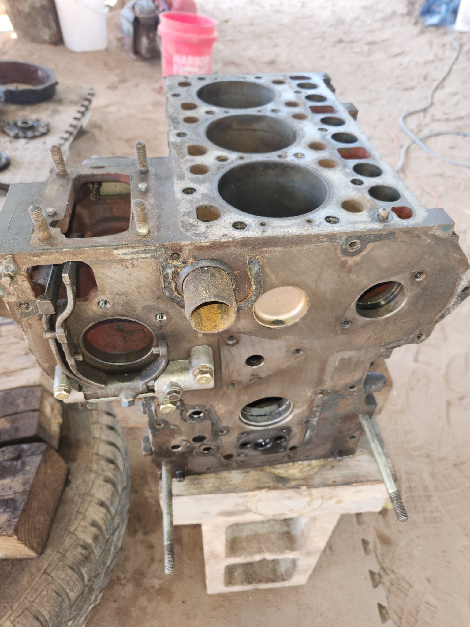

Hit the block with abrasives, first cleaning
Before cleaning: stuck on gaskets all over, lower ports clogged, head has gluey substances/gunk buildup...
Stuck on gaskets, gunk buildup, etc
Used a brush and applied diesel to the engine block

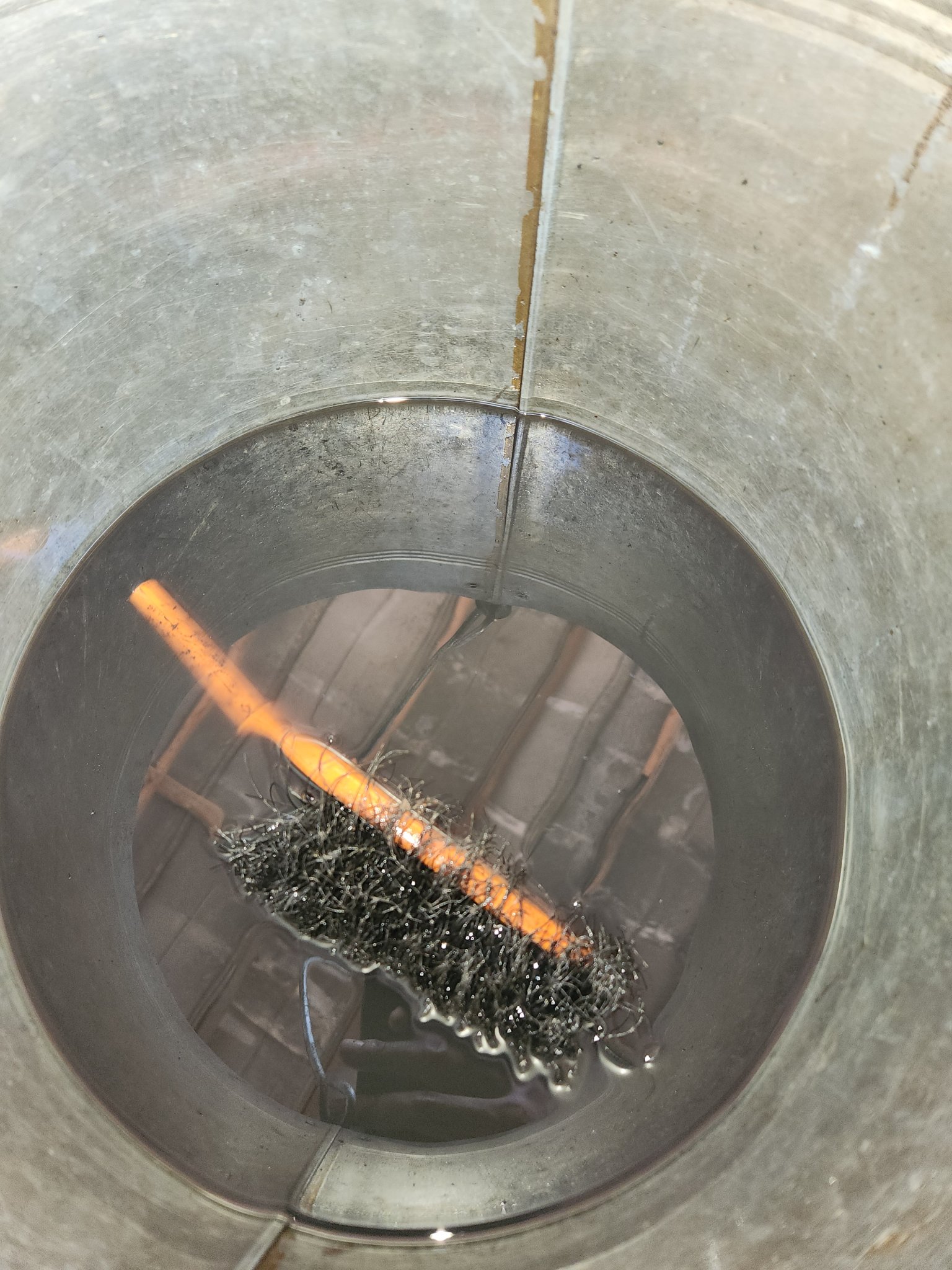

container of diesel: dip whatever abrasive being used in here frequently: wire wheels, nylon strip disc, window scraper
First wash: still need to hit it real hard at the bottom to get rid of the buildup, go through all the ports with a pik and clear them
top of block looking smooth, got rid of the stuck gasket on this side, still gonna get hit again with abrasives
This side looking cleaner, still has some stuck on gasket material, hit it again with nylon stripping disc

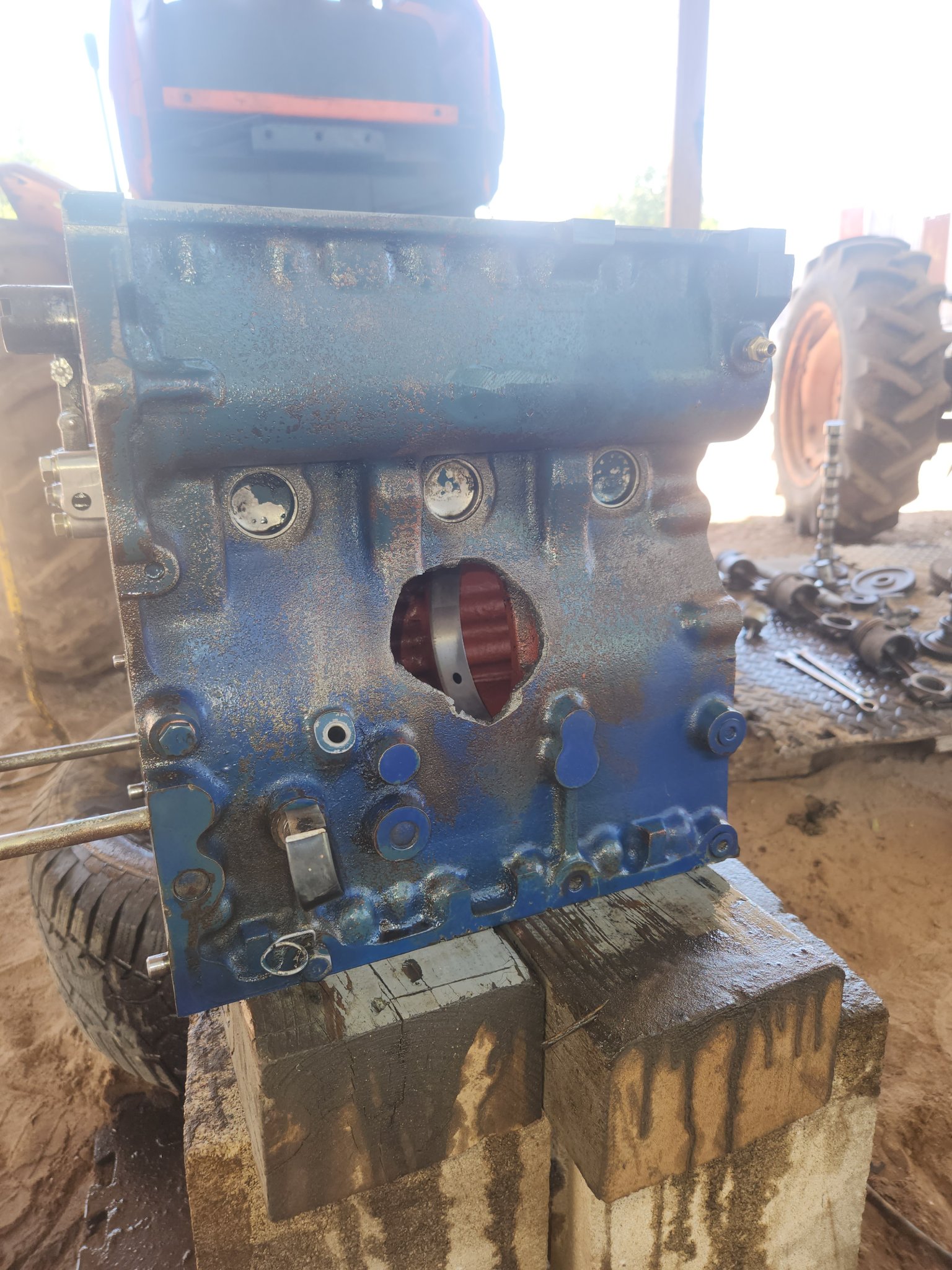

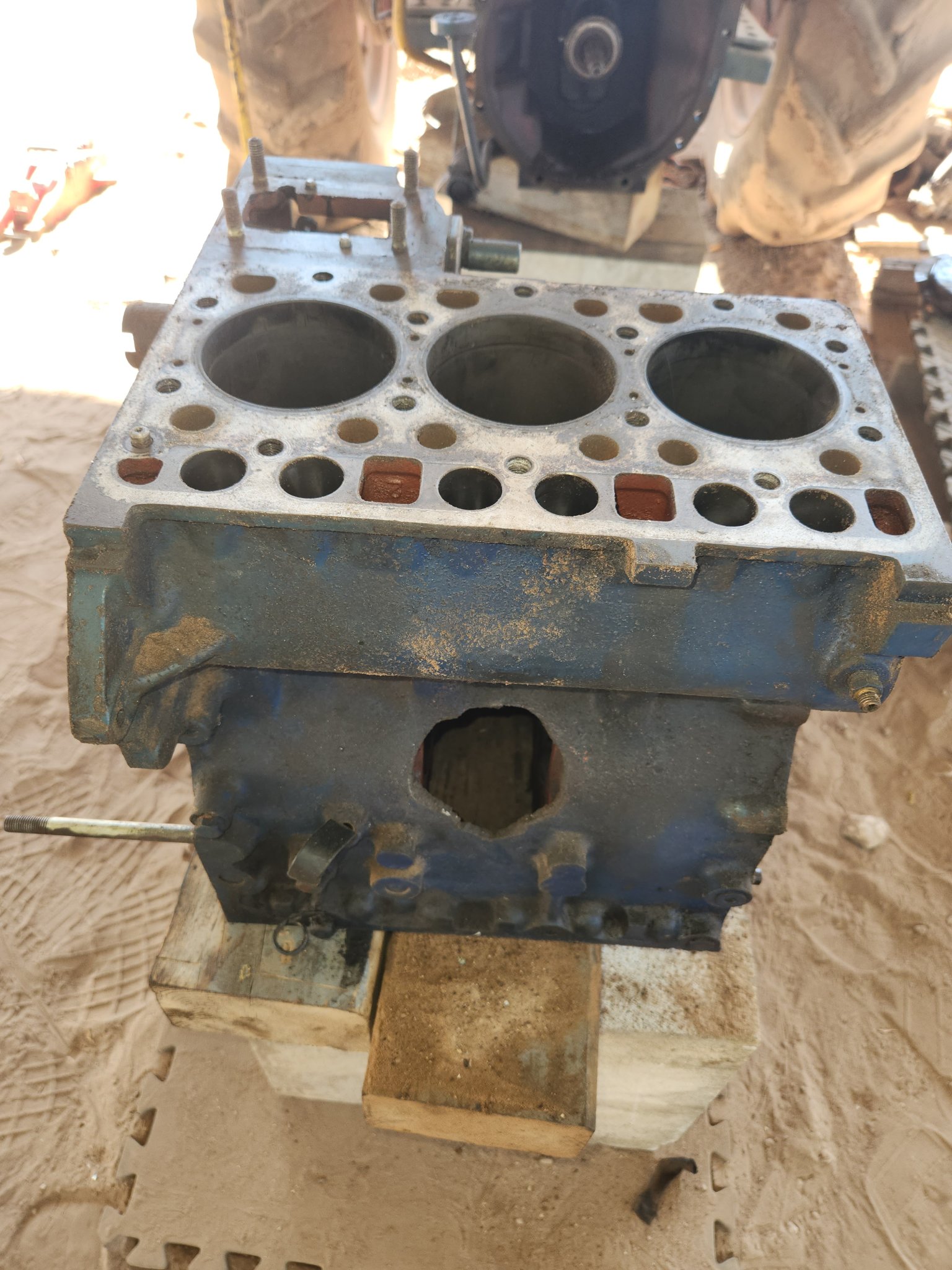

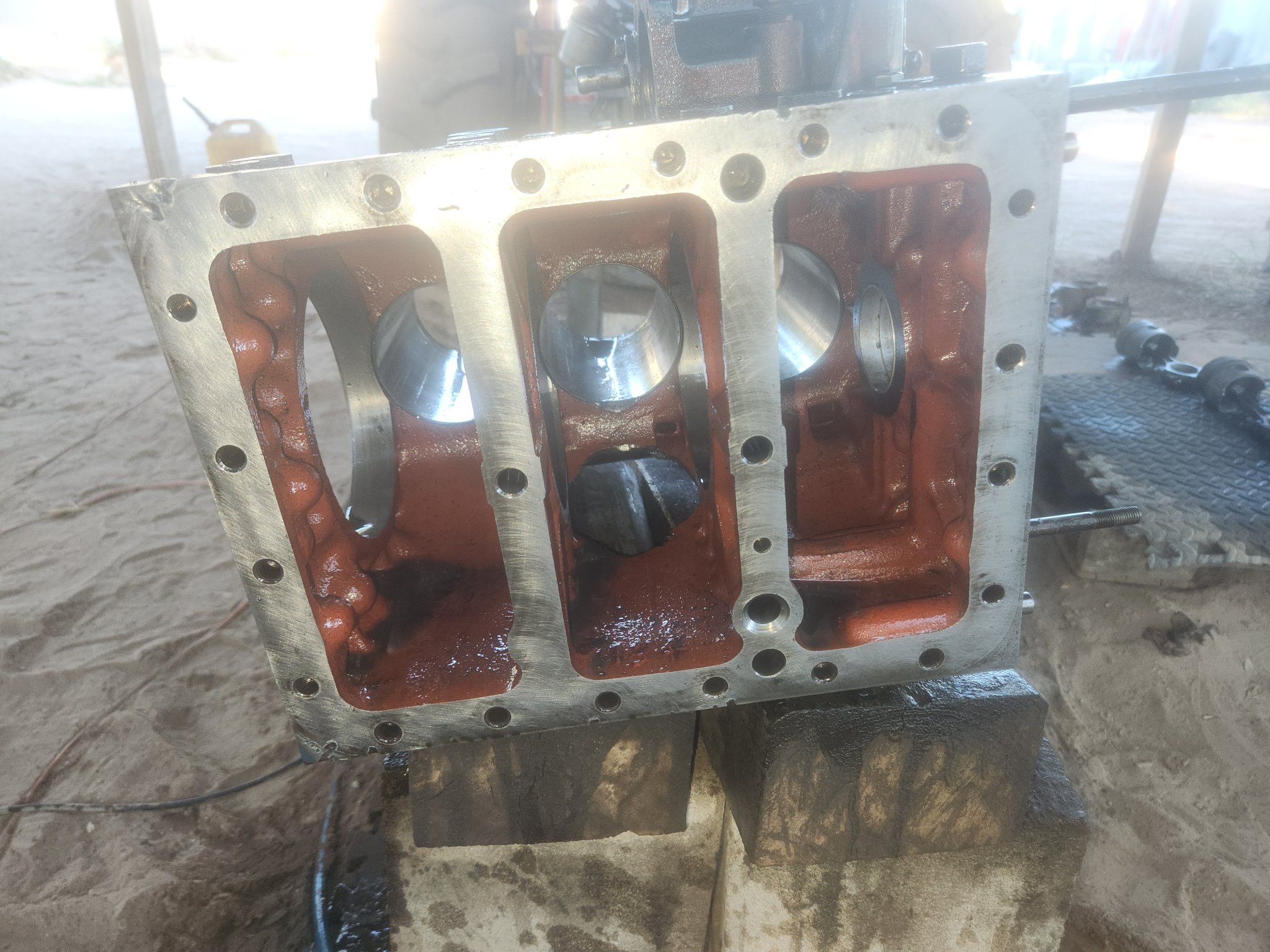

The hole in the block, still preparing the brazing repair

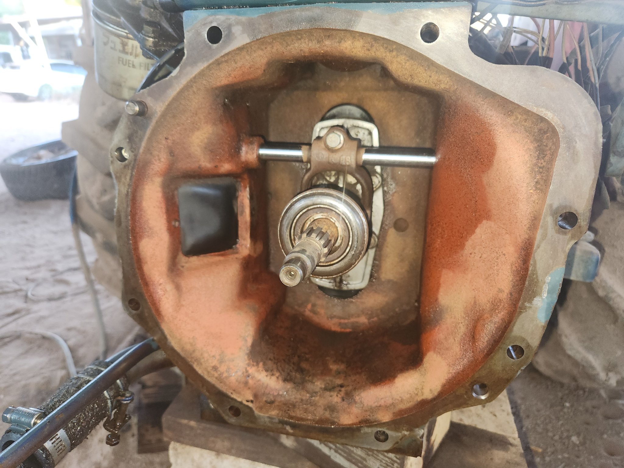

Now: hit the gears/pistons/camshaft/clutch/bell housing/the bolts with wire wheels and other abrasives, and go through the engine again with abrasives, hit the cylinders with wire wheel, get rid of all stuck on gasket material
View attachment 135414 View attachment 135415

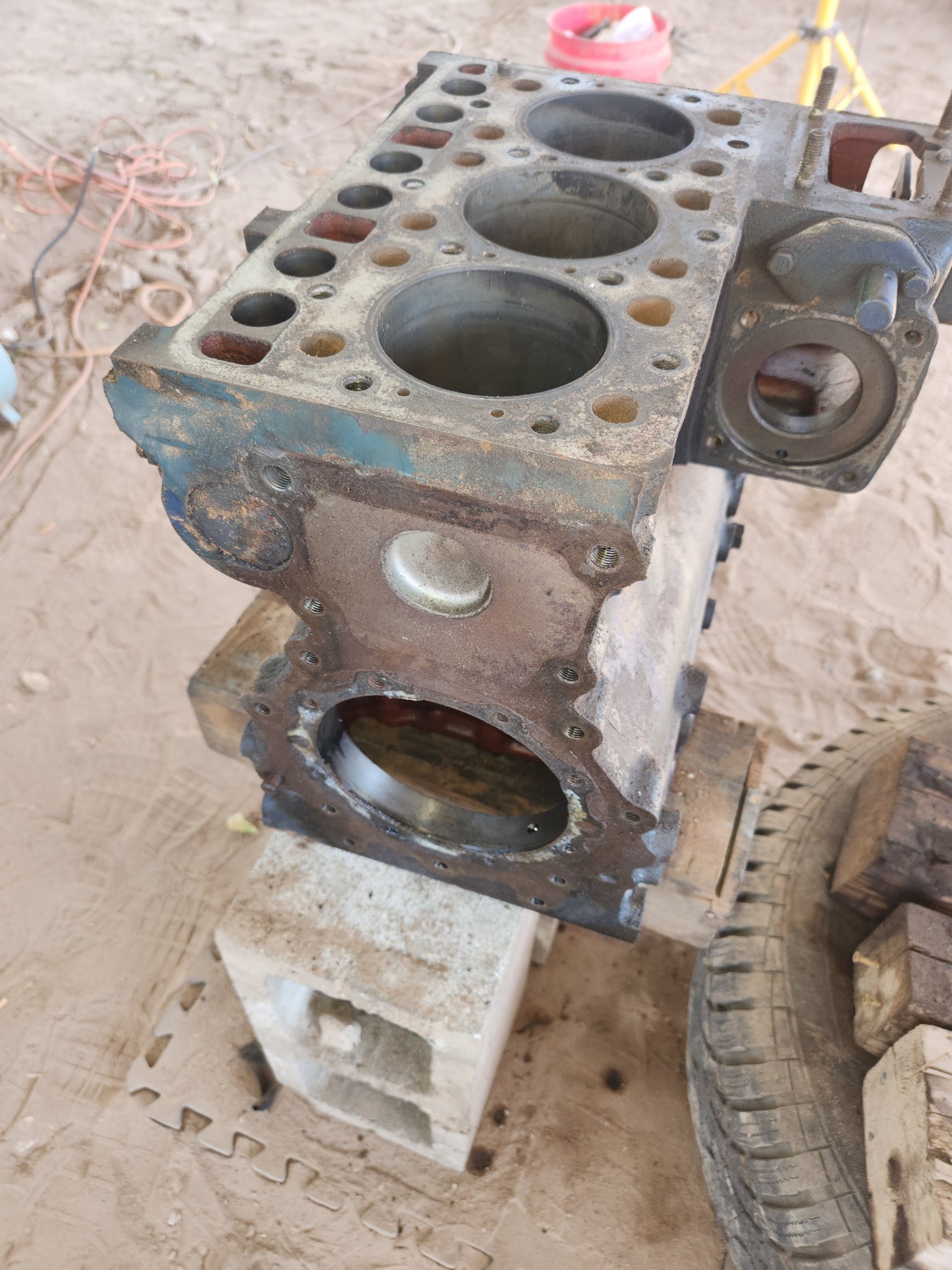

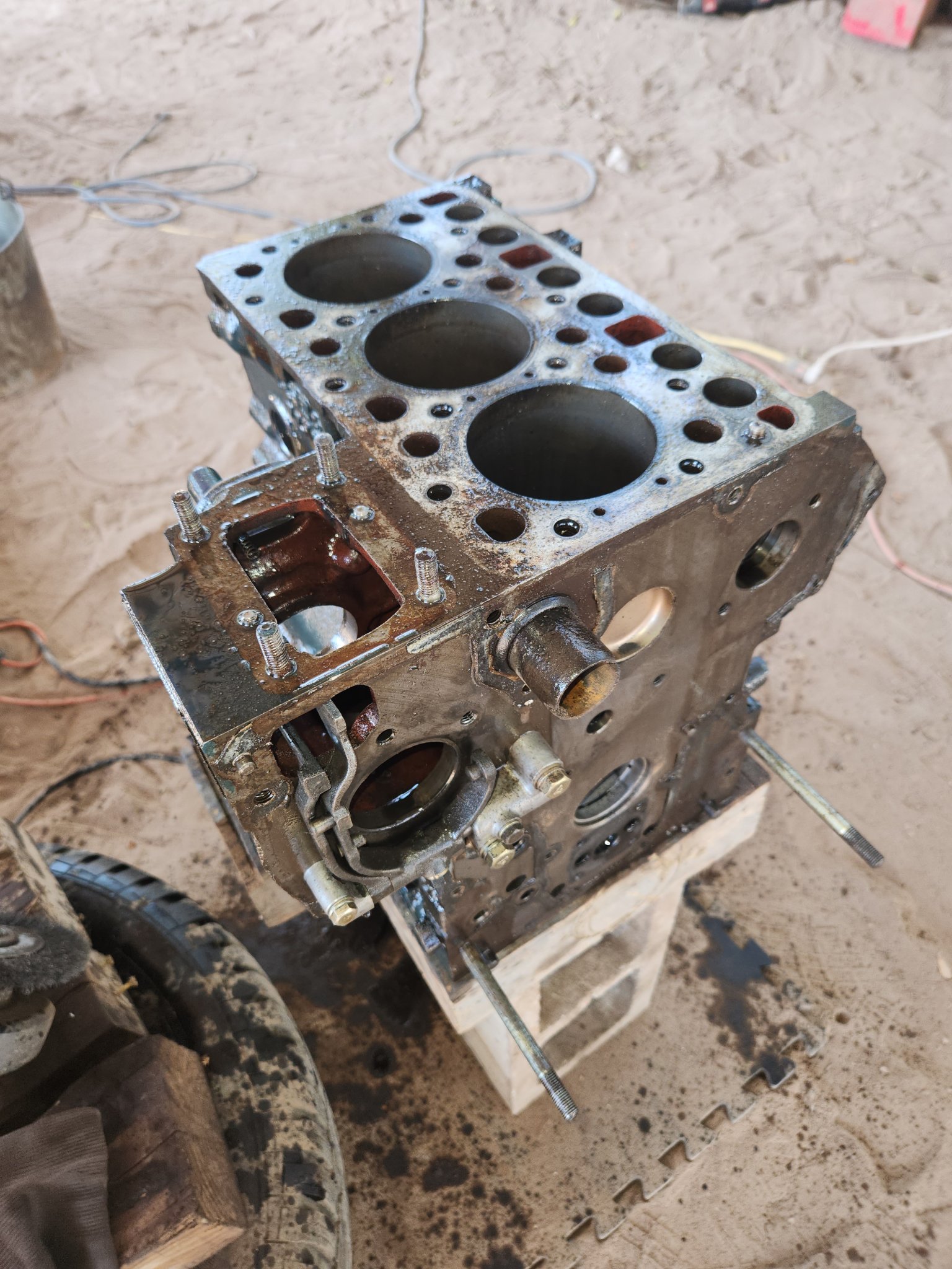

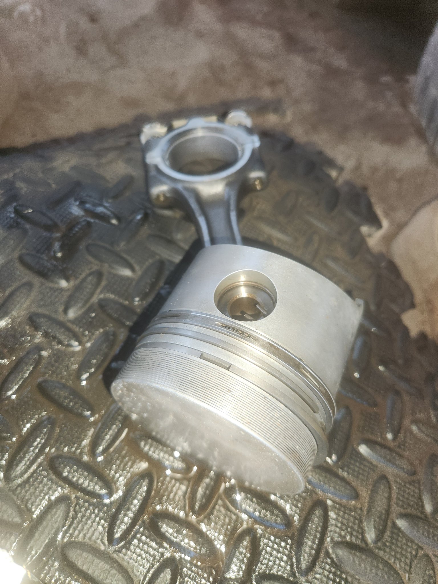

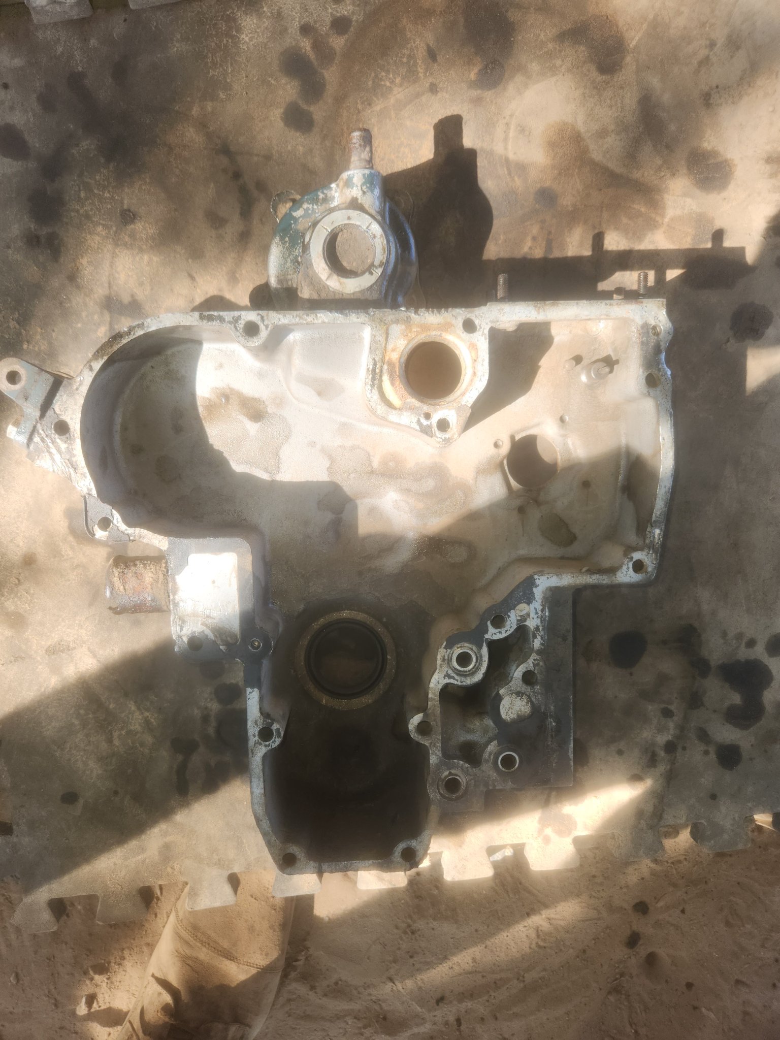

Hit everything with wire wheel and nylon stripping pad
Before cleaning
Spent lots of time stripping away stuck on gasket on crank casing using nylon disc on plug in drill

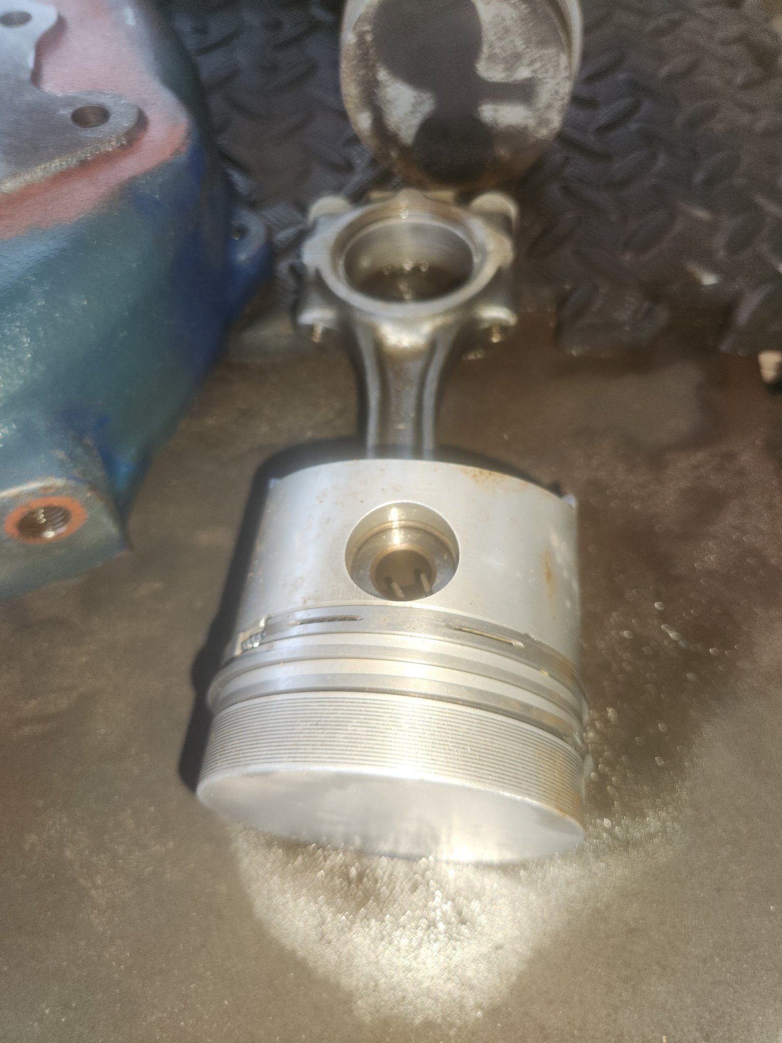

Piston #1 before cleaning

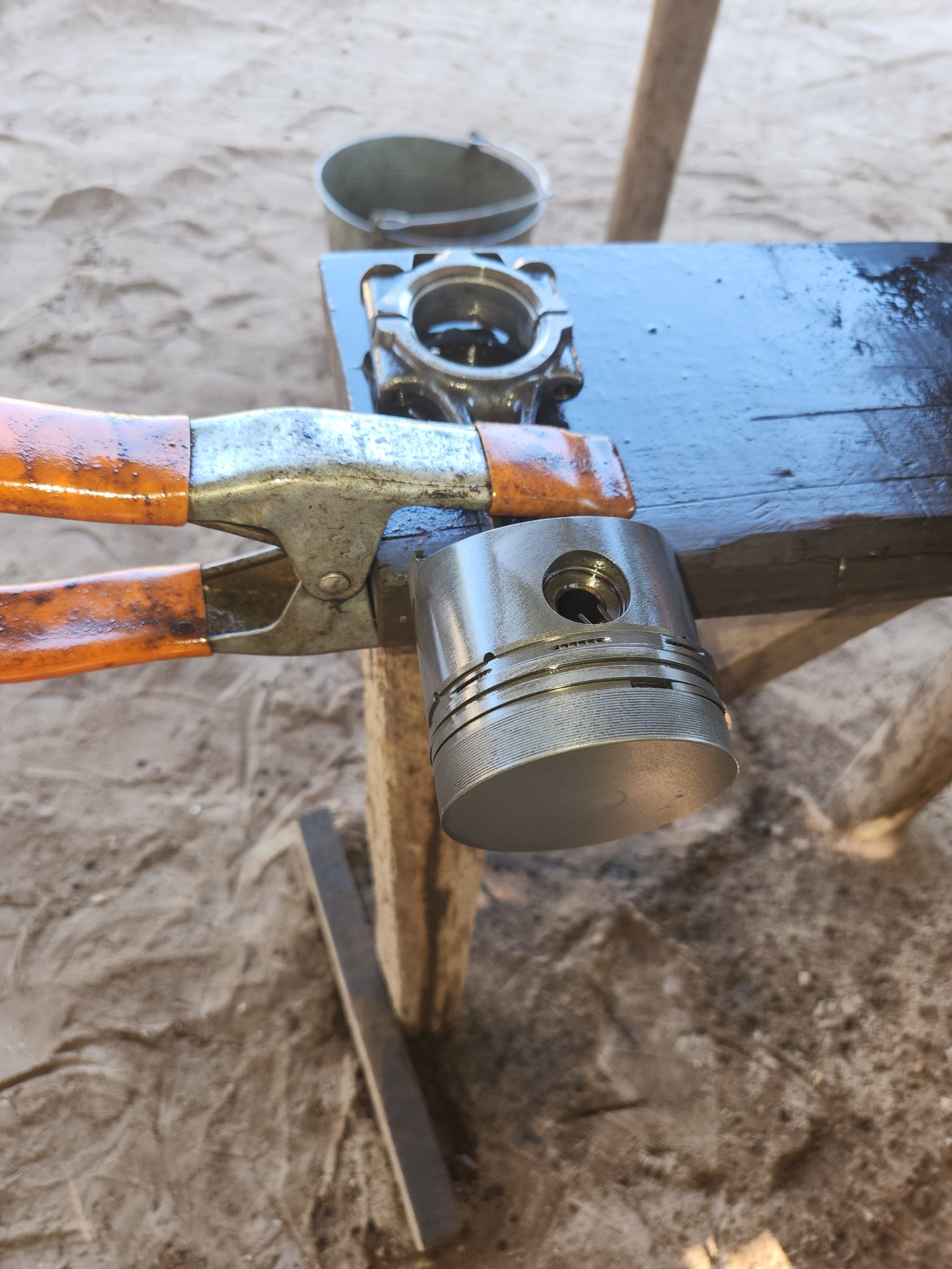

Holding piston down using clamp, hitting piston hard with 6 inch soft wire wheel, diesel soaked

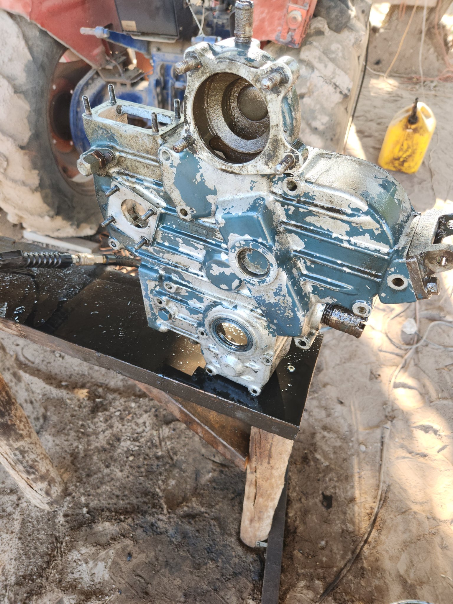

Gear case before cleaning
Scraping stuck on gasket with window scraper, hitting it with nylon disc, hitting overall area with brass front facing wire wheel
Tilted block 90 degrees, time to hit oil pan gasket with window scraper/nylon disc

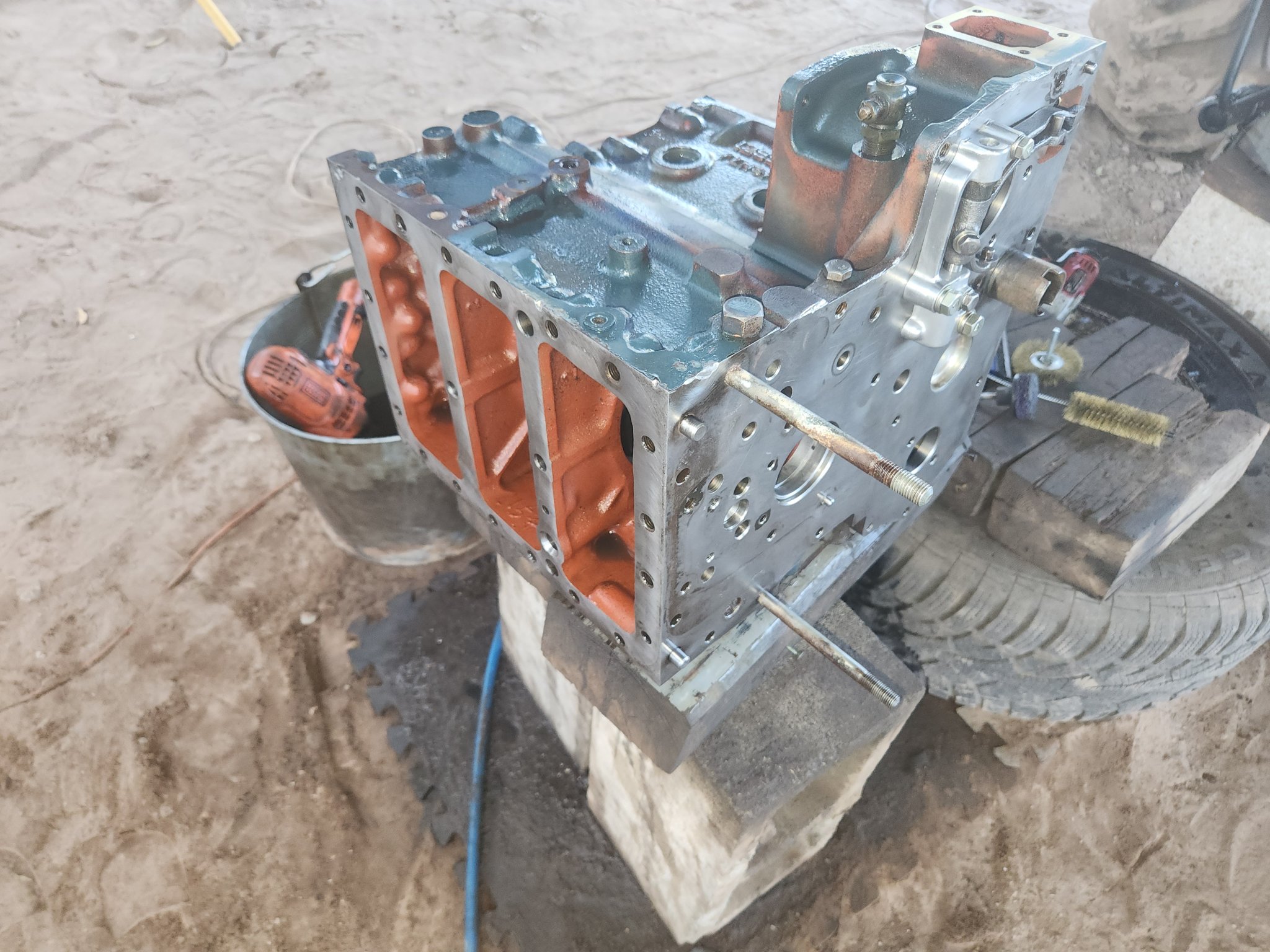

After abrasives

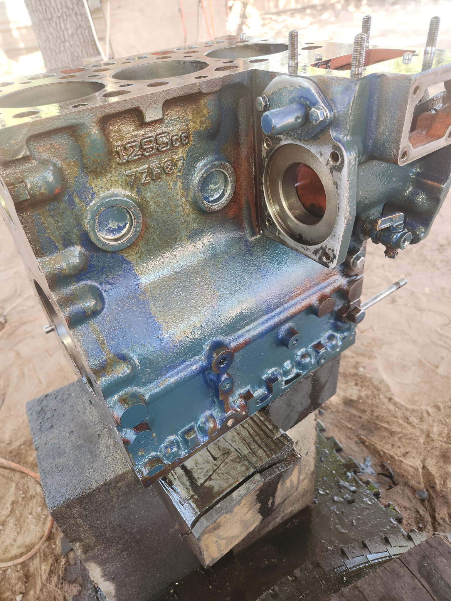

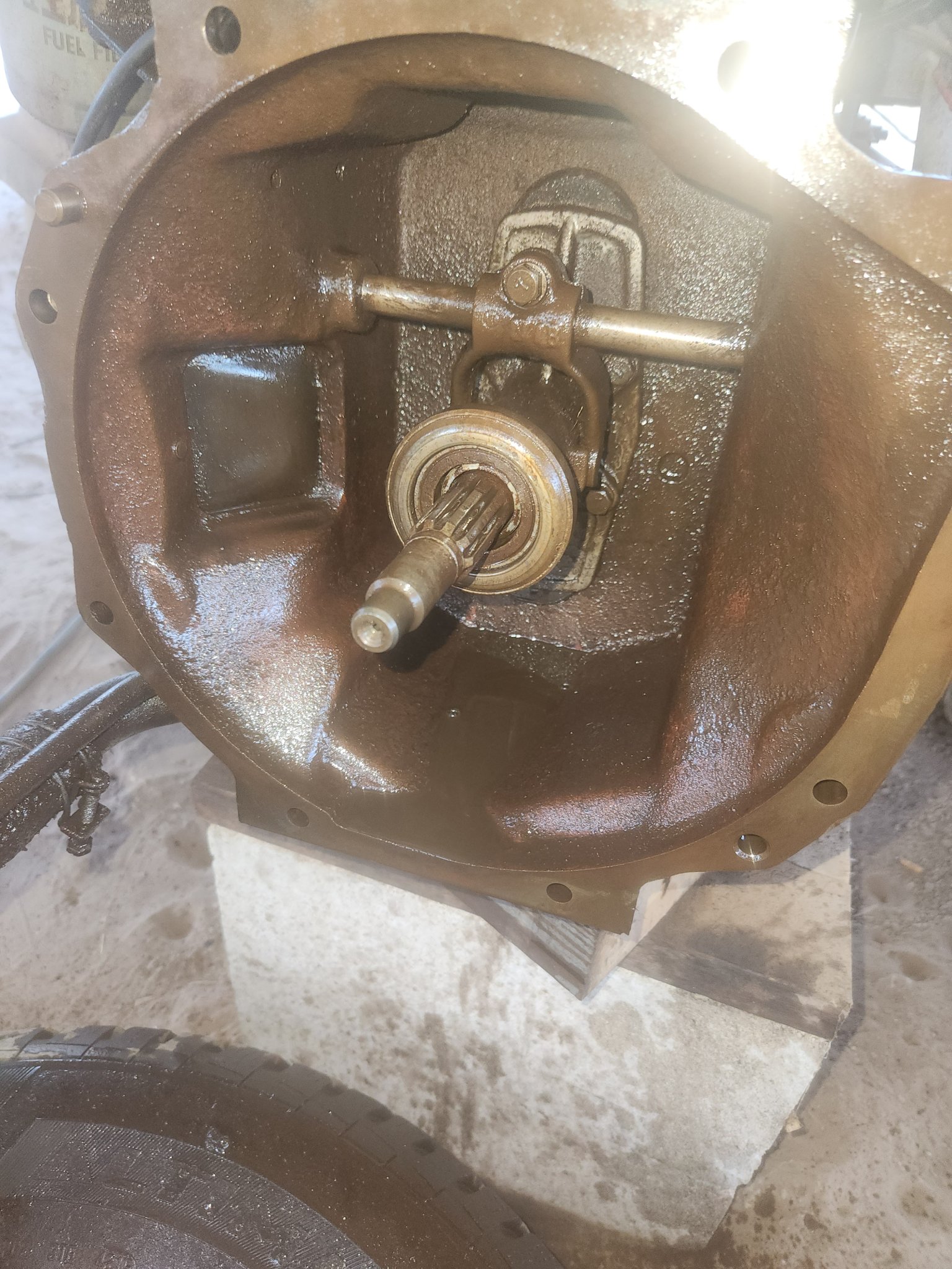

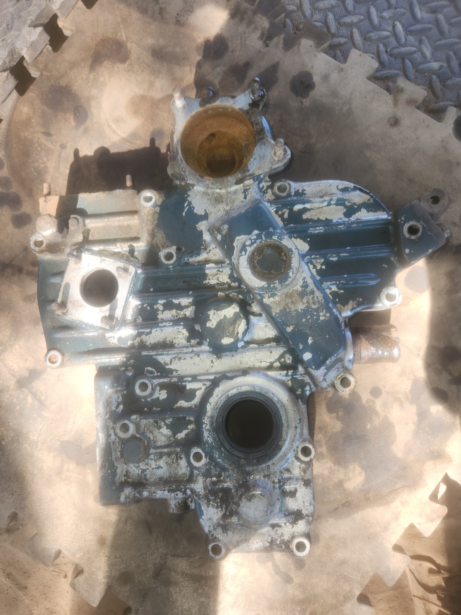

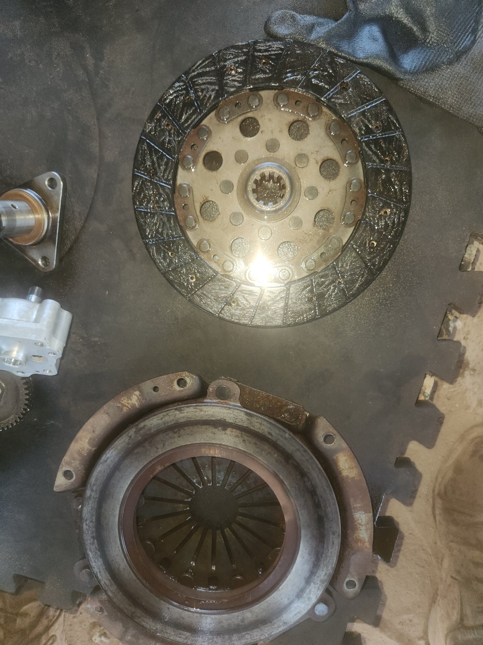

More cleaning

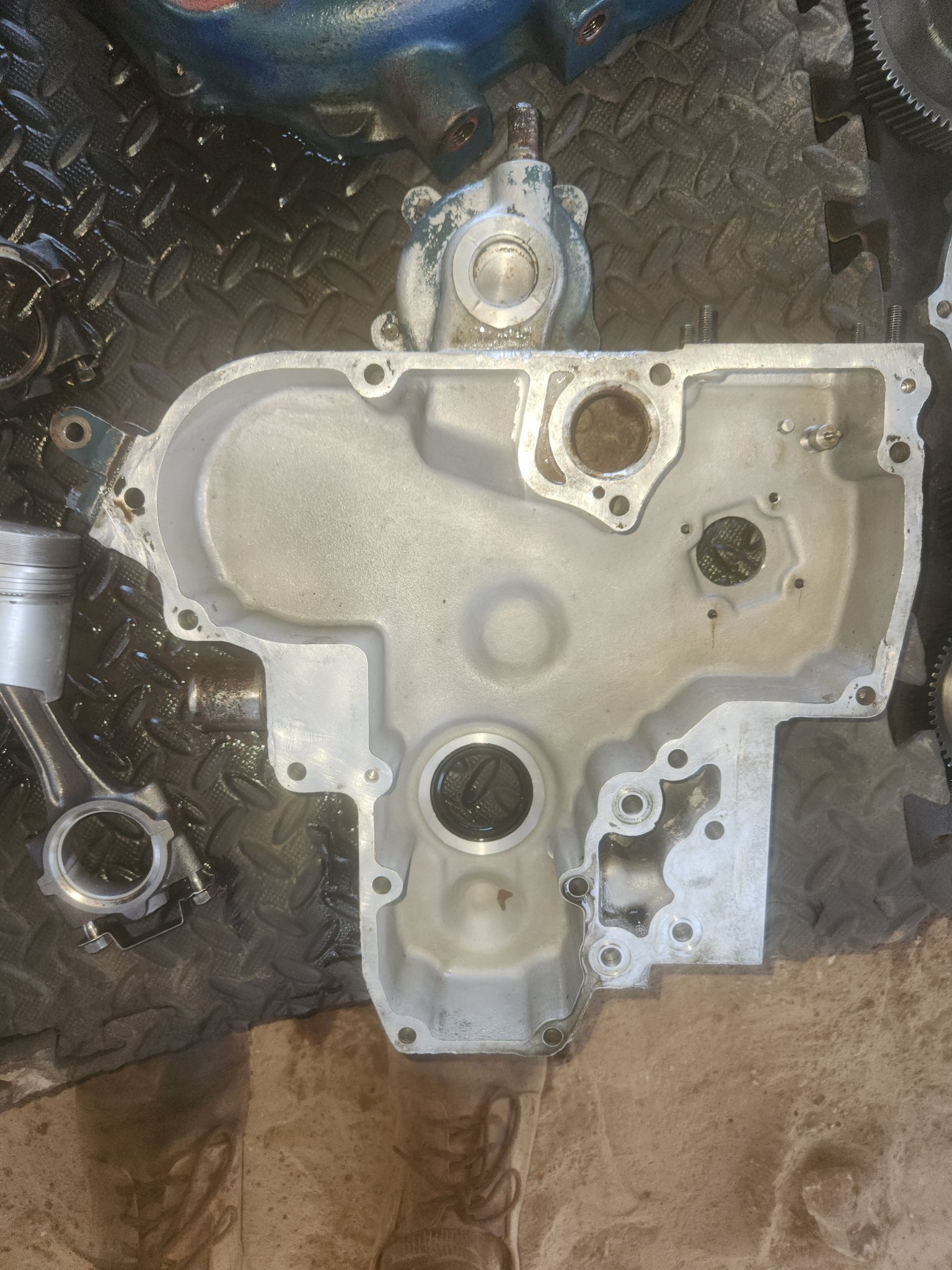

Gear case cleaned
Backside clean

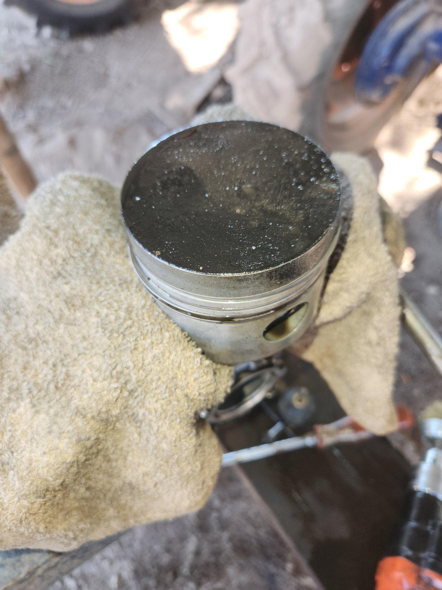

Piston #1, does have pitting on its head
Piston #3
Camshaft cleaned and other gears/parts

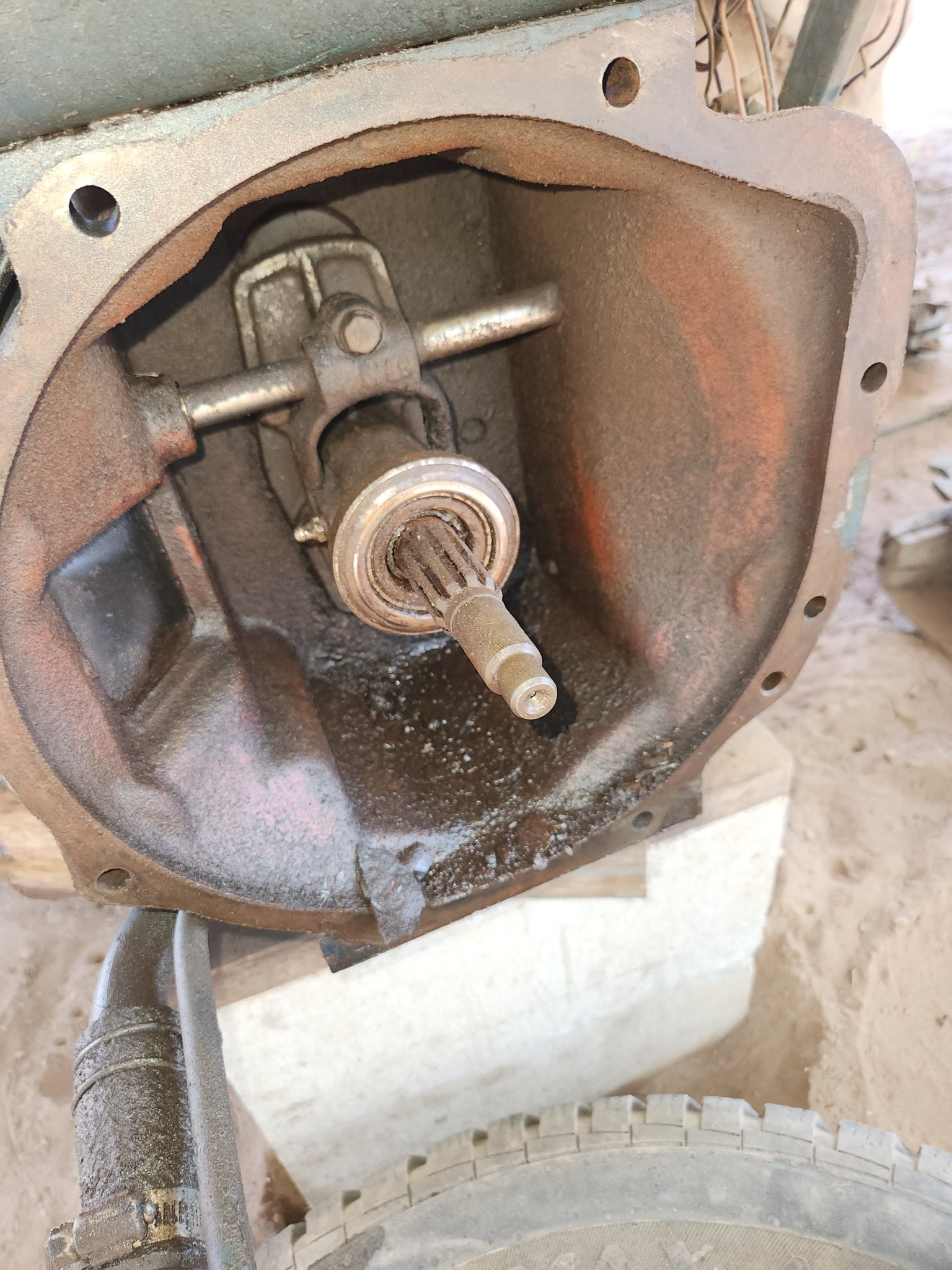

Clutch cleaned
Flywheel cleaned
Scrub area with diesel
Block looking cleaner
Cleaned this area
Next steps: Fill up oxy ace tanks, get bronze rods, get the flux, figure out exact material that will be used for the patch, cut the patch a nice even shape and grind the block into that same shape
Ideas of what material I have laying around that can be used for the patch: bx1500 bucket broke and there is a piece laying around. Maybe cut 3.5'' by 3.5'' of that steel, I think it is 1/4 steel. That might be better to use than the cast iron since it will be malleable, and I would not be able to shape the cast iron...
