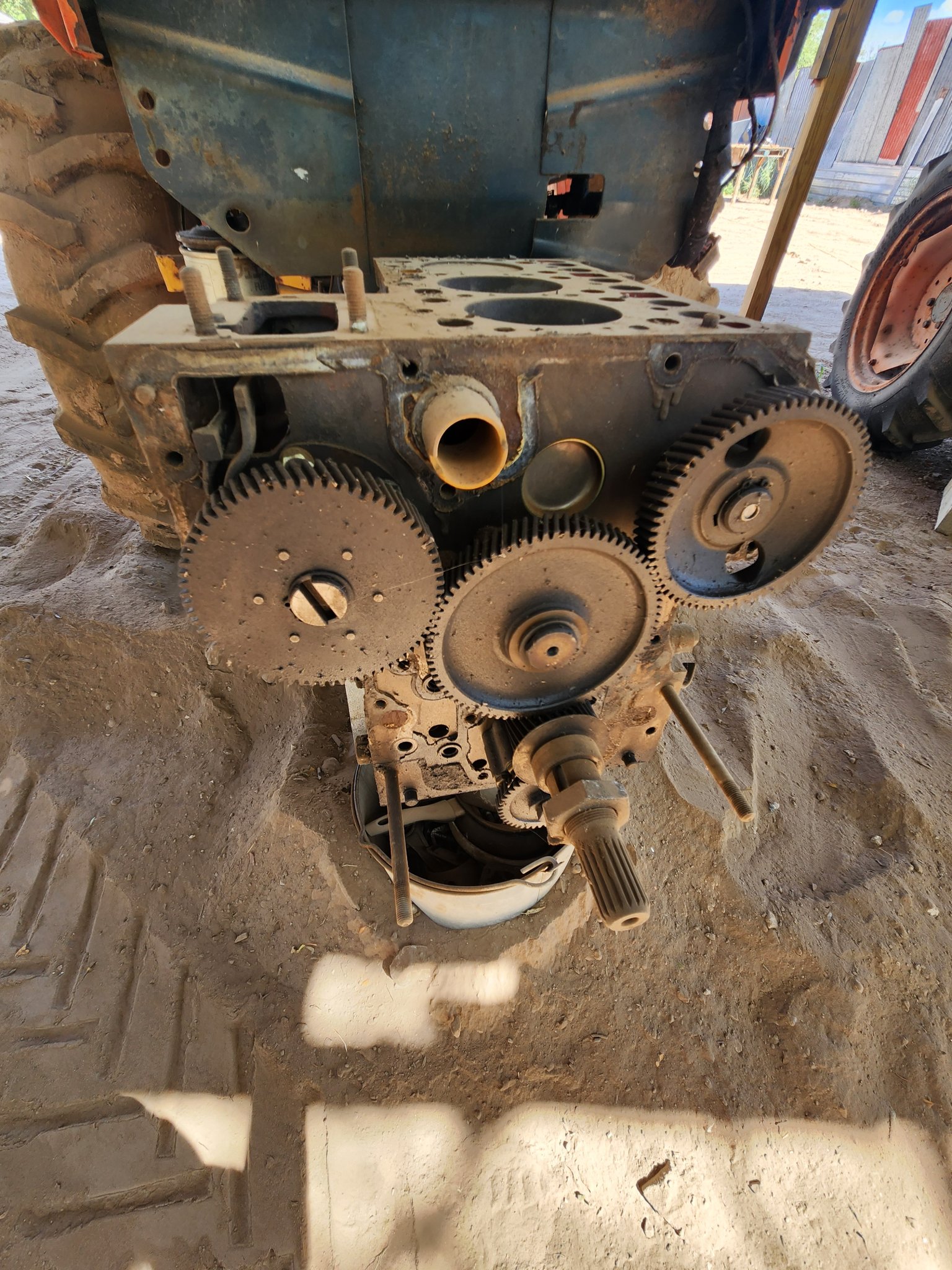

Took out pistons from block with hole
Cleaned up shop, reorganized all tools, hit all areas with compressed air, leveled the ground using bx1500
Dusty engine, before hitting it with compressed air/diesel/wire wheel

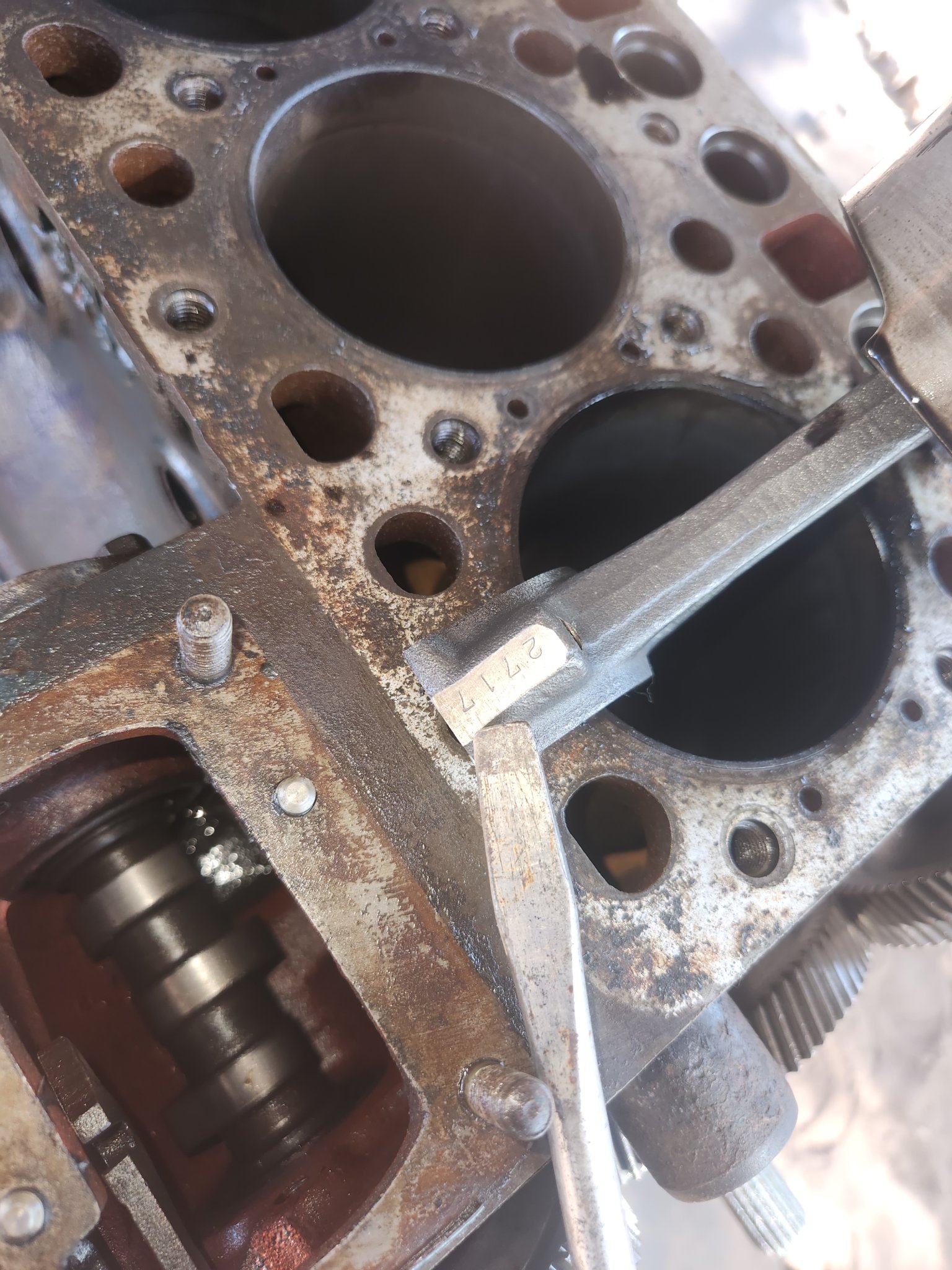

Popped out piston #1, exposed bolts and took 1 minute long video showing the gears and the backs of them and how they are put together
Pointing to piston serial, facing right of tractor

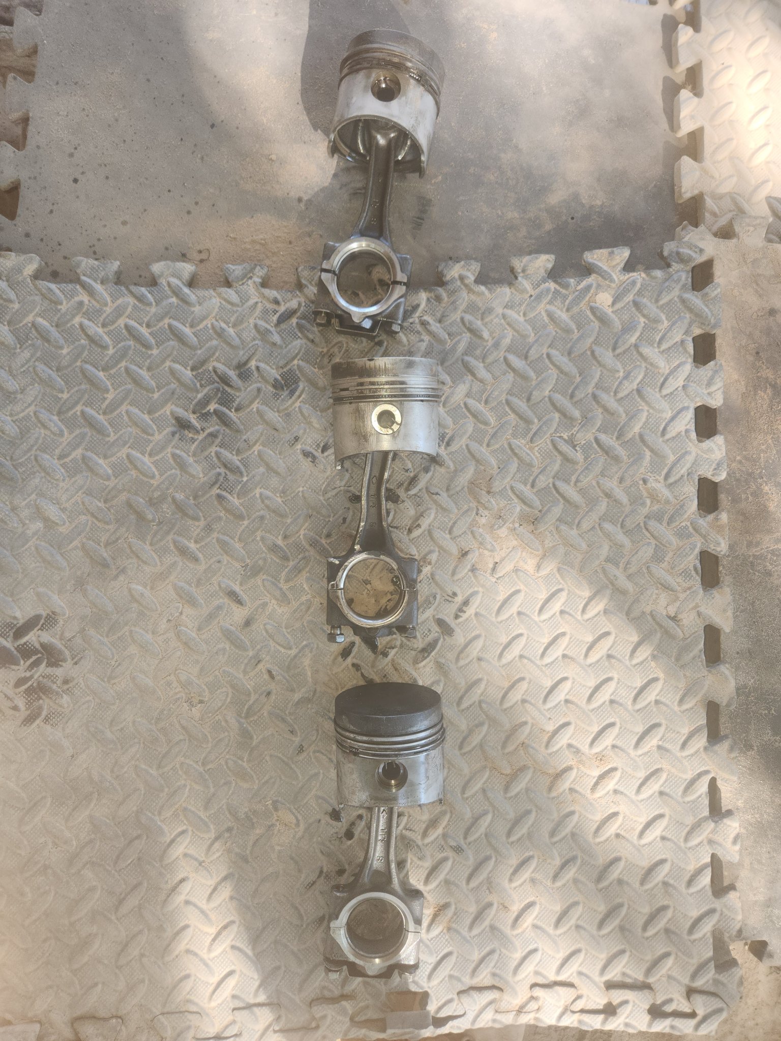

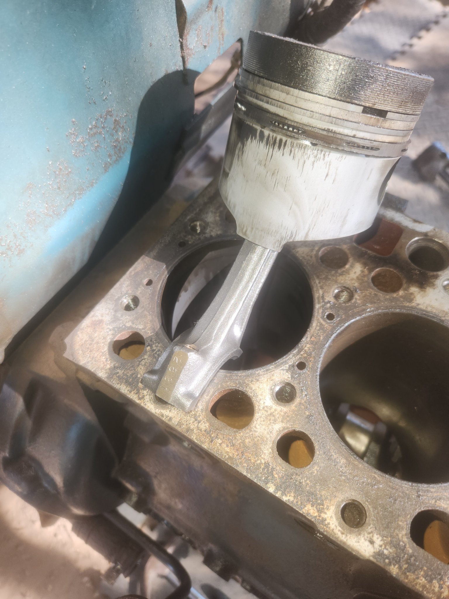

Popped out rear piston, serial facing right of tractor
Three pistons removed from engine with hole in it, notice how the top piston in the picture might have a bent connecting as well as the middle piston (that put the hole in the block)
That is piston #3, furthest from the front of tractor, I compared these connecting rods to the ones from the engine without the hole in it, and those ones looked more straight
When I spin the crankshaft, I am pointing maybe some kind of metal that got crushed into the gear, because it will interrupt the smoothness of the spinning, when this part of the gear touches the gear above it, I can feel it be more resistant
Next plans: carefully remove all gears and all parts, get the block off the tractor, remove the crank casing, then I will look into the welding of the patch onto the block, a permanent fix of some sort, then I fill the bottles with the torch gases, weld the patch onto the block, and if I cant figure it out, I can still take the block somewhere and maybe have it done professionally. not the end of the world, but it is a bummer that maybe there is connecting rod damage other than the center piston that blew the hole in the block

Can't see the bores but judging from the piston skirts you're putting sleeves in that one too. And what does torch have to do with welding the block?
