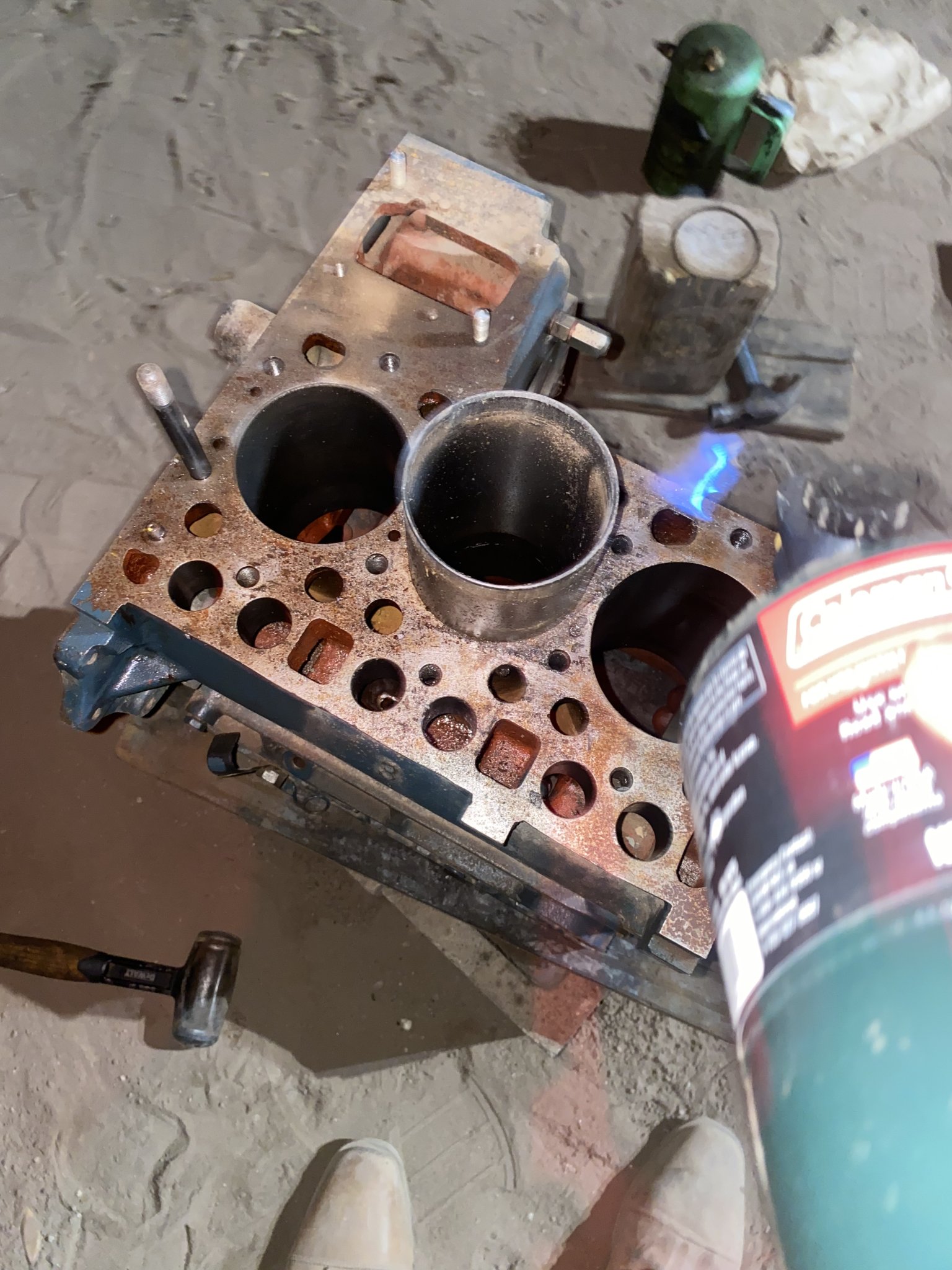

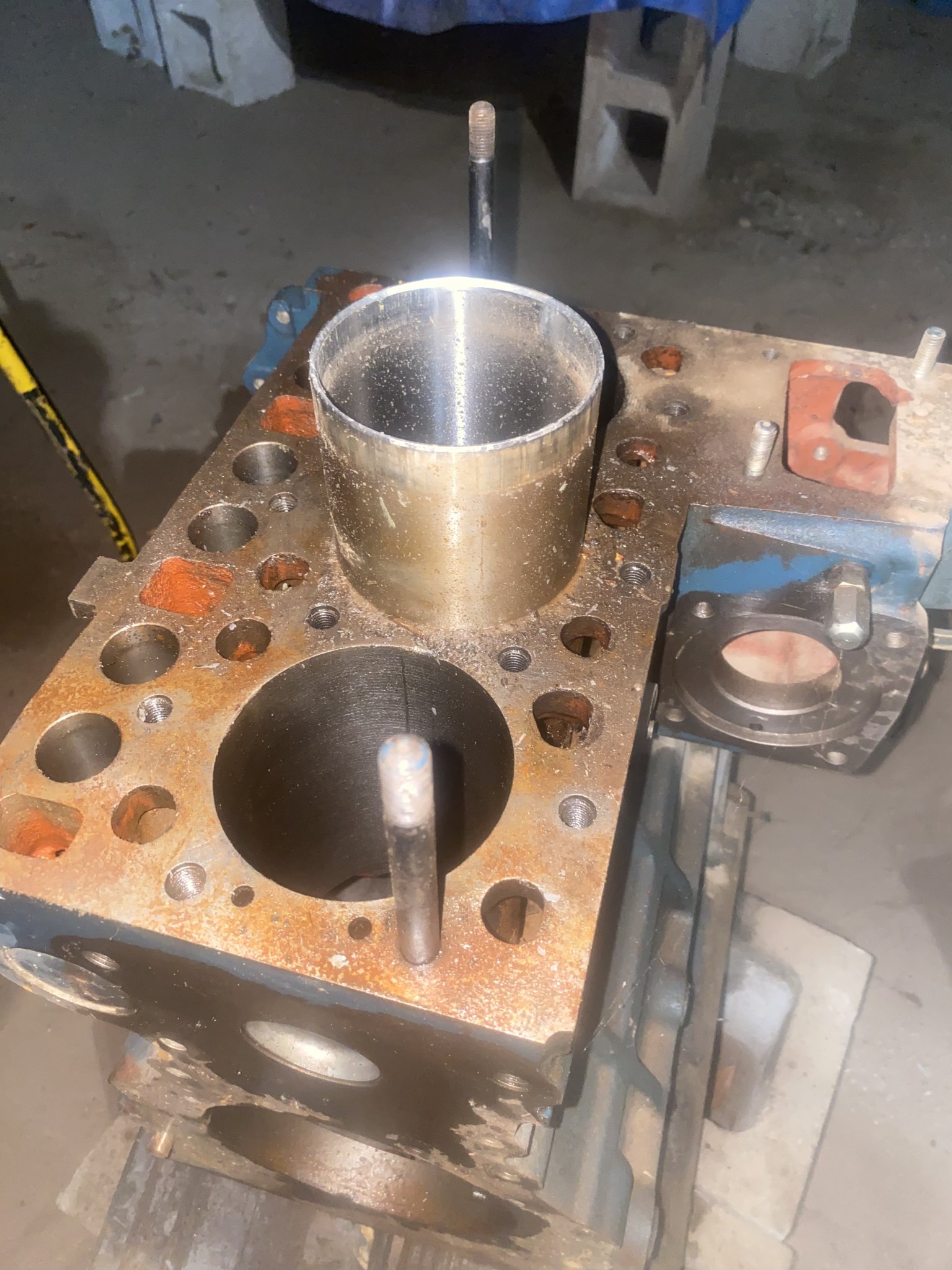

Got two new liners in without press
Sprayed diesel on the engine block, hit it with torch, getting it ready to accept liners
took liner out of freezer, got it into position to hammer it down
Using a 4x6 block of wood, hitting block of wood, pushing liner down, block of wood kept digging into the liner, getting stuck like yall said
Having trouble getting it to move, hit it with torch and diesel, and compressed air
Looked through my junk pile, found this front bumper for this tractor, placed rag in between liner and bumper, hammered down onto bumper, slowing pushing liner into block
Making progress, holding bumper evenly on top of liner with left hand, hammered onto bumper with right hand

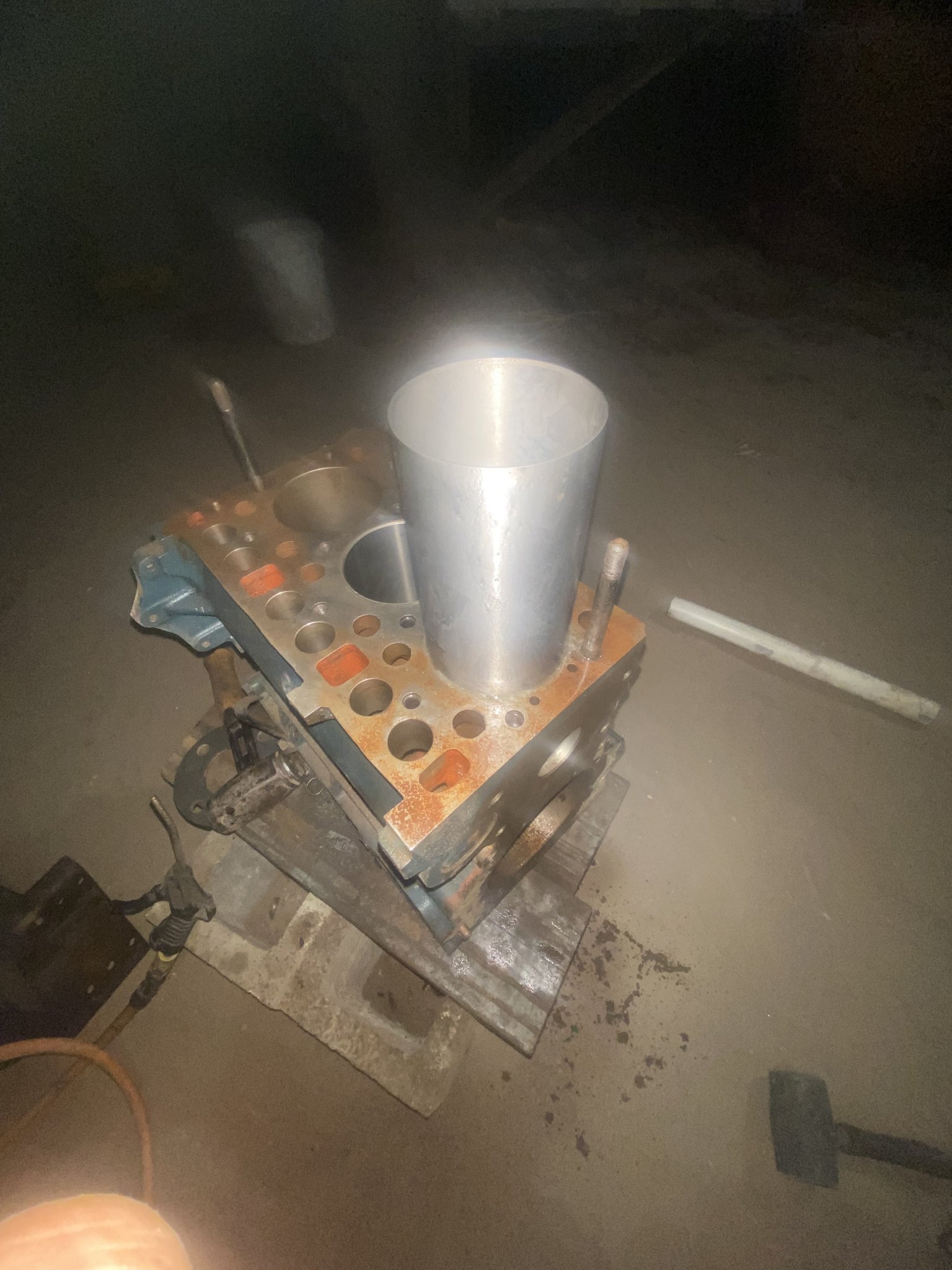

got the liner almost flush with the engine block, using a wheel spacer from bx1500 to finish pushing liner down

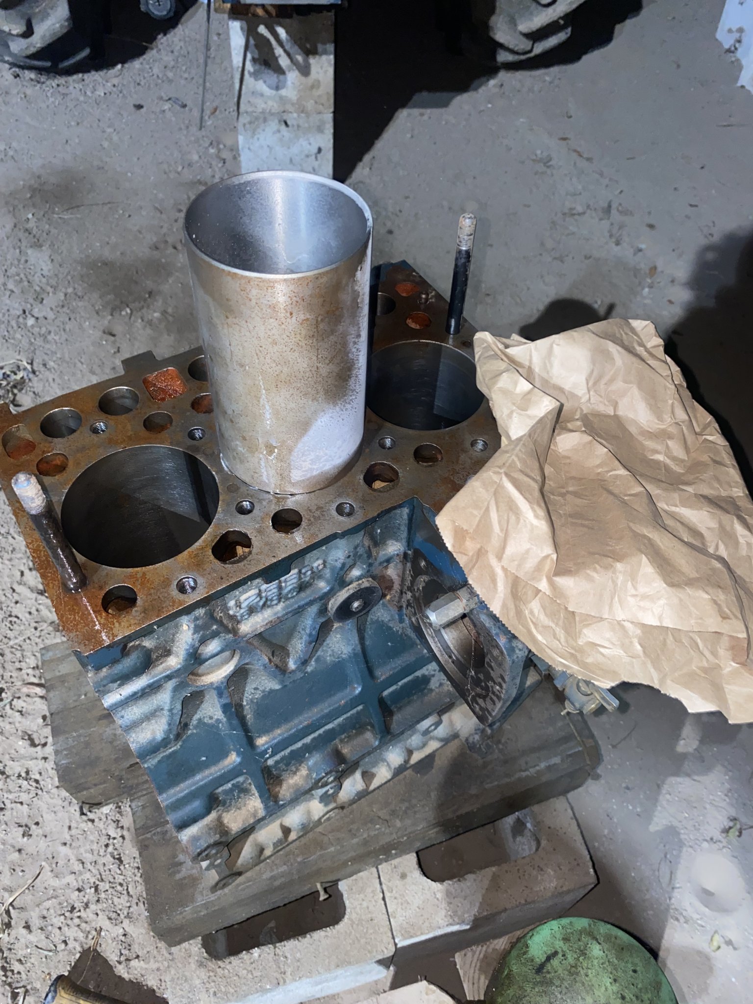

Got the 2nd liner from the freezer, getting ready to hit it with diesel
Got the liner down half way using 4x6 wood block, then finished her off with robust tractor bumper

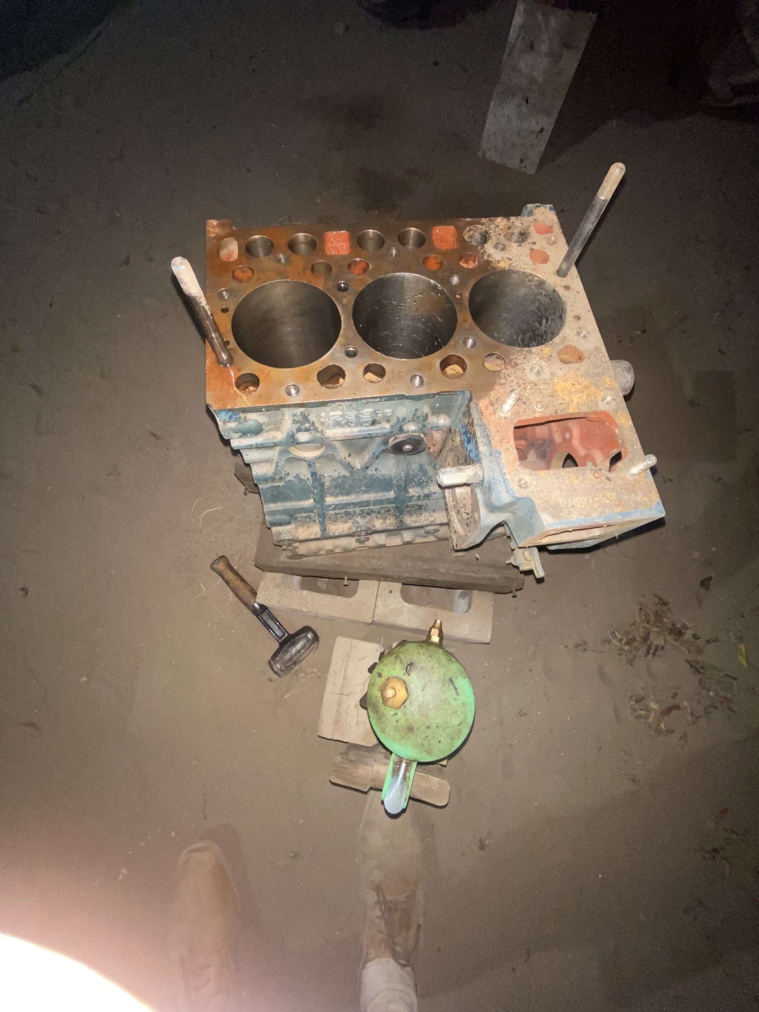

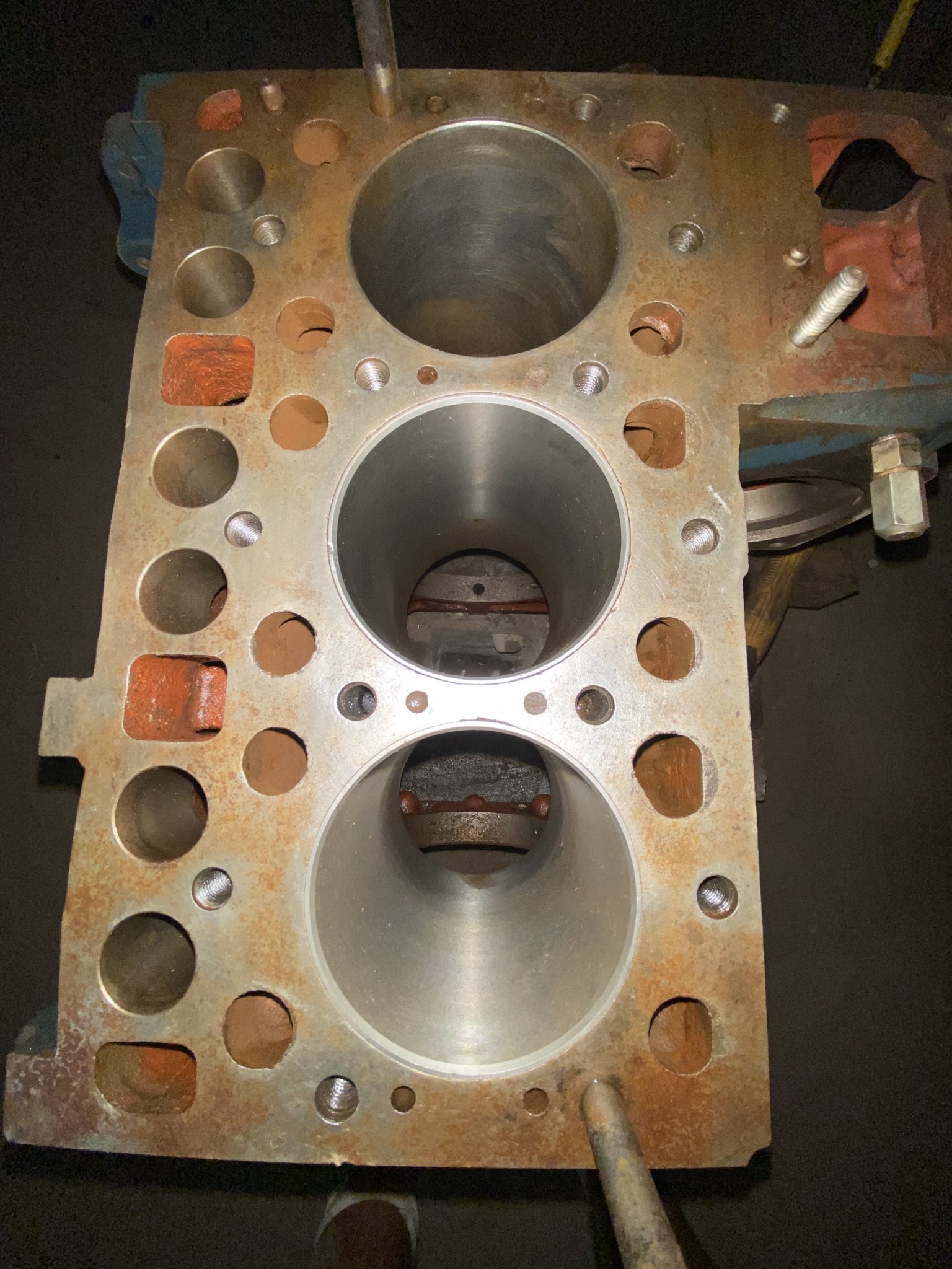

2 liners into the block, flush, looking smooth
Up close image of the two liners installed
the trick that got them to move the best: held the bumper with my body weight pushing down onto the liner, striking perfectly above it firmly, a controlled firm strike, directly above the liner, you will feel the liner shift down slowly, patiently striking working it down, not hard strikes, just firm strikes
Next steps: save up $ and make appointment to hone the two new liners, start to imagine the rebuild process, finish cleaning the shop and thinking about the next steps, get all tools that are not for this job out the sight, go through all the new parts and get them ready on table, hit everything with compressed air and get all the dust away, put time and energy into the rebuilding plan so I dont make big mistakes, also it will take longer for me to have $ for the press, and that one I was going to get sold, but I know I need press for those connecting rod bushings, I do have 2 new ones that i want to install, tons of little details
I'll figure it out
