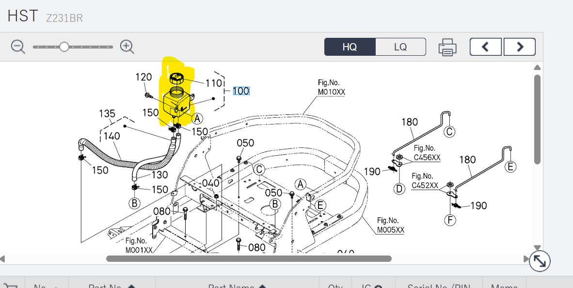

North Idaho Wolfman Moderator Staff member Lifetime Member Equipment L3450DT-GST, Woods FEL, B7100 HSD, FEL, 60" SB, 743 Bobcat with V2203, and more Jun 9, 2013 33,169 8,556 113 Sandpoint, ID Tuesday at 4:54 PM #4
P Papalote New member Equipment Kubota M7060 Sep 8, 2023 8 0 1 Texas Tuesday at 5:07 PM #5 Wolfman, thank you but the Z231 doesn’t have that part.
North Idaho Wolfman Moderator Staff member Lifetime Member Equipment L3450DT-GST, Woods FEL, B7100 HSD, FEL, 60" SB, 743 Bobcat with V2203, and more Jun 9, 2013 33,169 8,556 113 Sandpoint, ID Tuesday at 6:37 PM #6 Papalote said: Wolfman, thank you but the Z231 doesn’t have that part. Click to expand... While your Z231KW doesn't have that part, but a Z231KH and a Z231BR does. You're model just has a plug.
