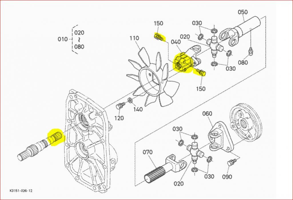

The shaft is connected to the engine with 3 bolts. The other end is splined which slides onto the transmission shaft. There are 2 cap screws that go through the splined coupler that keep the shaft on the transmission. Those bolts are obviously not in place. There is virtually no in-out movement to that shaft so once in place and secured it cannot come apart so it must not be secured on the transmission end.
29,132
5,422
Like Kuboman states, If the 2 rear bolts are in place and the shaft is coming off the shaft then you have either the wrong bolts in place and it's not tightening the yokes clamp, you have a worn yoke, or a worn shaft of all of the above.

Thanks for the Parts illustration.... The problem is with the engine side #60 Yolk Flange, #70 Shaft and #20 U-joint ....
OK.... After trip to local dealer and visiting the ZD28 at our shop I have the information.... The part about the shaft separating was "conjecture" on the part of one of the shop techs.... turns out the shaft (#70 ) was not pulling out... the u-joint end was "grenading".... when it let go the shaft takes out the radiator to the tune of $480... The shaft, u-joint and yolk flange another $350... Nobody seems to know why the shaft is blowing up.... last one lasted 8 hours and blew on level ground... no heavy rough or trash around...
One item of interest is that the #60 yolk flange has a new part number although the 2 parts, old and new, are interchangeable....
We are going to put it together again, build a guard for the radiator and before putting it in service we'll observe the operation of the shaft and alignment to see if we can determine any irregularities....
