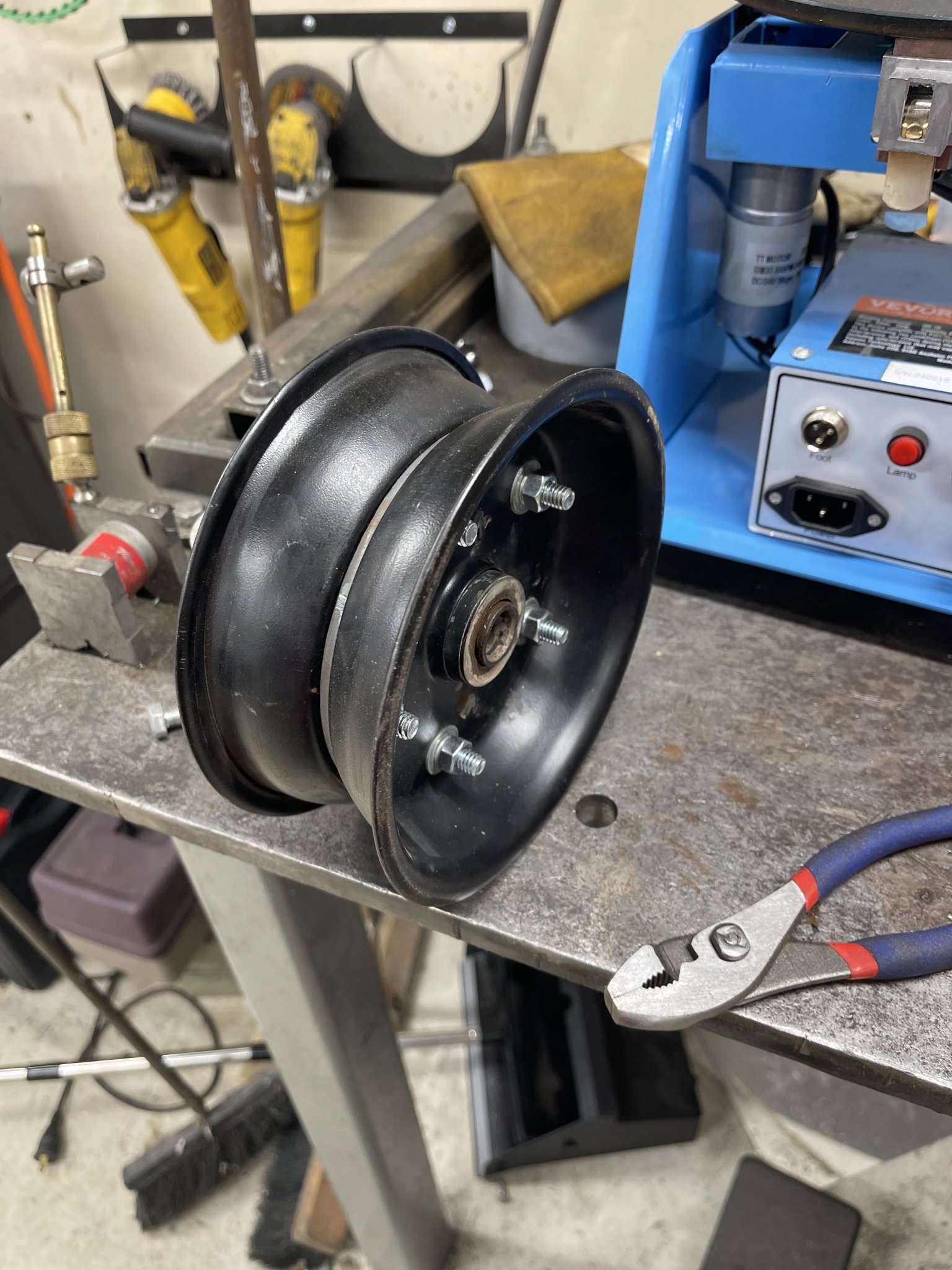

So I was taking my “new to me” rotary table down stairs to the shop, when the hub for the wheel on my Chi-Com HF hand truck cracked.
Luckily it did so before I hit the stairs, but now I gotta replace/fix it.
Now before we get started, I am FULLY AWARE that a replacement wheel is like 20 bucks and that there is a Horror Fright store less than 5 miles from me.
However, the store won’t open for 4 more hours…..so……I get it in my head that I should/need/want to fix this damn thing…….So off we go…...
(Having technical difficulties posting pics right now……………to be continued…..)
well……I found a “work around” for loading pics…..for now anywhooo, so…... “The Show must go on!"

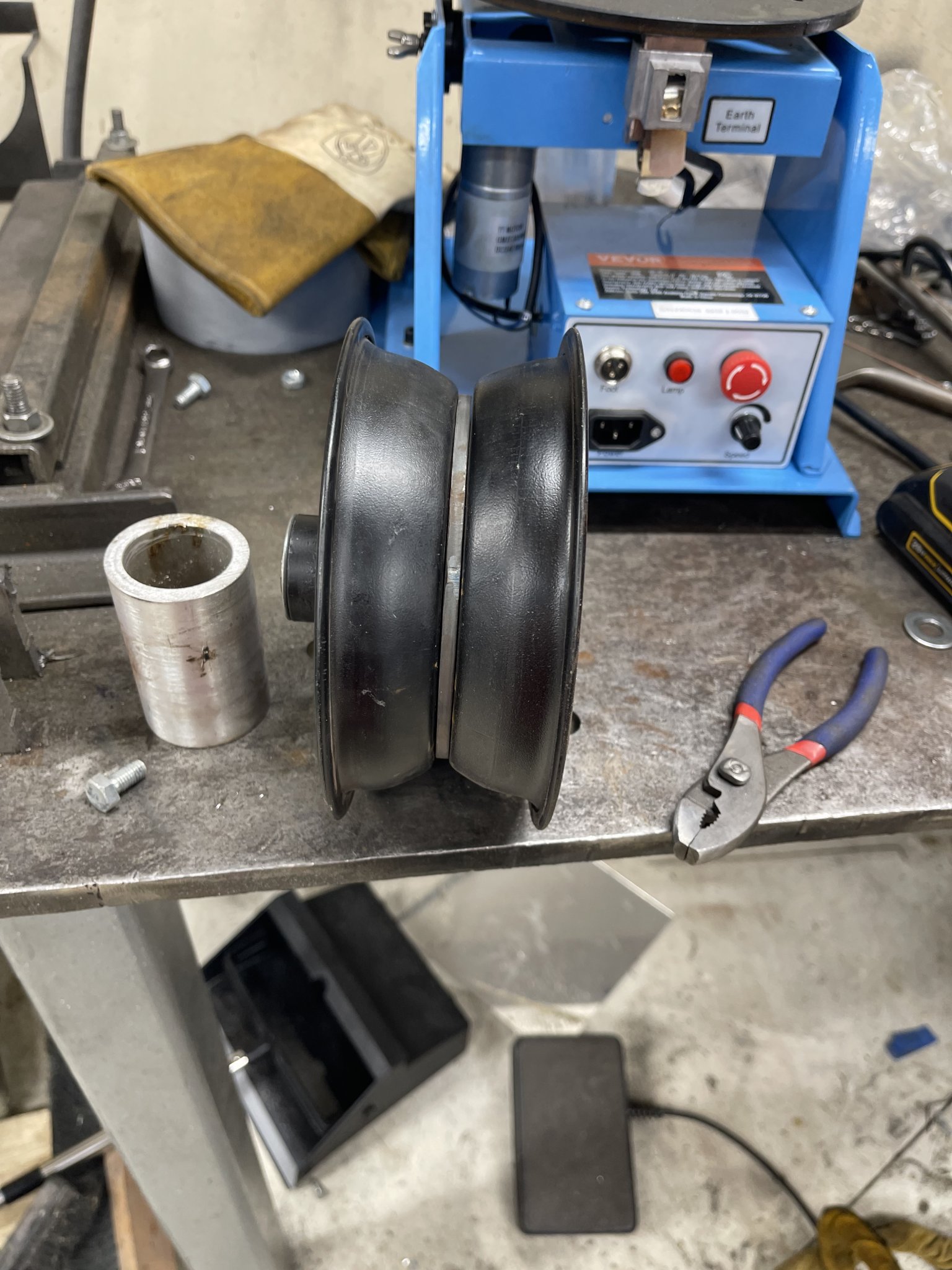

Well here is the crack.
I tried to just snap it off, but I was just bending the hell out of the rim,
So grab the cut off wheel, ….but…..won’t reach…..damn it!!!!!
So what the hell kind of RWS post would this be without a picture of his lathe? ;)
As you can plainly see, it's pretty "jacked up"

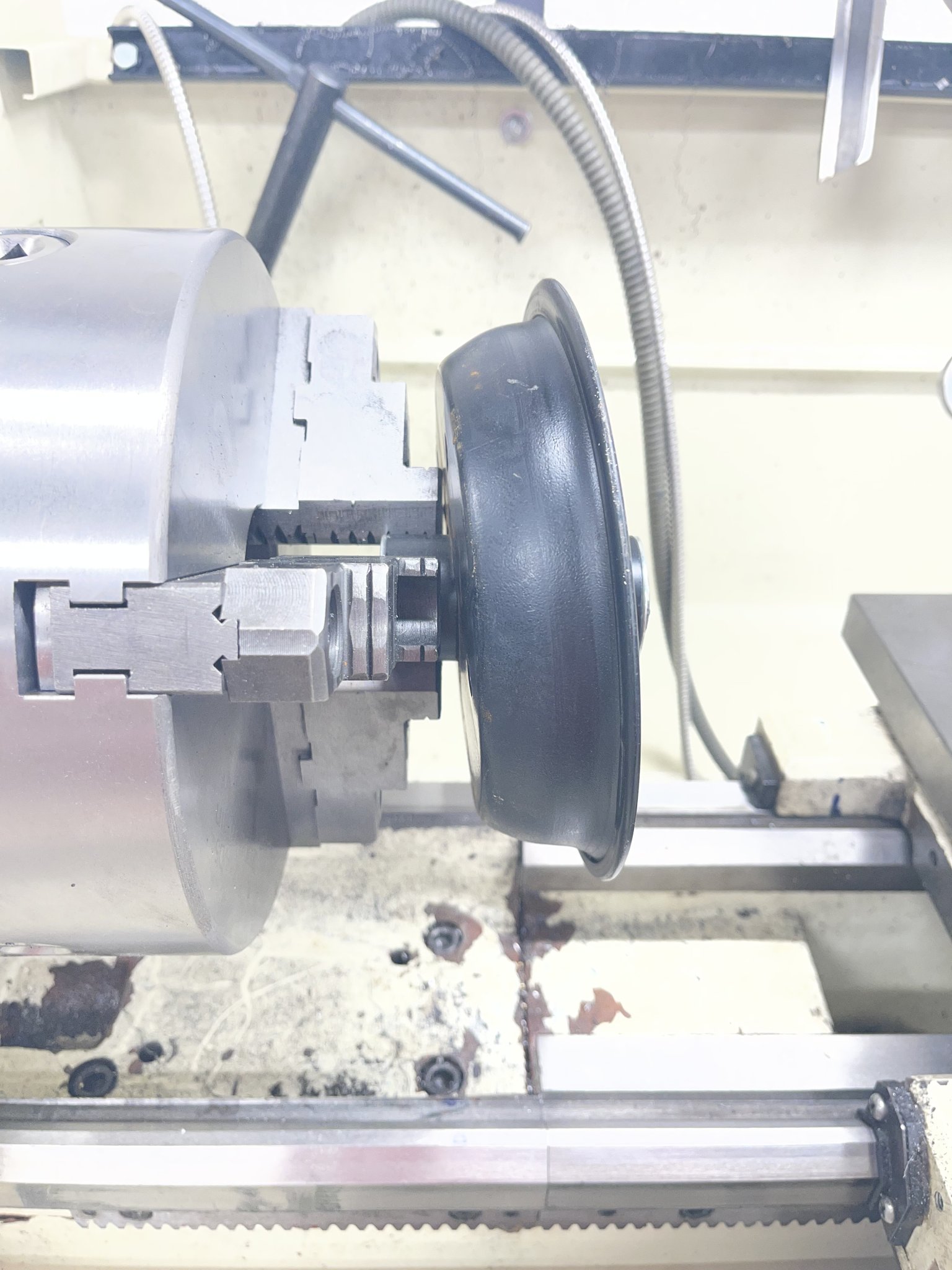

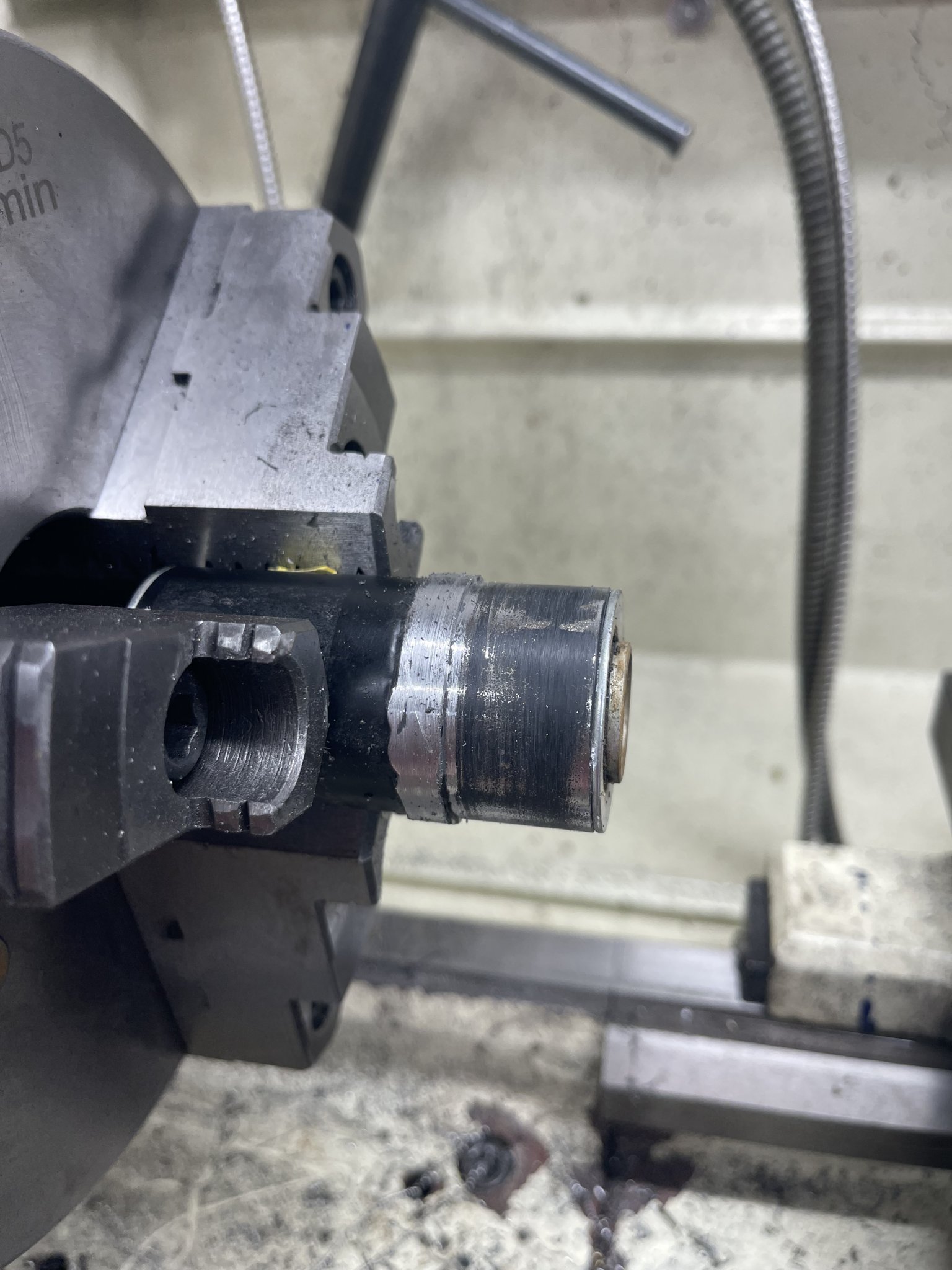

So I chuck the “rim” up and “Jerry rig” (or is it "Jury rig"????) a boring bar to cut it off.
a few seconds later it’s off.
I then took a few passes to “clean things up a bit"
Now I will just “re-weld” it and BAM….I be done!!!!
Well as soon as I got that torch even close to that "paper thin” part, it melted it so fast, I couldn’t believe it. I tried heating the axle before I “walked it in” , but no dice…..that thing was toast.
Maybe an actual welder could do this, but my “weekend warrior hack-ass” wasn’t gonna be able to pull this off……..
Time for plan B….
As I contemplate my next move, I look at the time, and now the store is only 2 hours from opening….Hmmmmm….better get my ass in gear…...
So as I am looking around for solutions, I see out of the "corner of my eye’ a 3/16’ish plate of scrape “mystery metal” that I was making .22lr targets out of, and it hits me……….
Why not cut a “circle” out and weld that to the hub and use the existing bolt pattern to simply bolt it all together……Kind of like a “sammich” …..
Brilliant!!!!!!…….But how should I proceed with making/copying/drilling the proper bolt pattern?
Hmmmmm……..Is this a good time to learn how to use one of my 2 rotary tables?????
Probably is…..but I’m just not “feeling it” right now, ….the "store opening” somehow becomes my “White Whale”….for some strange reason……I have nothing to prove, but I want this done before that damn store opens; Come “Hell or high water”…..

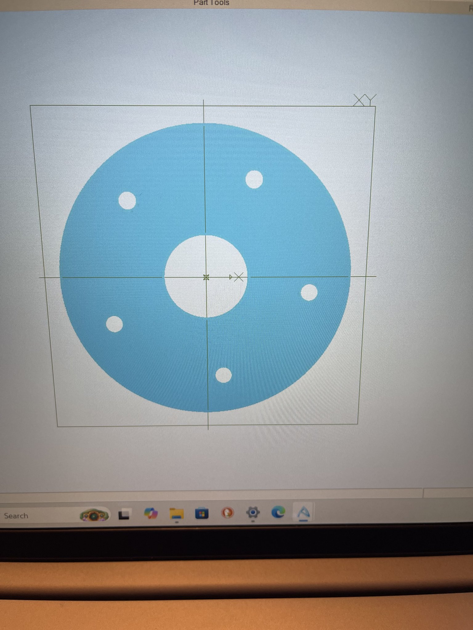

So I decide to cut it out using the CNC Plasma machine……
So I run up the stairs, open that computer, and in mere seconds I proudly have this…...
(as a side note; I’m not too "half ass'ed bad" with that Alibre program now…..I even upgraded to the Mac-Daddy "Expert” version recently;))
PRAISE THE LORD!!!!!!!!
I am going to make my “artificial/made up/no good reason deadline”, after all. !!!!!!
RIGHT!!!!!!
But that’s where this story takes a "sad turn"…………...:mad::(:cautious:

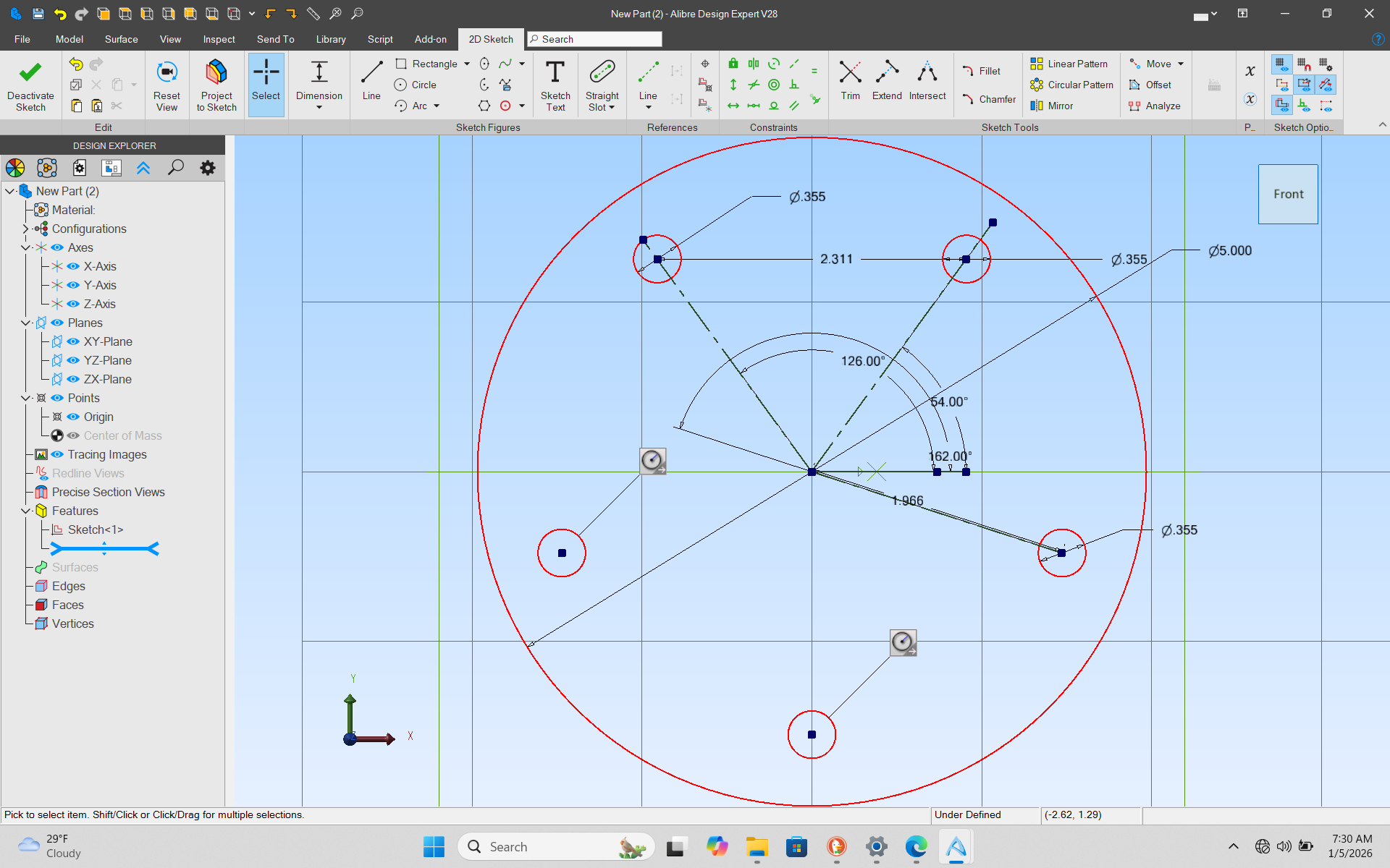

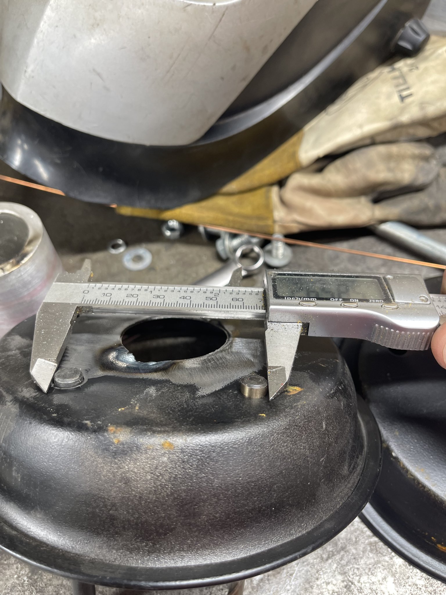

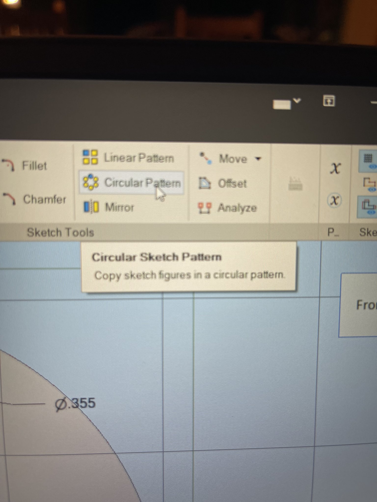

Problem is…..I can’t figure out how to get the proper spacing for the bolt holes…..
Oh sure….. I can get 5 holes in a circle, but how the hell do I get the proper distance from the center of the axle hole?
Well, I go down stairs and decide that the distance between the holes is easily and accuratly measured, so that will probably be a good start, but since I cut out the hub, the actaul raduius is/was going to be challenging to accurately measure.
So I find some “pins” and take a few measuremnts
Then run back up stairs, and this is where my "Moby Dick” moment happens…..
I sat there for 3 F'ING hours trying to figure out how the hell to get "the computer" to use those measurements that I so carefully took, in order to properly space these holes…..
3 DAMN-F’ing hours of me beating my head against a wall, watching the clock speed by my “stupid/artifical/self imposed/ good for nothing” time goal…….of “opening time".
Well "3 hour story” short, I never could get the damn computer to figure it out. I had to get a paper and pencil, figure it out, and feed the proper diameter to the machine.

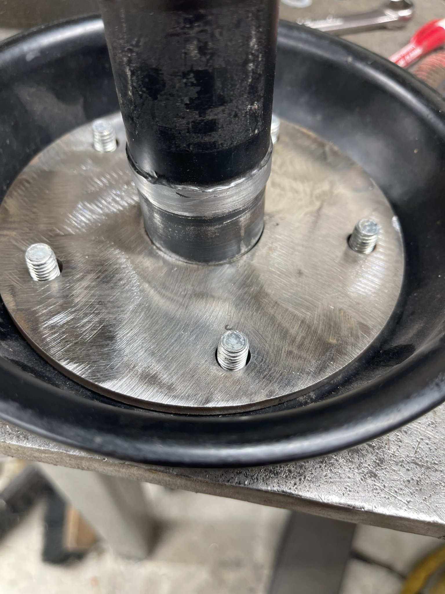

Well I fire up the Plasma machine and about 1 minute 38 seconds later…..
A nearly perfect plate, and all the holes easily/perfectly line up.

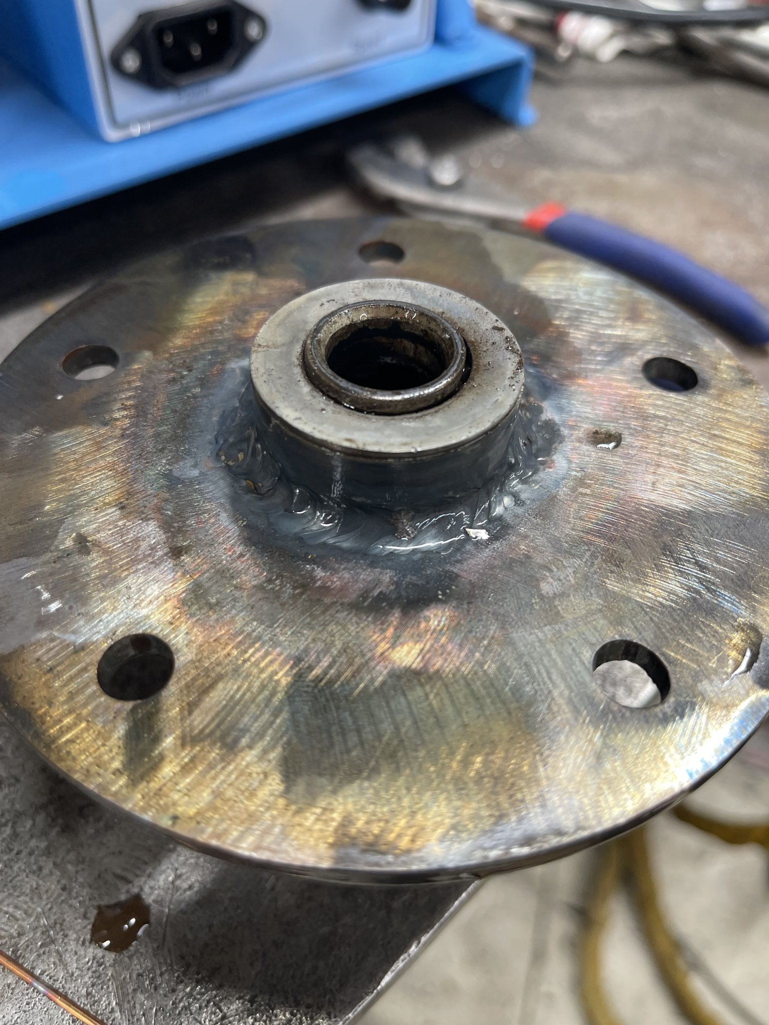

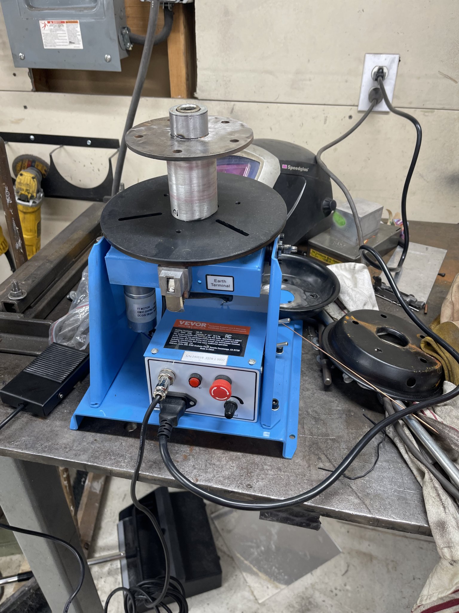

I decide this is a job perfect for the “rotary welding table”
So I load it up, align everything …….

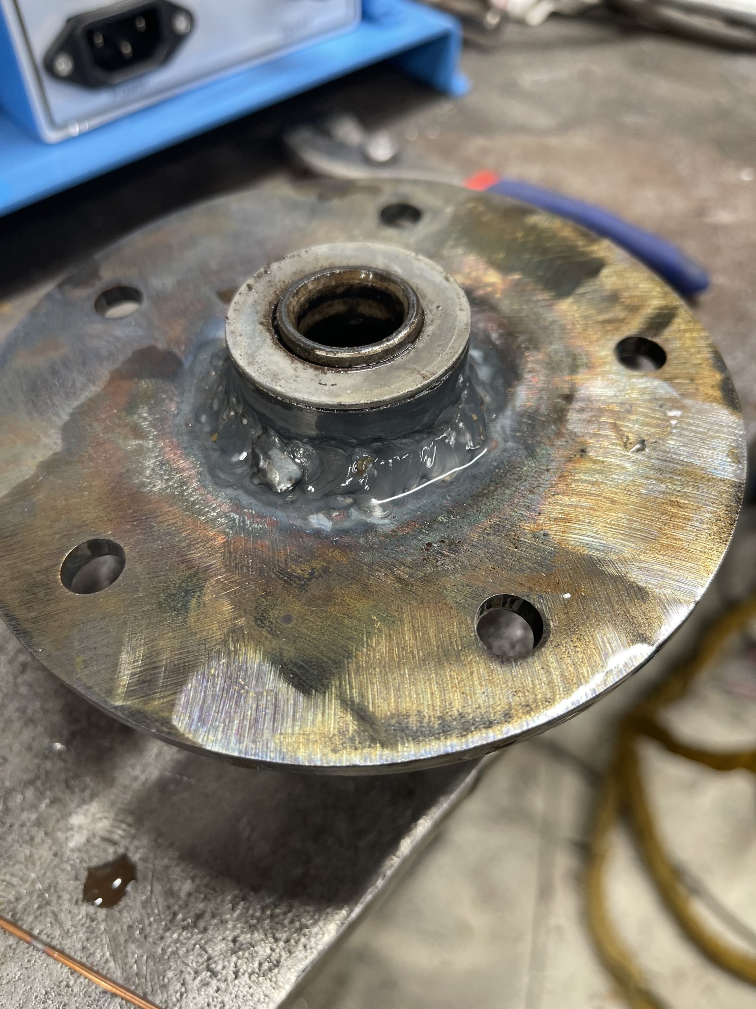

…and commence to make some of the “worlds shittiest welds” ever…..
I just couldn’t get my “Welding Mojo” flowing,,,,,but I reason to myself that this is not exactly a “High speed, low drag” fine machine…it a damn hand-truck.
I then find some longer bolts, and

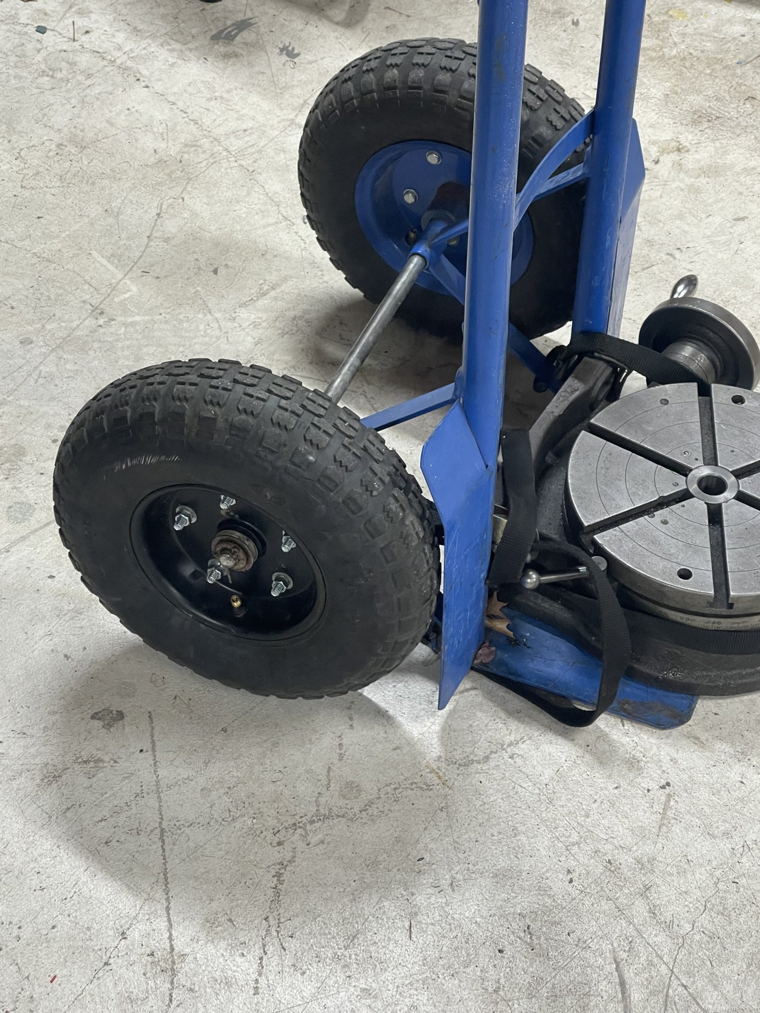

Throw the tire on, pump her up, and here she is………at high noon…..
I should have just waited the 4 hours, and spent the 20 bucks. ;) :cool:

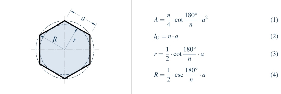

You put the verniers over a bolt diameter and set them to 0. Then you put them across two neighbouring bolts and you get the bolt centre distance a.
n equals 5 in your case and with equation 4 you can get the hole circle radius R.

Yes, yes gentlemen……all good advice, and much appreciated.(y)(y)(y)
One of my character flaws, is that I get stubborn when things don’t work like I think they should, and then I get pissed off, then I keep trying to make it work………Just because I think it should…..
Lets see if I can explain the “problem” better.
The “problem" was not a matter of being able to make a 5 lug bolt pattern.
I had a 5 bolt pattern in a few seconds.

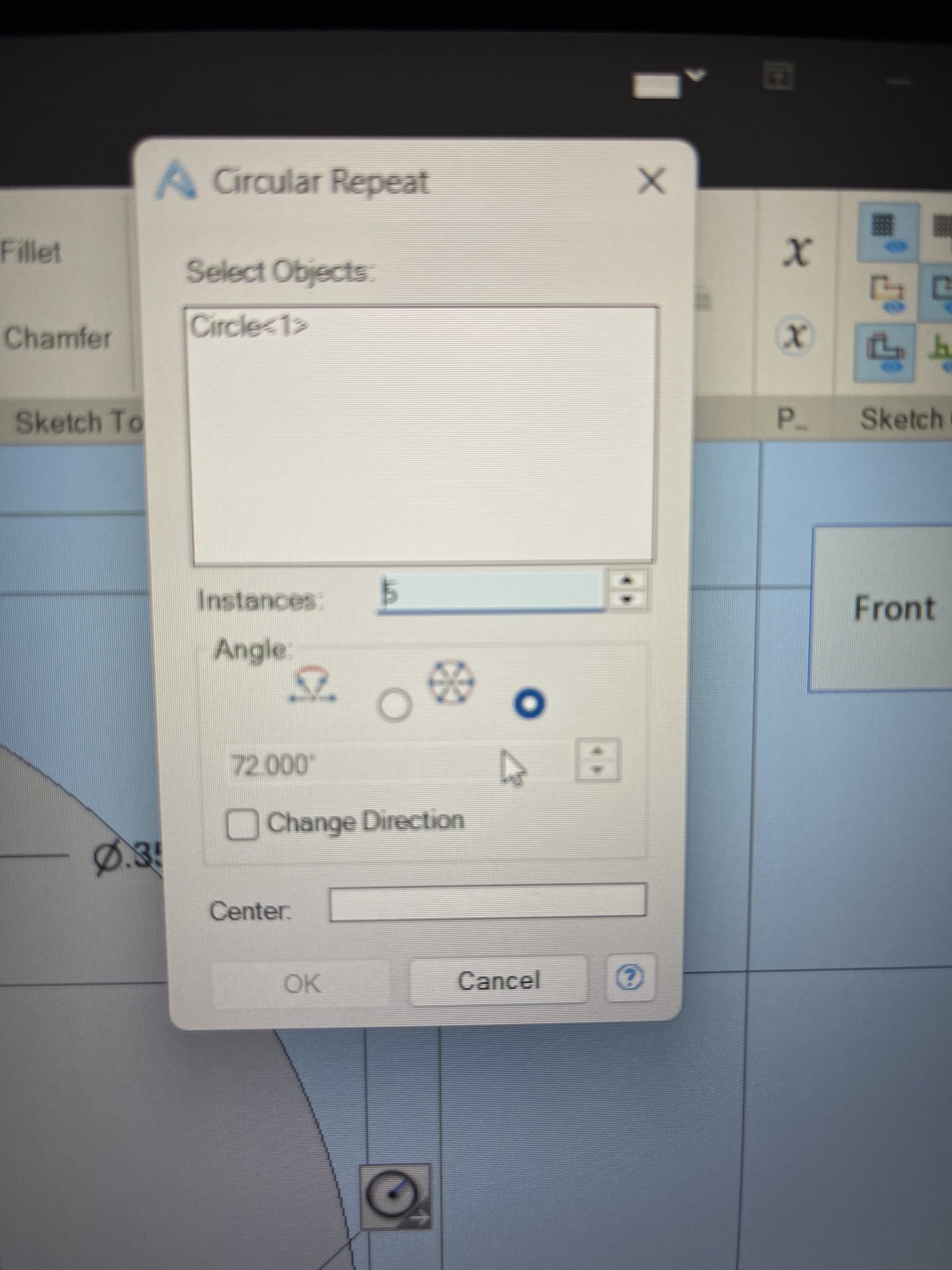

The “problem” I have/had is that I wanted the “Alibre" program to “automagically" find the proper radius of the bolt pattern, given the measurements between 2 bolt holes. (because thats all I could accurately measure since the hub was removed already)
You can see that when I click on “circular pattern” I have to put in 3 parameters.
1. which entity I want to make a pattern of. (in this case a “circle 1")
2. number of “circles” I want in the pattern (in this case 5)
3. the radius of the bolt pattern…. (where it says “center”)
Now #3 is where I was/am having the problem. I do not have that radius……Actually, I need that radius because I have already cut out the hub and can’t accurately measure it.
I wanted to find someway to use the “distance between 2 of the .355 holes” and have Alibre give me the radius.
I completely agree that the radius of the bolt pattern is easily figured out with paper and pencil………….But thats NOT WHY I paid 2 grand for the program……In fact having to figure things out “old school” is the anthesis of the why I got the program.
Hence, me sitting there and beating my head against the proverbial “wall” for 3 hours…...
Even though the “job” is done, I am not through figuring this out…..There has to be a way to do it, and come “hell or high water” I’m gonna find out how to do it “my way"
THAR SHE BLOWS!!!!!!!!!!! said Captain Ahab…..;):D

I would have made 2 angled construction lines. 72 degrees apart off the center of the part. One at 36 and one -36. Drawn circles with the center constrained to the angle line and constrained to be inline horizontally. Then add a dimension between the centers. Then just copied one 3 more 72 degree spaces using the intersection of the angled construction lines as the center point and also the part center. You could also draw the circles first constrained and then add the angled construction lines to find the center.
3,527
4,621
Pure genius sir!!!!!!!
That is EXACTLY what I was missing.......The horizontal constraint.
Every time I "dimensioned" the distance between centers, it would "shoot" one circle off into space, making them "uneven".
By constraining them to be horizontal, they would "shoot off" evenly, revealing the proper radius, the rest was simple.
Many thanks sir!(y)(y)(y):D
I really have to learn how to use "constraints" better.
