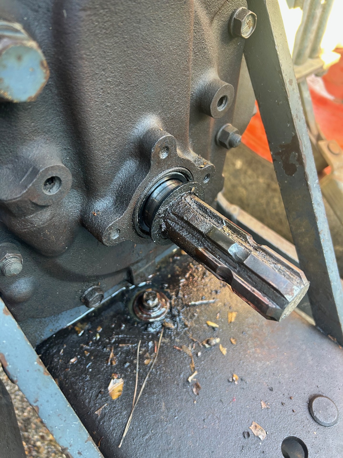

Seen Hydro oil leak under tractor - Obviously a Yoke Seal - No problem - But I noticed the yoke to be some what extended out? I dont recall the lip it is showing -My Deeres are flush - The PTO operates as it should. Before I just replace the seal - I'd like to get y'alls thoughts. Thanks.

I can't say for certain what is going wrong, but something is going wrong.
That looks pretty "jacked up" to me.
I hope you caught whatever is going wrong before it becomes too costly.

Haven't touched it yet - If I'm opening it up, I'm replacing all - So, I'm going to make a pick list beforehand.

get the WSM or at least real good drawings of PTO shaft ,what's inside and how it's put together
hard to tell if PTO shaft has moved back or just the seal's outer cover came off
for some seals, you use a simple 'puller' from the outside, 10 minute job.
just be sure to clean and inspect where the seal 'rides' for wear(groove).

Thanks - Yea, for the life of me I cant remember how it sat with the seal. There is no play, and works as it should.

GREAT no 'in -out play' is nice to hear ! I suspect it's just the seal cover,so hopefully a simple job.
I'd order TWO seals though. better to have the spare, on the shelf collecting dust than 'oopsy-sneezed-bent new seal-need another -sorry 4 day delivery'.......
probably need to drain a fair amount of oil BEFORE pulling that seal ??

Cool - I'll head to the Parts House - get a look at the seal to get a better Idea ( I always order in 2's with a consumable) Yea - draining wont be an issue - there is barely anything left - Thanks for the repplies and help.

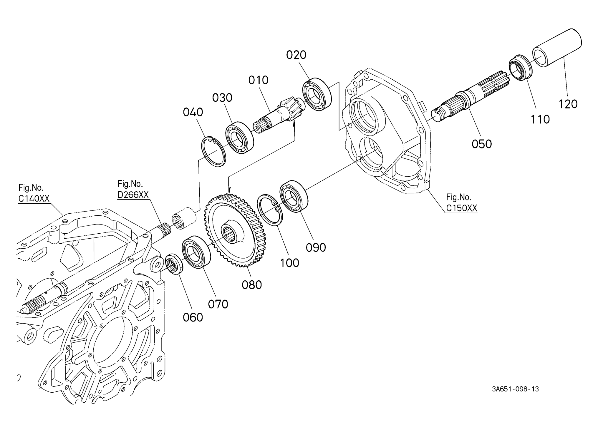

Looks to be a nut holding it in place. I would get a pdf copy of the wsm to know the best way to repair. I got this off "parts finder canada" / kubota webb site.
I would think if the nut was backed off there would be fore/aft movement, so maybe the seal just moved out, but why ?

If I were to venture a guess (and I will!) It appears that there should be a 'cover' bolted on. The clip on the PTO shaft would be removed, the cover, with the seal installed and bolted on and the PTO clip reinstalled. The clip probably protects the seal from someone too aggressively attaching an implement.
I doubt the bearing has moved out of position and I suspect the cover has been gone a long, long time, leaking fluid and fortunately, flushing away debris.
Though I could be wrong... again.

Looking at the diagram a bit more, it looks like the #90 bearing is mounted on the rear side of the flange on the shaft, which means the shaft could not move rearward even if it wanted to. So the seal has probably wiggled out.
I would still get a wsm.

why it came out ? ..one possibilty .it could just be 'wear' and 'old age'. Spinning the PTO,over time especially with an unbalanced PTO shaft / implement,can move the seal 'up-down' an itty bit and wear away the 'locktite' that may be there . heck mountains become beaches.......
If, IF, you have to remove that back cover,consider replacing the bearing #090 with one with a rear shield. It helps keep some oil from escaping....
When you install new seal , be sure to 'degrease' where it slide in real good and use whatever 'locktite' the WSM says, and confirm it's 'all the way around',nice even coat. Maybe wait a day before refilling the oil and taking a test spin,as you want the seal to be FIRMLY attached.

Hard to know for sure from just one picture alone, but it appears to me the seal has broken in half.
FYI: That's not a yoke, or a yoke seal, that's a PTO shaft and PTO shaft seal.
