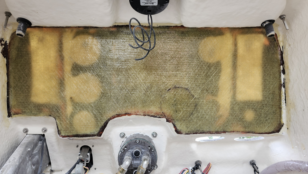

I finished up the front side of the console with two more layers of CSM and a different resin. I had to go to Home Depot to pick up more resin since I used up the Fiberglass Warehouse stuff. I have a nice "flat" surface on the front side with approximately 3/8" of fiberglass mat and resin all the way through, and possibly closer to 1/2" in the center section. When I cut holes for the various components I'll get to see just how thick the console is. I'll be applying a skim coat of Evercoat Formula 27 to the front surface and radii to get it as smooth as possible prior to gel coat. Once the gel coat is sanded with 1,200 grit paper, it should look like a factory job.

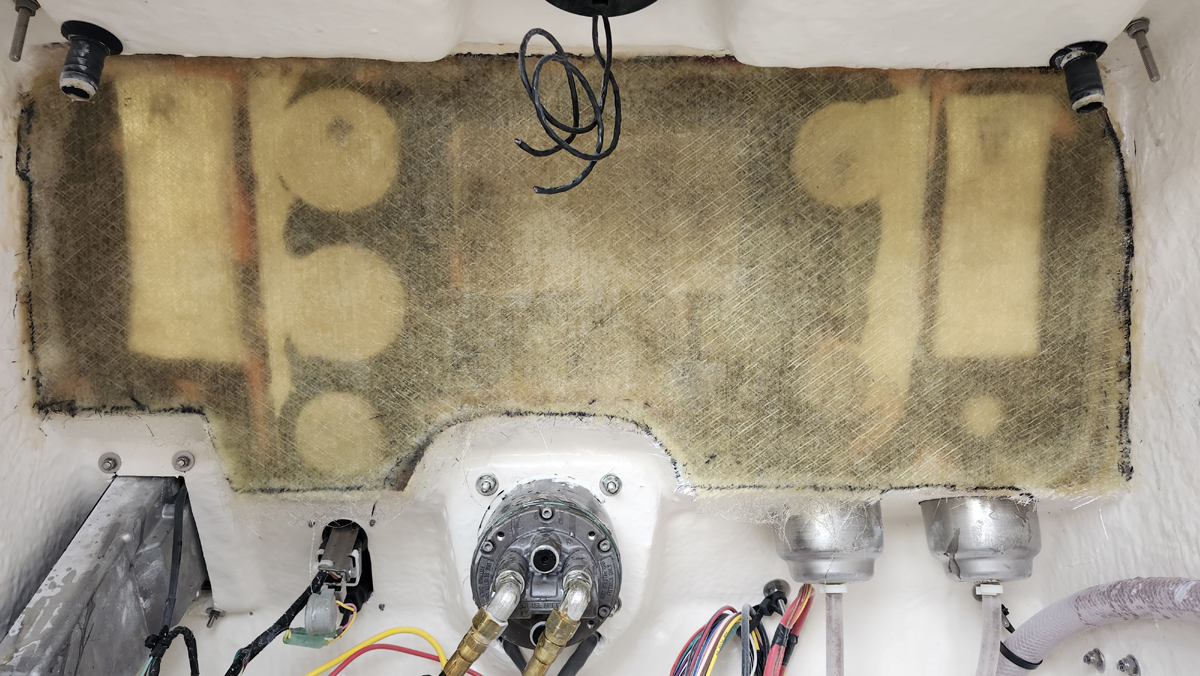

I got two layers of bi-axial mat and one layer of CSM on the back side, and after cleaning up the inside margins I'll add the last layer of CSM which will be nicely fitted to blend everything together. I feel good about the integrity of this modification with existing fiberglass sandwiched between new layers of CSM and bi-axial mat. As I said earlier, this is not a structural part like the hull so it's a good way to learn how to work with resin, mat and fillers where the penalty for failure is more inconvenience than catastrophe.
Some might wonder why I'm doing this during the boating months and not during the off-season. Well, fiberglass work should ideally be done when the temperatures are in the 65°F to 85°F range. Since I don't have a heated shop I can't do this in the winter, and living in Montana, we don't have a lot of days in the ideal temperature range. It's currently around 50°F in the mornings so I have to wait until it warms up before I can do much in the way of fiberglass work.

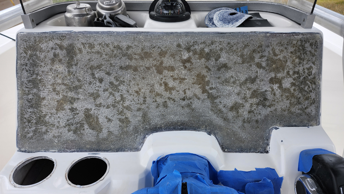

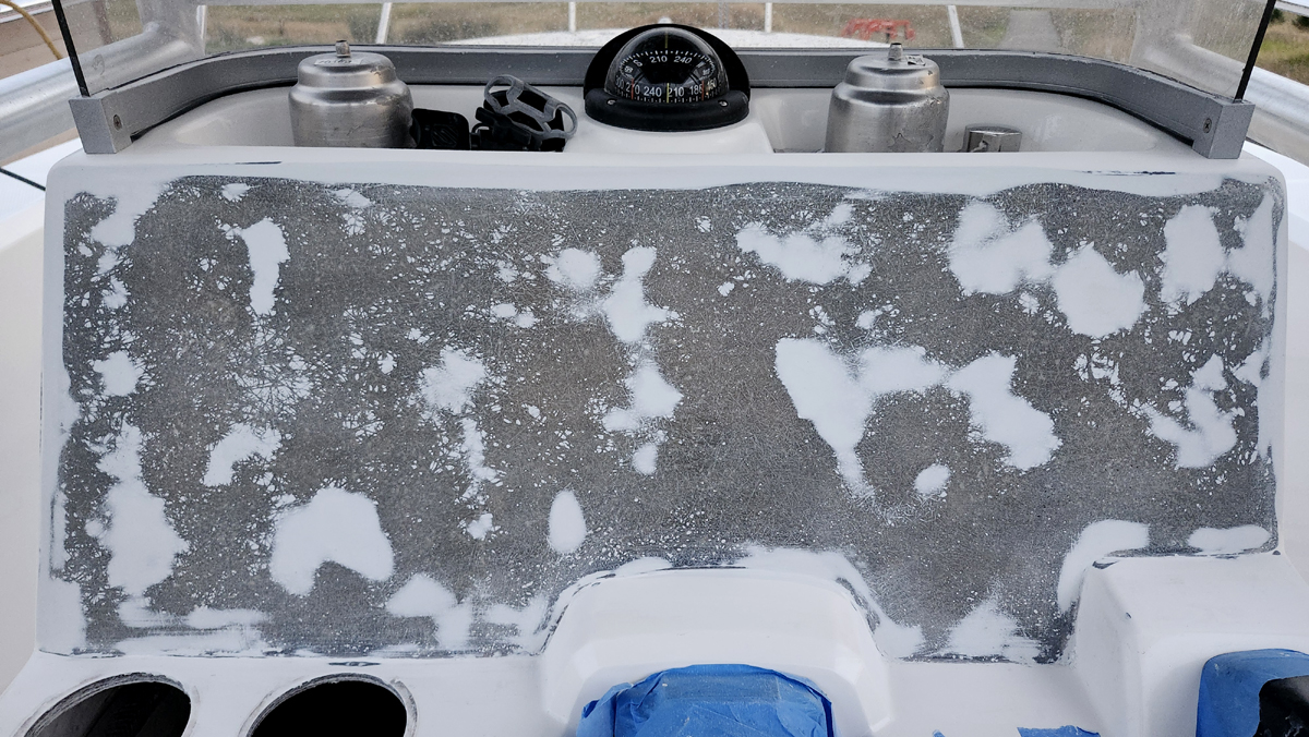

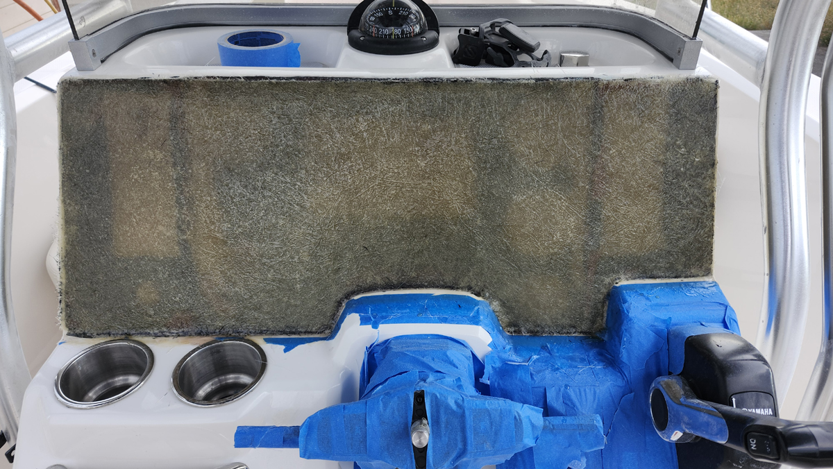

I'm making good progress and will be gel coating the front tomorrow. I managed to get another layer of bi-axial on the back side after I cleaned the outer edges. I blended and leveled the front face using Evercoat Formula 27 to fill in the low spots and feathered in the outer radii. It doesn't look like it, but the front is almost as flat as a piece of glass, and that's before gel coat which will consist of three layers with wax in the last layer.
I'm probably going to gel coat over the bi-axial on the back side and use a roller for a textured finish since the inside of the console is fairly "rough" in appearance. In case anyone's wondering why there's a black circle under the bi-axial mat on the back side, well, I noticed a bubble so I ground it out and then put two circular pieces of CSM under the bi-axial with the second circle larger than the first. The intent is to make the outer surface flat and having a divot under the bi-axial wouldn't have allowed for that.

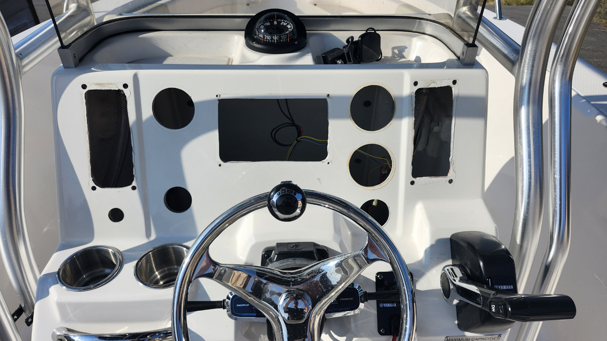

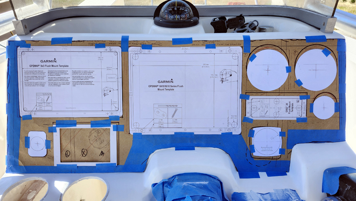

Still a ways to go but I got the holes located and cut out. The five round holes are done and good to go but the four rectangular holes need some work to get them to the finished size. I slightly undercut them to be safe. The fiberglass is 3/4" thick in the center and 1/2" thick towards the outside.
I still need to apply more gel coat and sand to a nice finish but that'll have to wait until I get back from a work trip.

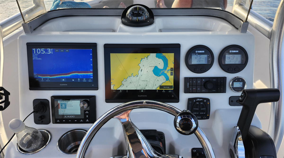

So from this ...
To this ....

Odd that steering is not in center of the width! My symmetry meter is going off like crazy!
At least it looks like you got rid of the offset dip in the middle and appears the large rectangular opening is pretty close to centered over the steering column. (I think your layout had it further off than it appears now )

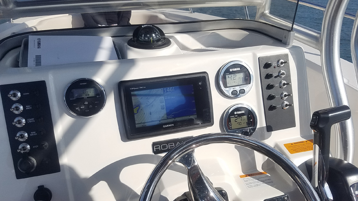

Now that boating season is winding down it's time for an update on the very deep rabbit hole that I found myself in. I learned a lot, and still have more to learn, but being out on the lake with friends and enjoying the boat this summer, along with the greatly improved functionality due to the upgrades has all been worth it. Looking at a couple of ferries in 50 ft of water where Flathead River enters Flathead Lake and seeing amazing detail via ClearVu is kind of addictive.
I have a couple of things to do still, more than a couple actually, but have decided to put them off to next spring since they're not pressing.

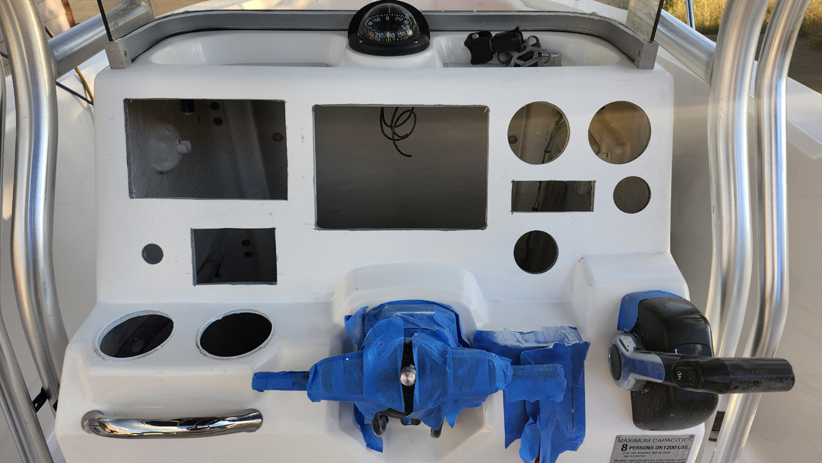

The first photo shows how the boat was set up when I bought it, and the second photo shows the upgraded layout after I modified the center console. I bought a new binnacle last year and decided to fix the chainsaw hack-job that Robalo (or the selling dealer) had done before installing the new one that's shown in the second photo.

One of my mistakes was completely underestimating how much work I had to do, and how long it would take. I didn't put nearly enough effort into protecting surfaces from resin and all sorts of areas from fiberglass and gel coat dust. It's a very messy process, and like many things, success is heavily dependent on preparation.
I did learn that Tyvek suits, a good respirator, good goggles, gloves and proper head gear goes a long way to taking most of the nastiness out of fiberglass work. Last year I had many an itchy night, but this year none that I can remember.
To buy a boat set up the way I have it now would cost about twice what I have put into the boat in terms of the initial cost and upgrades, but it was never about building something for less. My goal from the beginning was setting the boat up the way I want it, and then enjoying it for the next 10 years or so. I can say for sure that it's a far better boat than it was when I bought it.
I haven't shown all of the work I've done, or the excellent work that a local upholsterer did on all of the cushions, but I might make a few more posts to cover that.
6,929
9,444
Oh, the two biggest mistakes I made were cutting out the holes in the dash before completing the gel coat which made the work a lot more difficult, and not adding a larger radius at the bottom of the dash where it transitions into the horizontal surfaces. The center console is made from a mold, and it's much more challenging to make a brushed/rolled/sanded gel coat surface with complex geometry look like it came from a mold.
