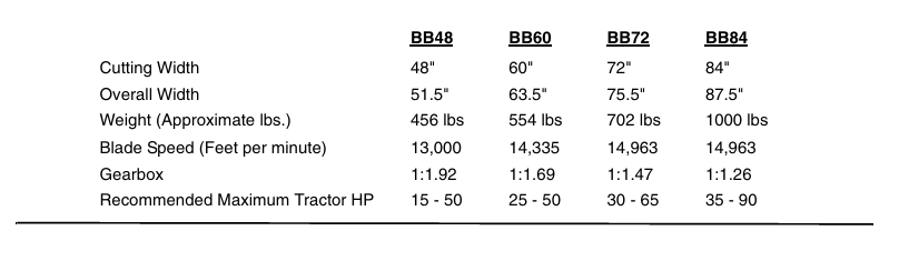

Will a Woods BB60 (older model) rotary cutter be to much for a L2501 kubota?

Your on the light side of having the recommended HP to run it.
You have 20.5 PTO HP.

I think it'll work fine. You may be more comfortable with some front weight.
I just look at the Kubota

You’ll be fine. May not be able to go quite as fast as a fella with 40hp on his PTO, but it’ll do the job for sure.
