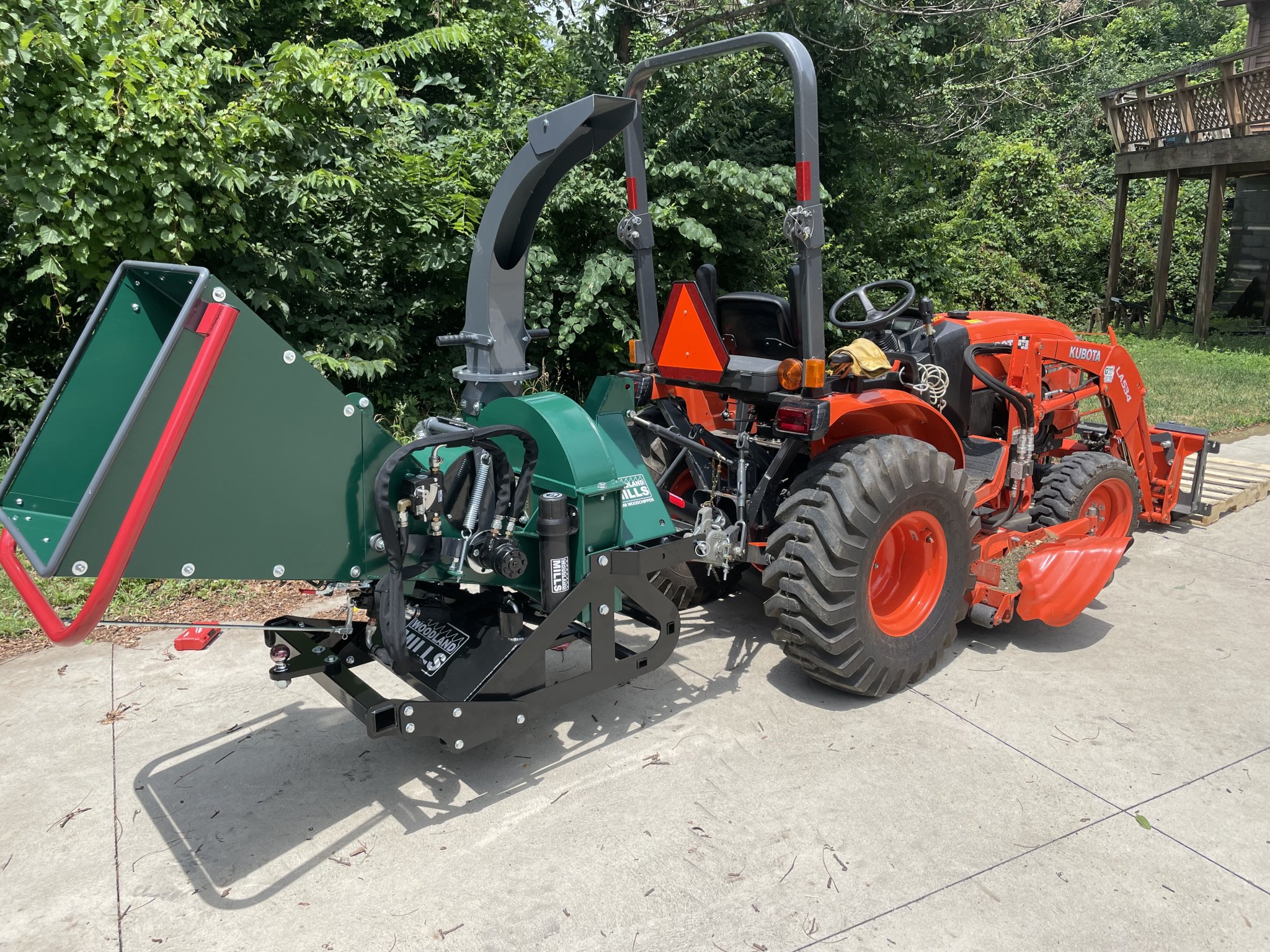

According to TractorData, which is usually correct but not always, your B2320 has 17 or 18 PTO HP (depending on transmission), and 3 point capacity at 24” behind the lift arms is a bit over 1000lb. Assuming those figures are correct, I would agree with whoever you spoke to at Woodland Mills, the performance of the WC68 paired with a B2320 is likely to be suboptimal to the point of dissatisfaction due to its weight and HP requirements.
While I have been quite pleased with my WC68, I’m mating it to a tractor with about 38 PTO HP and a bit over 2300lb 3 point lift capacity 24” behind the lift arms. I would suggest going with a chipper better matched to your tractor.
In regard to the old style single flywheel v the newer double flywheel, unfortunately I have no basis for comparison. I know the single flywheel works well. Maybe the double flywheel allows faster feed rates? I have no clue.

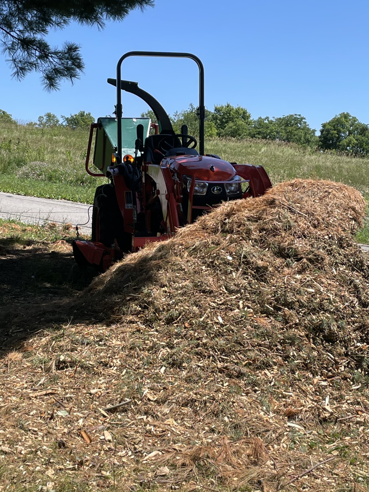

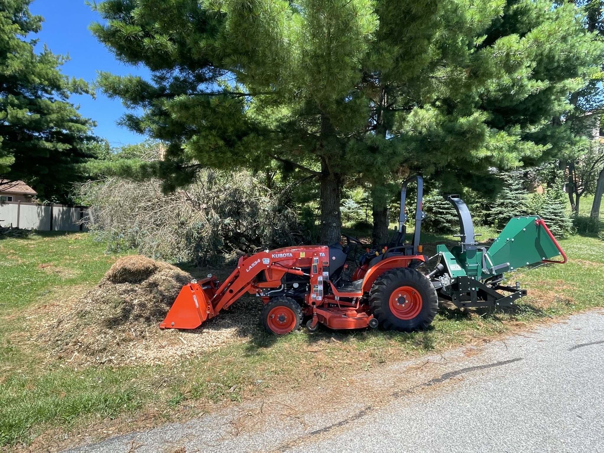

OP, I use a WC68 on my B (I believe it’s similar size to your machine? I also have a very hilly property. ). My recommendation would be tread lightly when it comes to big….its about all the B can handle if you don’t have flat land, and you will need the loader on to safely move around…man need a scoop of something in the bucket depending on what doing. (Steering gets very light) I would not take it down any of my steep hills that I normally would mow.
With the loader on and the chipper off the back it takes up a bit of space. Combine that with the hills and it starts to limit direction of travel. At least it does for me.
I’ve found it much safer to bring the brush/limbs to the location I can safely get the tractor too vs trying to do a milk run and stop and chip along the way. YMMV.
I would buy the WC68 again but I am also not familiar with the other model you mentioned. The one I have works great and I would not tempt fate to put something bigger/heavier on it…running it is no problem…moving it safely on a hilly property with B is the issue. Works great no complaints. It’s like an angry beaver.
(Saw holder is very helpful)
