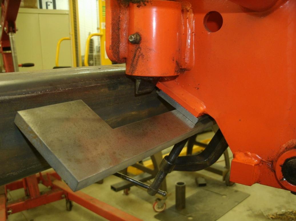

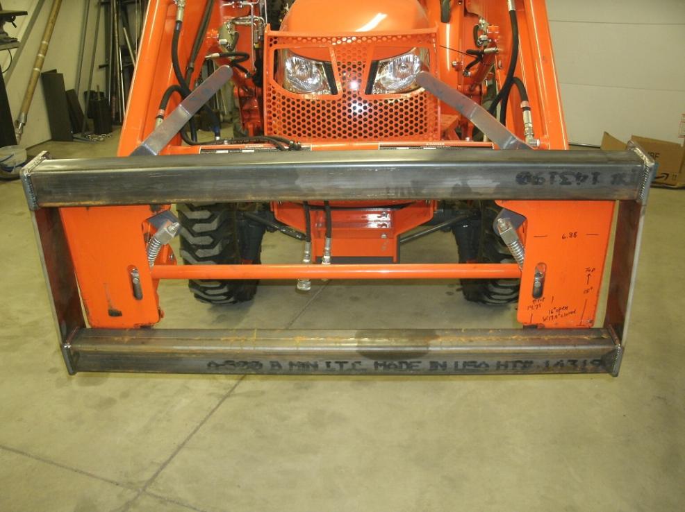

May I suggest a couple of things that I've leaned from my builds.
Add a verical support (plate or bar) where the pads for the SSQA meet the implement mount, that will help with loader twist.
And box the bottom latch plates with openings for the pins.

Wolfman, I boxed in the lower latch mount as you had suggested. Not sure if my 'boom' will address the twist, but if not, I can also gusset the corners. There will be braces going from the SSQA to the sides of the boom to stiffen that up. The angle on the bottom of the SSQA frame is for making the locking of the pin more solid.

Yep the bottom latch looks great, I had a problem with one of my buckets and that is how I fixed it.
Where you put the 2 pieces of angle iron are great, if you do that on the top too, I would think that should subside any issues of twisting the landing pads.

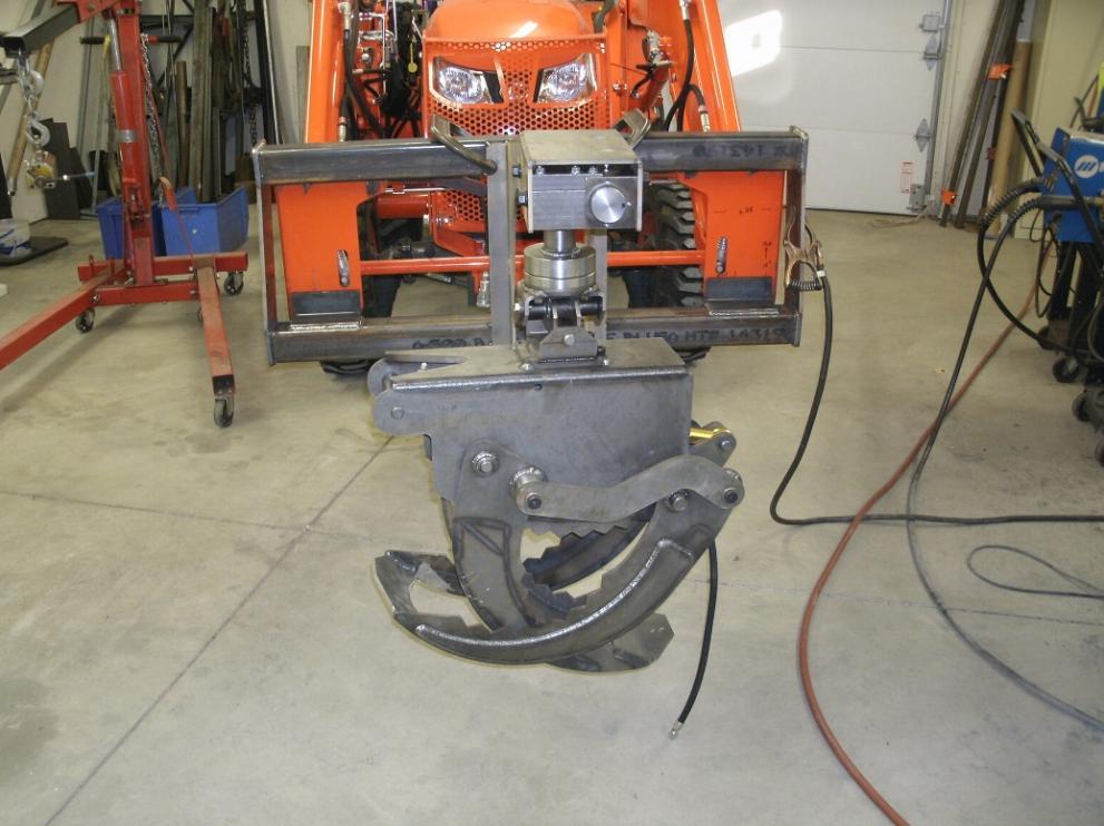

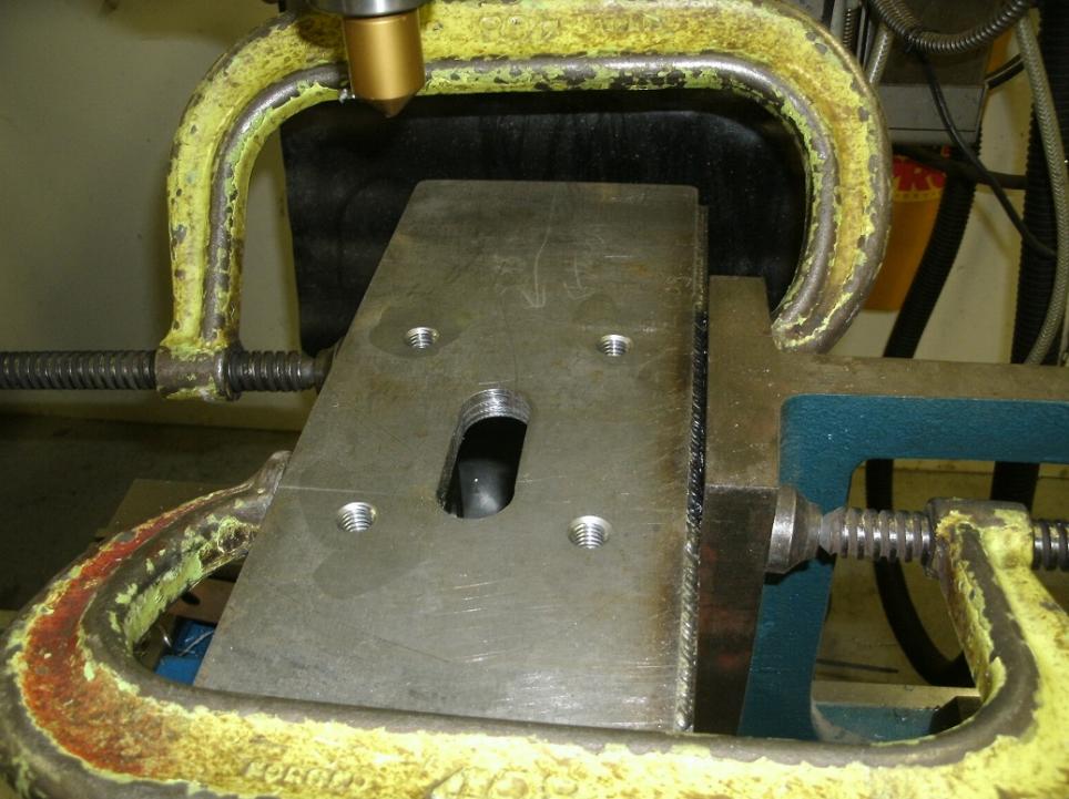

Had to put a slot in the upper plate on the grapple body to allow clearance for the return fitting on the cylinder. Also drilled and tapped to mount the swivel. What's the saying, measure once and keep a welder handy? Arrrrgh!

I know, I know... negative nelly here.
But it looks like it sticking way out front, you know you would increase lift substantially if you move it closer.
The way a lot of skid steer implements like this work, is that they mount the grapple perpendicular to the plate, so grapple would stick out front on the mounting plate, then when in use you roll the bucket / plate forward and point it down to the working position.
They usually do this at an angle and not 90 Degrees maybe closer to 45.
Way to set it would be at normal lift height the implement sound be parallel to the ground.
What this does is move the lift point back almost to the pin, thus giving it much greater lift ability.

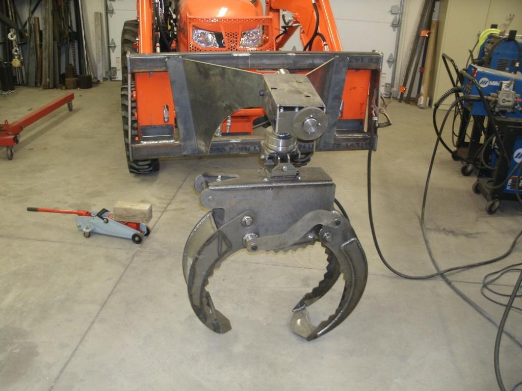

I appreciate the feedback, Wolfman! The main reason I post my builds is to get more eyes on it than just mine. Its easy to overlook things.
I'm right at the crossroads with this build right now. My original idea was to use the curl with a linkage to the torque tube on the FEL to rotate the grapple. That way I can control everything with one hand with my existing set up. Now I'm leaning towards a linear actuator. Guess I'll do some research and make some decisions.
You probably noticed that the boom is only tacked on. Had to start somewhere and I just pulled some dimensions out of my head. I'm warming up to the idea of moving it closer.

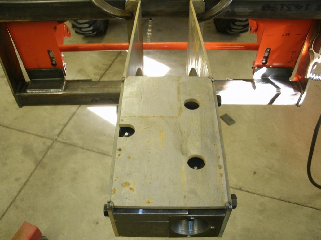

Did an experiment here with the outriggers by forming them so they widened out where they attach to the SSQA. Also canted them back fifteen degrees to move the CG back towards the tractor. I also offset the grapple about an inch and a half to the left as you're sitting in the tractor to help me with my vision of what is going on up in front. Doesn't seem like much but it does help.
Ordered a linear actuator from Surplus Center to handle the rotation. It has 500 lbs of force and a speed of .71" per second, which I think will not be too fast.
