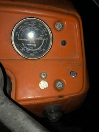

Also a picture of the control panel would tell us what components need to be on the schematic.

If you can get pictures of the dash, I can fine tune info.

I'm trying to figure out how to put the picture in--

Here we go with trying to get a picture in--

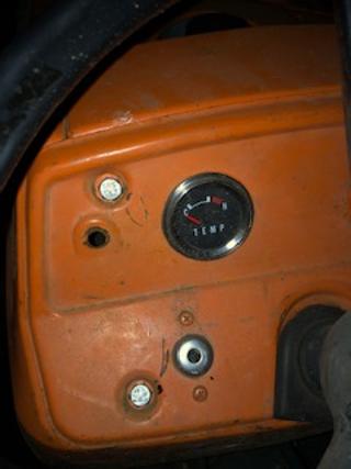

A picture of the other side of the dash of the tractor is on page two of these posts--

Pictures really help!
I'm going to go with Wolfman and say that your machine looks close to an L345.
He mentioned the kubotabooks.com website with the workshop manual that you can download in pdf format. I'm also suggesting that you download the file L305_L345_L355SS owners manual.pdf.
The owners manual has a schematic on page 58 which is more legible than the one in the WSM. It looks that if you need an electrical part then looking up the equivalent L345 part should work for you. And you can look up L345 parts on line.
