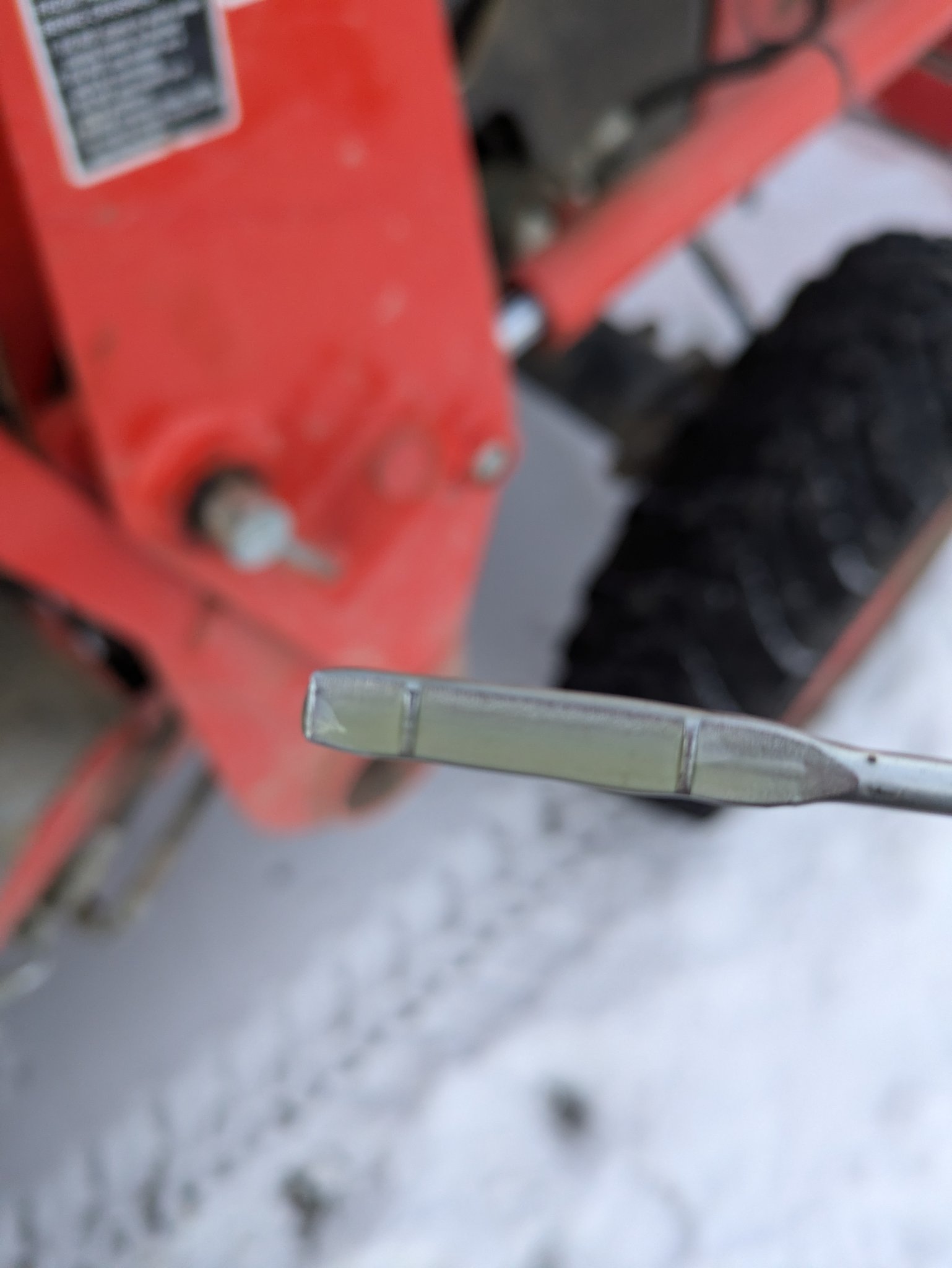

Update
Came home and ran it at 1400 rpm for thirty minutes. Nothing. Didn't even seem to respond to either throttle or bucket joystick.
Dipstick fluid image attached
I wanted to check the filters for ice crystals as suggested but - seeing as they are below the top of the reservoir - is that something I should really do with a full tank?
Not going above freezing for a week or so. If I were to hit this thing with a salamander, any tips on where to focus the heat? Just all up and down the hydraulic lines and on the filters?

You won't get water on the dipstick as the water sits on the bottom.

You have a serious water issue, as they are separate systems that use the same sump.
Sound like you have frozen up both the HST and the hydraulic filters and or sump.
If it were mine, I would push, pull, drag, it into a shop or garage not running it!
Put a lot of heat to it, drain all the drains, pull both filters, flush it out with some cheap hydraulic fluid with everything open.
The have 2 sets of filters and more cheap fluid, fill run briefly and drain and reinstall new SUDT2 fluid and filters again.
