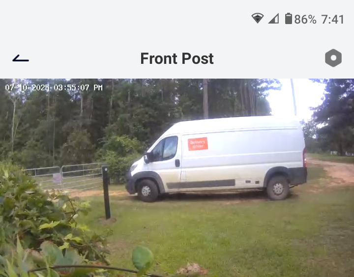

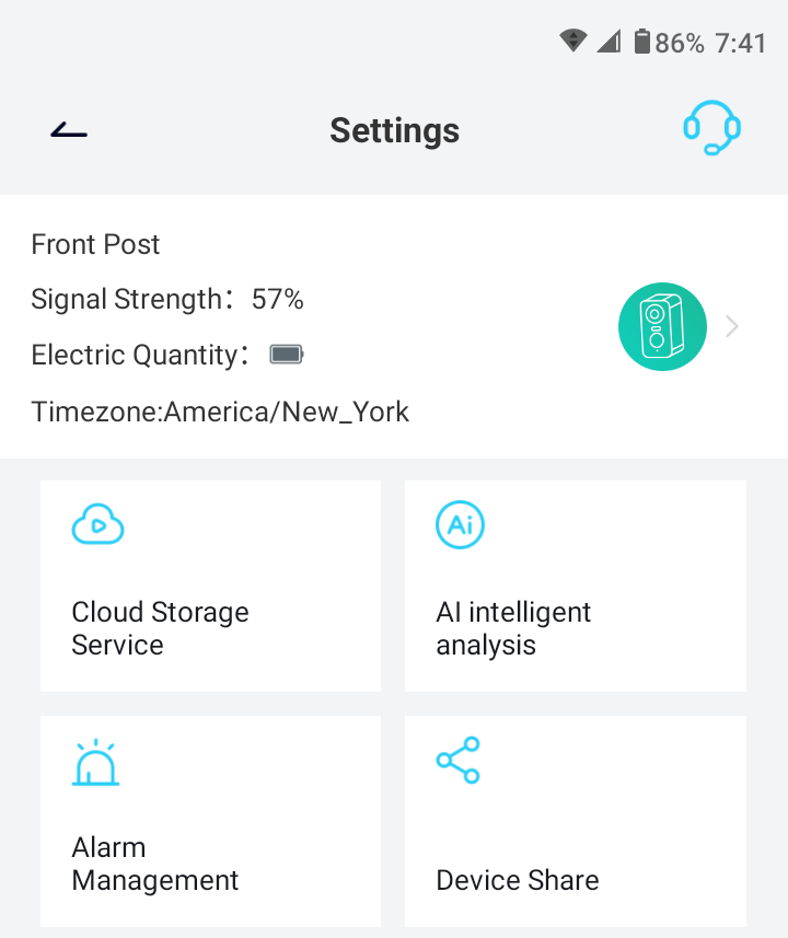

I went out and measured the distance from the window my little travel router is in to my furthest camera at the gate. It wasn't as far as I thought it was. It is 387 ft with no trees in between but the signal has to pass through the front wall of the house.
It has a 57% connection and records to the sd card and the cloud. Camera is a iegeek ZS-GX3S outdoor battery camera. Pretty sure if I used some extension cables and mounted the router antennas outside on the eve the range would be much improved.
Here is a cloud image from this afternoon.

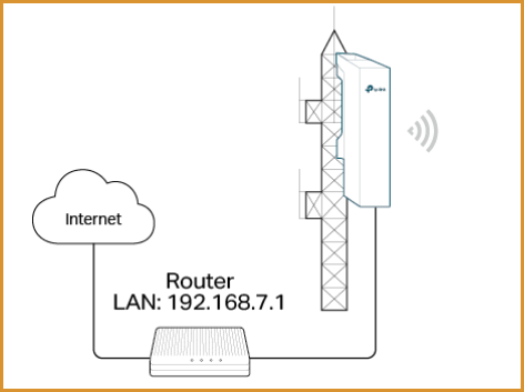

Again, for anyone wanting to extend Wi-Fi, it's best done emperically, that is, it will take some tinkering and some experiments.
I'd start with a single CPE-210. You'll learn how to set it up, and what 'range' it can provide on your site.
The system would look like this:
The basic procedure is this:
  • Connect the CPE210 to a laptop and use that to configure the CPE210 to 'AP Mode' and with the settings you want. (This is where you give the CPE210 a SSID and your network password, as well as select a channel for it to use)
  • Disconnect the CPE210 from the laptop
  • Install the CPE210 on a high spot, pointed in the direction you care most about.
  • Connect the CPE210 up to your existing router with ethernet cable
  • Pull out your phone and walk around to test the range.
The CPE210 access point (AP) can have the same SSID and password as your existing router's Wi-Fi. When you get out of range of the router, your phone should automatically re-connect to the CPE210, with no effort on your part. This action isn't flawless though, as your phone tends to 'hang on' to the diminishing signal a long time before re-connecting sometimes. As far as I know there's no easy fix for this. (There is a fix, but it requires more complex 'managed' Wi'Fi access points, like are used in commercial environments that employ real IT guys.)
You can also give the CPE210 a different SSID and password. This might be good for some installations, and it's handy for range testing, because you can control which AP (the new CPE210 or your existing router) your phone connects to.
InTheWoods.. again many thanks for you insights. I got alot of online research done last night. I have a bunch of the parts I will need ready to go in an Amazon order for later today to take advantage of the PrimeDay deals. Your schematic above seems to indicate that you plan to use the CPE210 as the end wifi in the chain.
However, in the ArsTechnica link above, the author says:
"Although TP-Link's bridges support connecting client devices—e.g., laptops, phones, and tablets—to them directly, I don't recommend doing so. Configuring multiple devices to use the same Wi-Fi band and channel as the bridge APs do will have a severe impact on the point-to-point link quality.
If you're wondering how to get "whole barn Wi-Fi," it's simple—connect a Wi-Fi Access Point like TP-Link's EAP-225 to the output of the bridge. If you configure it to have the same SSID (network name) and password you'd use to connect at your house, your devices will even automatically roam to either side of the link.
If you're using Wi-Fi mesh such as Eero in your main house, you may not want to use the standalone access point approach outlined above. Instead, bring one of your mesh kit's nodes out to the barn or guest house and plug its Ethernet interface into the CPE210/CPE510. The Eero node will consider itself connected directly to its mesh siblings by wire, and everything will "just work" as though the barn Eero was still a house Eero."
What about using just the CPE210? My plan as it exists at the moment is to buy two CPE210s and the Google Nest Wifi Mesh with one primary router and two nodes. The primary router and one node will go in the main house. The CPE210s will "bridge" the internet to the guest house and shop where the second mesh node will be. I am gonna work on tweaking that system to work well before I tackle extending the signal to the dock and eventually up to the gate.
