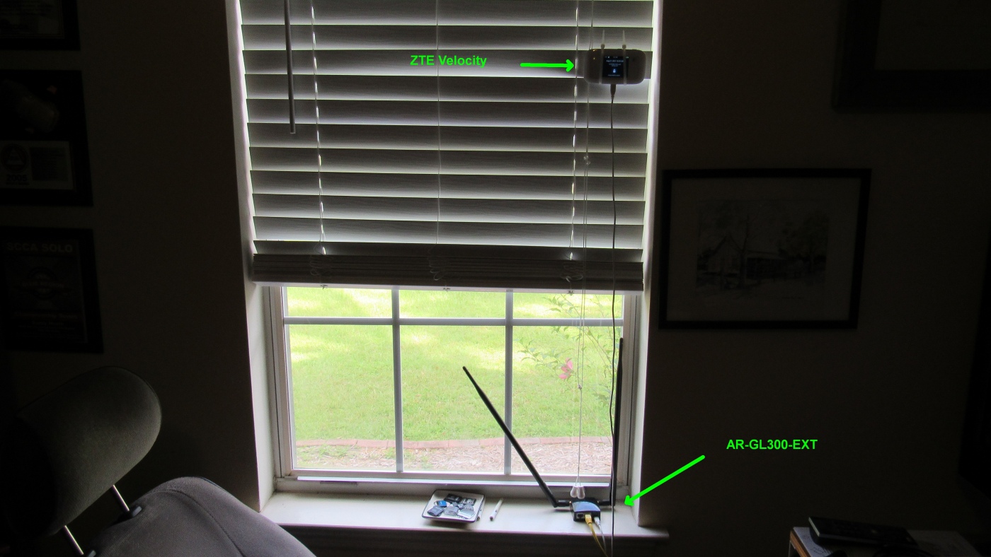

This may not help you but I have my home network and outdoor wifi cameras on a GL.iNET GL-AR300M EXT travel router. I replaced the antennas with longer 12db antennas and have it sitting in a window sill on the north side of my house. It connects to my cameras out 500 feet but is at around 48% at that distance. I can view them remotely from anywhere I have a data connection to my phone. I have a wyzecam in my metal barn about 400 feet from the router and on the south side of the house and it connects reliably.
I have 3 different brands of outdoor wifi cameras and they all connect through this tiny little router.
I don't think the AR300M EXT is available any more but they have similar versions starting at $30. Just make sure you get a model with the external antennas.
I would be willing to bet if I used some extension cables and mounted my antennas outside and elevated the range would be even further out.

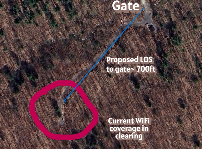

Thanks all for great input and details. Appreciate the advice. Let me clarify my needs a bit. The priority for me is the gate opener (Ghost WiFi and bluetooth as well as remotes for vehicles) and security cameras (4G cellular transmission) at the gate. Current cellular cameras (Glass Raven brand) are adequate but there can be many minutes delay in sending images to my phone. I'd like to replace these with "live" WiFi cameras such as the Arlo brand which currently work for me at the top of my property where I have a T-Mobile 5G modem setup for WiFi using PV /inverter/battery setup. There is no utility power access at my lot. I'd like to be able to see visitors at the gate in real time and remotely open the gate when needed using WiFi. The gate is approx 700 feet away down a curved driveway with a partial view of the modem site (some trees and leaves but can see both ends. Probably would work with the fresnel concept described above. Power at the gate is suppled by deep cycle lead acid and a 18 watt solar panel. This would need to be upgraded to supply power for point to point link device needed at the gate.
Have several Arlo cameras already at top of property within 300 feet of modem for live wildlife viewing which work fine as they are in a circle at the edges of the clearing at the top. So I am thinking the tips you've all provided me are a great start. I'll experiment with some point to point link setups. Thank you all!.
Image below does not include recent clearing of trees.

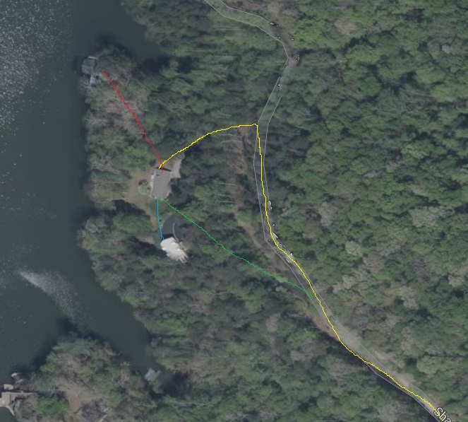

I too am just savvy enough to get myself in trouble, Gaspasser. BTW... are you flatulent or are you a Sevo server? I am the latter. Those CPE210's are on sale at Scamazon right now and I might just go ahead and pick them up now if they will be my solution. My research into the CPE210 indicates that it serves as a wifi.
here is what I am dealing with...
Yellow - Internet service line coming from provider to main house
Red - Main house to boat dock
Blue - Main house to guest house and shop
Green - Main house up to top of driveway at gate (for security cam)

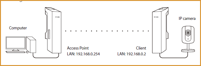

1. The CPE210 is listed as a point-to-point wireless bridge. Does this mean that you need two units to send internet somewhere else? Do I need one on the side of the house where it sends the signal from the modem 500feet down to the boat dock where I have another CPE210 to receive the signal and then act as the wifi?
The CPE210 can be configured as a general access point. In that configuration, it will allow any Wi-Fi device (phone, camera, laptop) to connect wirelessly. However, using it that way means the device end of your link is degraded by whatever crappy antenna and positioning that device has.
Setting a pair of them, with the far end cabled into your remote device like this is better.
Or, instead of the 'IP camera' shown, the remote CPE210 can be connected to the ethernet port of an old Wi-Fi 'router' that you configure to act as a switch, providing 'local' Wi-Fi coverage (and ethernet jacks) at the remote end.
