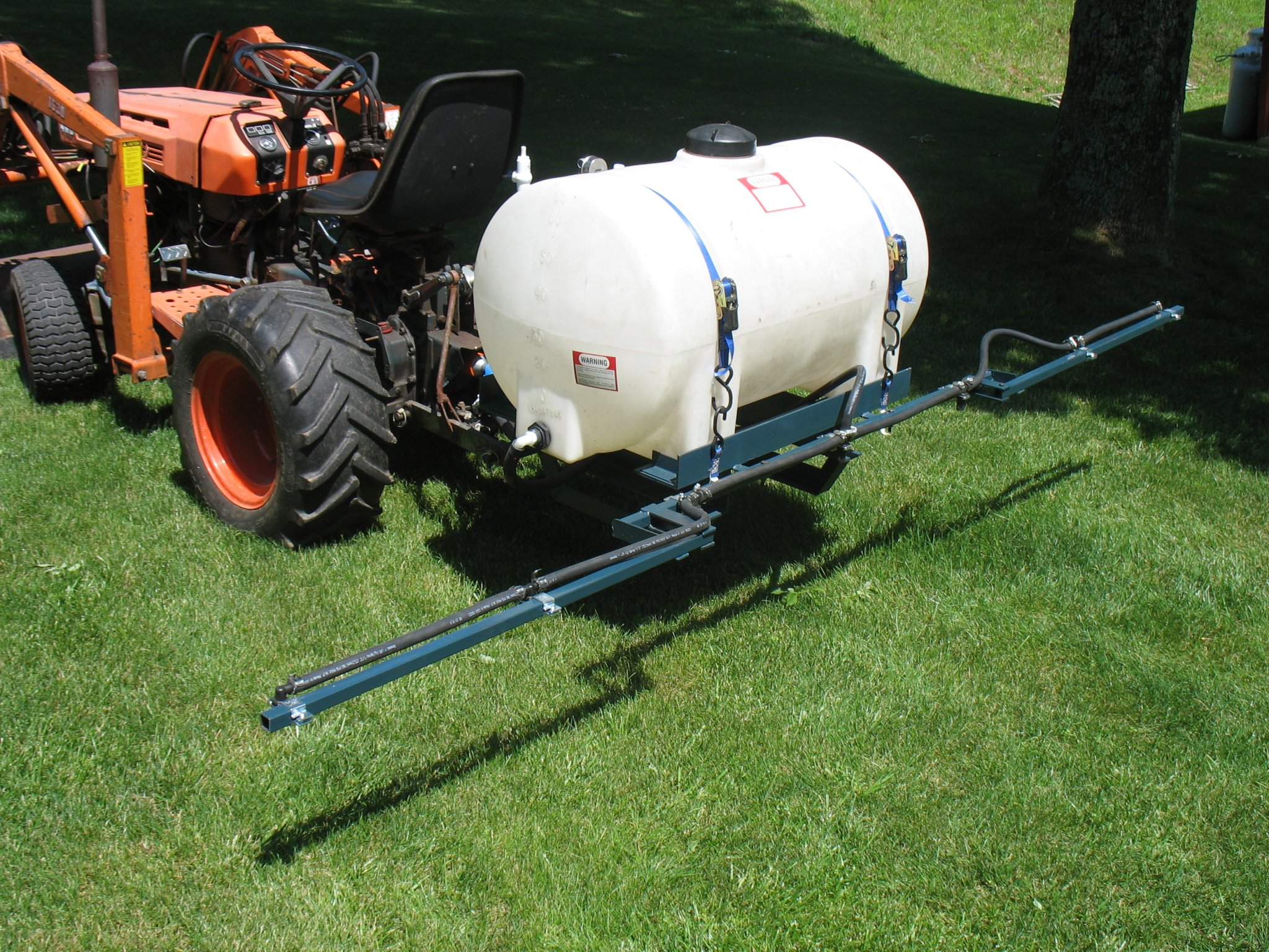

Many years ago I thought the same thing. I had a poly tank and a 3pt frame from an old seeder so I decided to build my own. By the time I was done I had a lot of hours invested and almost as much money as the cost of the Fimco I copied. Things add up fast and my DIY was not as nice as the Fimco.
That looks pretty darn nice for a home built sprayer!

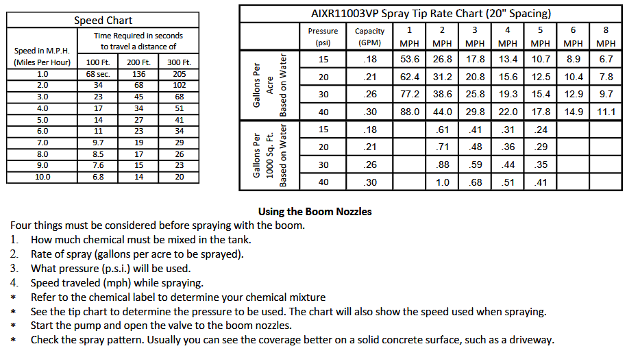

I want to spray Milestone for Knapweed and I need to spray at least 12 acres. Milestone suggests 3oz to 7oz per acre, and it would be great to spray while the tractor is moving at 5 mph but it's just not going to happen. 1.5 mph is far more realistic given the terrain, and the slower you go the more water you need in order to distribute the dosage over the acre. It's not going to be a lot of fun with a 55 gallon sprayer putting out 0.9 GPM and moving at 1.5 mph. That's a lot of water, a lot of filling and a lot of seat time.

Spraying is one of the most technical things many of us will ever do using a tractor and sprayer, assuming that we want to do a good job and apply the proper amount of chemical per acre. Given the cost of the chemical I want to optimize the process. I've got some thinking to do over the next few weeks to figure out if I should push ahead with what I have or invest in a better system with the realization that yearly spraying might be in my future.

For truly proper spraying you need to have the tractor ground speed fed into the sprayer 'computer' to optimize the spray.
Yes, as the table from FIMCO above shows, along with other parameters. Maintaining constant ground speed over hilly terrain is difficult if not impossible. The M6060 has RPM management which will help with that but it's not a sophisticated system that can vary output from the sprayer as ground speed changes.

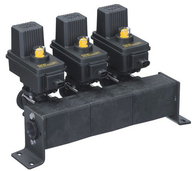

Then spend another $1500 for a three section electric valve + electric controls and you are good to go....
Nice to have I'm sure, but do I need to be able to turn sections of the boom on/off that often? :unsure: Spraying alongside the driveway will require shutting off two of the sections but for the price of admission I think I'd be ok using manual valves.
