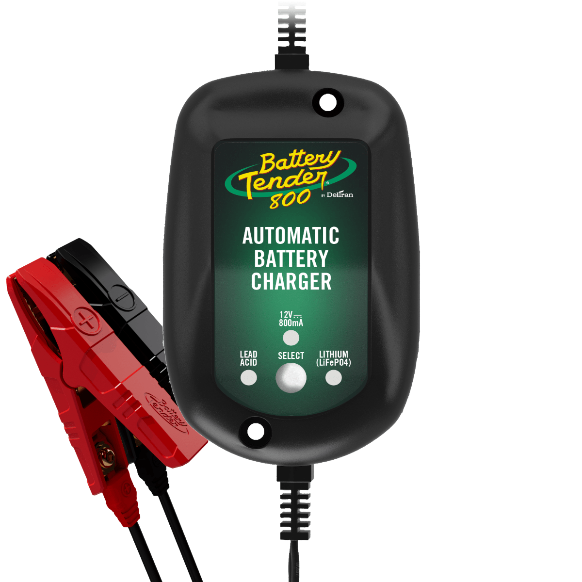

I have 6 hooked up as we speak - 1 boat, 3 jet skis, 2 kubotas.
Been using this brand for years:
https://www.amazon.com/stores/page/...st_dp_nofrnas_sto&ref_=ast_dp_bln_nofrnas_sto
Those look to be good battery tenders. I'd like to get a couple more so will try one of those models next time. I have no complaints with the one I have but I'm always interested in trying other brands ... unless it's a tractor of course. ;)
I agree - - like those. Other OTT folks mentioned NOCO as well.
Smart charge down to 0 volts and other nice features.
