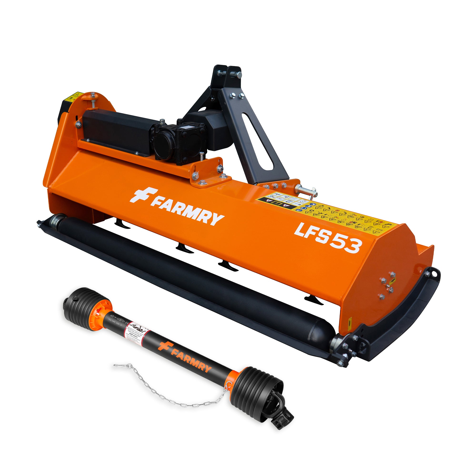

Reviving this thread. Am still considering a flail mower for my 1880. From what I have read, mechmax is cheap Chinese junk. Came across a farmery. Anyone know anything about this company or its equipment?

Bet your 2380 would handle that with no issues. Sine the BX line is 48 inches wide, am looking at that 53 inch Farmery. Still trying to find out if they buy chinese junk and slap there name on it or a legit business. Bonnyslope, have you tried cutting your lawn with your Betstco?

If you don't want Chinese stuff you'll need to buy Land Pride, Maschio, Del Morino, Befco etc. Betstco is Chinese as is MechMaxx and I bet that Farmery is a sticker slapper. I respect companies like WOODMAXX who provide information as to where the product is made.

I just shot off a email to farmery to see what they have to say. The machmaxx is $1499, which seems to be the cheapest.

Just got a reply. Stated they source out to their specs. Wouldn’t say where. Also stated they have their own engineers and support staff. Probably china or India or anywhere cheap labor can do it.
