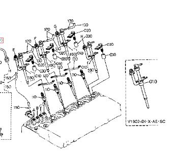

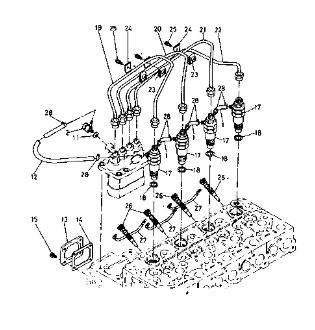

I would need to know if it is a IDI (indirect injection) or DI (direct injection) engine.
The IDI engine will have fat short injectors, and the DI will have long skinny injectors.
V1902 IDI
V1902 DI
