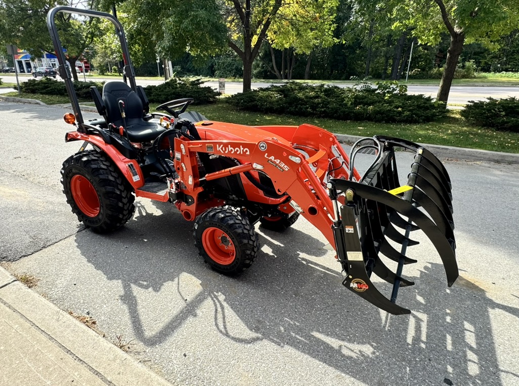

I stopped by the dealer today for a lesson on the various quick-attach devices. I grabbed one picture and will take more once the tractor is delivered on Friday.
PaulL
B2601, MX5200.
Jul 17, 2017
2,792
1,788
NZ
Very pretty. That grapple looks massive. Maybe it's just the angle.
