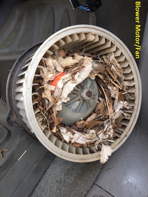

When you don't use your tractor frequently, make sure that mice don't set up under the hood. I drive my car daily, and it has developed the smell of decaying dead animals. I am certain that a mouse got into the car and died. I use rodent blocks in the summer to keep the mouse population down and frequently find dead mice in the driveway. I have searched the entire car looking for the carcass, and I fear that it is located in the dash. No way to get it out if that is the case. Too many airbags can blow if you mishandle them.
I have found many nests in the cowl under the wipers, or on top of the cabin air filter.
