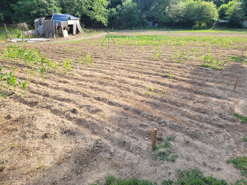

I've got several "patches" where my corn seems to be dying. I can't see anything to suggest anything consistent, including location in relation to irrigation (I was thinking possibly overwatering). I don't see any pests. The patches are across several rows, maybe about 5-6 feet of each row, in a couple of spots. Any ideas?
Here's some of the stuff growing well:

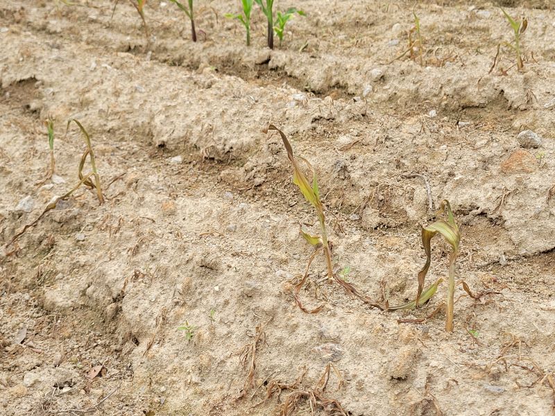

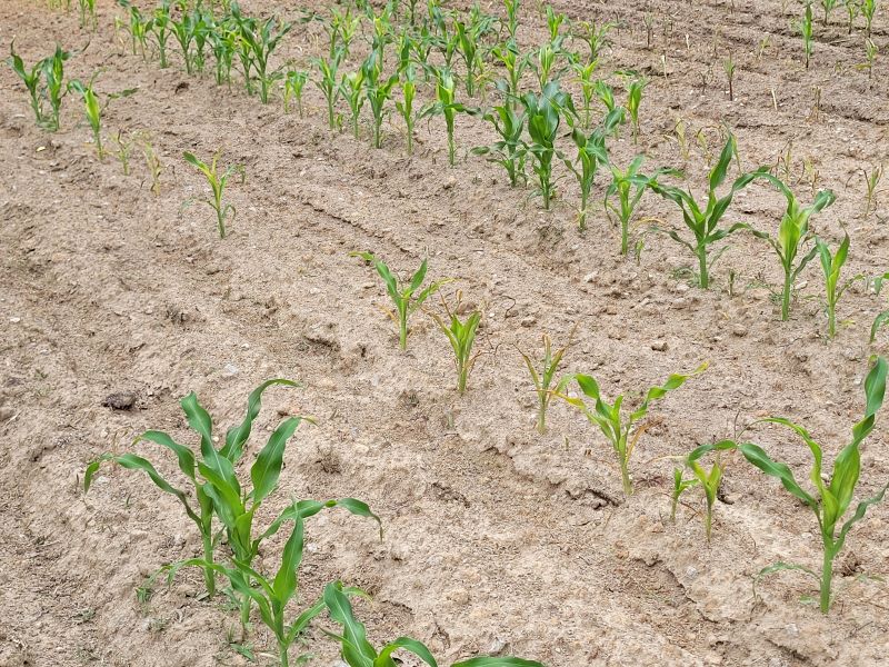

You can see the dying stuff in the background there. Here's some closer pics
As you can see - right next to some growing well

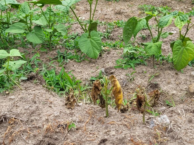

I'm having a very similar problem with my beans too, although the patches are smaller:
Potatoes, onions, peppers, tomatoes, etc - everything else looks fine, only corn and beans. Any ideas?

Not being familiar with your soil and its makeup, from the pics I'm almost thinking it might have suffered from a touch of cold weather as in frosty mornings. It's kinda supported by the condition of the other plants shown.
Have you sprayed any grass killing herbicides that could have drifted into the corn rows? Over watering, maybe but the other (beans?) don't show signs of that.

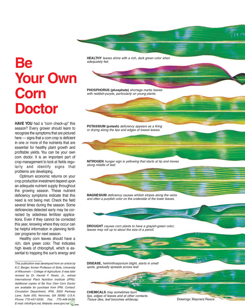

Lack of nitrogen in the corn will turn the leaves yellow.
Here's a chart showing some corn deficiencies:

Cut worm or root worm of some sort? The good plants seem too close to the bad plants for it to be drainage or nutrients.

I'll admit to not knowing the nutrient content, I didn't do a soil test this year. As for aeration - this was recently tilled, just before making the rows & planting. Flooding was my first thought but I have two problems with that conclusion: 1) the rows slope (a change since last year when everything DID flood) and 2) the healthy and unhealthy ones are too close, and the distribution doesn't suggest that at all. (Still watching out for it though). Won't hurt to put out a couple more gauges to see if there's a difference in incoming water between those areas.
Didn't think of frost. I don't think we've gotten quite that cold, but we did have a couple low-40s nights not long ago, so maybe it got down to the danger zone. I would have expected the peppers to suffer from that too, but the corn IS in the most exposed part of the field, peppers much less so. Soil-borne pest looks like another good candidate, I'll do some digging.

Didn't see anything in the ground. Soil is moist but not wet 1-1/2 to -2" down. Most of the dying ones appear to really be dying - leaves are dry and crackly.
COULD be from when I sprayed, but if so I sure didn't see how it happened. Nozzle was low to ground, kept it between the rows. That's a LOT of overspray to do that kind of damage.
Either way, looks like about half of it is gone. :(

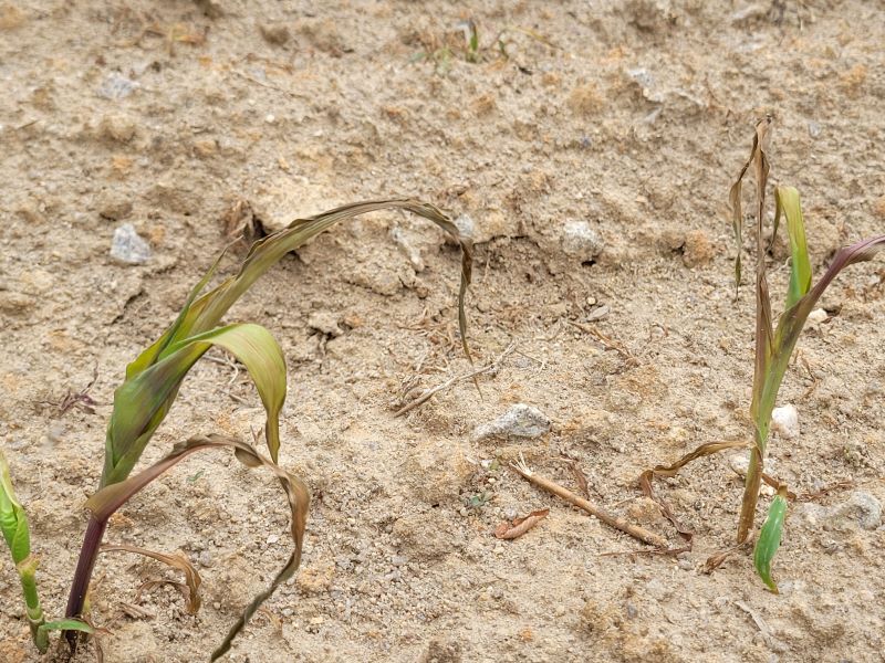

I can see a little bit of damage from a gust or overspray, but this seems a bit much:
I may have slipped once or twice but that looks like I just sprayed the entire field.
Like I said, at this point I'm writing it off, but hoping I can figure it out for next time...

Glyphosate can be transported with water to the roots of nearby plants and taken up there to kill the plant. So maybe rain after spraying was the culprit, without overspray.

FAULTY SPRINKLERS!
My son noticed a pattern I hadn't seen and asked if the sprinklers were supposed to turn full circle. I checked, and the three that were set to full circle were still hitting the limit clips, even though the "tab" was up.
Doesn't explain all of it, but explains most of it.
Obviously, not very happy. But at least figured it out before losing everything.
