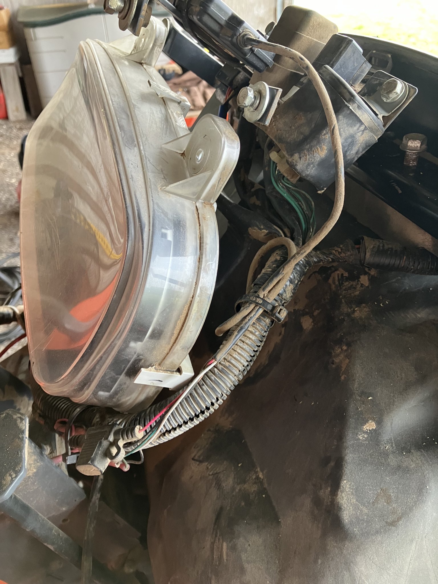

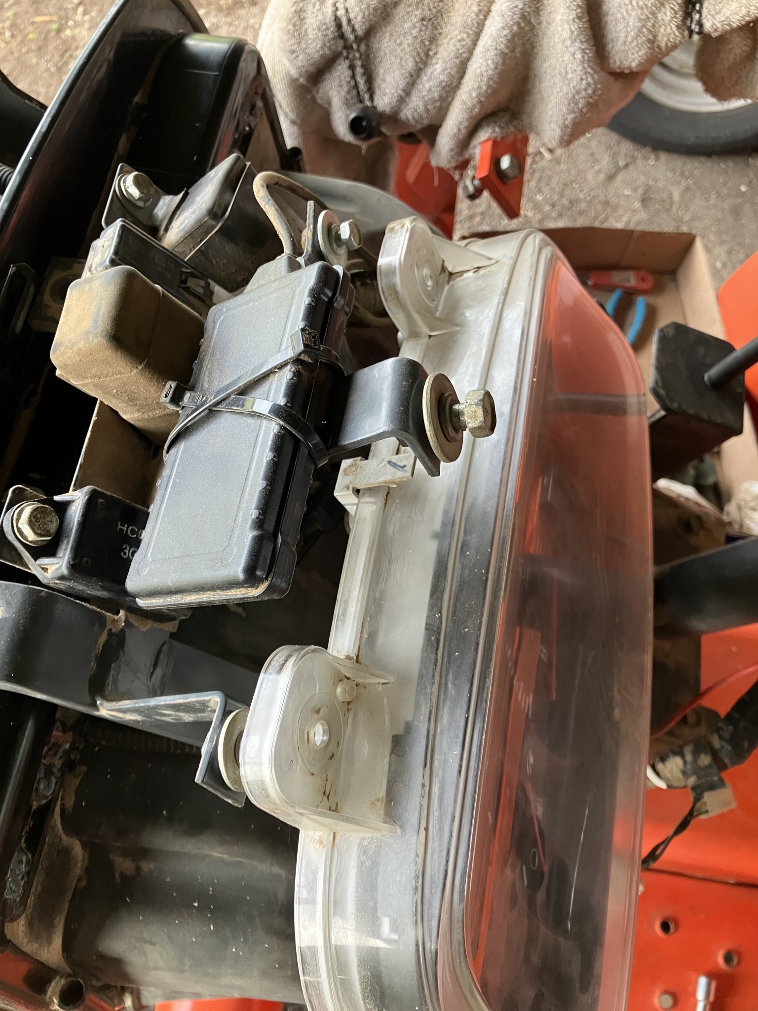

A battery? Not sure what was done here by previous owner. Any ideas what this electrical device is and what it is used for?

Is it fused? Pull the fuse and see what happens or doesn’t happen. Open it up. Worst case you zip tie it back shut
14,550
3,298
Where does the lead go? Snip the ties and open it up and see whats in side,, like said might be a GPS tracker of some kind
11,396
4,897
yes, snip ties, remove from tractor and then open up the case so WE can see inside !!!
Pretty Sure it's a 'tractor tracker' though,some YOU do NOT want !

You will probably need to splice the wire back together here, I would guess that’s to whatever they used to remote disable it

Yes it has a fuse. GPS tracker makes sense as this tractor was used as a rental unit.

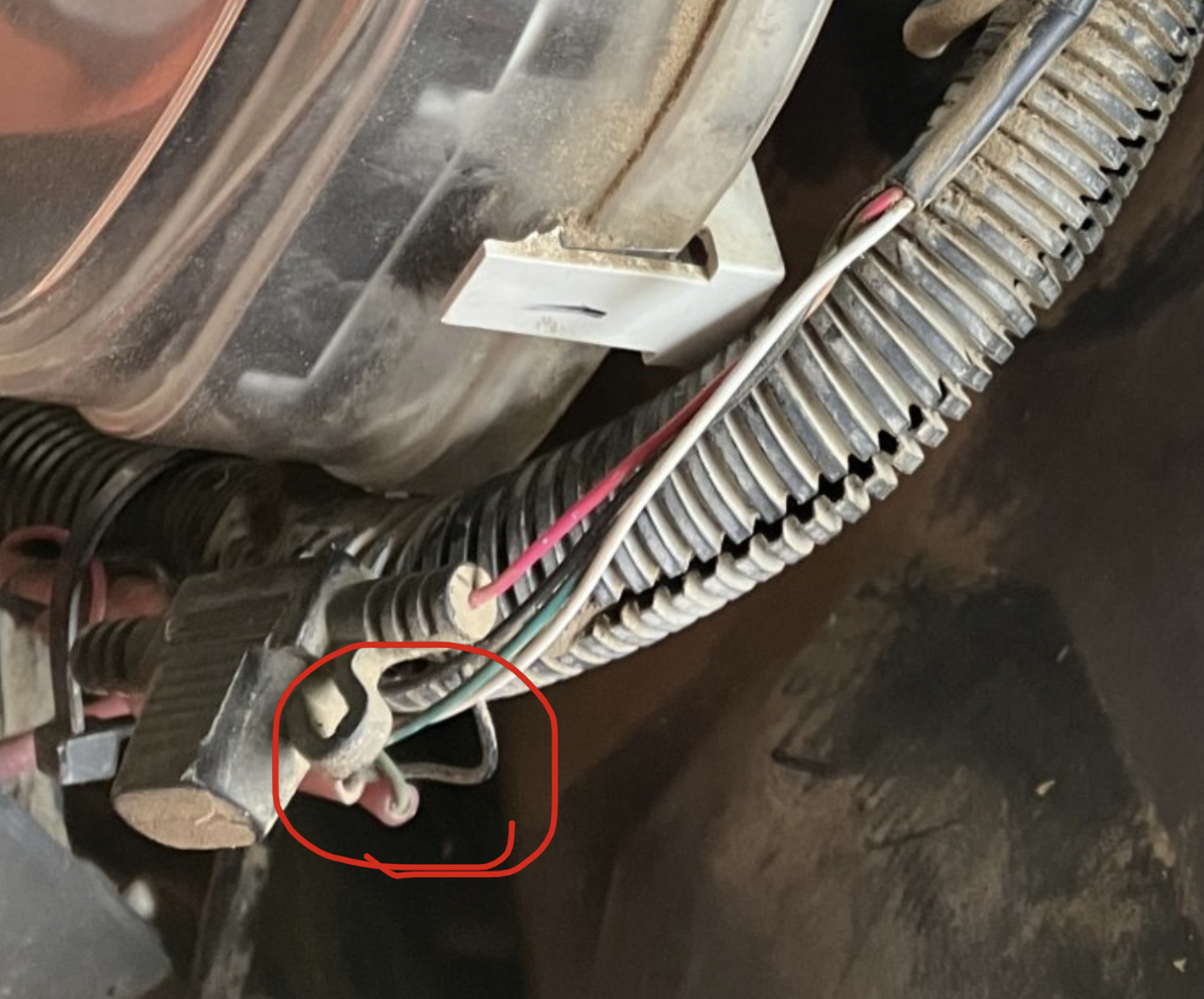

Can you give more details on which wires to splice? The main wire bundle coming from the zip tied unit, which is a SVR1400 LGE tracker, contains four wires - red, white, green and black. The red one goes thru the fuse then dives into the larger wire bundle as does the black one. The white wire dead ends. The green wire is spliced into an orange wire then into ProLink 40amp relay.

From the mounting location I agree it could be a simple version GPS tracker/ignition disable, though they usually have more wires. (there should be a Yellow wire for the Output to either the ignition relay or fuel pump relay)
Red: Fused System Power
Black: Probably System Ground
White: Possibly ignition switch
Green: Possibly ignition relay, generally the fuel pump relay disable.
There might be an add-on relay that disables the fuel pump, it's hard to say with so few wires.

The WSM (aka Service Manual) will give you the stock wiring.
You should be able to tell the difference between stock wiring and add on wiring just looking at it.
Picture of those locations where they join with wiring colors noted will help me to help you eliminate it.
It could be a crank defeat or run defeat
Depends on what wires they connected to.
Just ask if you need the WSM.

GPS tracker. Most won't disable the unit. They just send a signal when the engine is started.
You really don't need to do anything with it. It was disabled once the rental company sold the unit. They aren't gonna keep spending the fee each month to keep it active.
Most likely 1 wire is constant power. Second wire is accessory power that's activated when the key switch turns on. This will wake the GPS and tell it to start sending a signal.
Should have one wire running to ground as well.
I would check and see if there are some splices at the alternator. One for 12vlt constant, the other tapped to the exciter wire.
Follow the wires back. If it just taps into a quick connect. Then simply disconnect and toss the GPS into the trash. Fill the other half of the quick connect with dielectric grease and go on about your buisiness.

They don't normally have a remote disable. Just send a signal. They aren't that fancy. Just send a signal when the units running. That looks more like an inline fuse holder to protect the power circuit.
A remote disable adds a whole new level of frustration for a service tech.
If it's stolen, we want it running as much as possible so we can get a reliable ping on its location and for the thief to remain clueless until the police show up.
