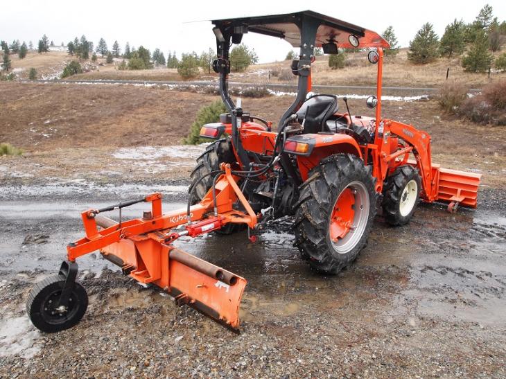

I put a tail wheel on my rear blade - the blade is suspended between the 3ph lift arms and the tail wheel, so it works like a road grader - knocks down the high spots and fills in the low ones. Works great! I generally use a piece of chain for the top link, unless I really want the rigidity.
Since I took this picture I've moved the wheel farther back -- as shown, the wheel is too close to the blade, and wont allow you rotate the blade fully around.

edit-> gpreuss great setup with the wheel and chain to allow the blade to work independent of the tractor angle. I have not seen that set-up in the past.

gpreuss, I also like your setup and wish I had the welding skills to put together a similar setup.
