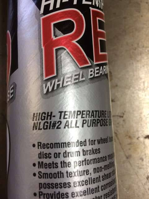

In today's world, I doubt that there is a "bad" grease, but some are more adapt for particular applications than others. I am content to use a red high pressure grease on everything.
NLGI#2
