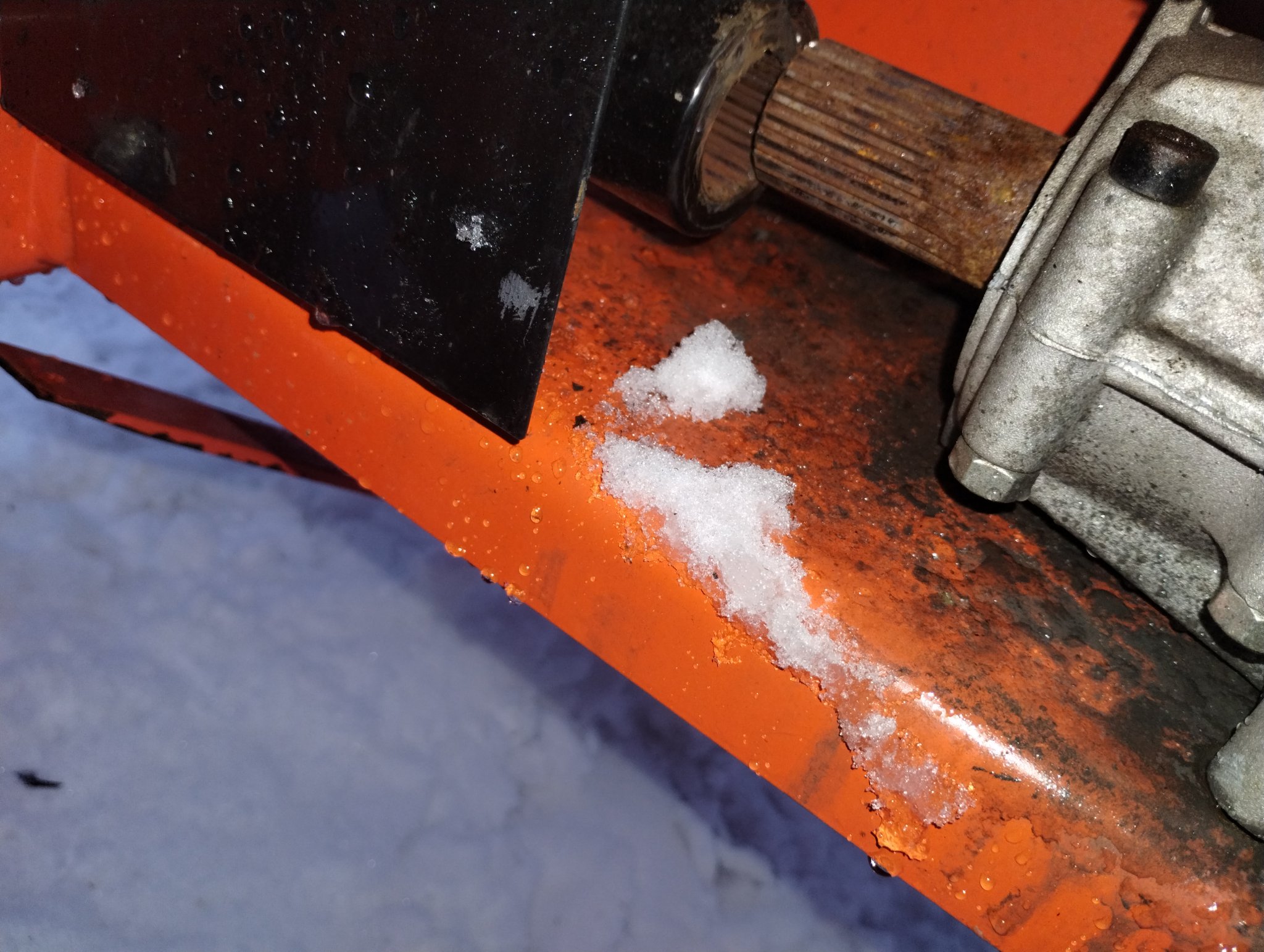

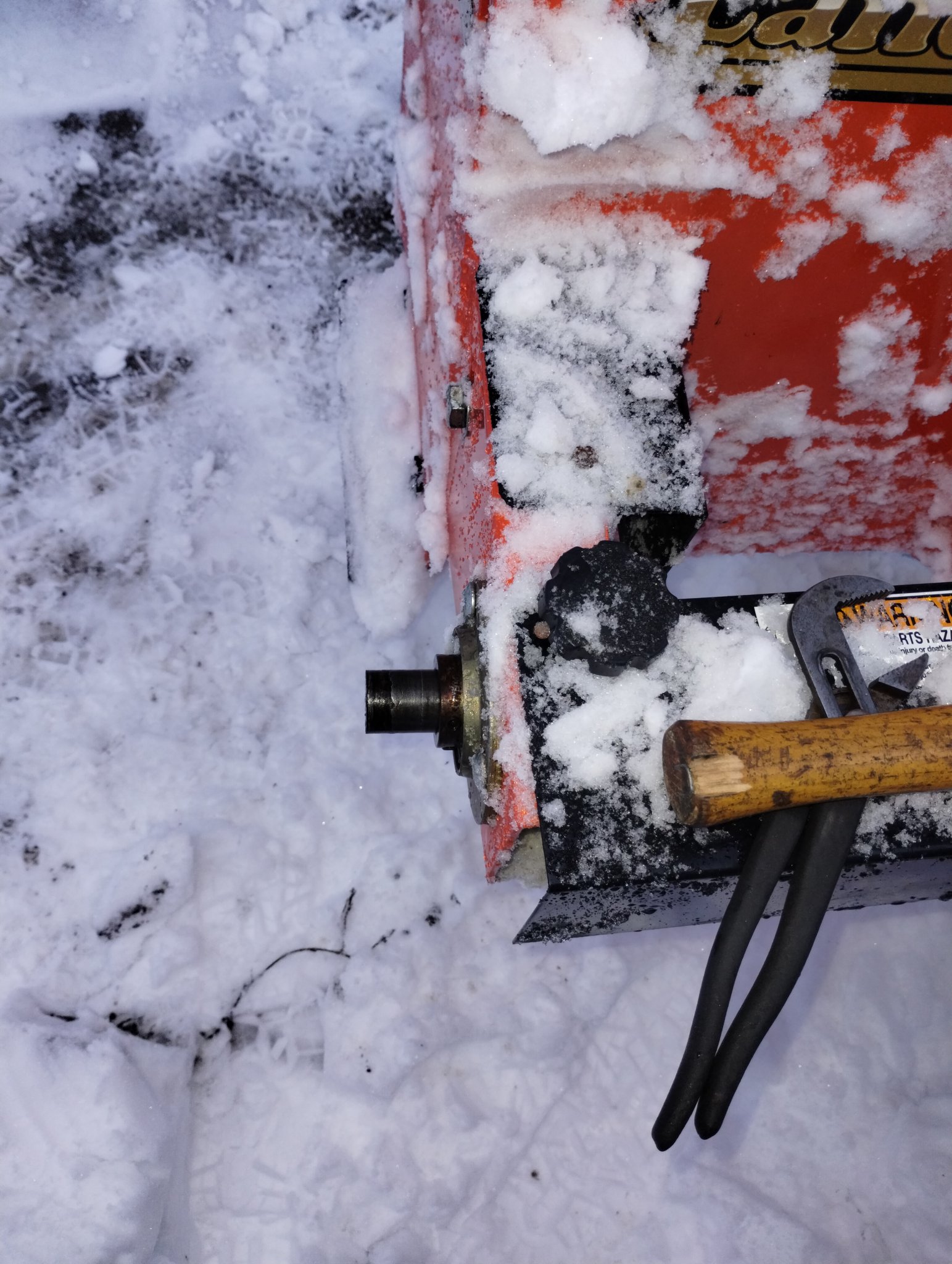

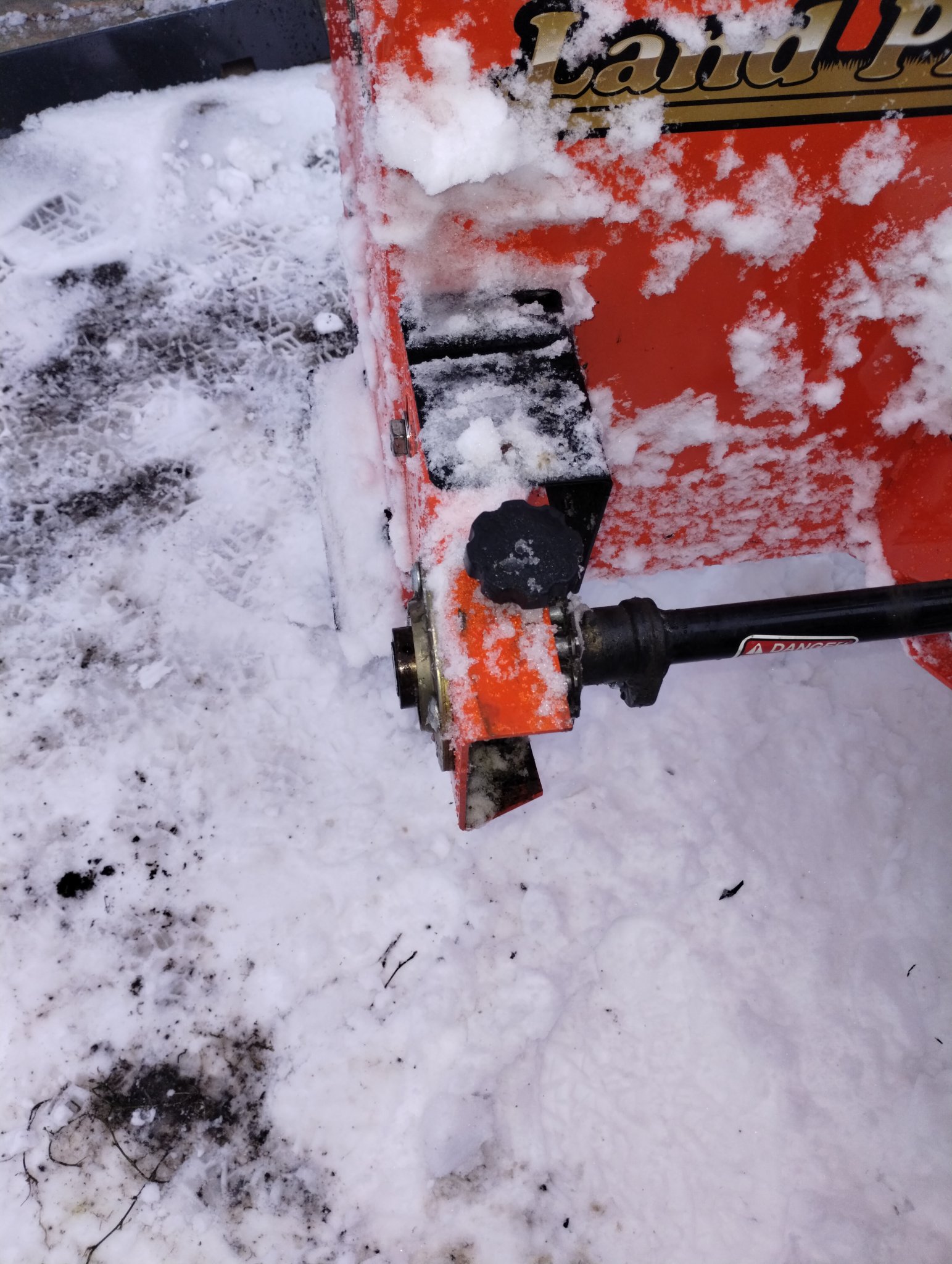

I snow blowed the drive today. Half way thru it stopped turning the auger.
I assumed the sheer bolt broke. Went in and got a sheer bolt.
Removed the cover found the bolt not broken.
Shaft moved out away from the gear box.
Got it back together and finished the drive.
Got it back together and finished the drive. View attachment 121396 View attachment 121397 View attachment 121398
What stops that drive shaft from walking off the splined output shaft on the gearbox? I have an SB1574 and looking at the parts drawing I don't see anything that controls thrust. I'm asking since I'd rather not have this happen to me.
I'll look into it when I'm back from a work-related trip but was wondering if you're aware of any feature that should prevent this from happening. The chain sprocket riding up against the chain would attempt to limit axial movement but that would cause additional wear on the chain and sprocket.

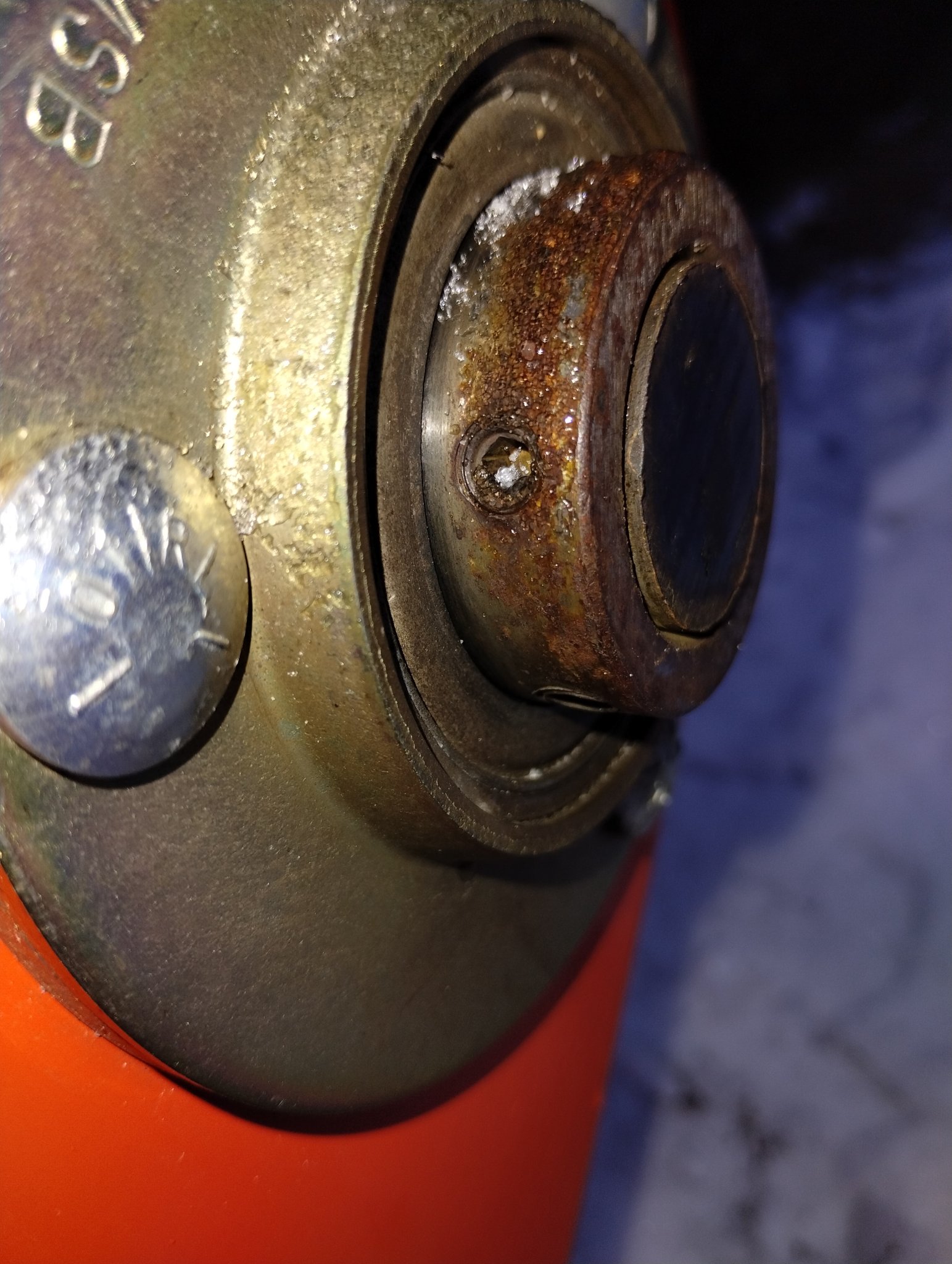

The shaft is held onto the splines of the gear box by two set screws in the inner race of the outer bearing.
when I get home this afternoon I will take of picture of it and send it to you.
7,246
10,014
Thanks very much. Hopefully your set screws were still in the shaft although backed off I suppose.

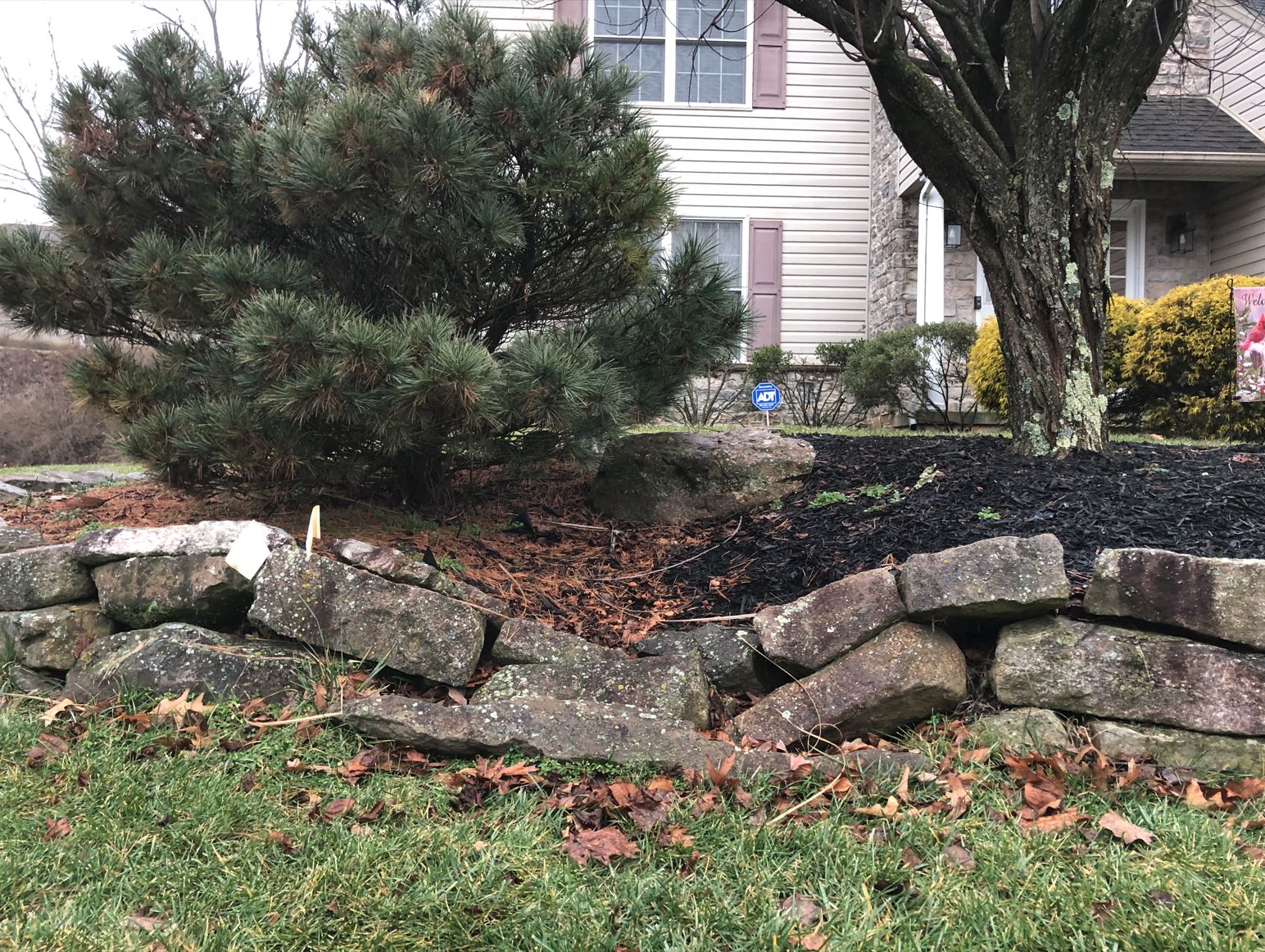

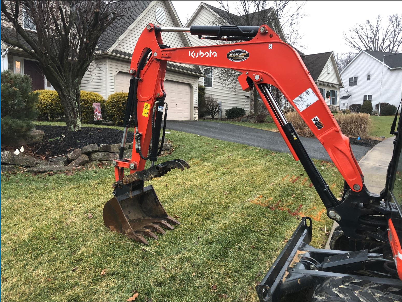

Sewer line repair today for the mini. Pretty nasty pipe separation. The 6" cleanout pipe had evidently been consuming soil, dirt rocks etc for some time. Just look at the rock landscaping wall. That tells the story.
Start
That doesn't look right to me...
dig
man eating serpent spotted:
yuck
anyway, I wound up making a huge hole. We made the repair and they were still trying to open the rest of the line with jetter and rooter when I left. Didn't get any pics at completion.

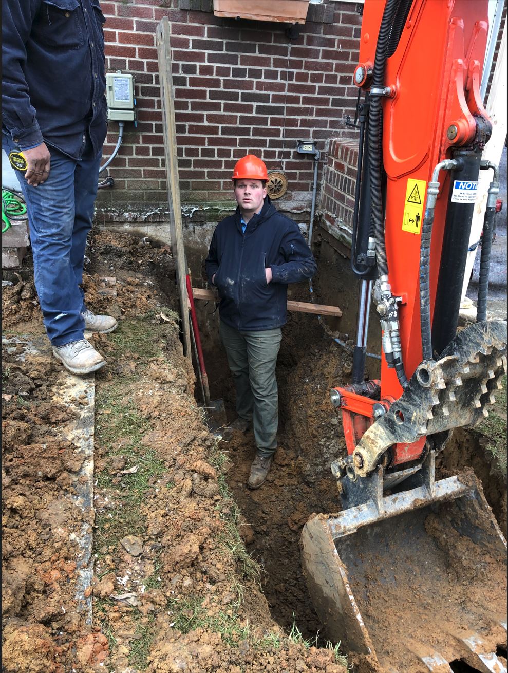

next one. only 1 pic from another sewer line job in town. Didn't go well. Need to go back with larger machine and trench boxes to make the final repair. Better to get the right machine for the job.
anyway, here's a very hard working guy. Nice to see that there are still some younger guys with common sense and a strong work ethic.

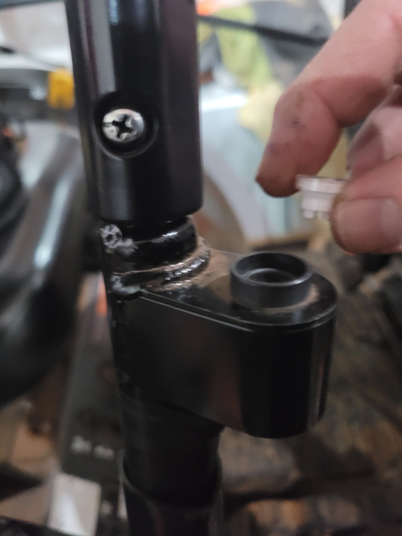

Popped the button off that controls the third function for the chute deflector or grapple jaws when the loader is on. Couldn't get it to go back in place and you can't order a switch for it from Kubota. The upper loader joystick and wiring comes as an assembly. The dealer was able to get it covered it as warranty which was nice since it would of been $1100 Cdn if they didn't.
They didn't want the old one back so I'm going to get a friend to fix it for a spare which would of been my plan if it wasn't covered. The new button sits lower and is rounded so I won't catch the edge.

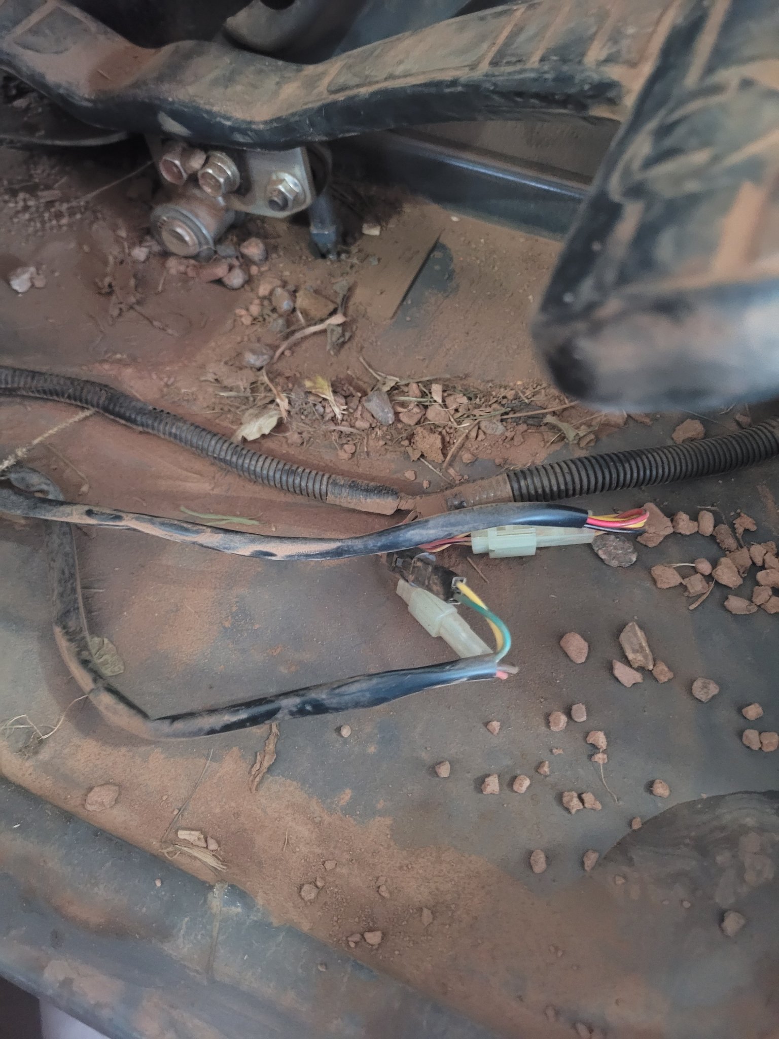

On another note. I didn't realize how much dirt and gravel was under the rubber mat and insulation. I'll make sure to clean underneath more often.
