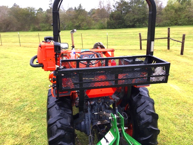

Added a chainsaw carrier to my rear basket. Handy to be able to be carry a small saw when I go down to the woods.
Won't have to go a mile and a half back to the shop to fetch a saw because of a tree down across the road/path. I could put a saw in the basket and strap it down, but I need that space for other things.
Easy to add a carrier and keeps the saw secure.
It tucks away fairly well. If my front bucket will clear the path, so will the saw.

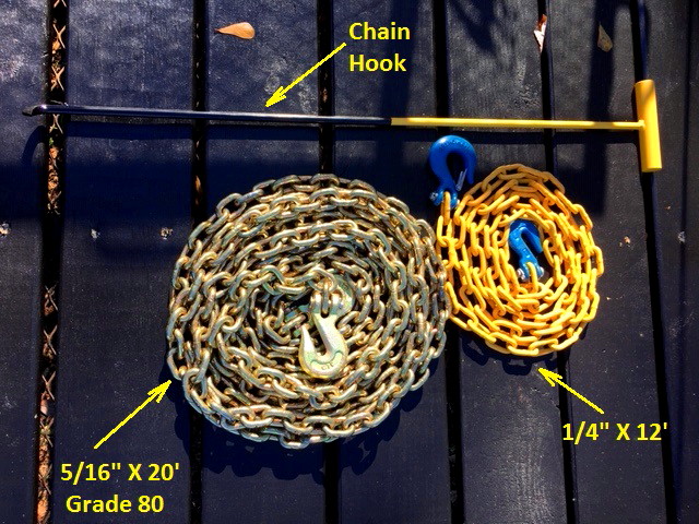

That’s a nice addition. Not to change the topic, but what is the ‘yellow T handle’ in the bottom left of the frame of the last photo?

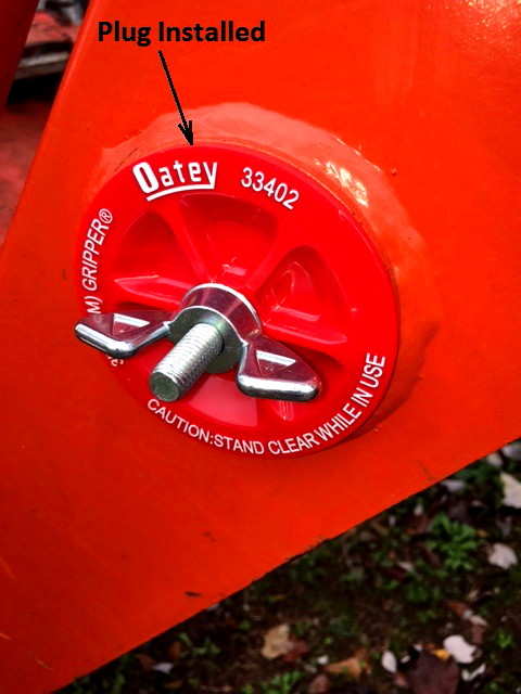

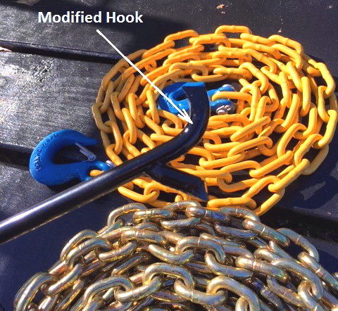

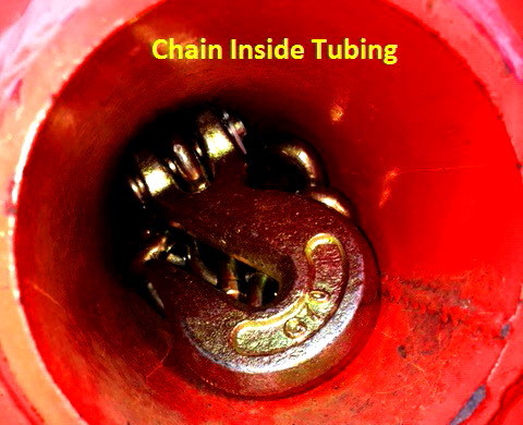

That's OK, I store a couple of lengths of chain in the cross-tube (brace) of my front loader. It's a convenient place to store chain without having to come up with an exterior location to carry them. On a compact tractor there is just so much 'real estate' to work with. So mounting a 'chain bucket' doesn't make sense.
Those two lengths of chain pretty much fill the tube. The only way to get them packed back IN the tube is with the chain hook tool.
Reaching in and pulling the chain OUT is no problem. Once it starts....gravity takes over. But putting it all back IN is like trying to put toothpaste back in the tube without the help of the chain hook to stuff all that chain back in place.
Naturally, I have to carry the chain hook with me.....so I just found a place to mount it out of the way.
