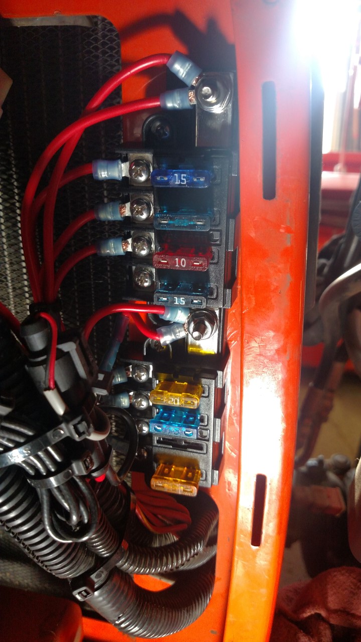

I got tired of looking at the fuse block dangling from the wire harness and sometimes making it difficult to put the battery cover back on, so I ordered a couple of four circuit fuse blocks and made it a little more professional looking. I drilled a couple of holes in the bulkhead for each block and used screws that were just long enough to secure them, but no long enough to interfere with the removable radiator screen.
The top block is for circuits that are always powered, like the shutoff solenoid and head lights.
he bottom is for all the circuits switched by the ignition switch.
I had to modify the top cover a bit for it to fit since the blocks are mounted so closely together.
The dangling fuse block was just one of those things that triggered my OCD.

Looks really good. I see you are using quality nylon terminals, not the cheapo vinyl ones. Nice looking crimps, too. (y)

Very professional Sir. Well done!! (y)

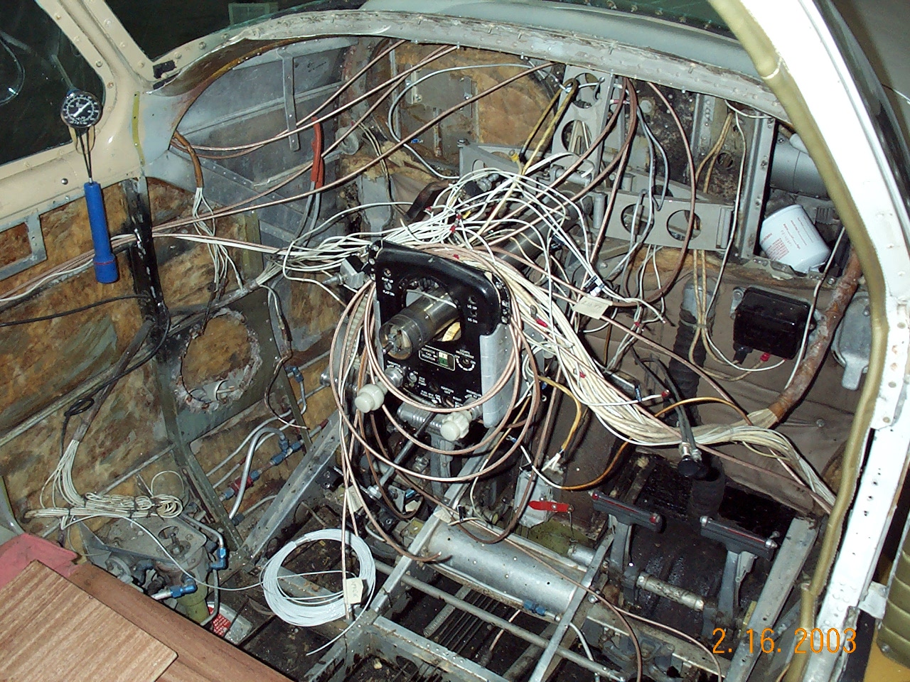

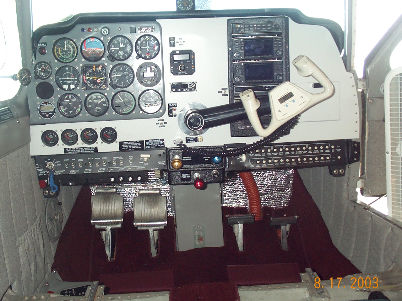

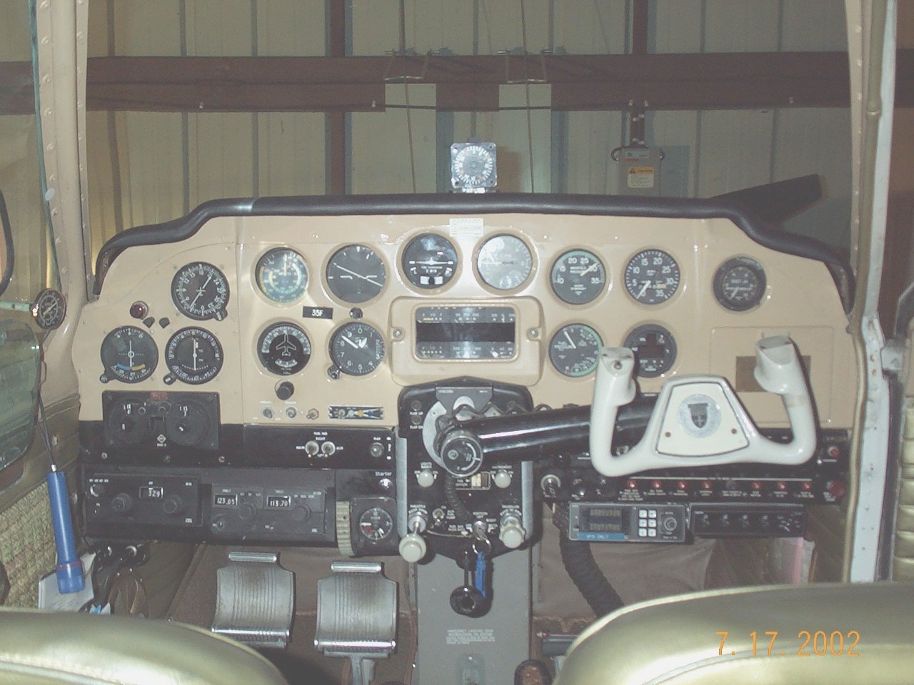

Thanks, I got a lot of practice on many previous vehicles with rats nest wiring. I also completely replaced all the avionics in my Beech Debonair a while back. That was a REAL project.

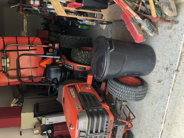

Played a bit of garage Tetris and was able to fit both tractors in the garage

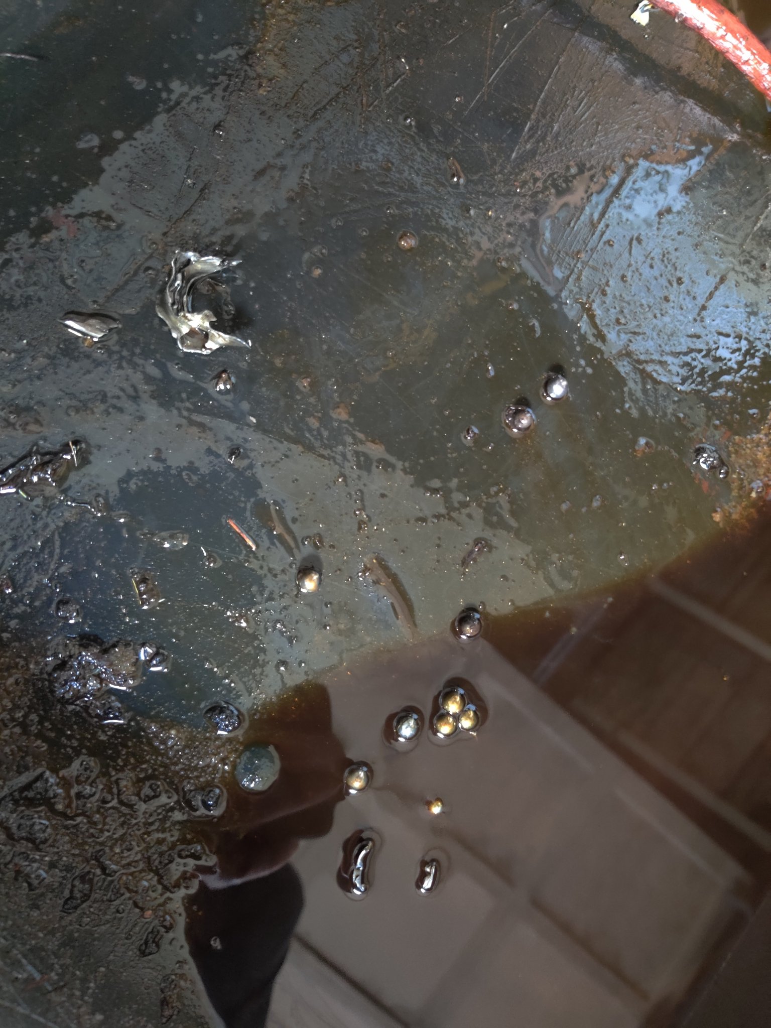

Removed and cleaned/degreased my steering gear box. Poured loose ball bearings out of the case but the case is in good shape. The steering shaft had broken and been welded together at some point by the previous owner so I ground that back to round as they just left the welds after it cooled and reinstalled it as it was. Just waiting on Messicks for seals and bearings to get it all back together.
